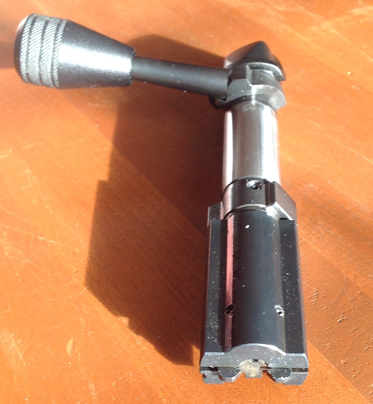

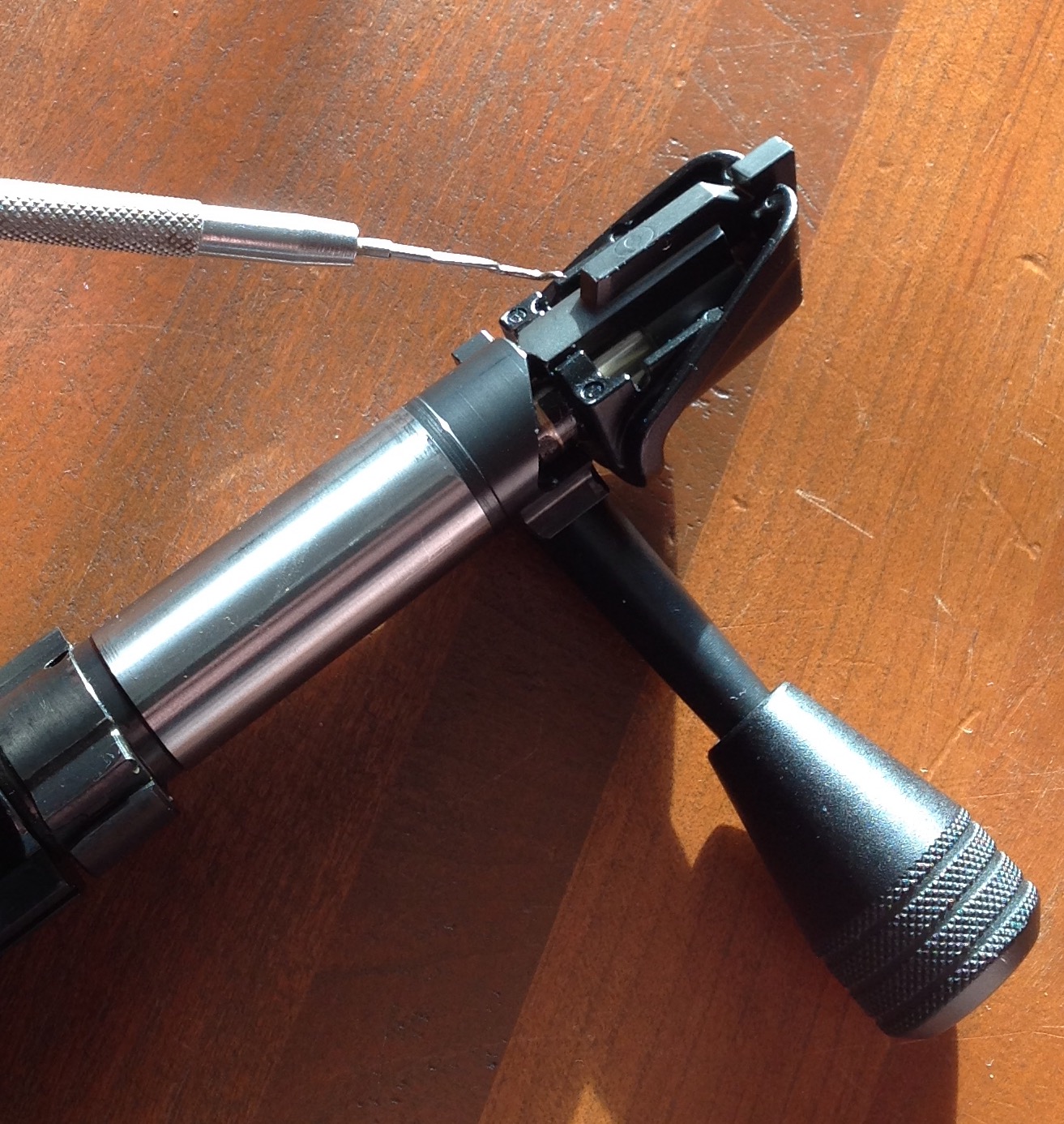

Can you explain the modified striker?
Reactions: A&8's
As for single load I'm not sure yet. It's control round feed from mag. I'd be interested In finding out. Here are picks of the bolt top and bottom if it will help.
I was having so much fun shooting, I caught myself getting in a hurry stuffing those mags with those little 22 rounds. I wonder if they make a mag loading assist! 😊
For the striker I've attacked photo pointing at the location that is modified. I like for my bolt close to feel the same on all the actions I shoot in matches. Since this is a trainer I wanted the bolt close to be the same. When I installed the Jewell it had about .020"extra firing pin protrusion with cock on close, which would cause slight torque to the right when closing bolt. Just me being picky. Hope this helps, Thanks , Jeremy

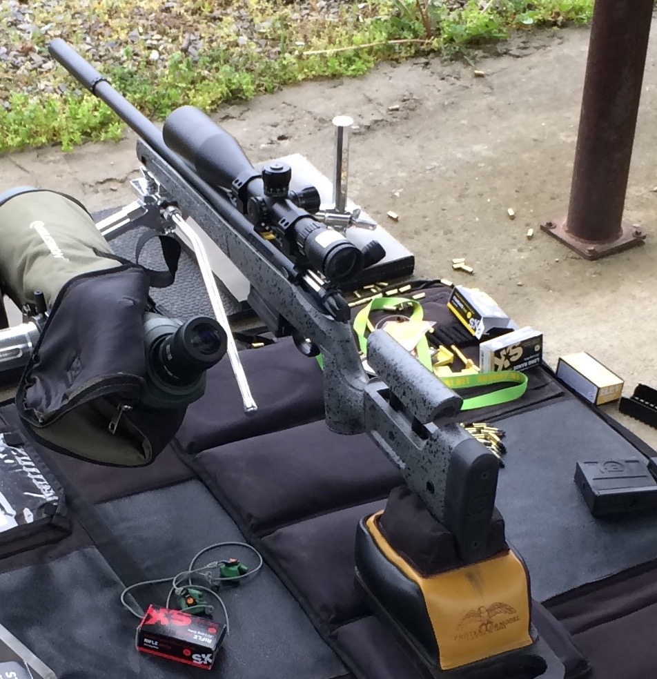

Just wanted to share today's best 10 shot group at 100 yards with Bergara B14R.
I had fun playing in the wind.
I'm 720 rounds fired through 3 mags. I had one case when extracting turn sideways. I feel it was on my part for not pulling the bolt back far enough without stopping.
I'm having good time with SK yellow box. Today I fired both sk yellow and red box. This group here is red box.
Once I get my optic upgraded I'll try my luck at 200 yards. That's the goal. Thanks Jeremy

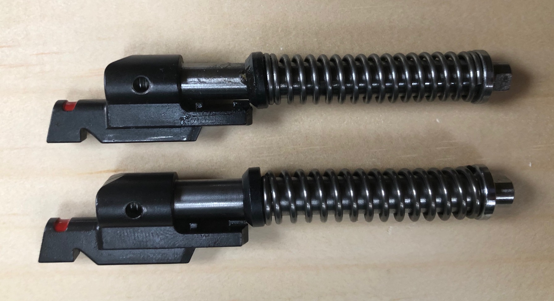

I installed a tt diamond in the b14 today that I ordered for my RimX.
Since I‘m still waiting on the barrel I thought testing it in b14 first. I didn’t want to order 2 not knowing if they work with both rifles first, since a lot of guys have problems with them.
I know, Bergara may send a new cocking / firing pin assembly if the trigger does not work.
The trigger seems to work as designed so far, I was able to adjust it down to 4# stopped there and adjusted it back up to 6#.
That is where I want to leave it for now. Passes drop test and safety works. It‘s definitely the best trigger I ever felt. I only had timney triggers so far. All ranges around here are still closed so I can’t shoot it yet.
Got a feeling I‘ll have to order me another one soon lol.

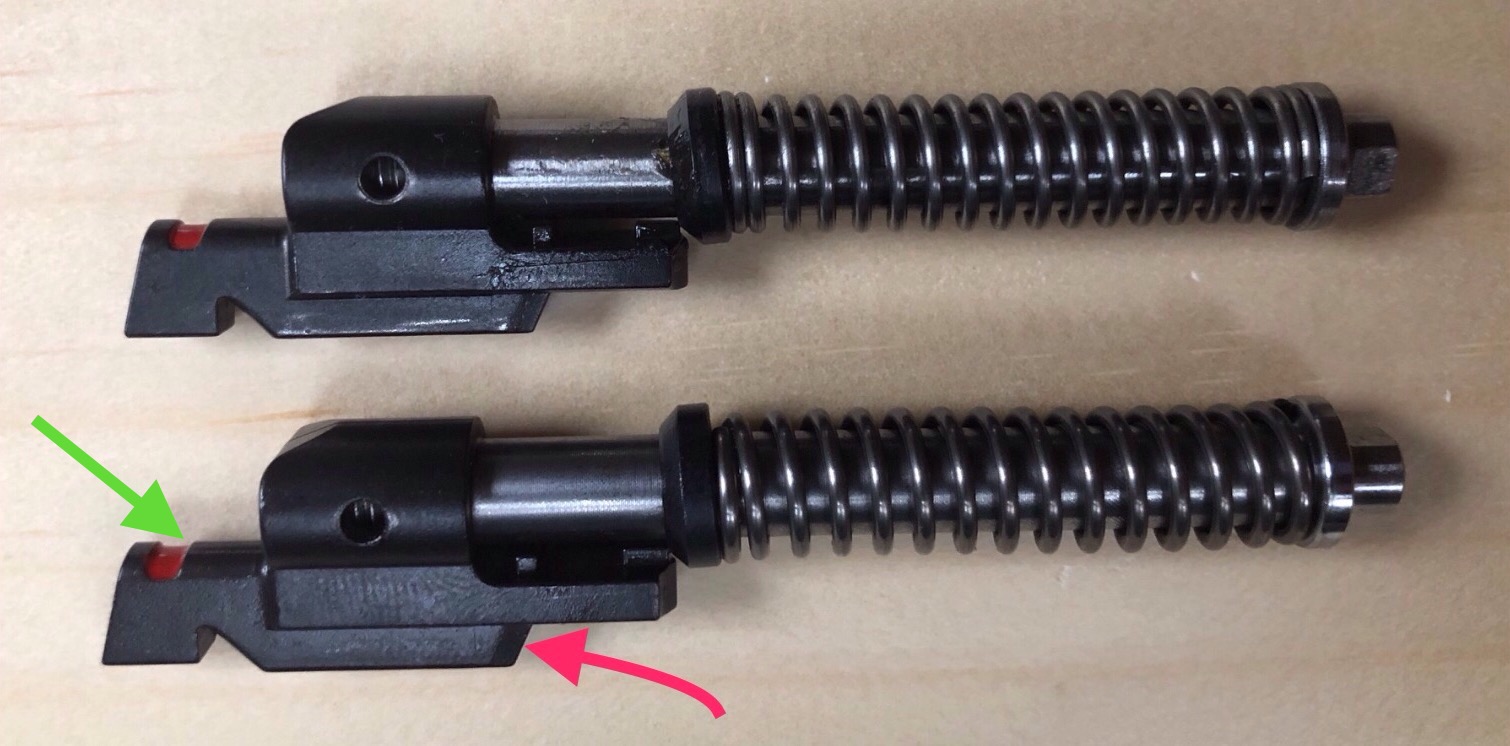

New parts arrived today. I can't tell any difference just by looking at them. Was easy to change out. Hopefully I can get to the range tomorrow and try the trigger tech. Top old, bottom new.
The video they sent.
[QUOTE="GrahamVT, post: 8522488, member: 132790
Once you install the new cocking pc maybe you can feel the difference when closing the bolt. I think what most of us are getting after installing our favorite triggers is a little cock on close (loading up that firing pin spring.. excess tension on striker). I've attached a few arrows to your photo. Red is the face of the striker which on the new piece could be different by .010"-"020" from original, which can be measured ( firing pin protrusion). The green arrow, once you install the new piece should see less of the cocked red indicator ( firing pin protrusion) from rear. In my experience I've had less felt resistance when closing the bolt.

Biggest thing I noticed from the pics was the difference in the springs. The new one seems to be a larger diameter wire and has less coils. Stronger spring?

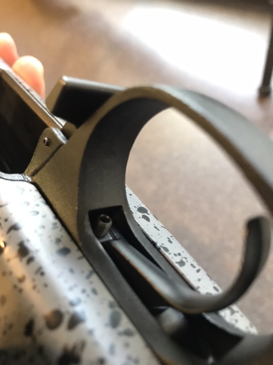

Just emailed Bergara and have the new assembly on the way. I have had an issue with light strikes with certain lots of CCI SV from day one.
One thing I noticed after the issue was that my striker assembly was not screwed down all the way, was one turn short. Even after screwing the bolt shroud assembly the extra turn still had light strikes with some CCI SV, but much reduced. Recocking without ejecting the round fired all but one time. That particular round showed no priming mix after disassembly. And let me state that the light strikes were less than 1%. Basically 4 per brick of one case that I have, and maybe 2 per brick of another, all 2019 lots.

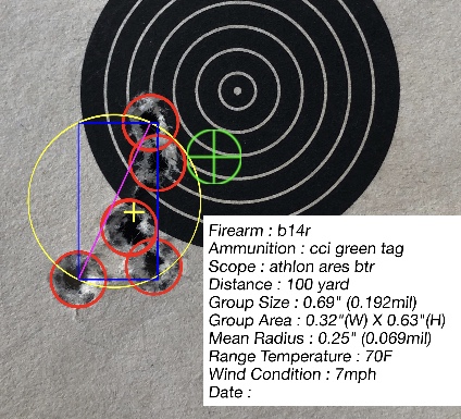

I have not had any problem with Lapua, SK, RWS or Eley ammo. Appears the CCI case is of a harder alloy. I even went so far a to section some of the double struck cases, along with Lapua and Eley cases and measured the head thickness. All measured the same best I could determine, thereby leading me to believe CCI brass is harder.
The CCI fires without issue in my other 22lr rimfire rifles, handguns. So....for serious target shooting I eliminated CCI due to the possibility. Accuracy was always there but I was not willing to have a light strike during a timed stage of fire.
I will see if this new assembly cures it or makes any change in the trigger pull. If it cures the issue great, if not I'll just shoot those that have proven to have no issue.
BTW, there is a Noticeable difference in the appearance of the hit between CCI and the others. CCI small dimple, others much more pronounced "impact".
I'm running the factory trigger, so it's not an aftermarket issue. And mine is one of the "early" rifles so a couple of "bugs" might be expected.
This rifle is extremely accurate without a fussy appetite! I'm really glad to own one.
I've only fired SK, was fixing to order some cci green tag. I sure dont want to spent $70 on a brick of CCI if miss fires are occurring thx
If you want to try CCI, go get a box of 50 SV, shoot them and then compare the firing pin indent with those of the SK. Mine show a big difference. Easiest way to know. Misfires are not common, but do occur for me with CCI SV, as posted above less than 1%, closer to .05%.

Added 5/7 @ 3:27 PM: I could not insert the .050 allen wrench in the bolt assembly the way it came, only after screwing the bolt shroud in one more turn was that possible. Hope you understand my meaning.

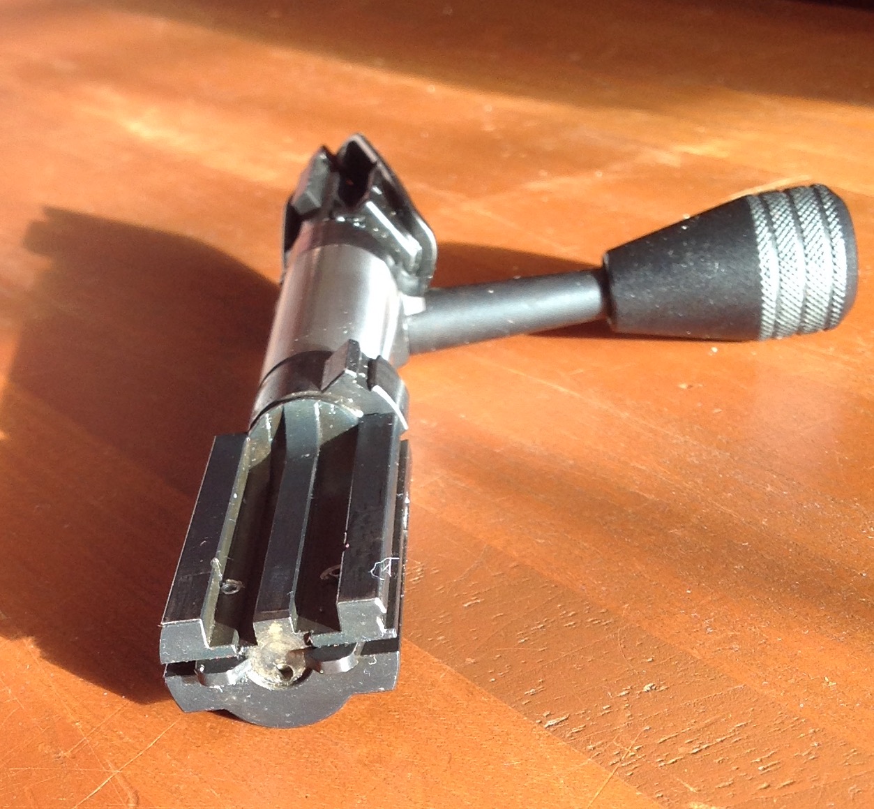

Hey Fullbore I would like to talk to you about the work you did on your bolt. Maybe I can swap info with you and talk PM thanks
Feel free on the bolt questions. Send a PM or reply here whichever is best. I'm no gunsmith, but sure can pull the trigger on one, lol.

Received my updated striker assembly for the B 14R today. I thought I would get one to try due to the minimal occasional light strike issue I had with one lot of CCI SV. I installed the new assembly and can state with out a doubt that the spring in this assembly is definitely stronger. How much I don't know but I used an .050" allen wrench to hold the striker for disassembly and reassembly as I can't get a 1/16" wrench through the locking holes.
The pressure from the new assembly, with the stronger spring bent the wrench. Original was no issue.
Before changing out the assemblies, I hit some CCi, Lapua and Eley fired cases to check for indent (I marked the original firing hit with a sharpie so as to not get them confused). After changing out the assemblies, I did the same with the new assembly.
The new assembly definitely causes a deeper dent in the fired cases. I'm almost certain this will eliminate the issue with CCI ammo.
I checked bolt lift effort, closing effort and trigger pull weight before and after. There was no change in any felt effort or trigger pull weight.

As for the trigger, considering the factory says it's supposed to come in at 3.7 lbs I decided to measure it again today and it does indeed break @ 2.25lbs. Not really a surprise, my FN SPR is set at 2.75lbs and the Bergara certainly feels lighter. Looking at the trigger adjustment screw, I'm not sure if it's all the way out or not because I haven't tried to mess with it but just looking at it seems like its backed way out. I'll post a photo of it below.

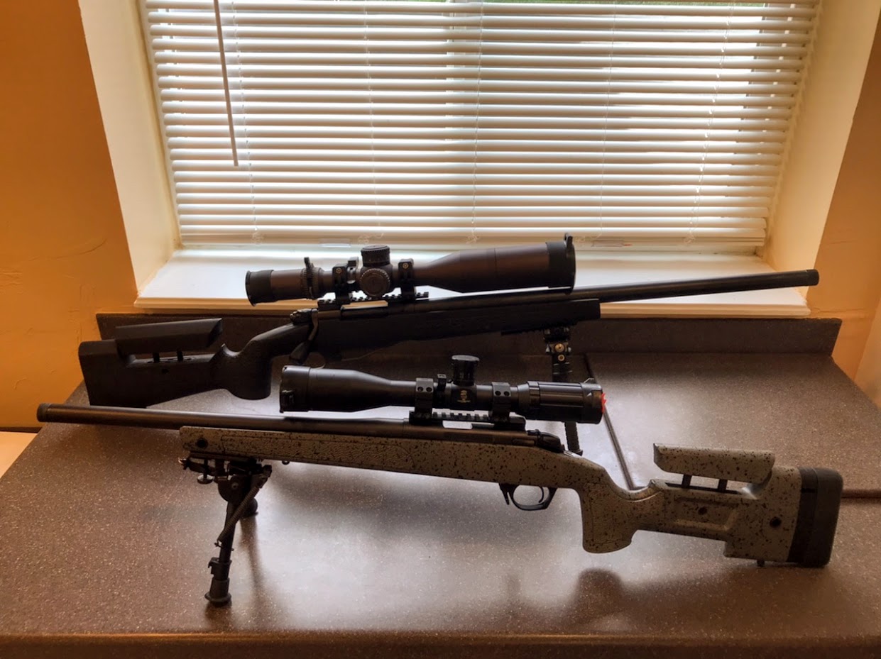

Threw in a photo of the Bergara with it's big brother FN SPR. I bought the B14R primarily to help me get better at shooting in the wind. Much easier to do with $.15-.20/rnd vs $1.00/rnd.

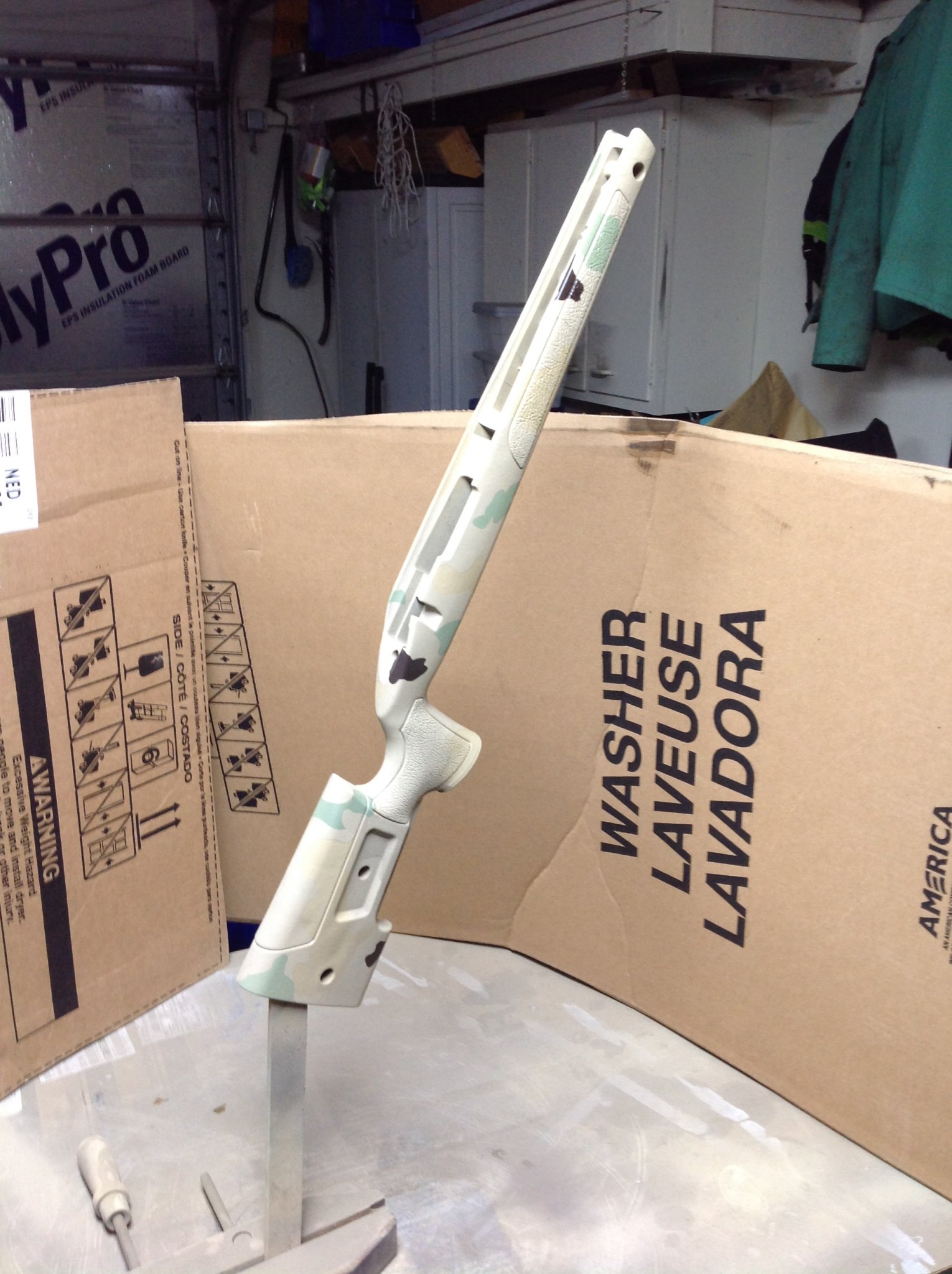

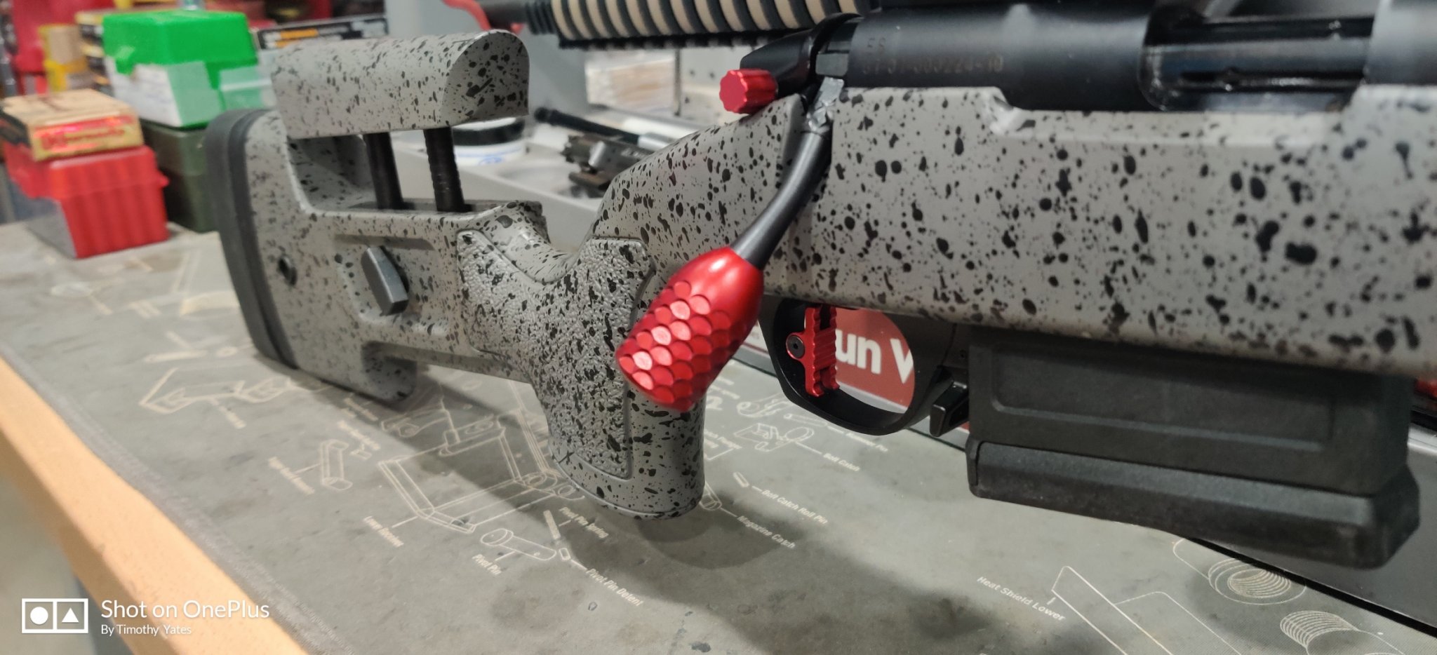

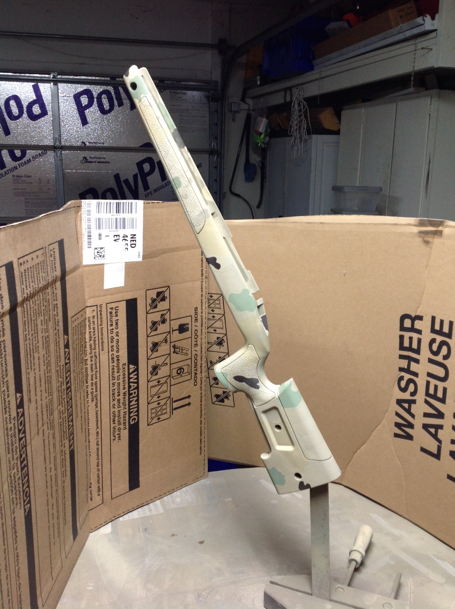

Also, I couldn't stand the color of the stock. Just me. With some red neck enjunuity and hold my beer I managed to spray paint it today. After it drys and I sober up. I'll decide to post a picture.
