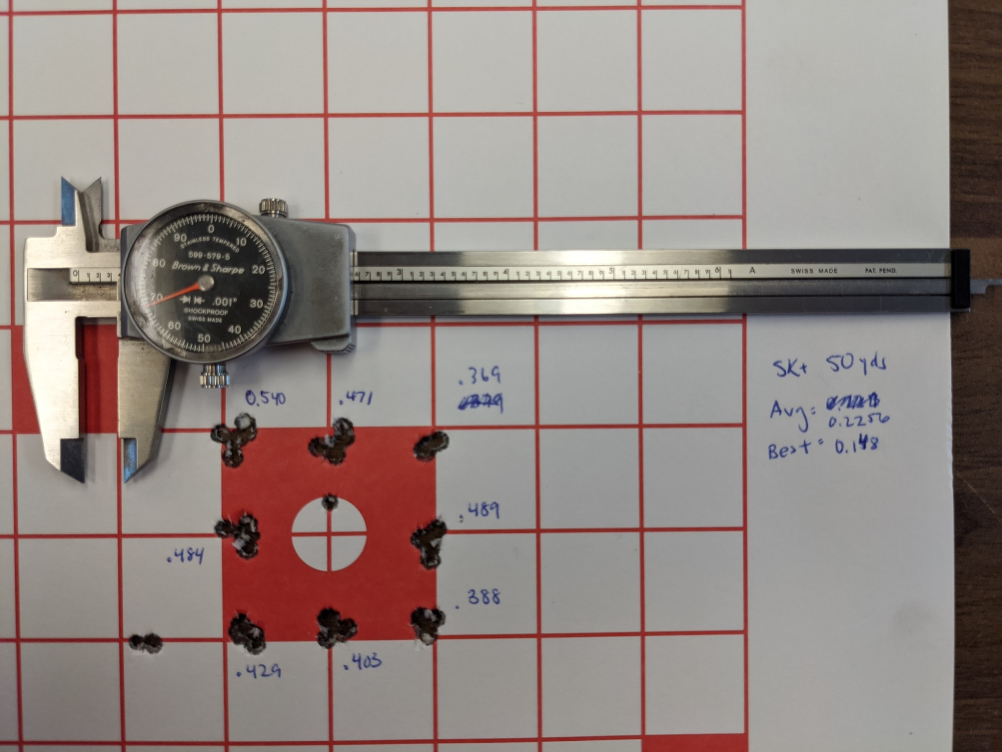

You Sir have good taste in calipers.. best made IMO.These were part of my first 200 rounds of my Vudoo with SK+. It can get a little better. It's the same kind of decision on saying getting a Tikka T3X versus a custom Impact/Defiance/Zermatt etc. My Tikka T3X also shot sub moa... don't need one or another to win a match.

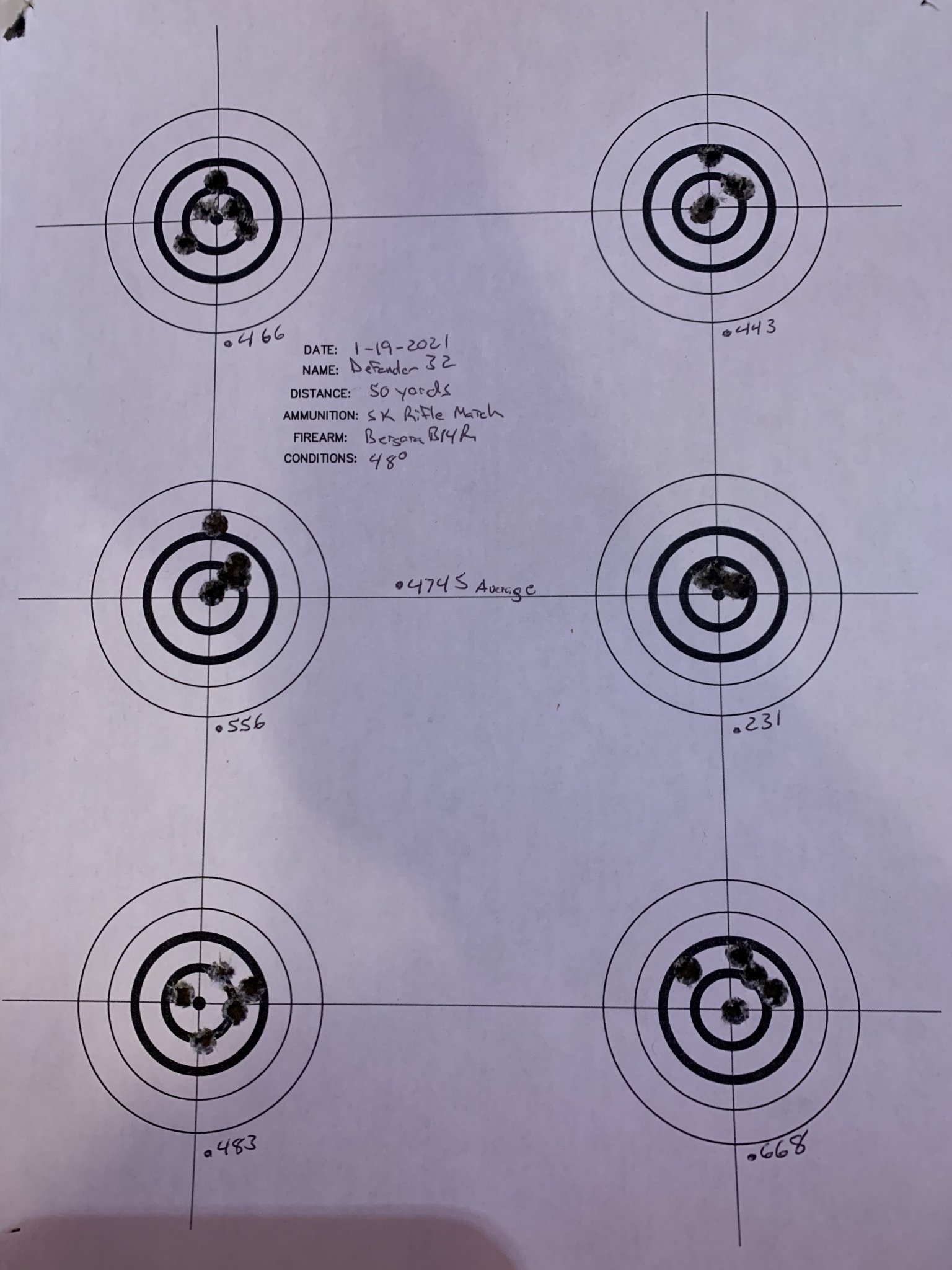

Pretty sure I was the fella with the Bergara that you helped diagnose (RFGCAgreed everything man-made can have failure. So I just judge companies now by how well they treat their customers. Vudoo has been very great to me in all my questions, fixing my rifle, tuning it at Nationals for me, and just constantly being responsive.

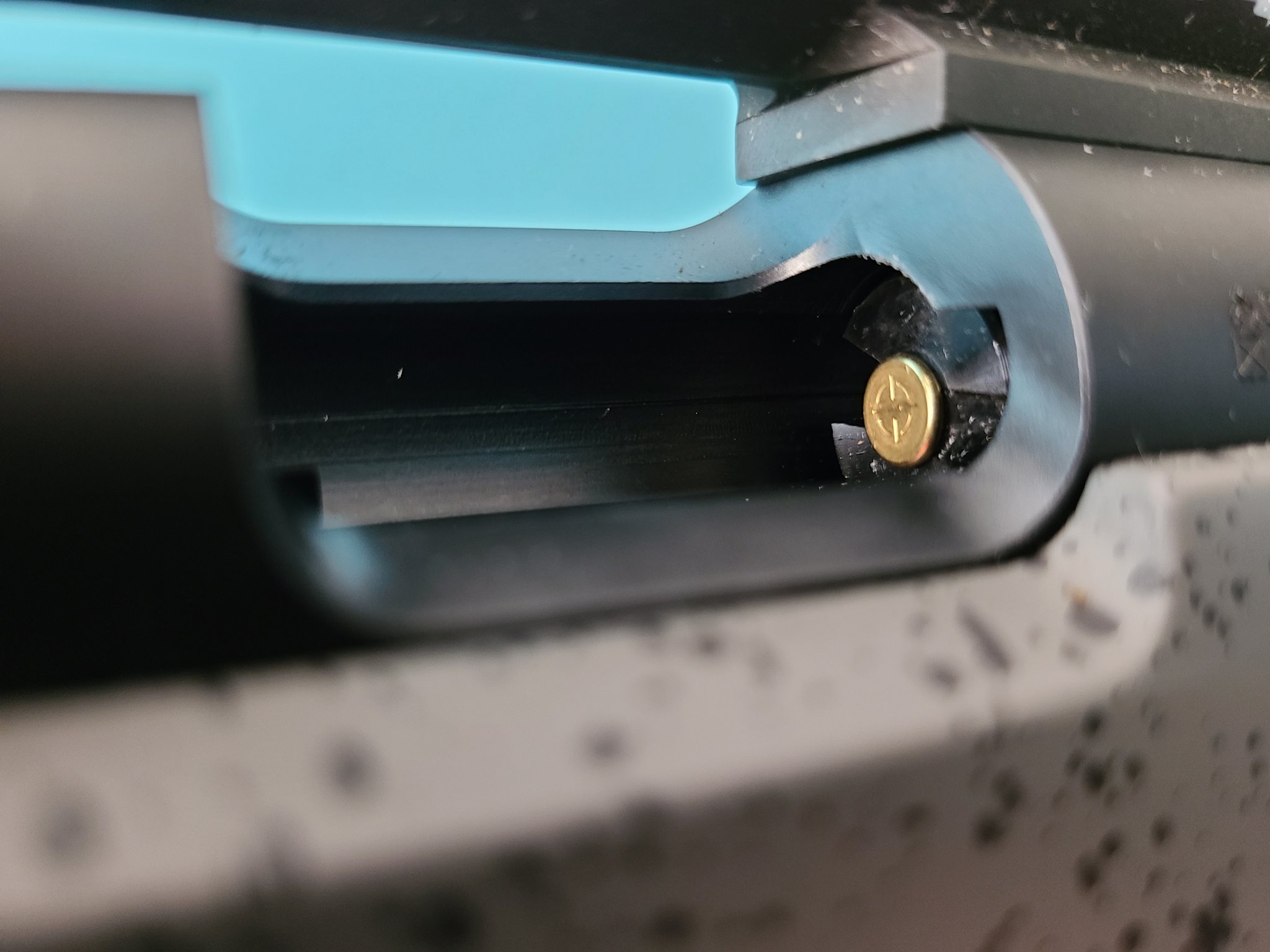

I spent this weekend working on a B14R that was having all sorts of feeding and light strike issues. I hope that Bergara will get him taken care of but not sure how long it's going to be and if he'll be ready in time for the match in 2 weeks.
This is good to know, I know any manufacturer can and will have issues, no matter how bulletproof their products may seem.Pretty sure I was the fella with the Bergara that you helped diagnose (RFGC).

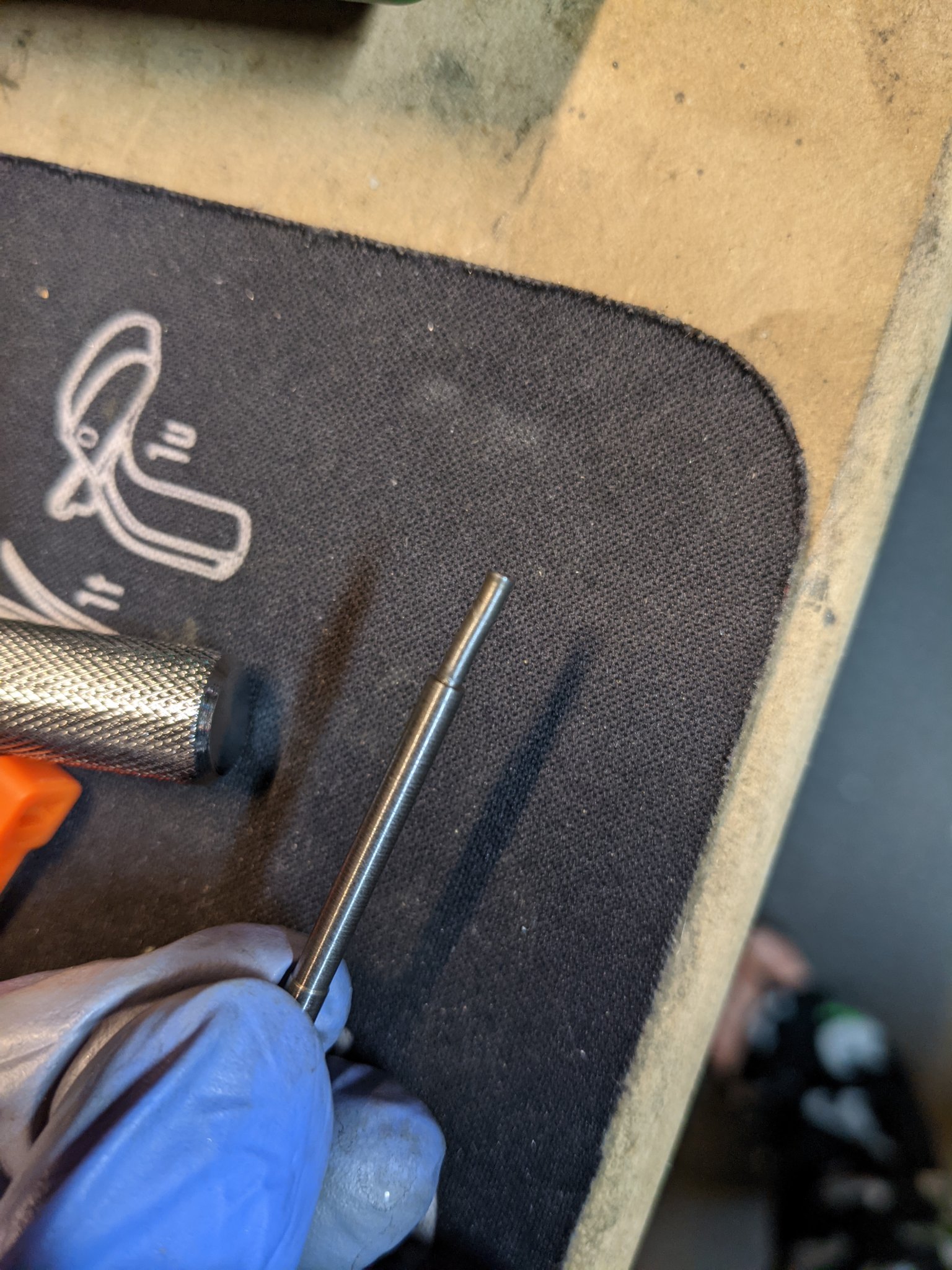

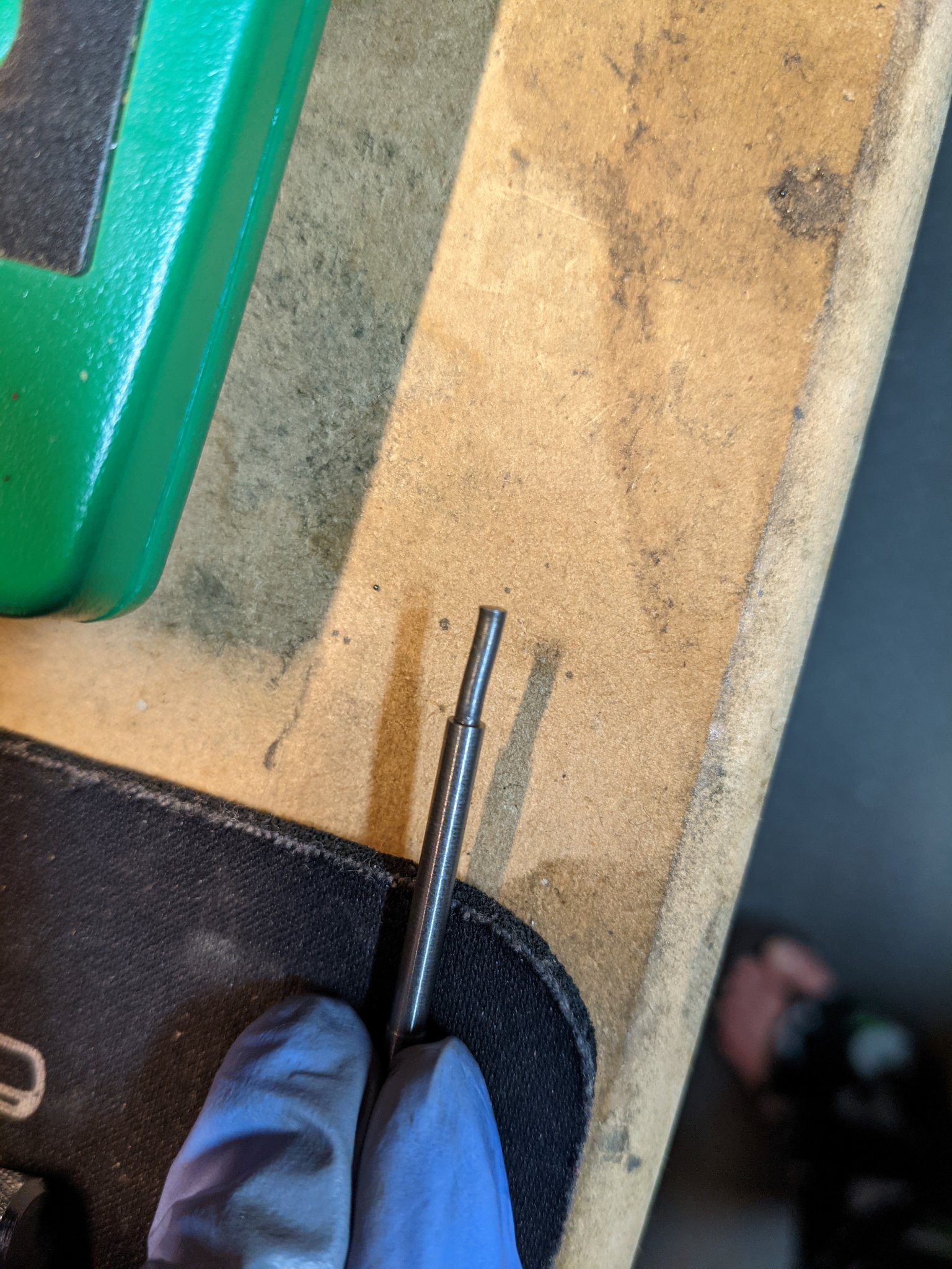

For the feeding issue: I went back to the factory mag latch. I also loosen the bolt by the buttstock and was able to push the entire trigger guard a bit forward. The mag seems to fit a lot more secure with little droop. I also cycled a few mags of dummies and they all Fed flawlessly.
For the light strike issue: I disassembled the bolt and, low and behold, found that my firing pin is bent like a pretzel (see pic). I've only dry fired with a spent casing. Emailed Bergara and they are sending me a few spares.
Not sure if all my issues will be fixed but I feel a lot more confident the rifle will perform as it should.

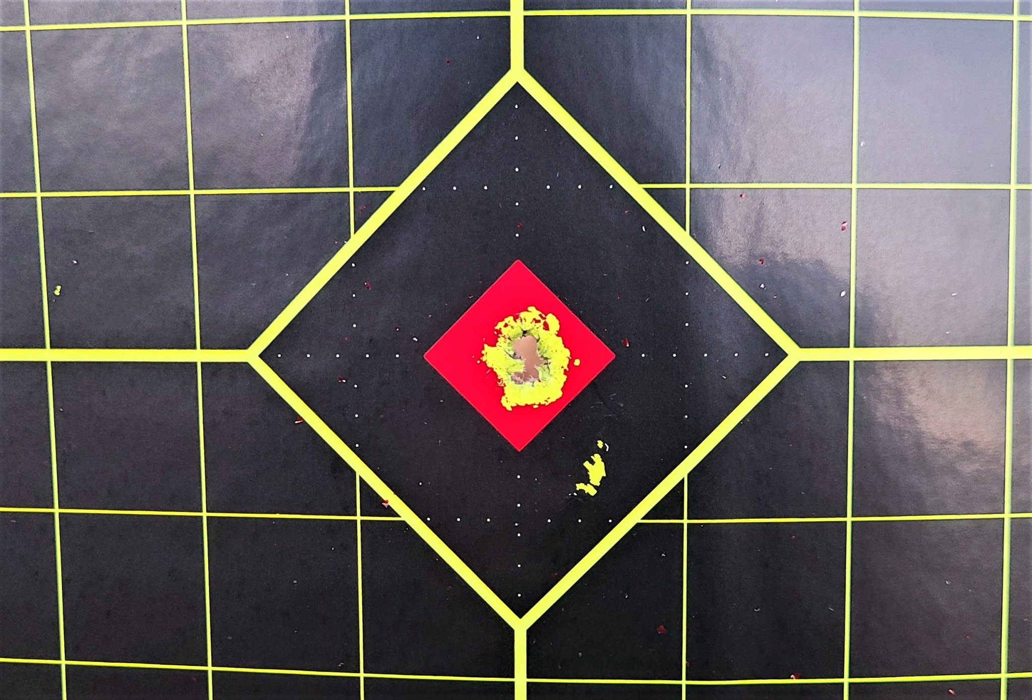

Appreciate your info, however, it is impossible for a .22 cal bullet to print less than its diameter...I have never shot a Vudoo. But...I was at the Lapua testing center in Mesa AZ. The test center had 3 vudoo rifles that were tested at the site. I can say with my own eyes, if I ever get the money, I will buy one. 10 shots at 50m in the test range. Vudoo has their own custom receiver holders at the range so they can test their rifles. I believe the group on 1 rifle was around .1 or .15 someone would have to chime in because I know someone here owns it. (I didn't take a picture and my memory sucks) Anyways, it made me cry after seeing those groups compared to my ruger 10/22 target. I will own a Vudoo one day.
edit - The true test of a barrel and action - since it takes human out of the equation. The test center also makes you fall in love with Lapua ammo.
what??Appreciate your info, however, it is impossible for a .22 cal bullet to print less than its diameter...
Must be your memory is slightly off, and I don't mean that as an insult.
Still, I'm sure that they shoot very well.
Take care
He's talking about center to center shot group. If all 10 shots grouped perfectly on each other your group size would be 0, or exactly your bullet diameter.Appreciate your info, however, it is impossible for a .22 cal bullet to print less than its diameter...
Take care
That's right, I meant the bullet hole could be no less than .22, a one hole group.He's talking about center to center shot group. If all 10 shots grouped perfectly on each other your group size would be 0, or exactly your bullet diameter.
electronic targets and apps like ballisticX make it easyThat's right, I meant the bullet hole could be no less than .22, a one hole group.
I don't know if I could distinguish the center of 5 or 10 shot groups of .1?...
Most use the edge to edge rule as stated above, then subtract the bullet diameter.
Still, I read this wrong, good info though.
I'm all for precision shooting, but not sure I'd call it less than a one hole group, but that's just me, lol...electronic targets and apps like ballisticX make it easy

my bergara action is not bad but who knows it is a roll of the dice. The Only take home is their is no “vudoo panacea”.
