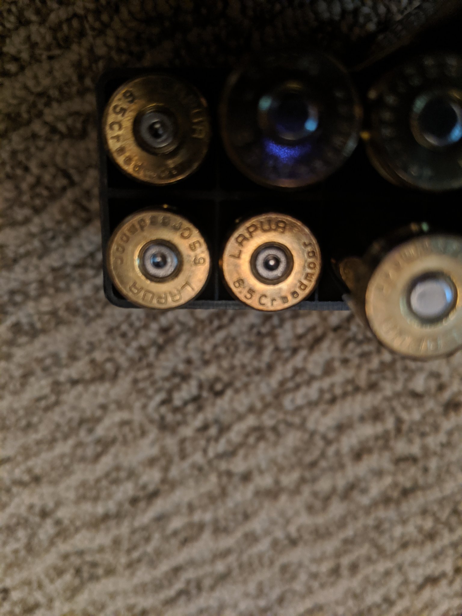

Was wondering if anyone has experience with this ammo. I was thinking of trying it but it cost about $5 box more than the GMM 6.5 with the berger 130's I have been shooting. I have heard it is loaded with Lapua brass and if so would be well worth it for the extra but have not been able to find hard data confirming. Can anyone confirm. it is Lapua Brass?
Definitely lapua

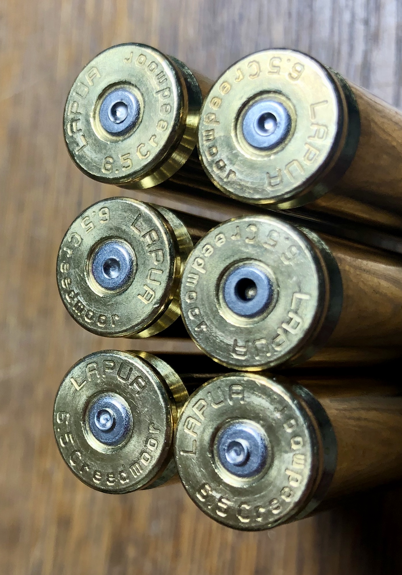

I recently did some testing with the Berger 140gr hybrid loaded 6.5CM. The raw data is in this thread on post #27. Now that Berger and Lapua are the same company all their loaded ammo is in Lapua brass. The 6.5CM that I used was small rifle primer.

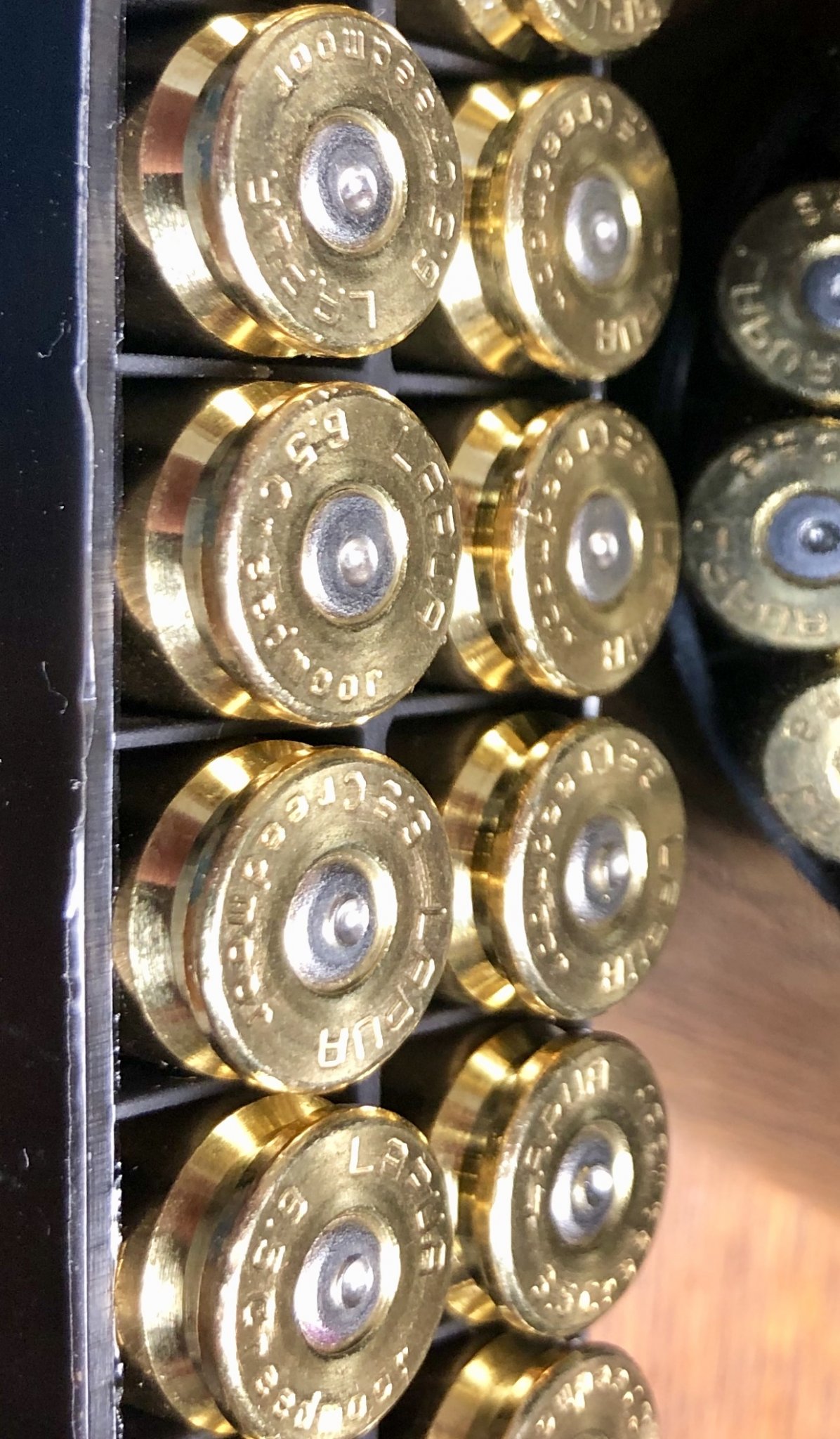

Awesome ammo. I buy boxes everytime I want new brass. As stated above, even at 1.60 per round, that is less than you can buy the components.

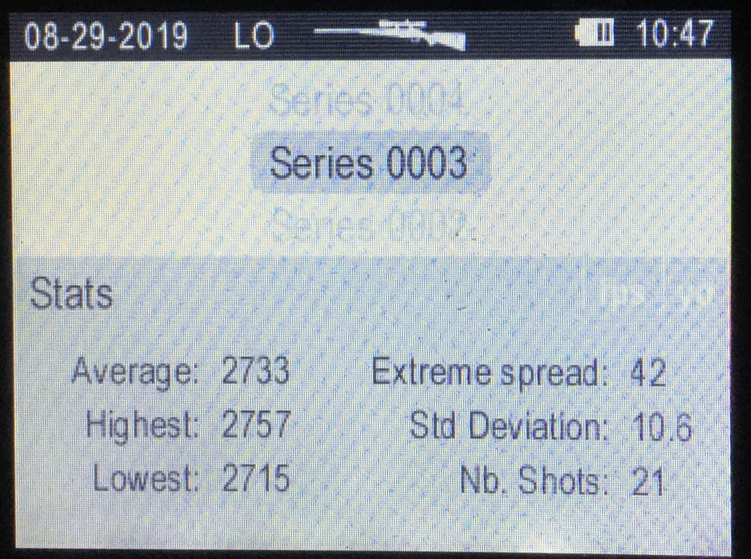

I shot two cases of Berger’s 6.5 Creedmoor 140 Hybrid Match Loads. They were from two different lots P001500 & P001535). The barrel is a 22” Proof CF LSC.
MV measured on a single Labradar averaged 2733 fps at temps in the high 70s to low 90’s. Elevation < 100’. It shoots sub MOA. The P001500 lot seemed a bit faster.

Data from a broken in Proof CF 1:8 22" barrel. Lot 1500 and 1535.
Total number of shots
21​
Stats - Average
2733.04​
fps
Stats - Highest
2756.58​
fps
Stats - Lowest
2714.89​
fps
Stats - Ext. Spread
41.69​
fps
Stats - Std. Dev
10.63​
fps
