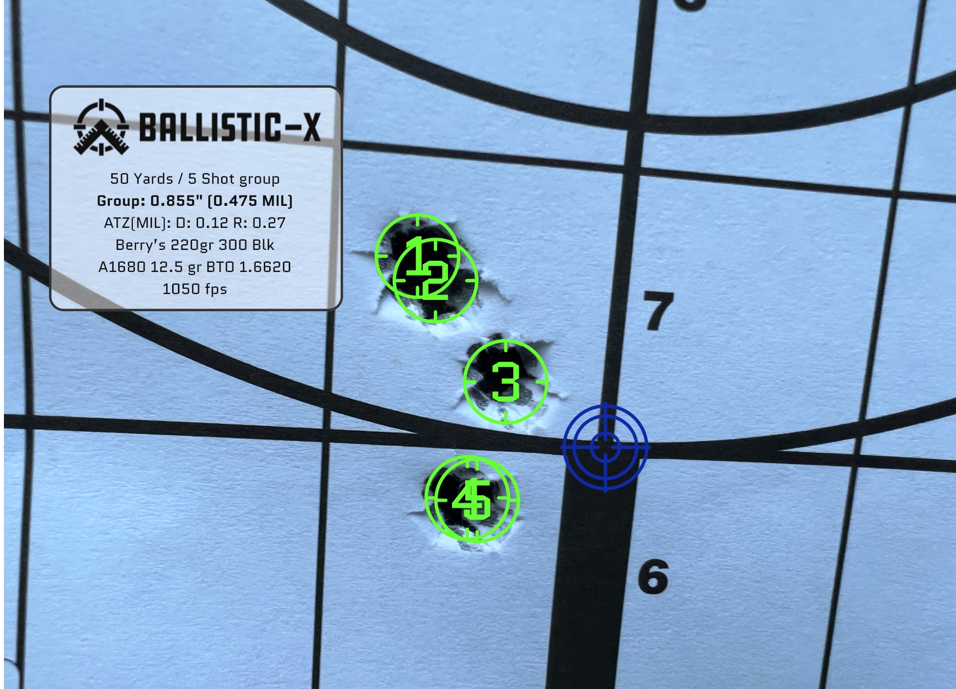

    My experience at 50 yd with Seekins 8” suppressed Omega 30.
    Magnetospeed V3
    Berry’s 220 gr .300 Blk SP
    10/18/21
    69 F 28% 30.07 mmHg
    A1680 10.8 gr
    BTO 1.6620
    955, 939, 930, 954, 920 SD 15.1
    1” (0.5” 4 shots)
    11.0 gr
    920, 942, 940, 924, 951 SD 13.0
    1.25” (4 shots 0.5”)
    11.3 gr
    942, 1009, 968, 983, 985 SD 24.6
    1.5” (4 shots 0.75”)
    11.5 gr
    993, *1064, 971, 987, 988
    11.8 gr
    1007, 1039, 1000, 986 SD 22.4
    1.5”
    12.0 gr
    1040, 1035, 1010, 1010, 1007 SD 15.7
    1” (0.75” 4 shots)
    12.2 gr
    1019, 1063, 1044, 1031, 1032 SD 16.6
    1.25” (1” 4 shots)
    12.5 gr
    1038, 1057, 1039, 1067, 1038 SD 13.4
    0.855” x 5 @ 50 yd

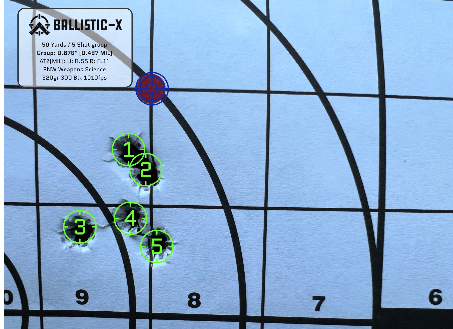

    Pics in comparison to PNW Weapons Science 220 gr factory ammo
    220 gr
    1064, 1004, 1007, 1016, 1002, 1039
    1007, 1007, 998, 1020, 1044
    0.876” @ 50 yd

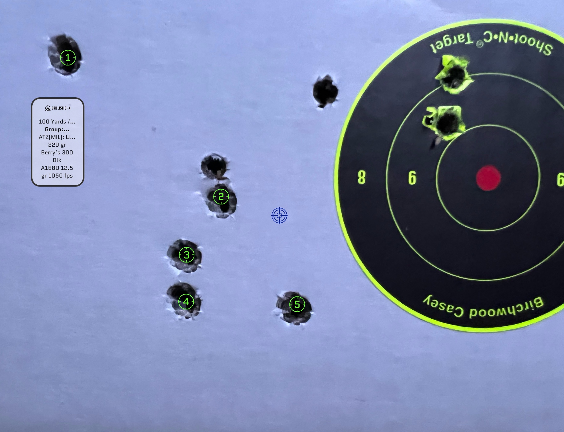

    They have some visible defects, which I thought was odd , but didn’t seem to affect performance too much for plinking. I hit 10” an 12” steel consistently out to 150 and 200 just for fun.
    I load them for plinking subsonics in my 16" .300 BLK AR. I use Alliant PowerPro 300-MP and CCI 450's in cut-down 5.56 cases. In my .300 BLK I'm getting 1" or less 3-shot groups @ 100 yards on average. But it spreads pretty vastly when I step it out to 200. It still shoot 5-6" groups (which is more than enough to hit steel), but nothing like my precision subsonic load did with Berger 210 VLD's, 300-MP, and CCI 400's. It was tack-driving them at 200. But, for the price, it's hard to beat the Berry's 220's when you catch them on sale for $119 a box (500).
    You shooting those Bergers supersonic?
    Shit... 😮 At 100 yards with Berry's 220 sub load, I'm putting 3 inside a 1" red dot all touching...
    Like I said in the above post, once I step out to 200 yards, shit starts gettin a bit wild. Shooting 4-5" groups. But it would still "do the job" if I had no other tools with me, and I had to reach out to 200.
    The 100 yard target appears have impacts that look like they are key-holing. Specifically the 5 shots marked. Anyone else notice they almost look like 2 impacts per hole? (Shots 1 , 4 and 5) They have a figure 8 appearance. What twist rate is your barrel?
