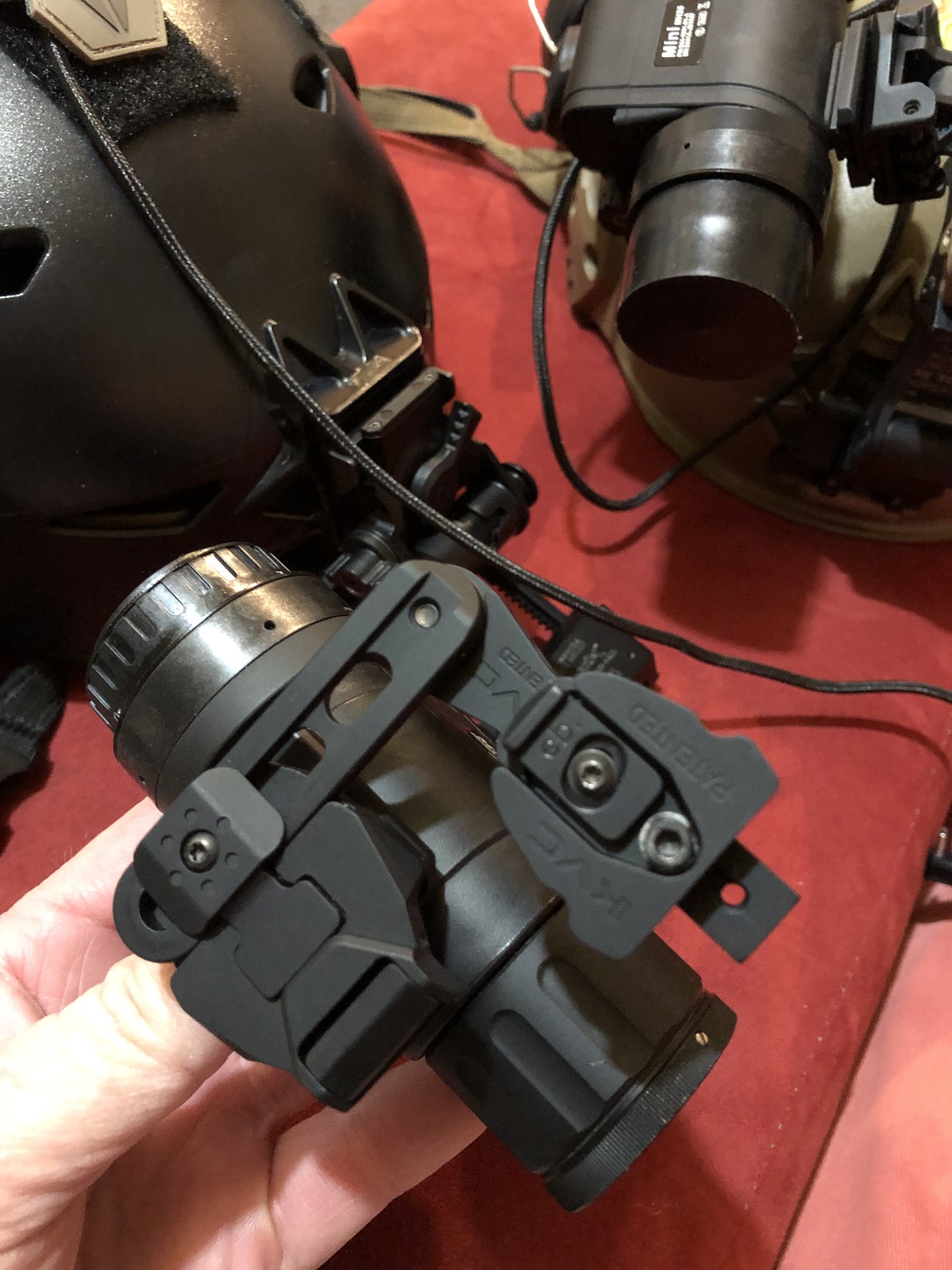

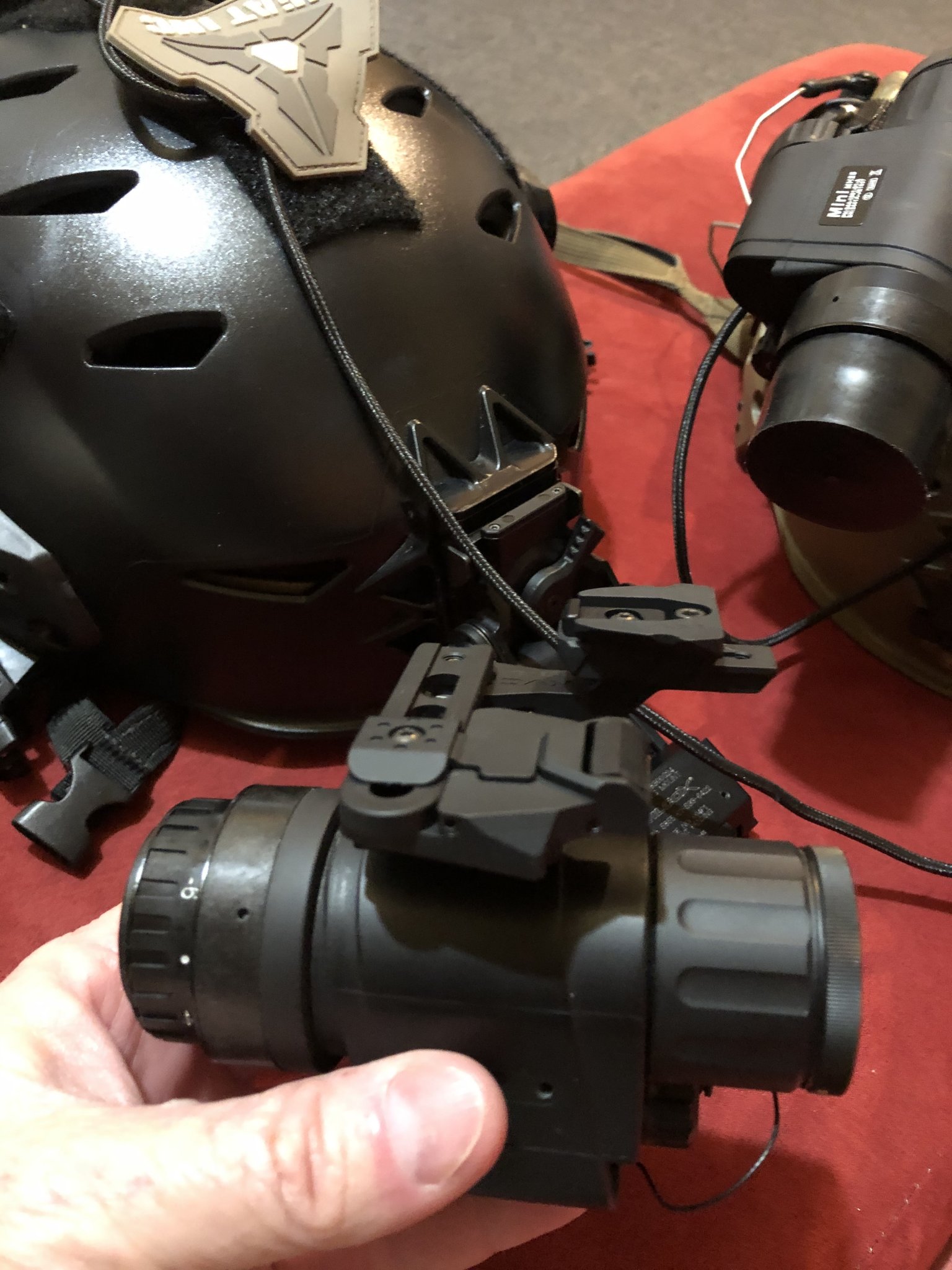

Is this sort of what you're saying?
and on screwYoutoobe:
Yes this is conversion and it will give you a little more forward adjustment over the G24 and should help. Nice to be able to just lift the arm as well and not have to push a button.
Thank You very much BamaSE. I really appreciate the effort you went through to post the pics.
I was about there. I was just skeptical of cantilevering the dovetail.
