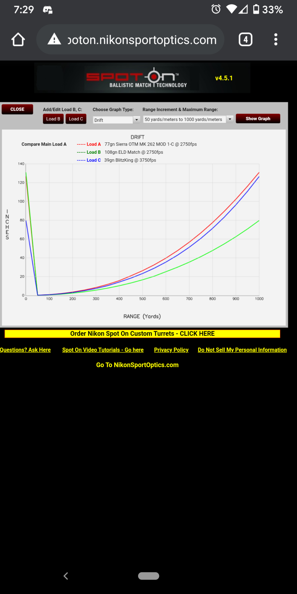

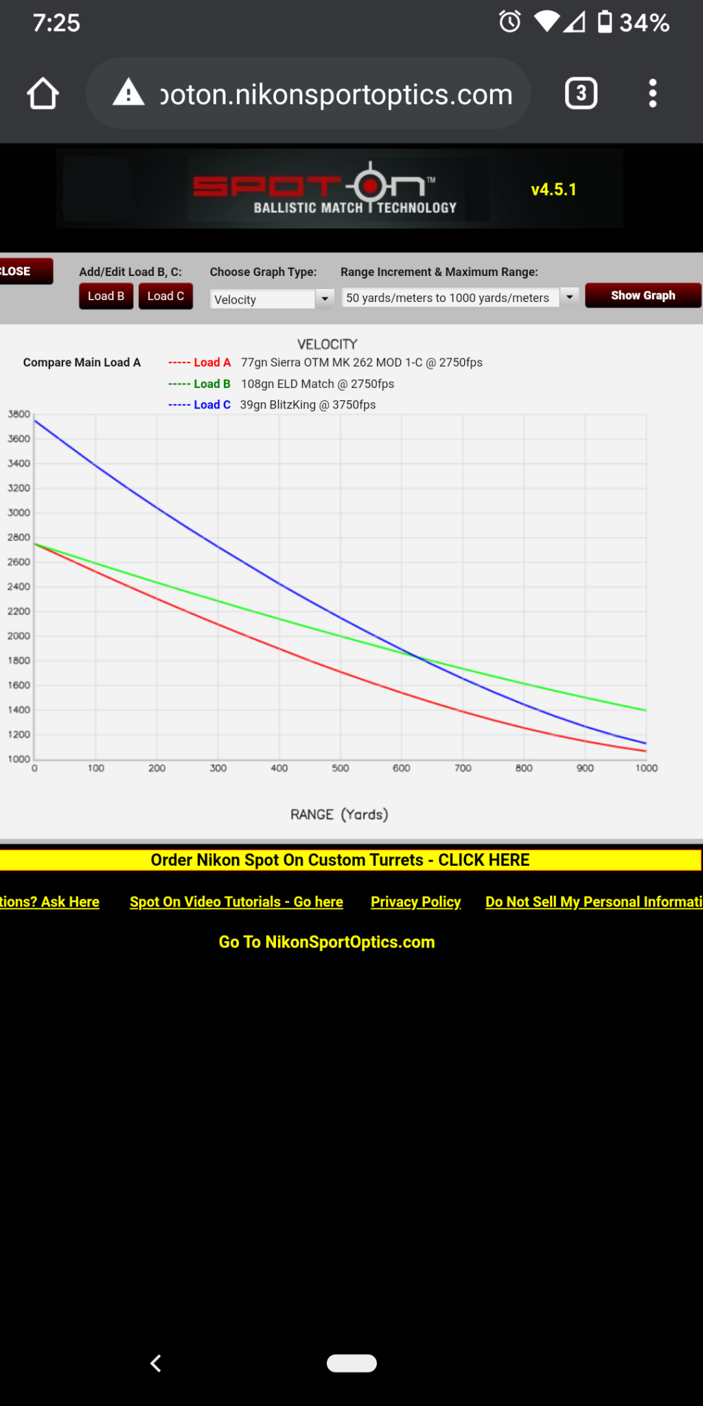

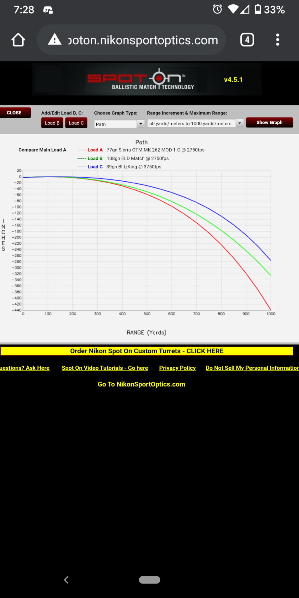

For parrie dog, 204 ruger all the way. Here is a bit of data on 204 vs 223 vs 6 arc. You could use a different bullet, but nothing is going to come close to that velocity advantage. It will blow around in the wind a bit more, buy nothing too crazy. 6 Arc would be the second choice, 223 is just outclassed by either of these other options.

Or instead of 204 you can go 20 Tactical (simple reforming of 5.56 brass). Ballistics are about the same, I get 3950 with a 40gr Vmax over Lever from my 24". FYI most of the advice and recommendations about the 20 Tactical vs the Practical are complete crap and actually backwards. The Tactical is a very easy single pass forming through the Hornady FL dies, which are available if you look around and you don't have to spend $150+ on a Redding bushing die unless you want to. Mine shoots about the same with freshly formed brass as it does with once fired; excellent either way. I'm just using LC 19 brass, and it loads about the same whether it starts as 5.56 or 20 Tac.
IMO regardless which of the 20 cal variants you choose, 400 yards is about the limit in any kind of wind. Inside that it's a laser beam, but the little 20 cal is pretty small for reaching out further. Nearly zero recoil and reticle movement though so it's a lot of fun to shoot.
The 6ARC will give you some benefits with wind. If “I” was going with a 6ARC, I’d get a 20-22” or longer to get the most out of it. I’d just make sure you get a quality barrel that is known to shoot great.
With that said, I can hit the 4” plate at 500yds with my 18” 223wylde pretty consistently if the winds aren’t too switchy. If going 223wylde, the WOA or Rainier Ultramatch will both shoot great. Having owned several RA Ultramatch barrels, I’d expect them to shoot below 3/4moa, and closer to half moa with a good load.
