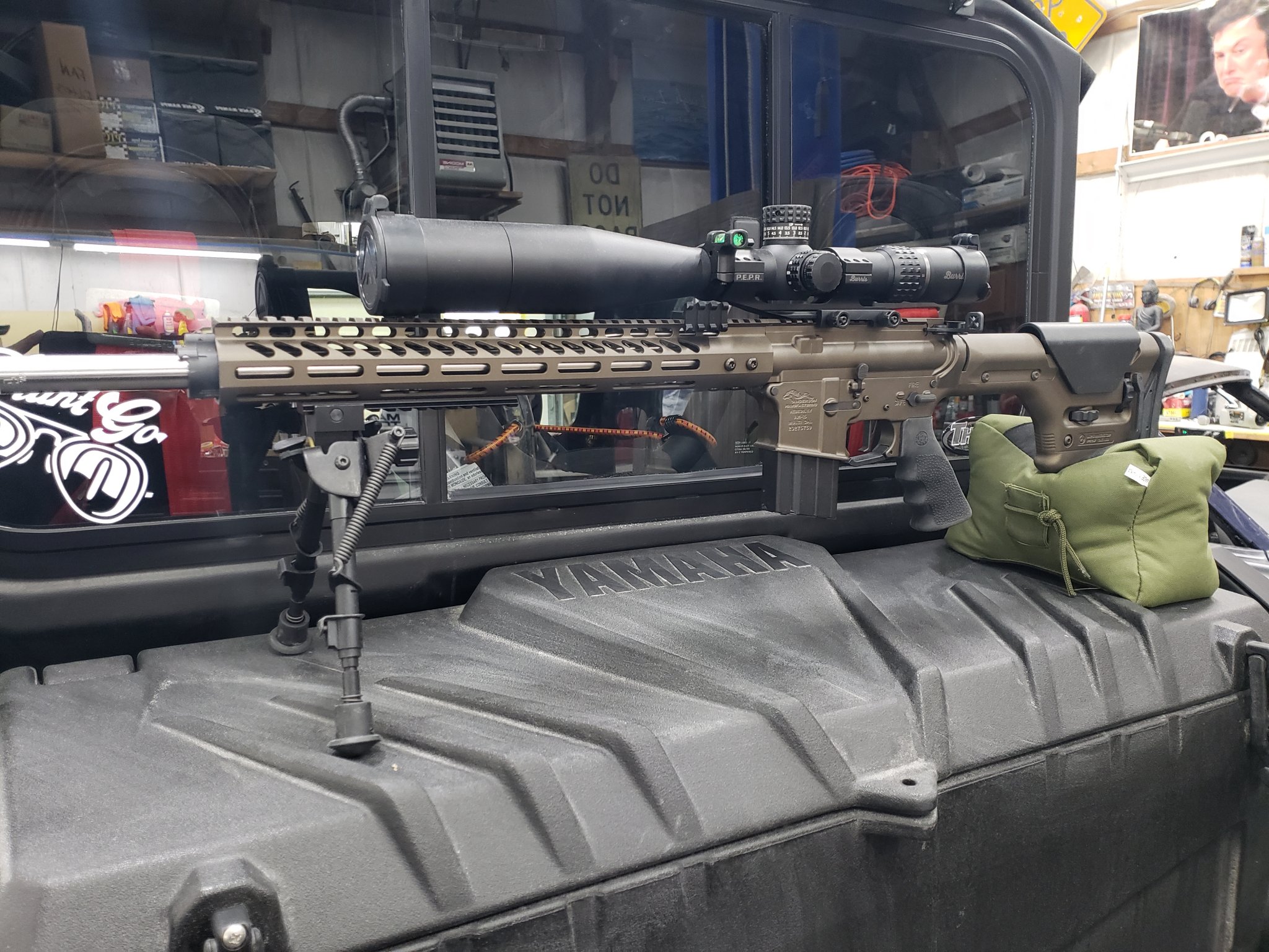

Valkyrie build teaser...all I'm waiting on is my muzzle device and I'll have it done with some pics!

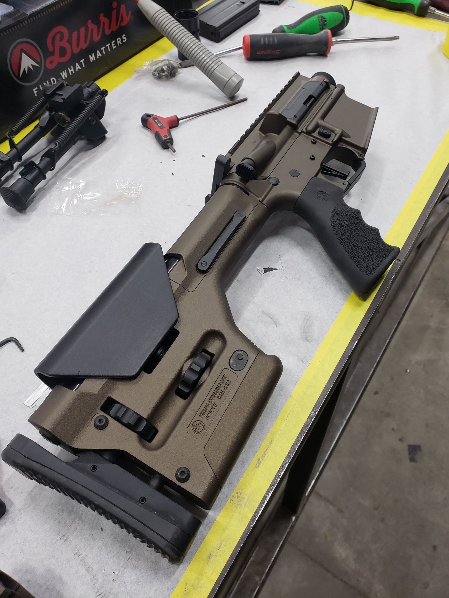

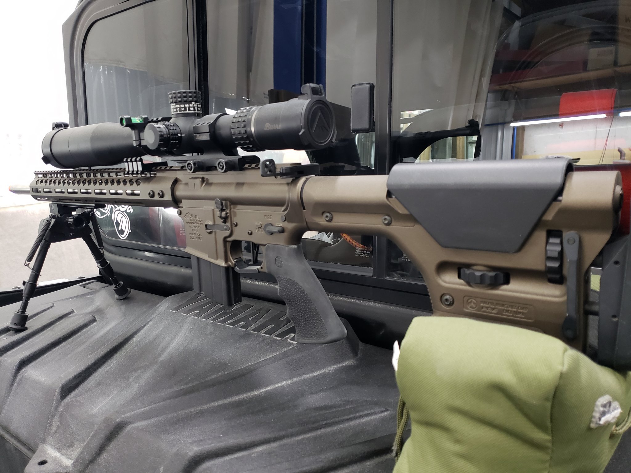

About done! Got a decent pile of factory ammo and plenty of components to start load development asap

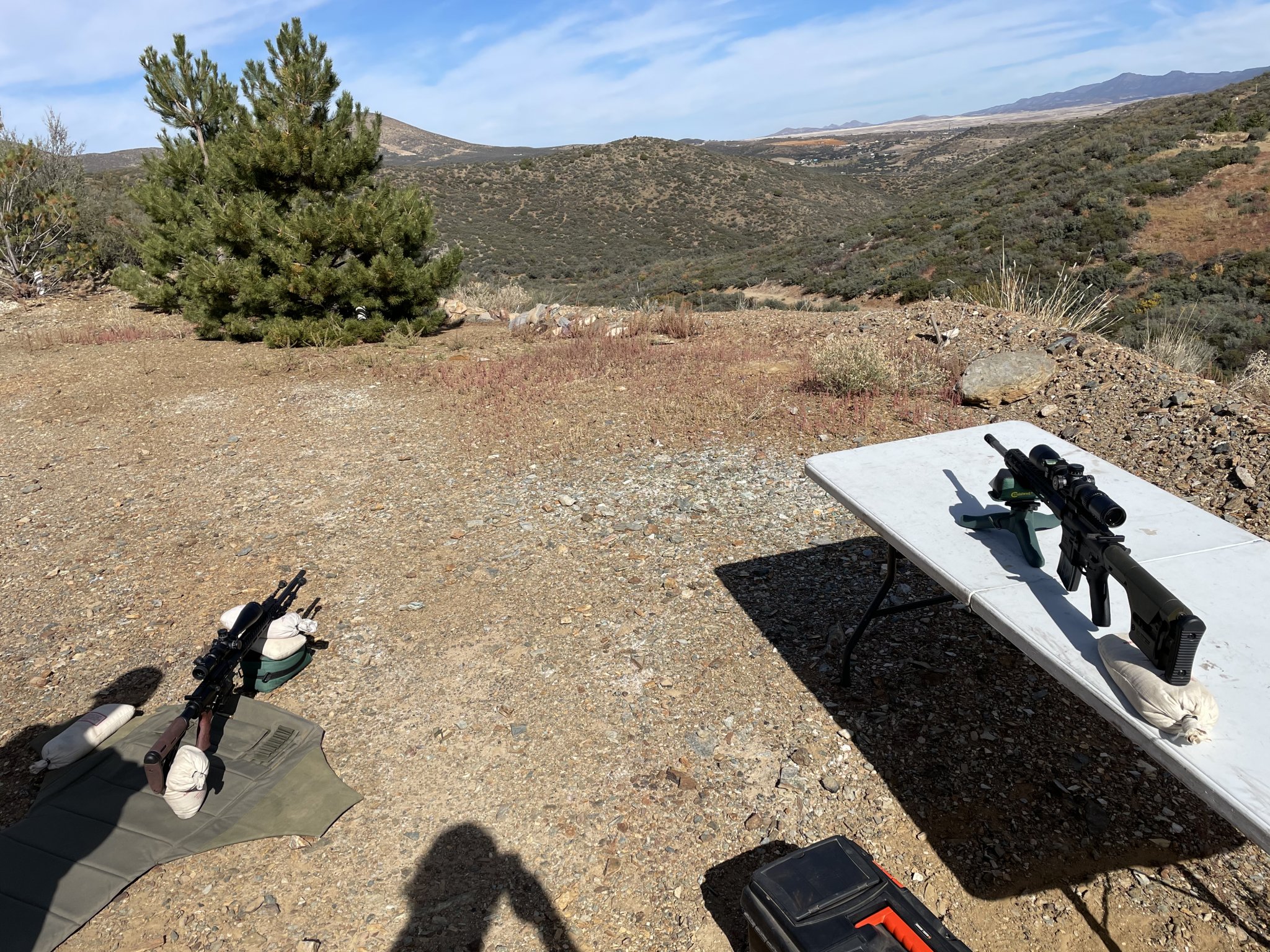

I assembled a 28"+2 22 Nosgar gasser (22 Nolser with necked down 6mm Hagar brass) for the wife to use slow fire prone.
It's right up there with flatness.
Confirmed dope with a 100 yd zero and Berger 85.5:
Muzzle velocity is right @3000 fps (LabRadar).
300 yd velocity is about 2500 fps (ShotMarker), dope is 0.8 mils.
600 yd velocity is about 2000 fps (ShotMarker), dope is 3.1 mils @ 75F, 1950fps and 3.3 mils @ 37F.
700 yd velocity unknown but with 4.0 mils can ring an 8" plate pretty easily/
Farthest we shot is a 2moa plate @ 800 with 5.1 mils, but that's a giant plate.
Calculator says transonic about 1300 (mach 1.1)
I'm using a +2 buffer and gas cut way down to just dribble cases out but still lock back.
Video of one shot, ejected case goes about a foot. Usually end up in the ammo box lid :)

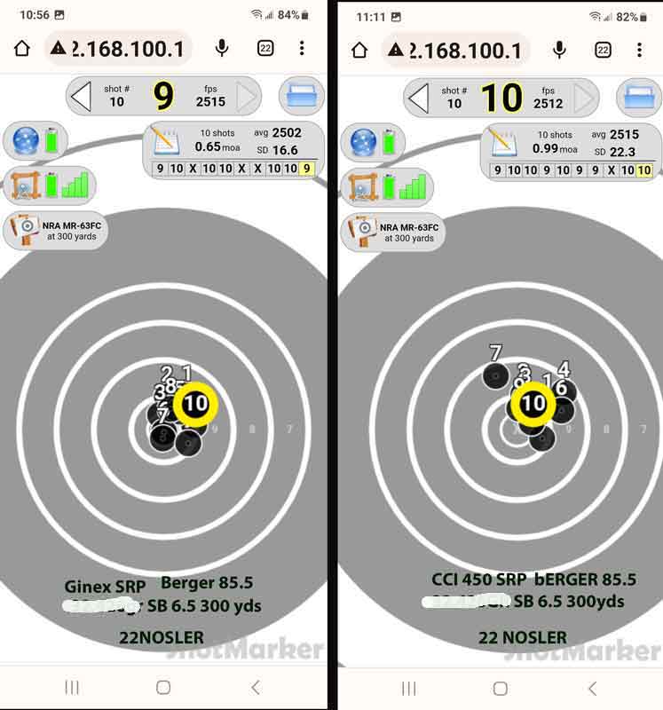

We be getting better. Here's 10 shots at 300 with Ginex primers and 10 with CCI 450.
Actually shot with my No-Gas AR using 22 Nosler/Dogtown brass.
Fat fingered the load in the pic. should be 32.46gr.
Damn Flyer :(
