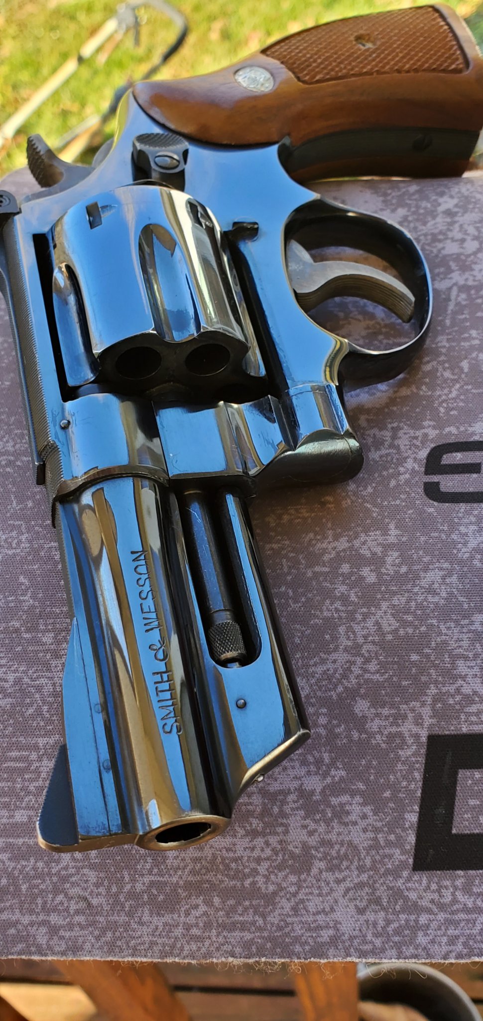

I've got a couple of older Smiths & the job they did on these guns back then (to include Colt as well) was just pure craftsmanship & artistry- absolutely made for generations of use. That being said, a thin coat of oil & checking them once a month or so will do the job imo
'68 27-2 & '77 27-2

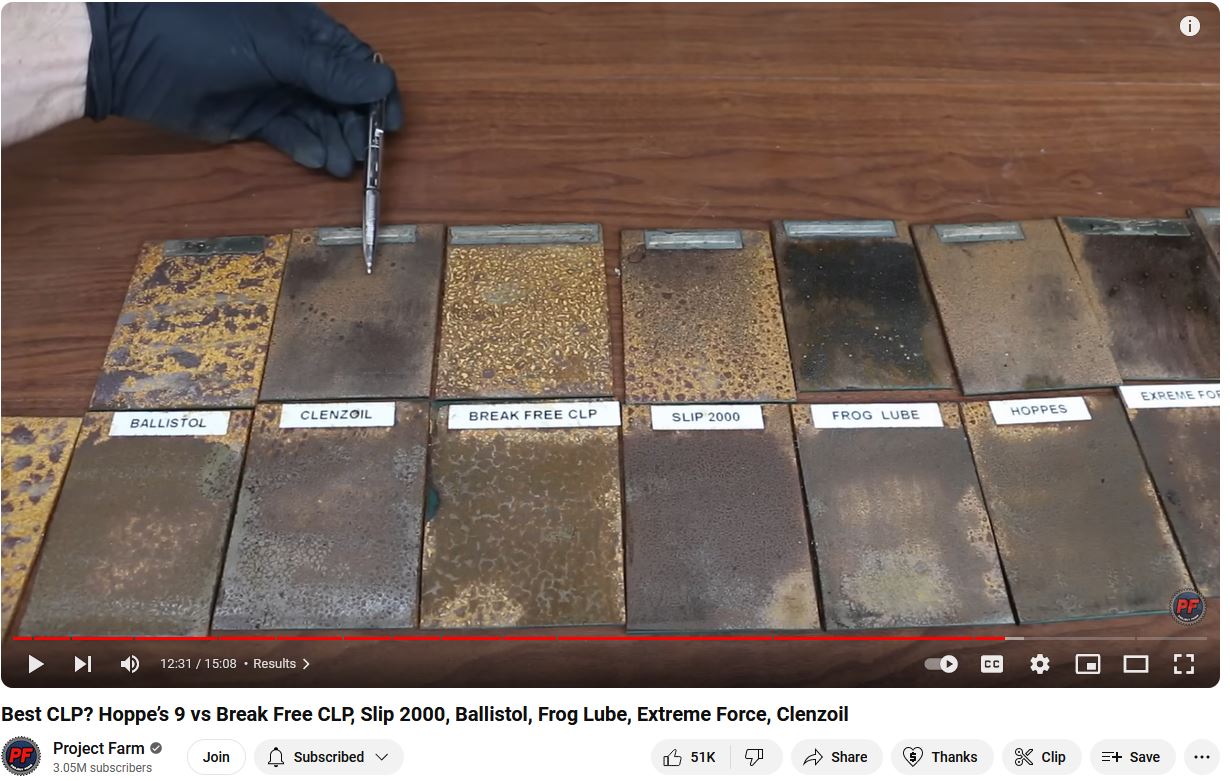

Project Farm did a test. Seems like Ballistol isn't as good as Clenzoil as a corrosion protectant. The top plates are after the heat test.
If you watch the rest of his testing, the wear scar test shows Clenzoil beat out the other samples here with Break-Free CLP coming in close second.
