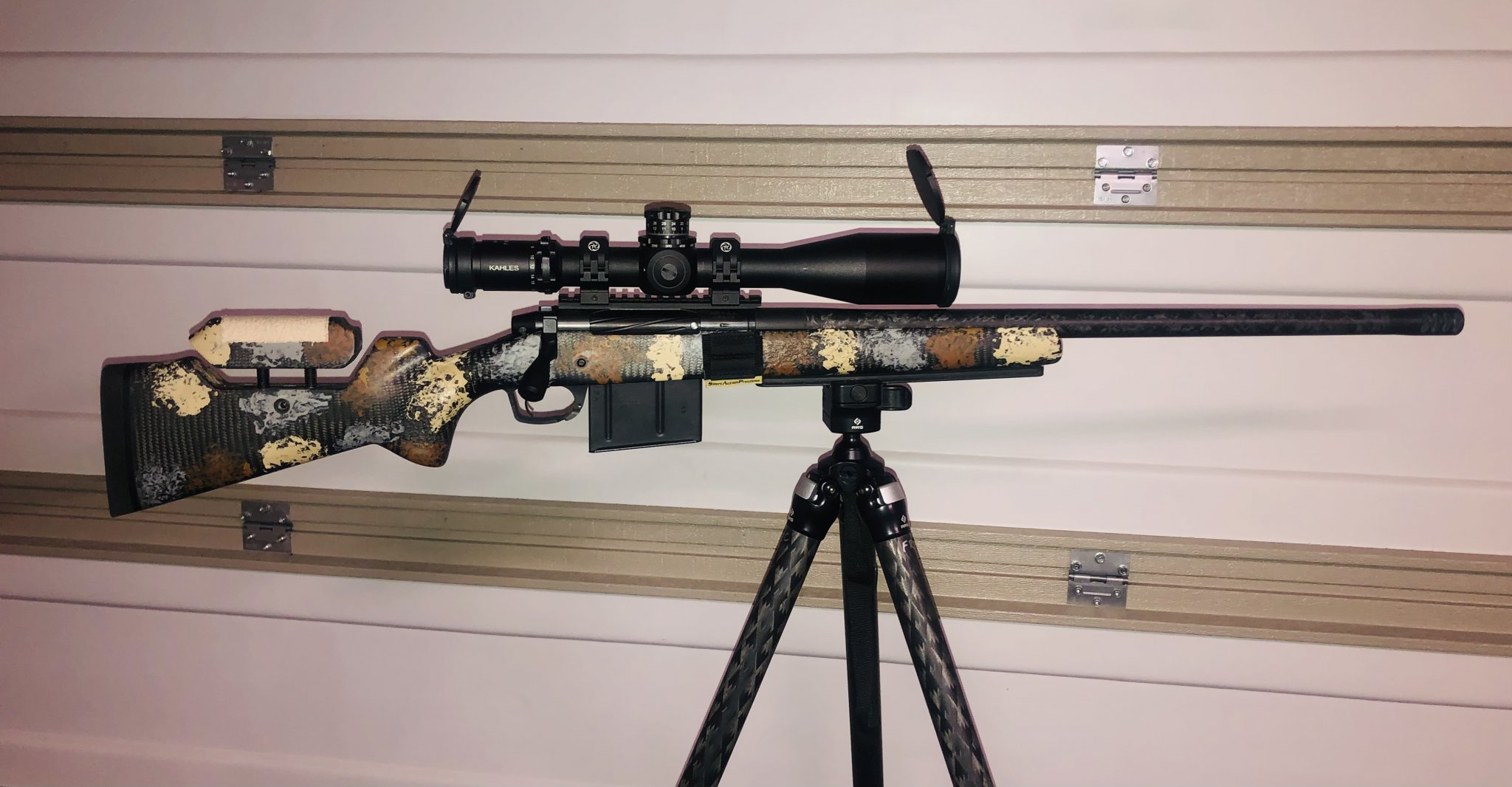

Built for the father inlaw. Fun rifle to shoot and a tac driver. Minus the scope being second focal plane and the trigger being heavier than I like but it wasn’t for me so there is that.

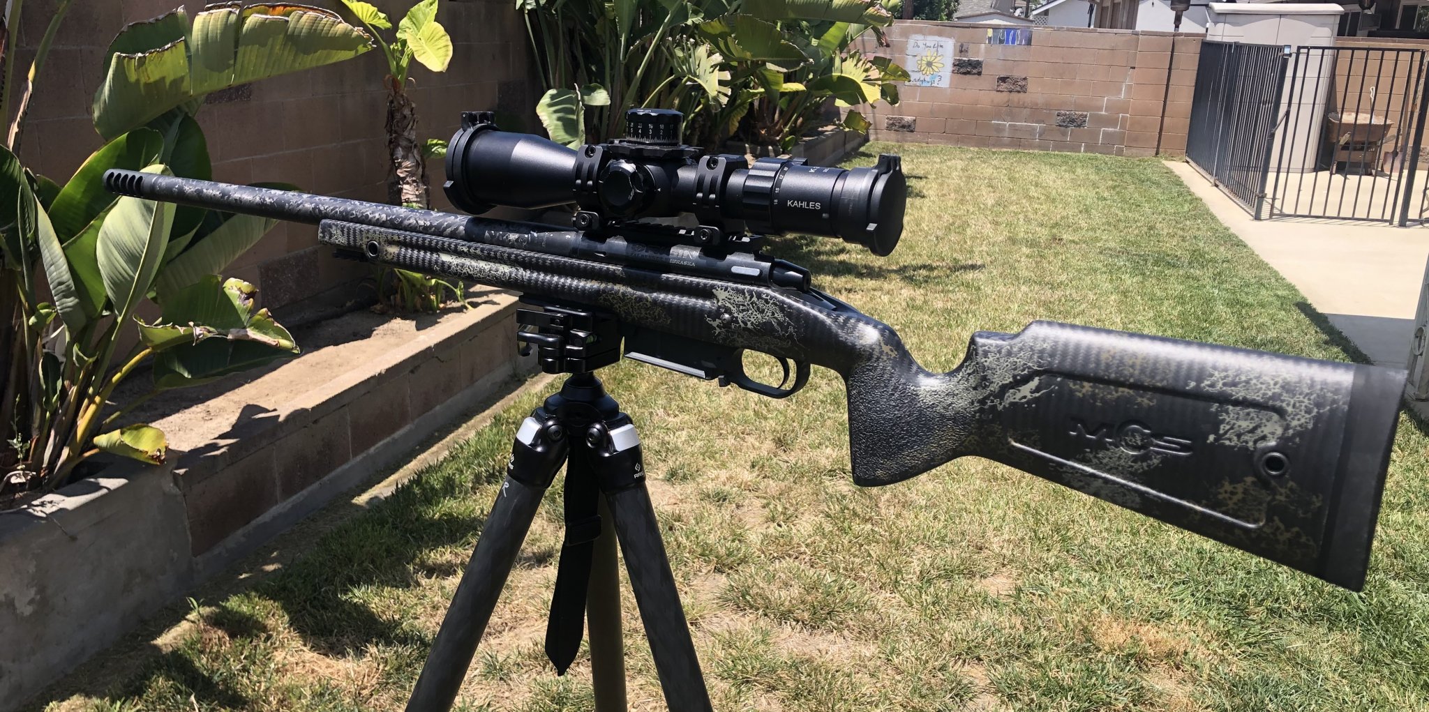

6.5 PRC
Bighorn Origin SA LH
22” Proof 1:8
TT Diamond
Mesa Altitude Stock
ARC M Brace Rings
Kahles 3-12x50

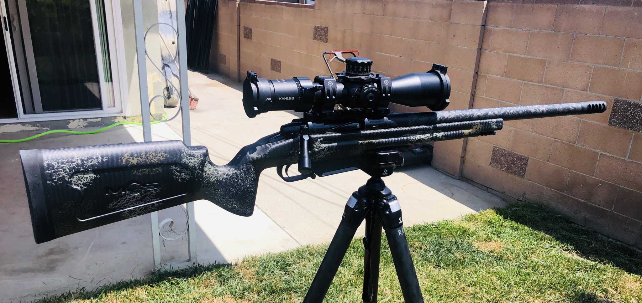

308 Win
Bighorn Origin SA RH
20” Proof 1:10 w TiPro3 Brake
TT Special
Manners EH1 w/ Mini Chasis
ARC M Brace Rings
Kahles 3.6-18x50
7mm Rem Mag w/ +P Chamber
Bighorn Origin LA RH
24” Proof 1:8.4 w DE Mini Slab Brake
TT Special
Manners TA w/ Mini Chasis
ARC M Brace Rings
Kahles 6-24x56

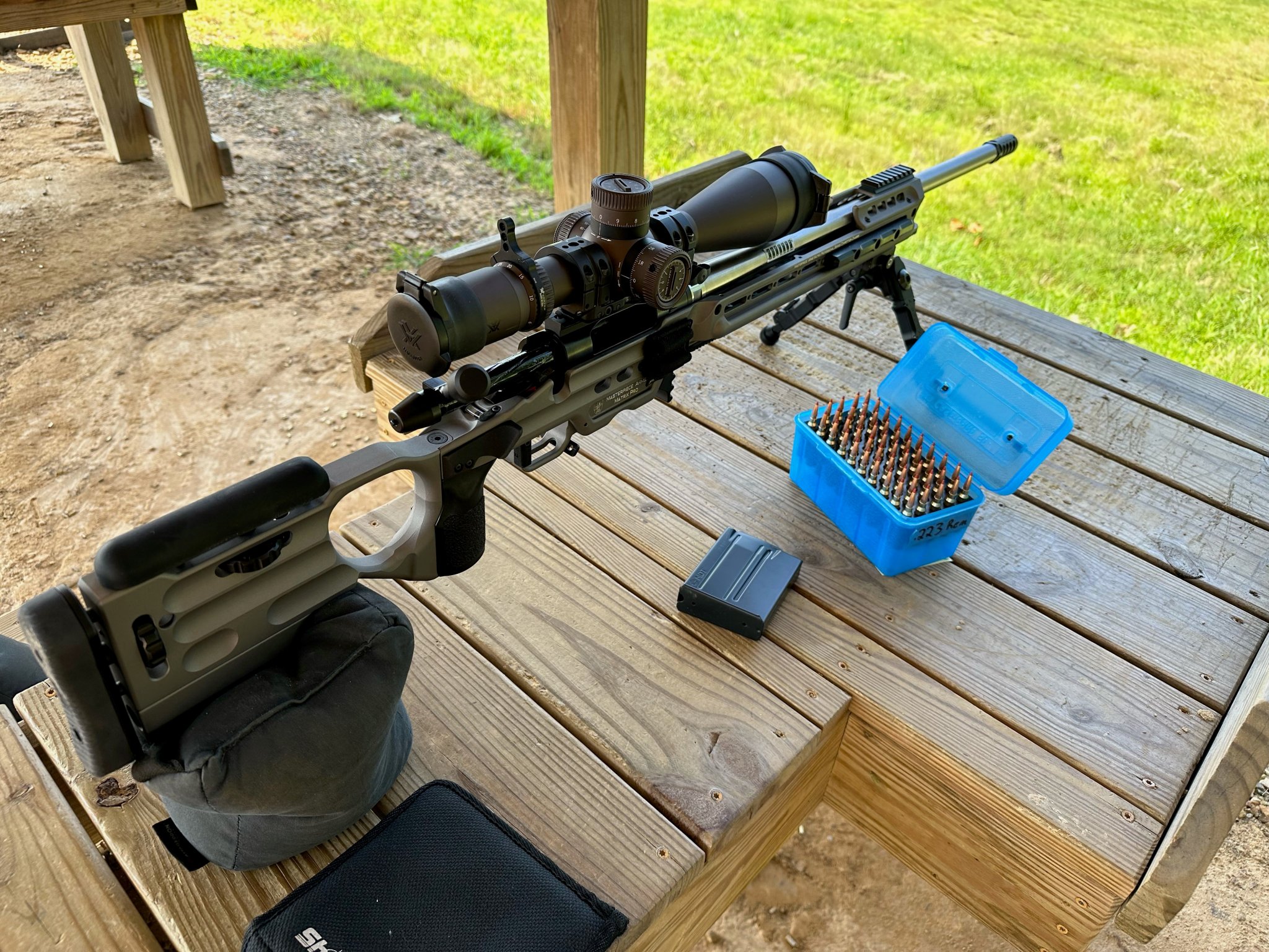

Swapped out the Mannera EH1 on my Origin 308 for the Manners Pro Hunter and I’m glad I did. Hands down my favorite manners stock to date. light and ergonomics are on point .got one coming for my 7RM now too.

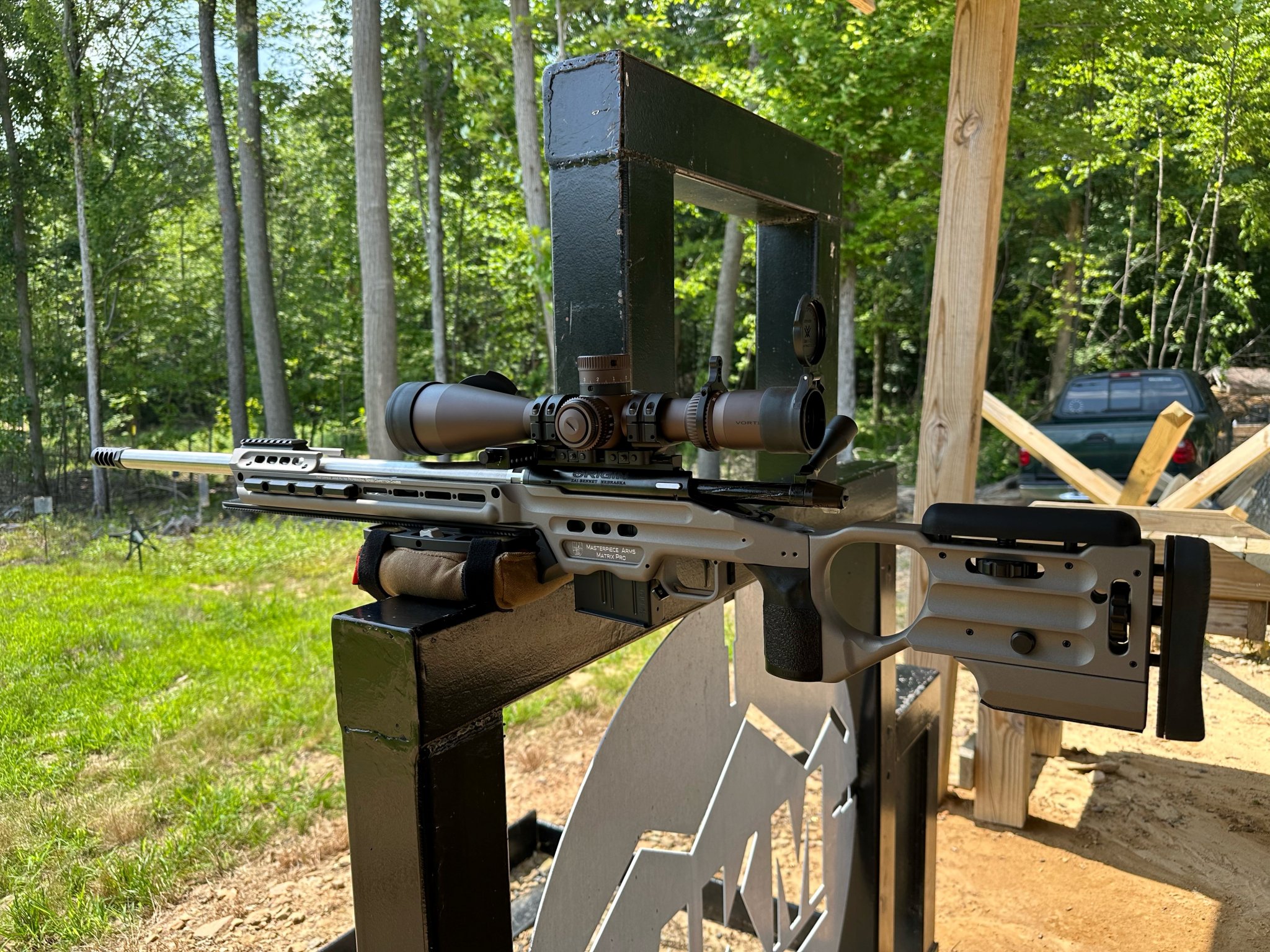

The newest iteration of my bighorn origin action, foundation dominion stock, hawk hill .257 cal 7.25 twist marksman contour spiral fluted 25 creedmoor barrel, area 419 brake, Timney HIT trigger, Hawkins m5 dbm, Hawkins 35mm low ultra light tactical rings, Leupold M5 3.5-18x44 scope. Great little all around rifle.
Just a quick update on my .223 PRS trainer rifle. I was able to get out to the range yesterday and get the first rounds through this rifle and get the scope dialed in. I have not done any load development yet, I just picked a load and ran it. I'll wait until I get more rounds down the barrel before I do any load development. Even with a random load, it performed well and looks promising. I picked 24.0 gr of Varget with the Hornady 75 ELD-M, Starline .223 Rem brass and a CCI400 primer. After an old school bore sight, the first shot was just a couple inches left of the center so I sent 4 more to make it a 5 shot group. I was also cleaning in between each of the first 5 shots. I dialed the scope a little to the right and then shot another 5 shot group. I was shooting modified prone off a bipod on a bench with rear sand bag. The first group was .58 moa and the second group was .48 moa. I couldn't be happier with a random load.
After this, I shot the next 40 rounds at various steel plates at varying distances and also practiced the PRS barricade skill stage. The MDT metal magazines performed flawlessly. I'm usually a 60ish second guy for the PRS barricade skill stage (8 shots from 4 positions at a 10 inch round plate at 400 yards). My first run with this rifle was in the 55 second range (8 hits) and the second run was 46 ish seconds (7 hits). I'm very pleased with this rifle and can't wait to keep shooting it and practicing PRS skills and techniques.

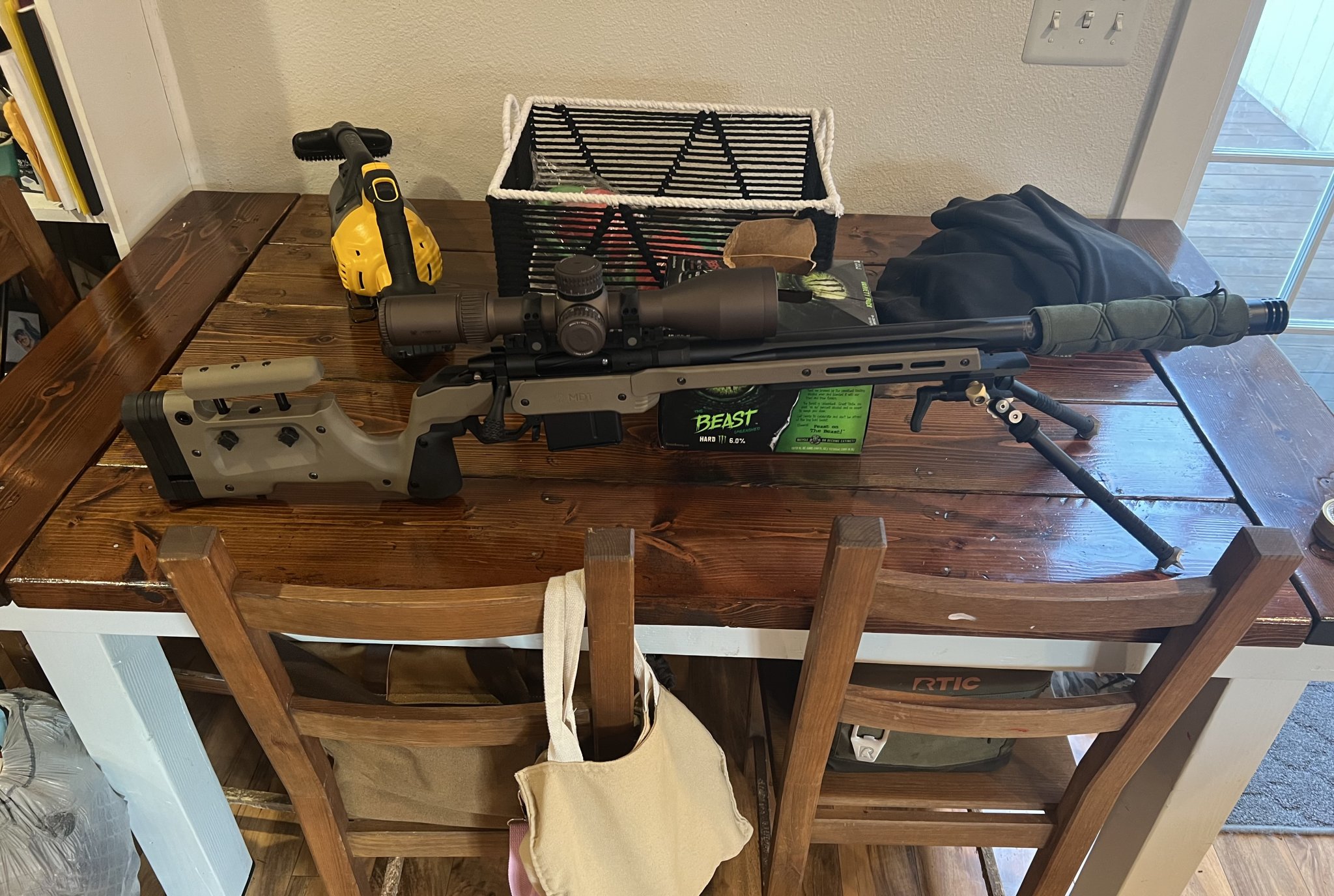

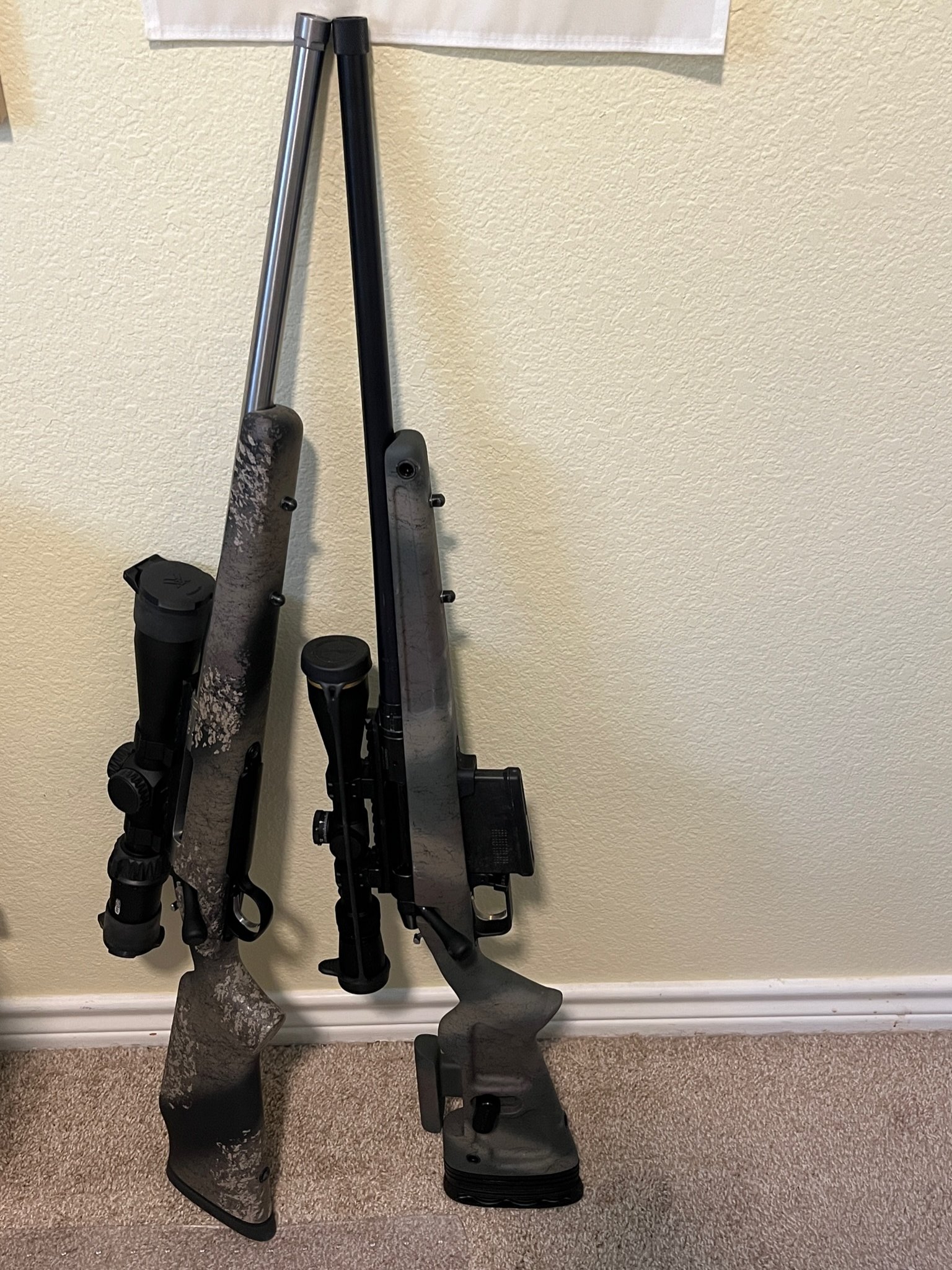

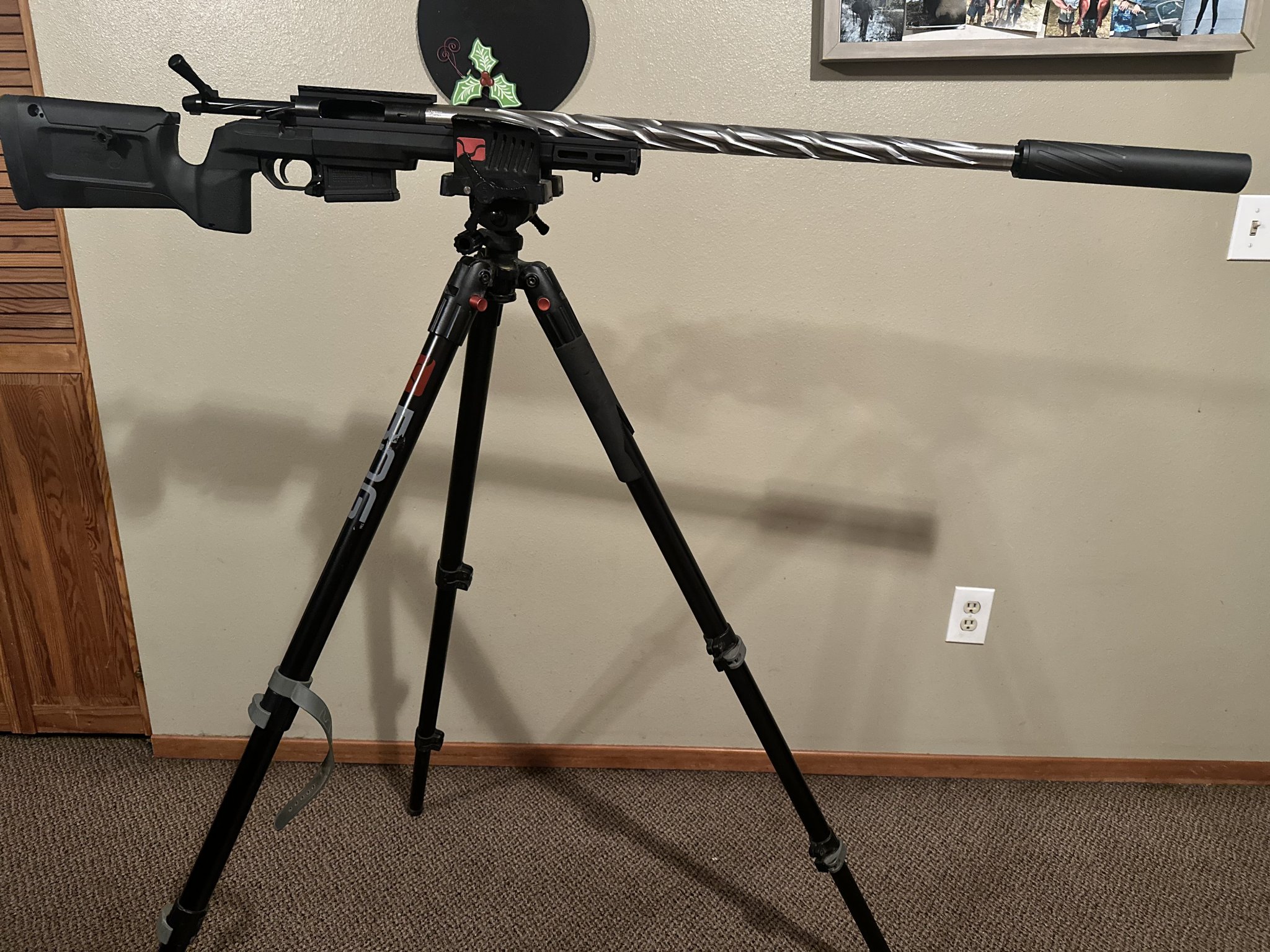

I apologize for the poor photo.
I started out with a black Origin action and a stainless 24" 280AI.
While it shot well, I did not like the weight of the barrel. Solution: get a black, 20" threaded 270 barrel.
Next, I decided the BDL setup was a PITA at the range and replaced the Grayboe Terrain stock with a Grayboe Eagle and M5 DBM bottom Metal.
Then, I realized I had a barrel and a stock laying around. Solution: (1) get the 280AI barrel cut to "20 and threaded. Buy a bead blasted Origin action?
Scope: I am not sure yet.
Next Project: figure out how to make the magazine rattle around so much.

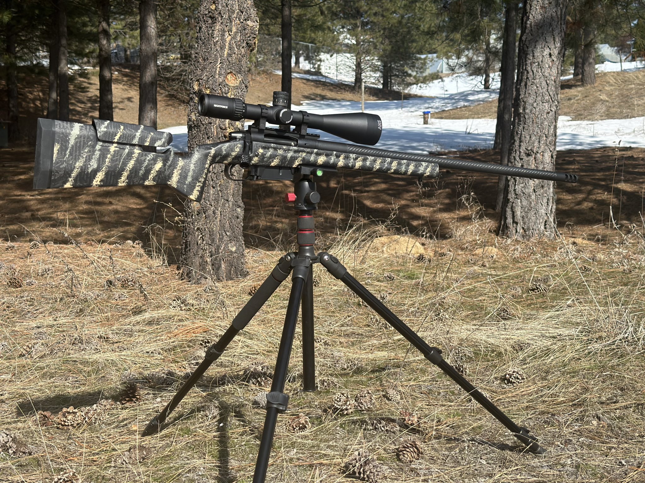

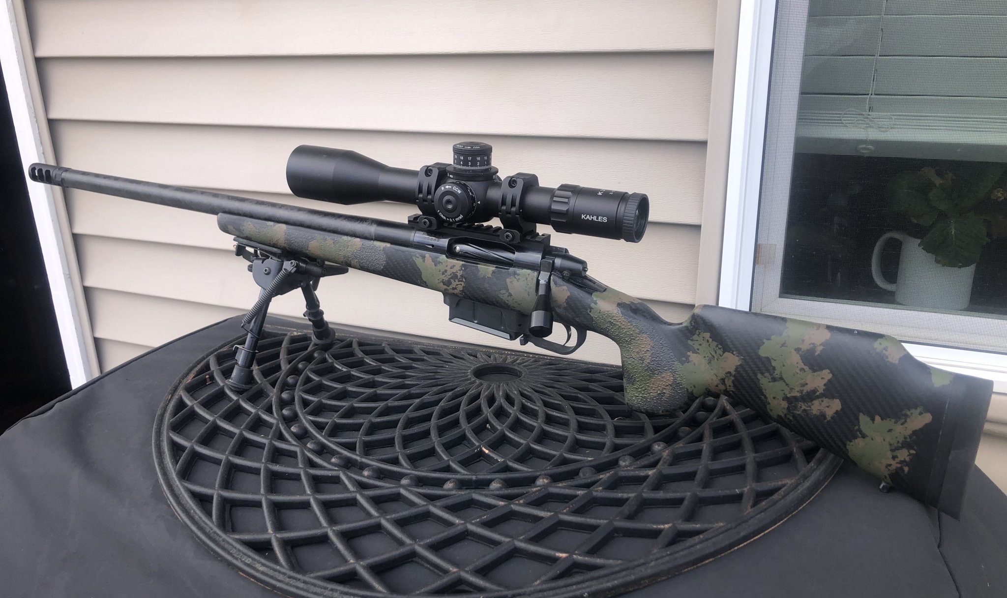

14.8 pounds as it sits
XLR Element 4.0 Magnesium
C6, folder, carbon grip
27" Heavy Varmint 7SAW
A419 Sidewinder
BnA Tacsport Pro
ARC M Brace rings
Zeiss S5 5-25
That a nrl heavy hunter build? I'm somewhere in the midst of that too, but need to get a 38oz triple pull in there, was thinking heavy palma.
Reactions: Bsnyder
Yup that was the aim. Lots of weight to lose between rings, brake and drop the folder too to get a triple pull on the front if I don't run an MTNGear. It's a 7# barrel so easy to cut weight from that too

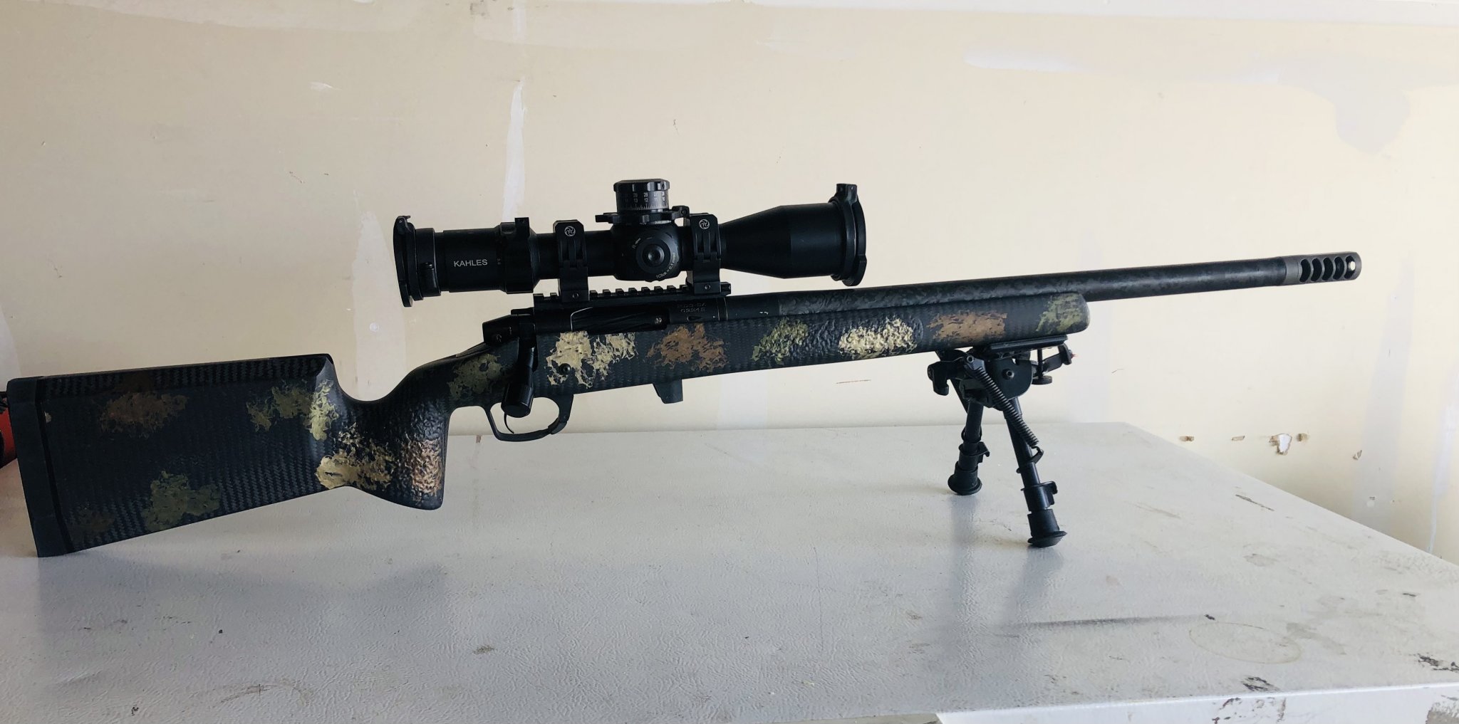

I'm excited to post pictures soon. Took a lot of information from many helpful members here, wanted to do it right.
My NX8 is on the way, and I'm going to order ARC Mbrace rings soon, once I get it mounted I'll take pictures and post on the thread.

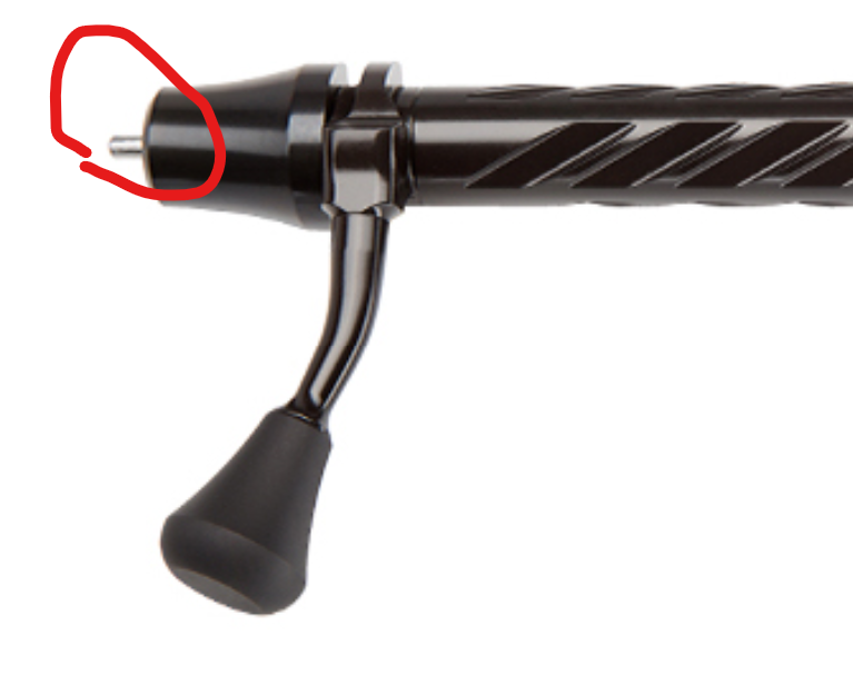

My bad, didn't wanna clutter the thread. My question was can I put an origin bolt in a Rem700 action. Completely new to the bolt gun world and trying to get creative with a build I'd like to do. Feel free to roast me as I don't know anything about non-gas platforms; would appreciate some knowledge on the different types of bolts / actions and why they can or can't go together.
Couple other questions if you don't mind answering:
1. Why does the Macbros bolt have this little pointy fella sticking out the back and what is it?
2. When Macbros says the bolt has toolless fire control removal, what part are they referring to and what is the benefit or difference?
3. What circumstances make control round feed better / worse than push feed?

1- that’s the firing pin. Sticking back is cocked, sunk in is released.
2- the firing pin and shroud piece comes out of the bolt by hand and doesn’t require any tools.
3- none other than poorly set up but I prefer it as I control when it goes out and not a spring as soon as it’s clear.
4- I would go with whatever the bolt comes with, doesn’t really matter. I wouldn’t pay to have a bolt altered to go from one to the other.

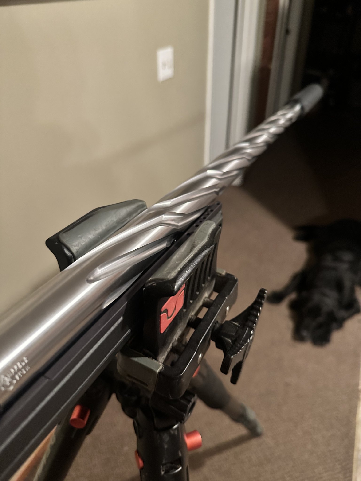

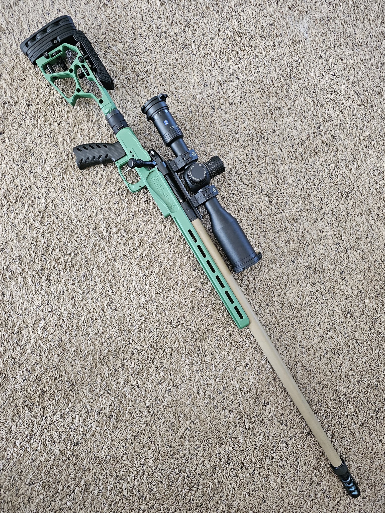

6.5 creedmoor
Zermatt origin action
16 inch Outlier barrel
Trigger tech special
Mdt xrs chassis with mdt Arca rail
Harvester 300 suppressor with area 419 adapter
Atlas cal bipod with leg extension and spikes
Vortex razor genii in Nightforce rings
Also have a 22 inch proof carbon that need chambered.
Weight ended up being 15.8 pounds.
