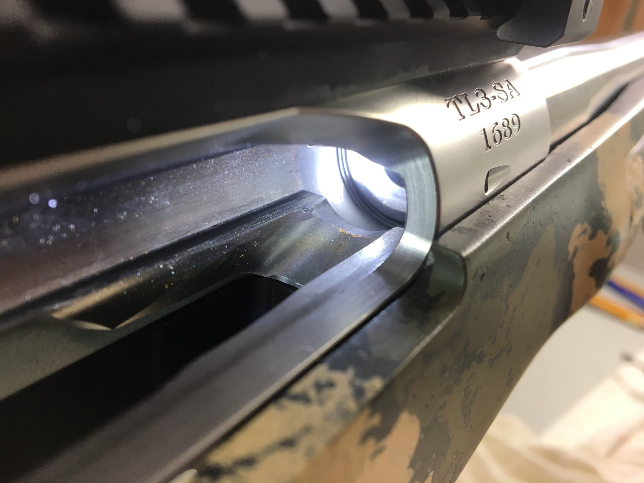

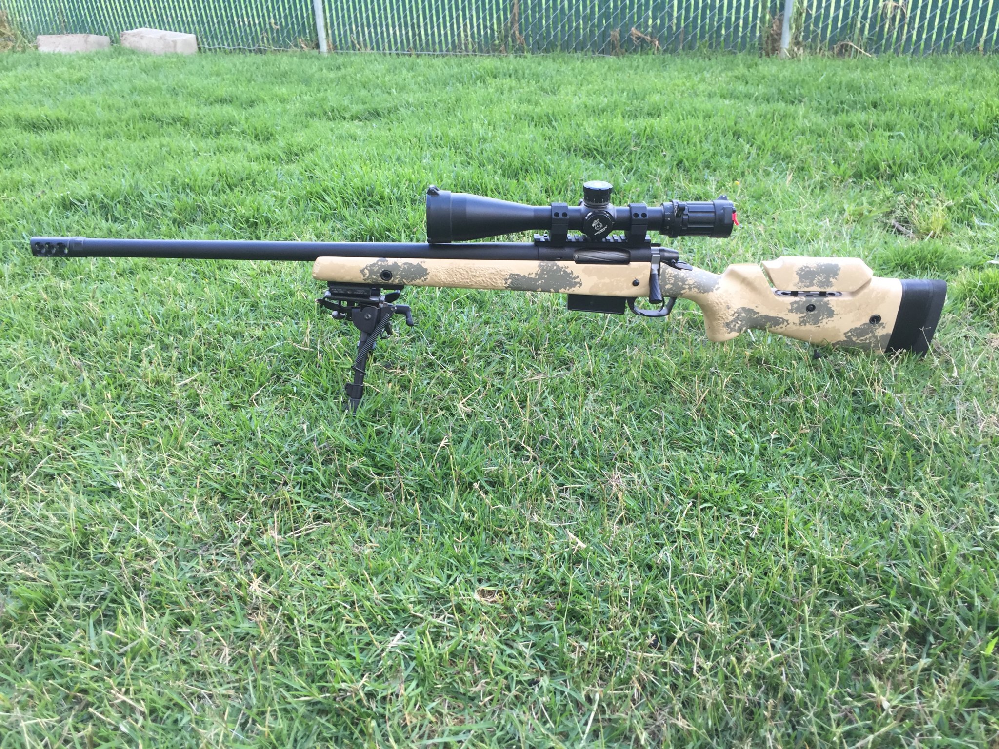

Just pieces this together today for a friend. Soon to be wearing a kahles 3-18

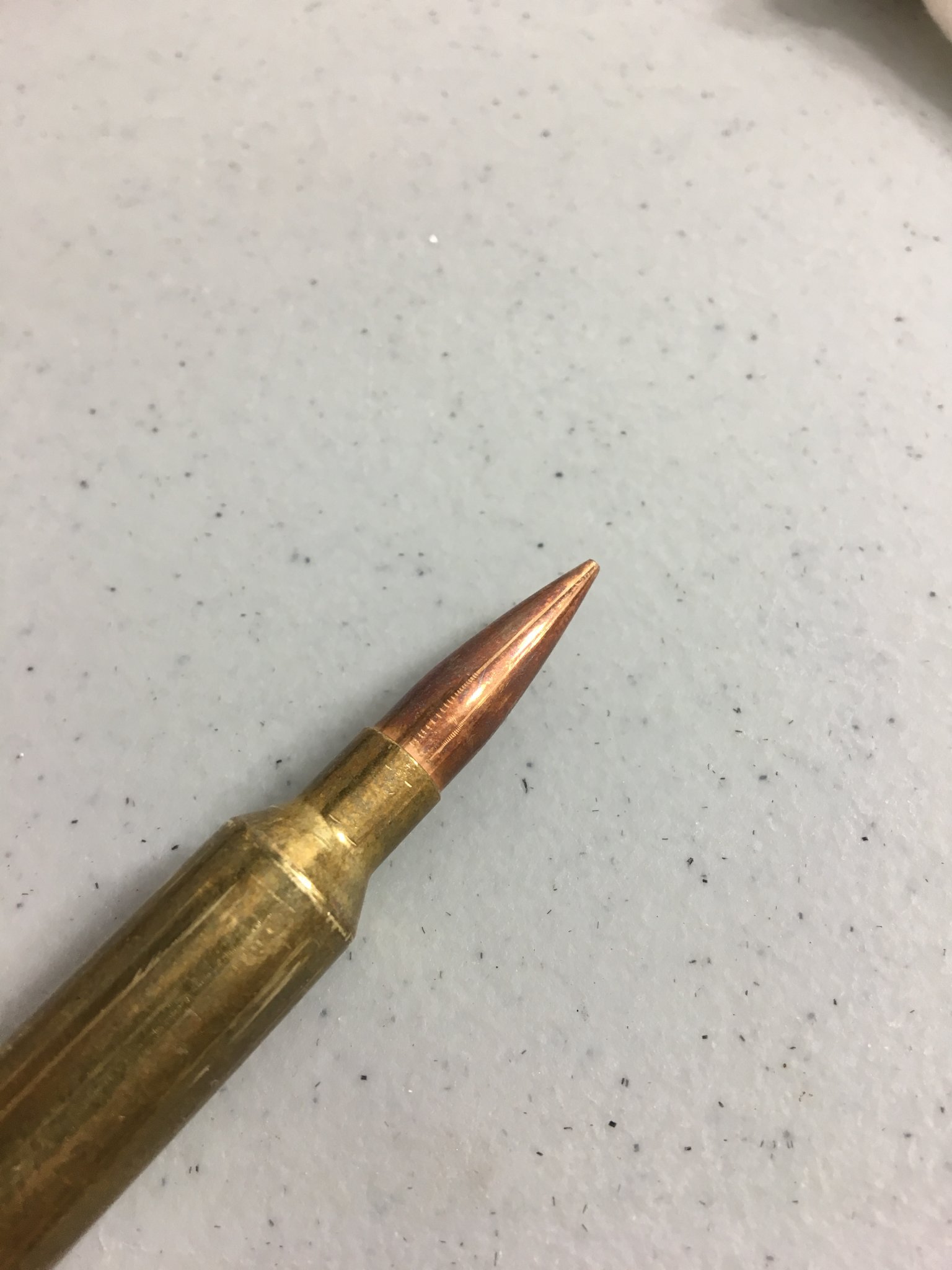

Reading about people having feeding issues and/or scratching brass issues and thought I would share my experiences. I do not claim to be an expert but when I started my build I did not see anyone really discussing the finer points of setting up a CRF action. LRI had elluded to the need to fine tune the system when the Mausingfield came out but I could not find and specifics so I thought I would share my findings. The barrel sits forward of the feed ramp because of the space for the bolt lugs so I did not mess with the barrel at all. Josh at PVA does excellent work and I was not about to start messing with it. I needed to polish the tool marks out of my early TL3 feed ramp and round the top edge of the feed ramp as it was pretty sharp and was scratching my brass and bullet. The stock magazine lips were also scratching the brass. Easy fix but would not overly recommend people busting out their Dremels for the first time.

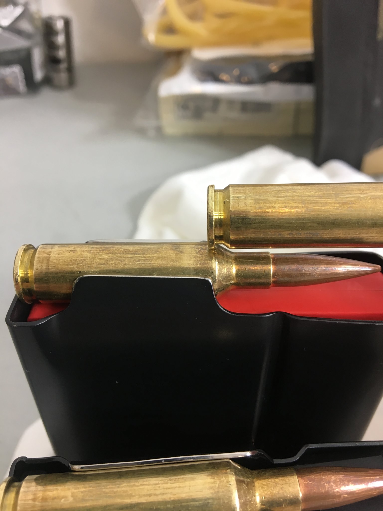

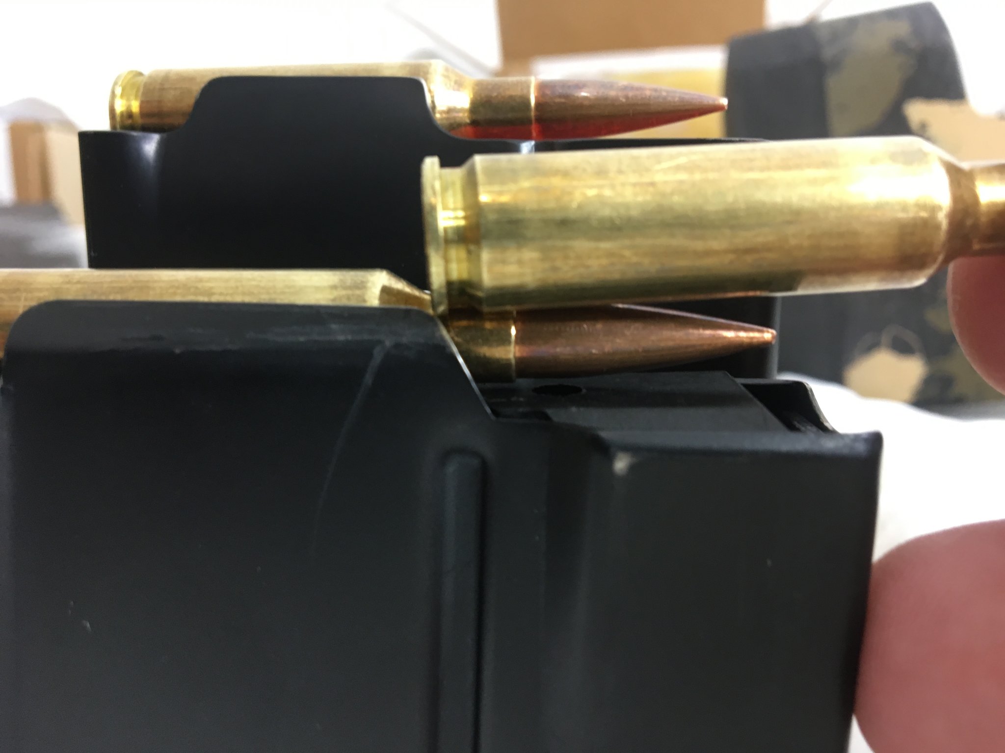

It was also important to me to fully utilize the features of the TL3 action, specifically the Controlled Round Feed. Initially my setup was only providing Controlled Round Extraction and Push Feeding. It is important to note the AICS magazine is designed for a pushfeed action with a .308 cartridge profile. The length of the magazine lips dictate which part of the lower cartridge presses the upper cartridge into the bolt face as it is being pushed into the chamber. My barrel is chambered in 6.5 Creedmoor so it was important to me that my rifle package be properly tailored. The AICS magazines press up with the neck of the lower cartridge when using a cartridge of this profile.

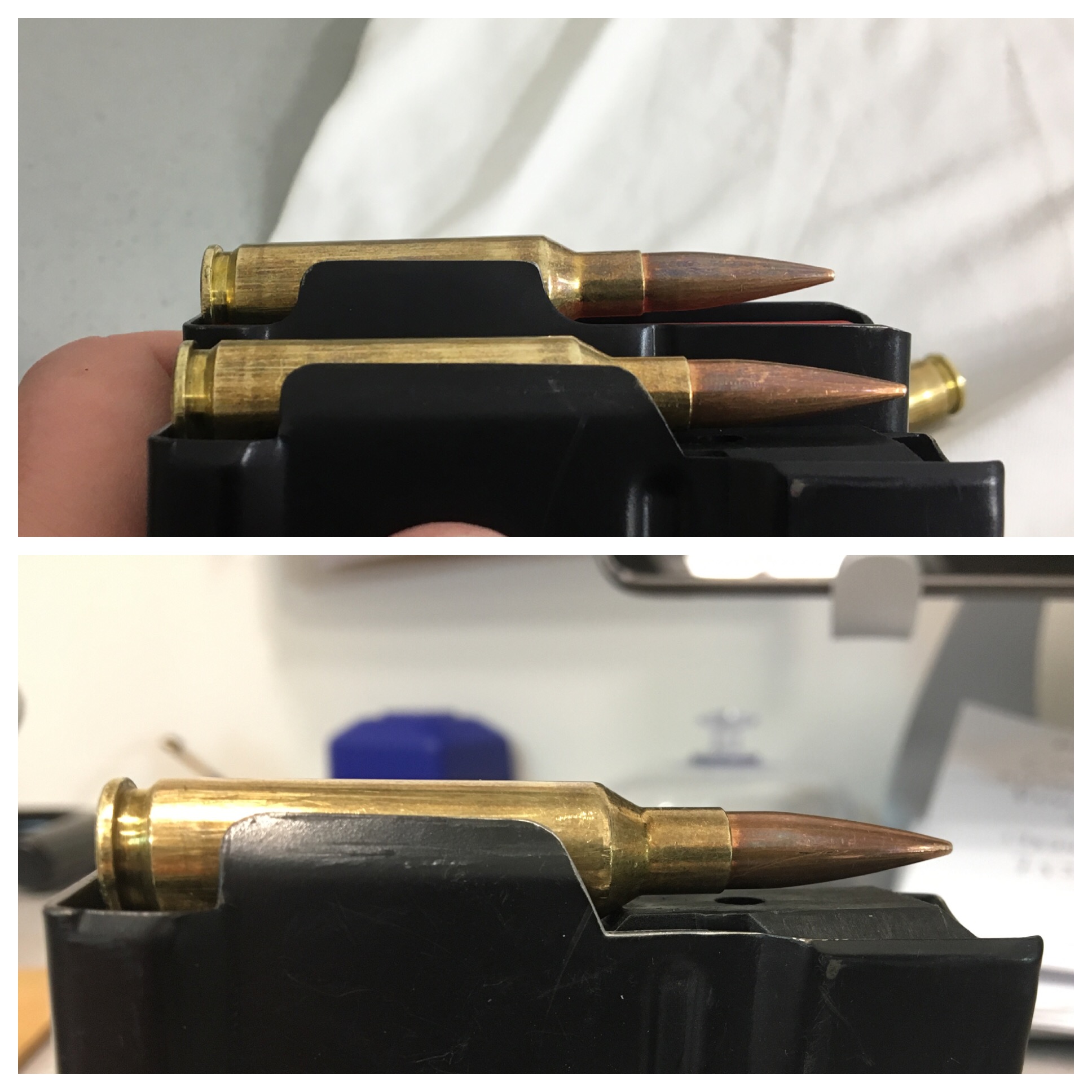

This means the top cartridge will pop up low of being fully captured by the extractor. The ARC magazines have a shorter feed lip and are better suited for CRF but with the Creedmoor still press up on the shoulder or just barely on the body of the cartridge. This results in CRF if it catches on the shoulder/body edge but more typically the angled shoulder pushes up and forward causing the cartridge to bounce in front of the bolt face once it clears the lips.

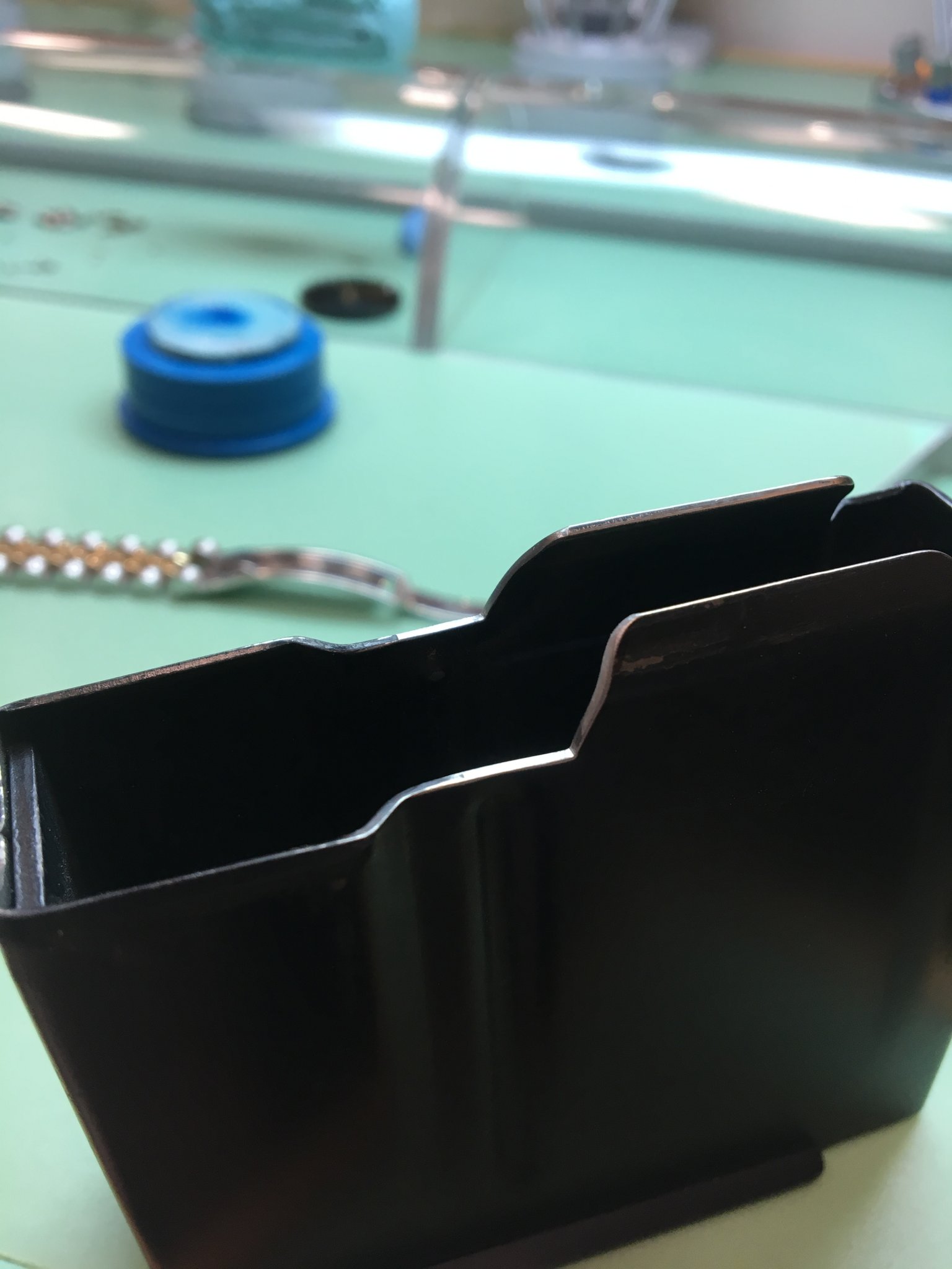

I solved this problem by simply shortening the feed lips to properly fit the cartridge dimensions.
(AICS metal roughed in before final cosmetic work shown in the bottom image)
Obviously, like others have said, it is also important to make sure the cartridge sits high enough in the magazine to avoid over riding with the bolt without the lips riding the underside of the bolt. My TL3 has been extremely reliable since the modifications and will definitely build off one again.
Hope this helpful for some.

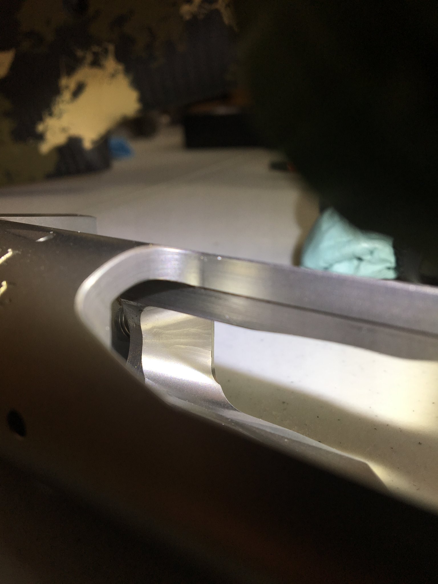

I am in Wisconsin if you are ever in the area. I only had feeding issues during assembly because I am not a believer in breaking things in or “seeing if it works”. My day job is too methodical for that.
Scratching is completely eliminated with high quality polishing of the madazine lips and feed ramp crest. The feed ramp itself was never an issue other than cosmetic.

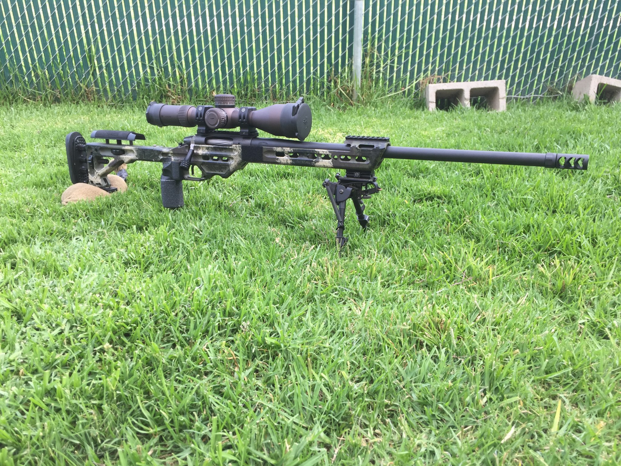

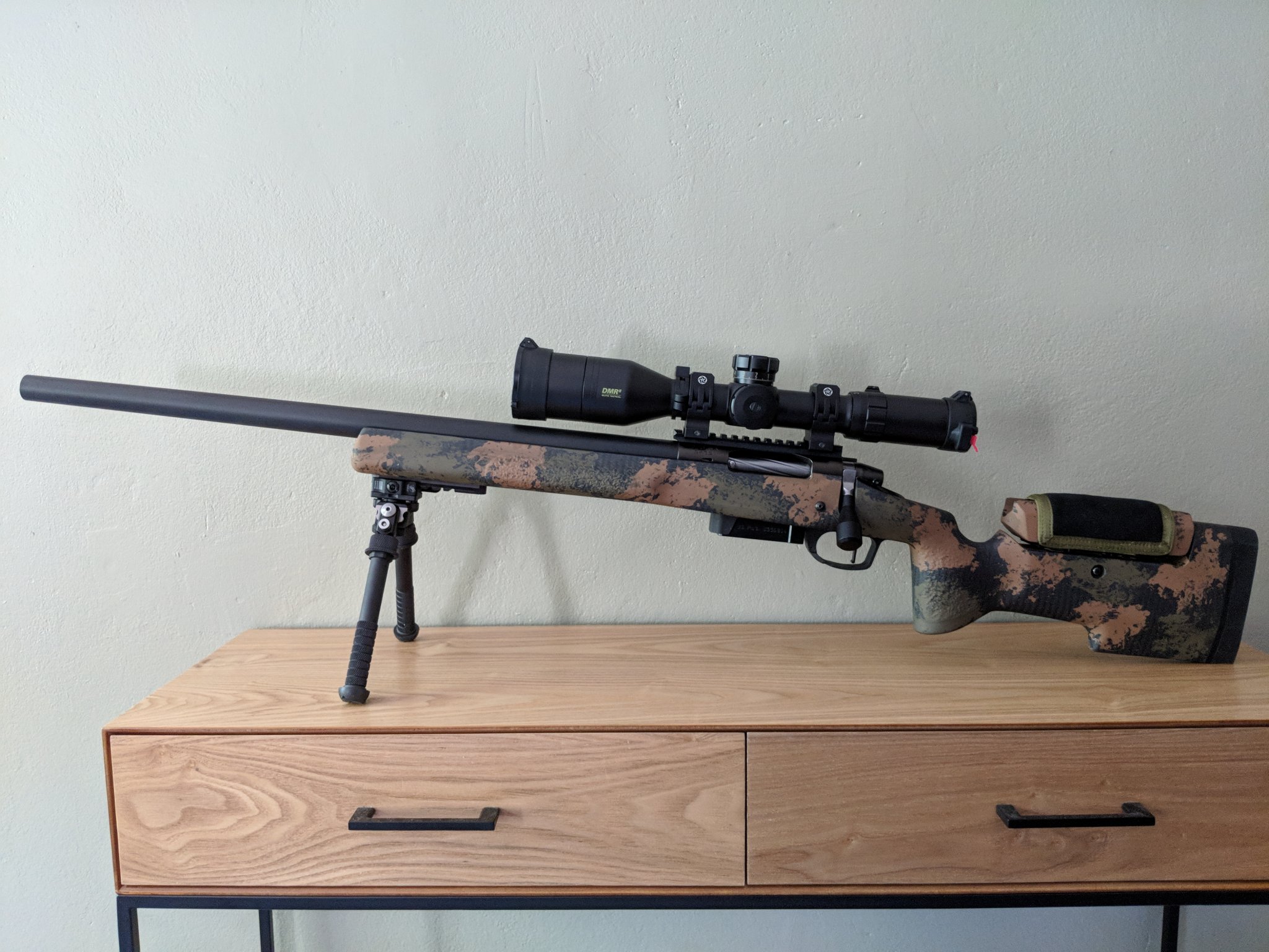

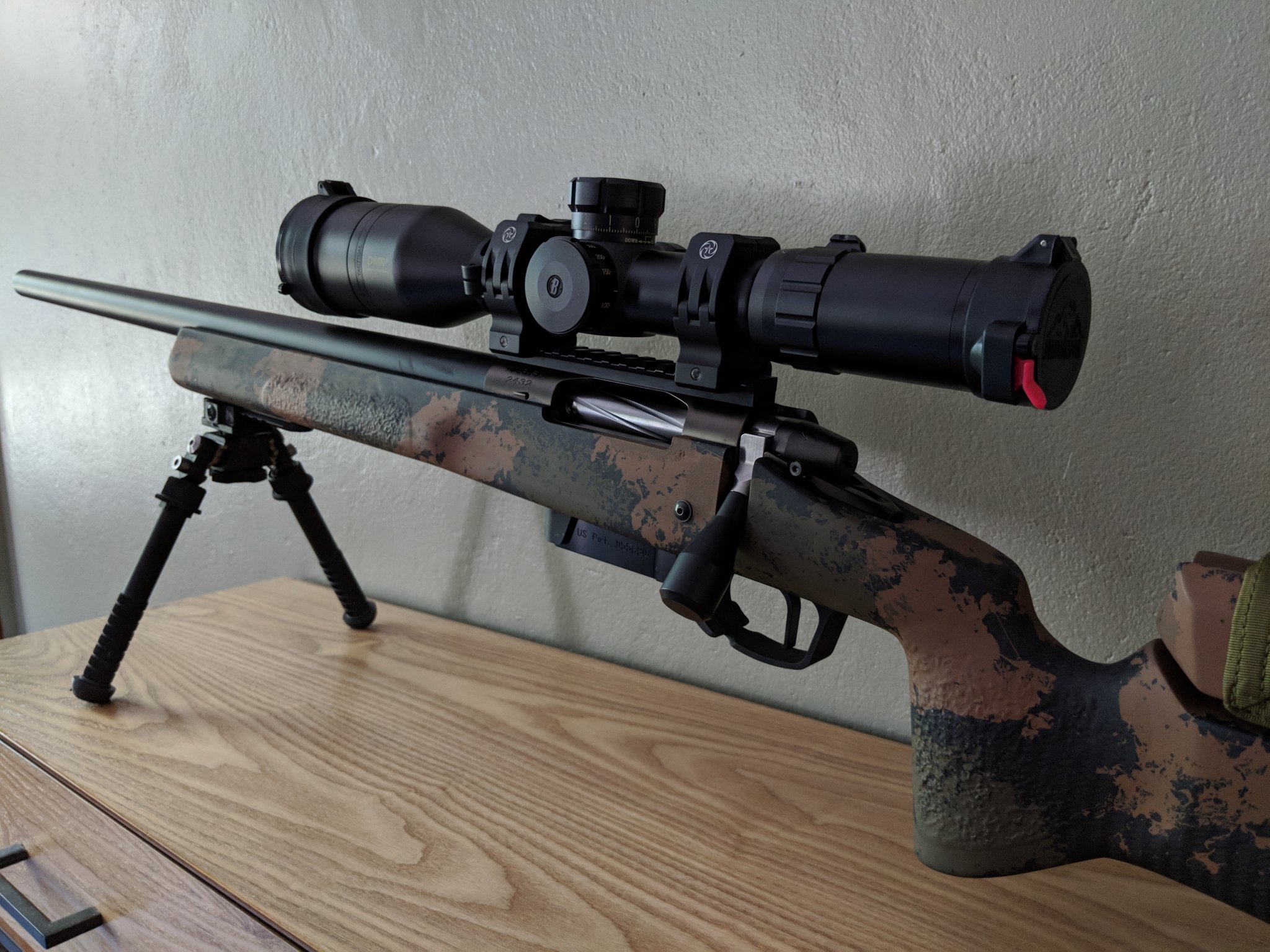

Just put this together today. First ever Build!
-TL3
-MPA comp chassis
-Trigger tech special flat face
-4.5-27x56 w/ebr2c
-ARC M10 mediums
-.223 Wylde 1:7, Rock creek marksman contour by PVA
-PVA jet blast
Great looking rifle! Can you give any details on the camo finish on the MPA. I am wondering if you just sprayed it on yourself over a black finish? Thanks!
Reactions: DEWD_STUFF
Thank you,
Yes I used a sea sponge from lowes, chassis is sniper green from MPA, I layed down black, brown then tan. I posted the steps and pics showing process over in the DIY section of the forum, there is a thread over there with a bunch of DIY rattle can paint jobs.
Reactions: jafo96
Thank you,
Thanks for the info. I will see if I can find the DIY section with your posting.
-TL3
-MPA comp chassis
-4.5-27x56 w/ebr2c
-ARC M10 mediums
-PVA jet blast
This is the exact build I want PVA to build for me. But I am going with powder blue to represent my SD Chargers!
How does it shoot? What factory match ammo have you tried and which stand out?
Thanks!

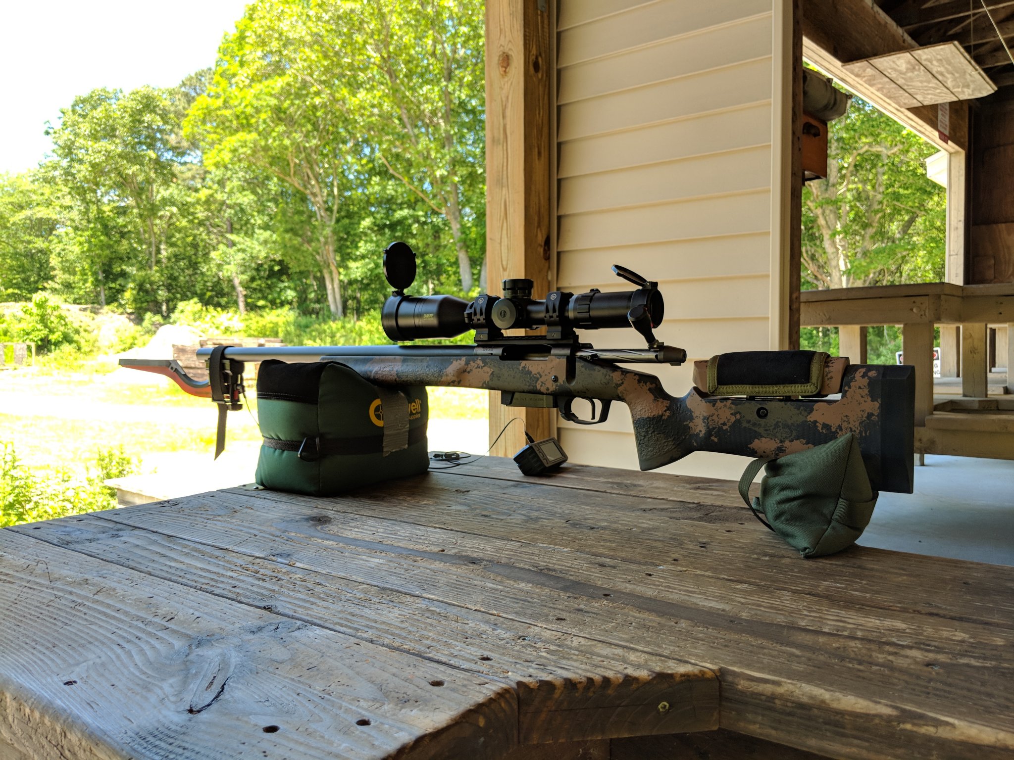

Went out today.
Shot some 5.56 surplus green tip stuff, Winchester 65gr, frontier 68gr, federal 55gr and Prime 77gr.... no surprise the prime shot lights out. Prime was excellent first round impacts out to 630 yds on varying sizes of steel. At 760 I had a miss, corrected my wind and hit, moved to 895 yds had 5 rounds left, missed the first 2 again wind was constant 5mph gusting 8mph, went 3 for 3 on the remaining rounds on an 8" swinger. None of the misses were vertical, they were all horizontal due to the wind. I believe the prime is the ticket and very consistent. I told myself I would never be the dude to post groups but I can't help it be tickled about how this thing shot. Not pictured is the other ammo I shot, but they all fell between .70" and 1" in group size. I shot 2 strings of 5 for each make of ammo all off bipod and rear bag.
p.s. If you're in the SD area, I was shooting out at pala rifle range today. I'll be there next weekend most likely as well. Pm me if interested on linking up
