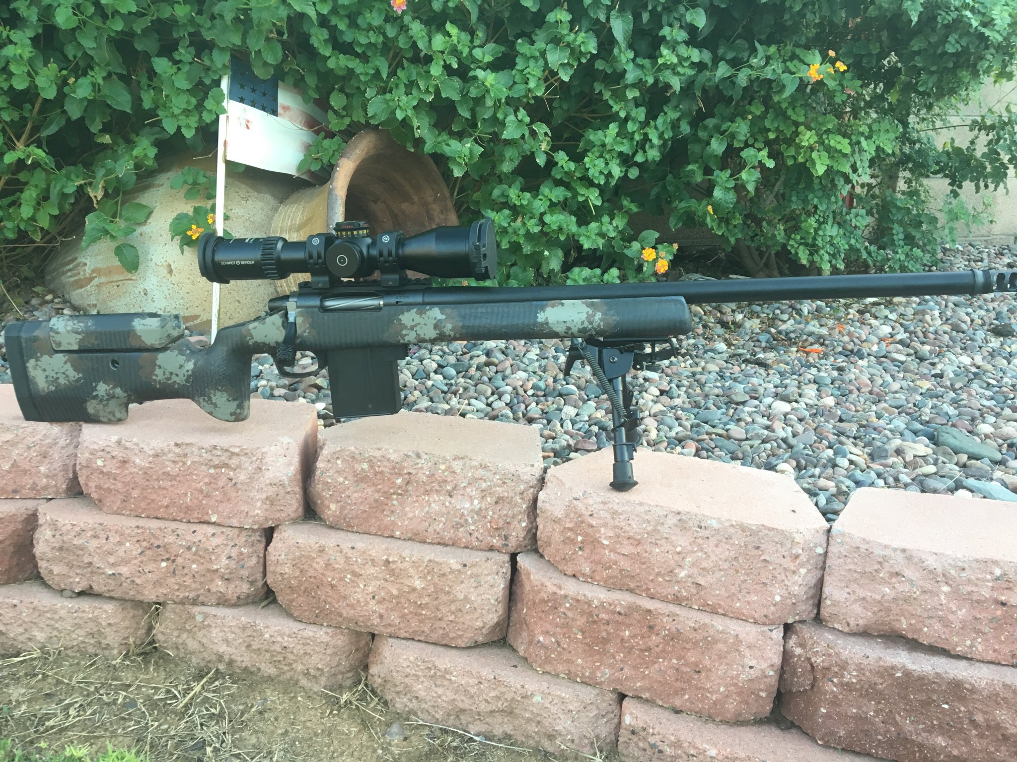

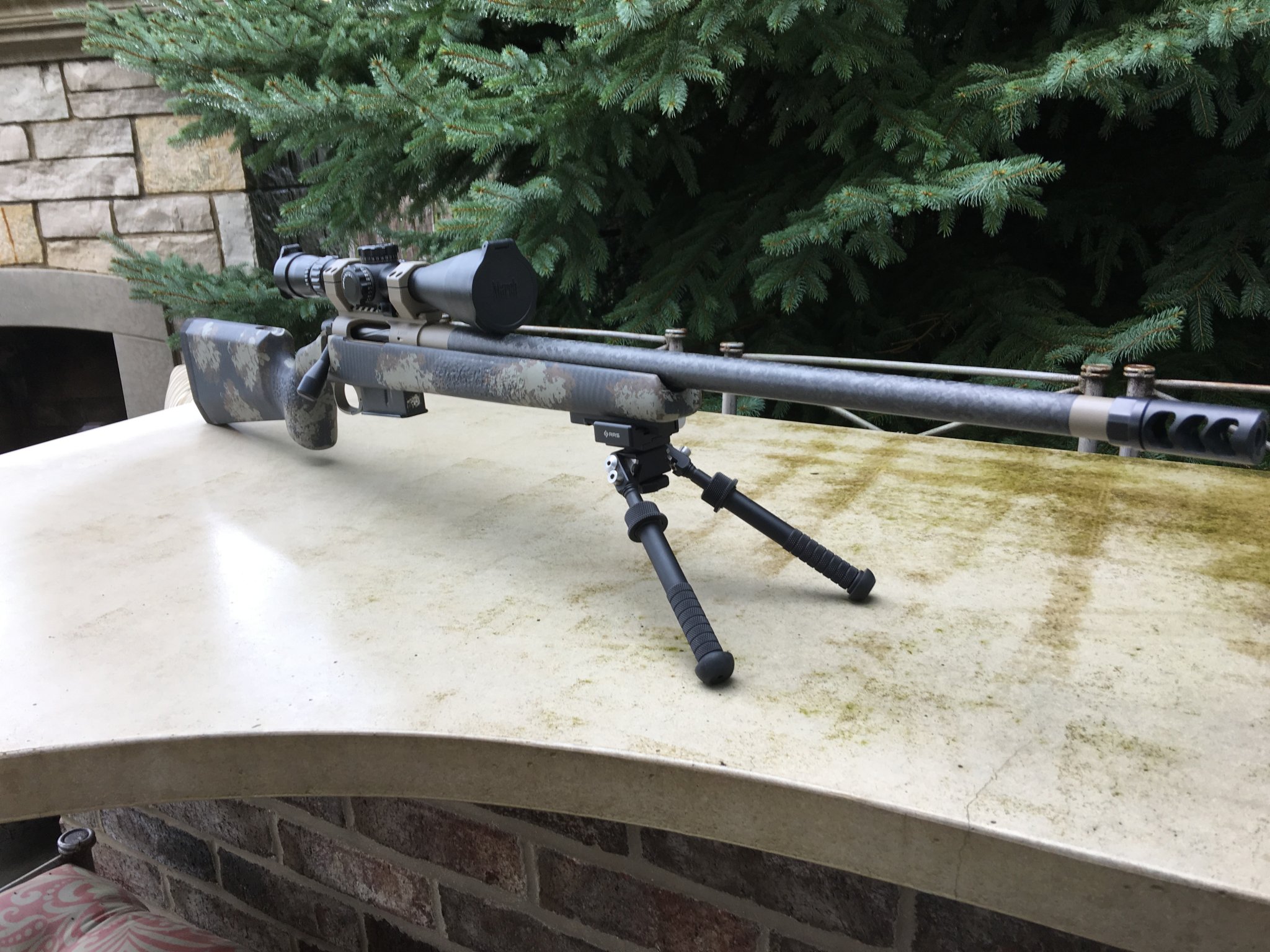

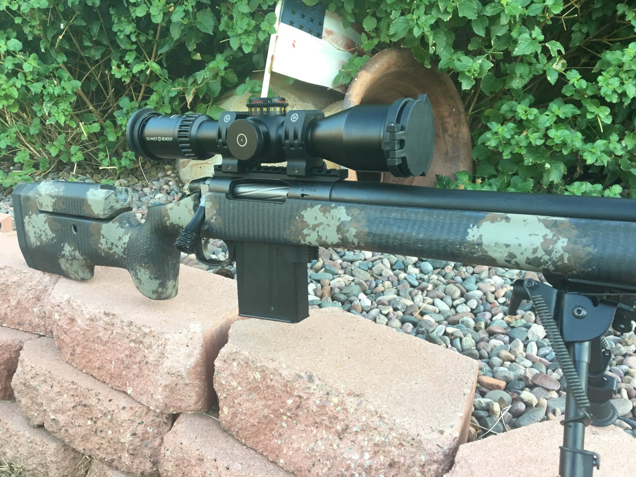

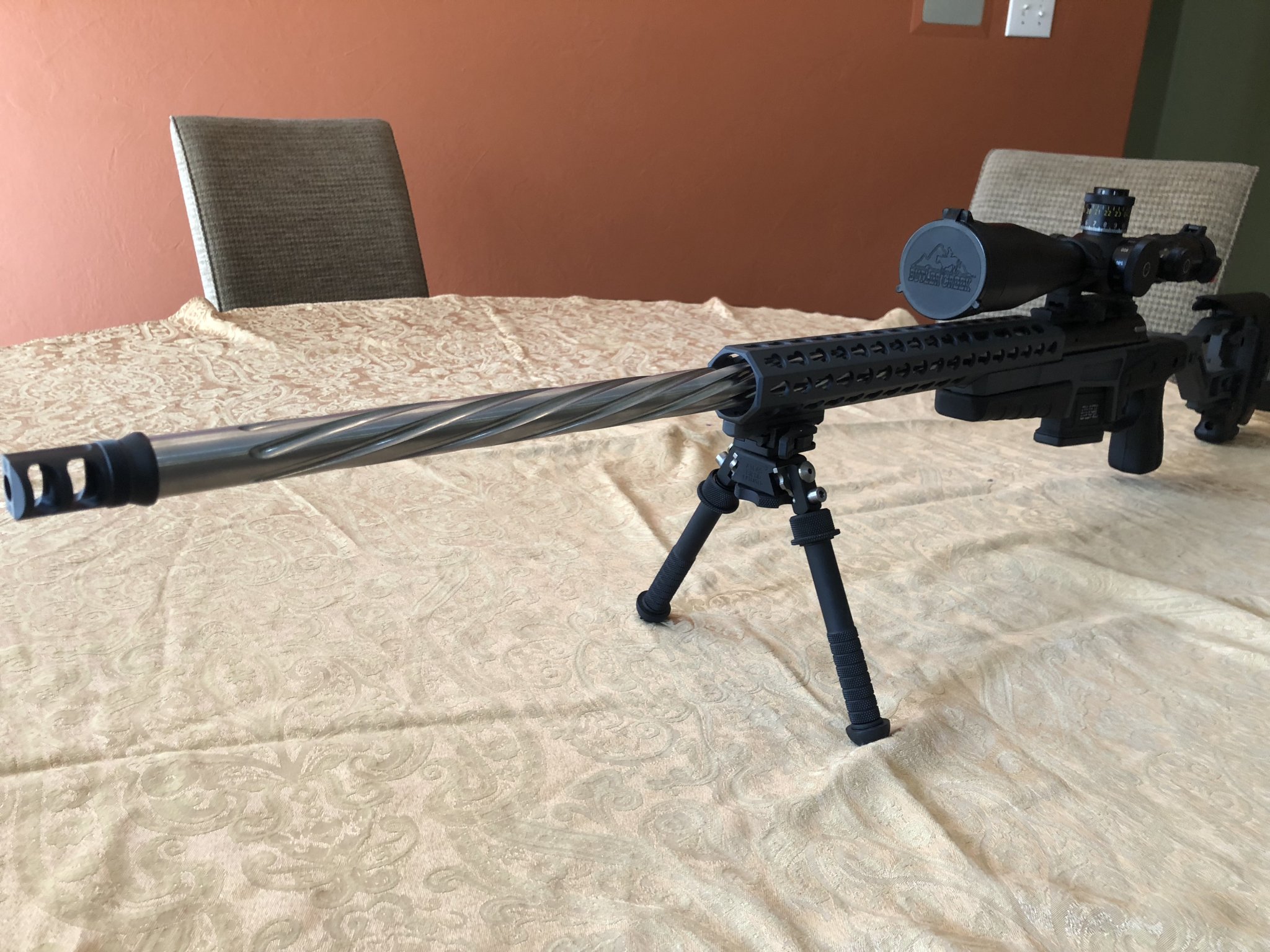

Just got my 6.5 Creedmoor TL3 build from Phoenix Custom Rifles. Specs are:
TL3 DLC coated with AW cut
23” Bartlein Heavy Palma barrel
Manners T4A in “Scorched Earth” camo
Badger M5 gen 2 bottom metal
Trigger Tech Primary
TBAC brake
S&B 5-20 Ultra Short
ARC rings
TBAC brake
ARC rings
View attachment 6947118View attachment 6947119
Looks awesome, Keith does great work. Keep us posted on how it shoots.

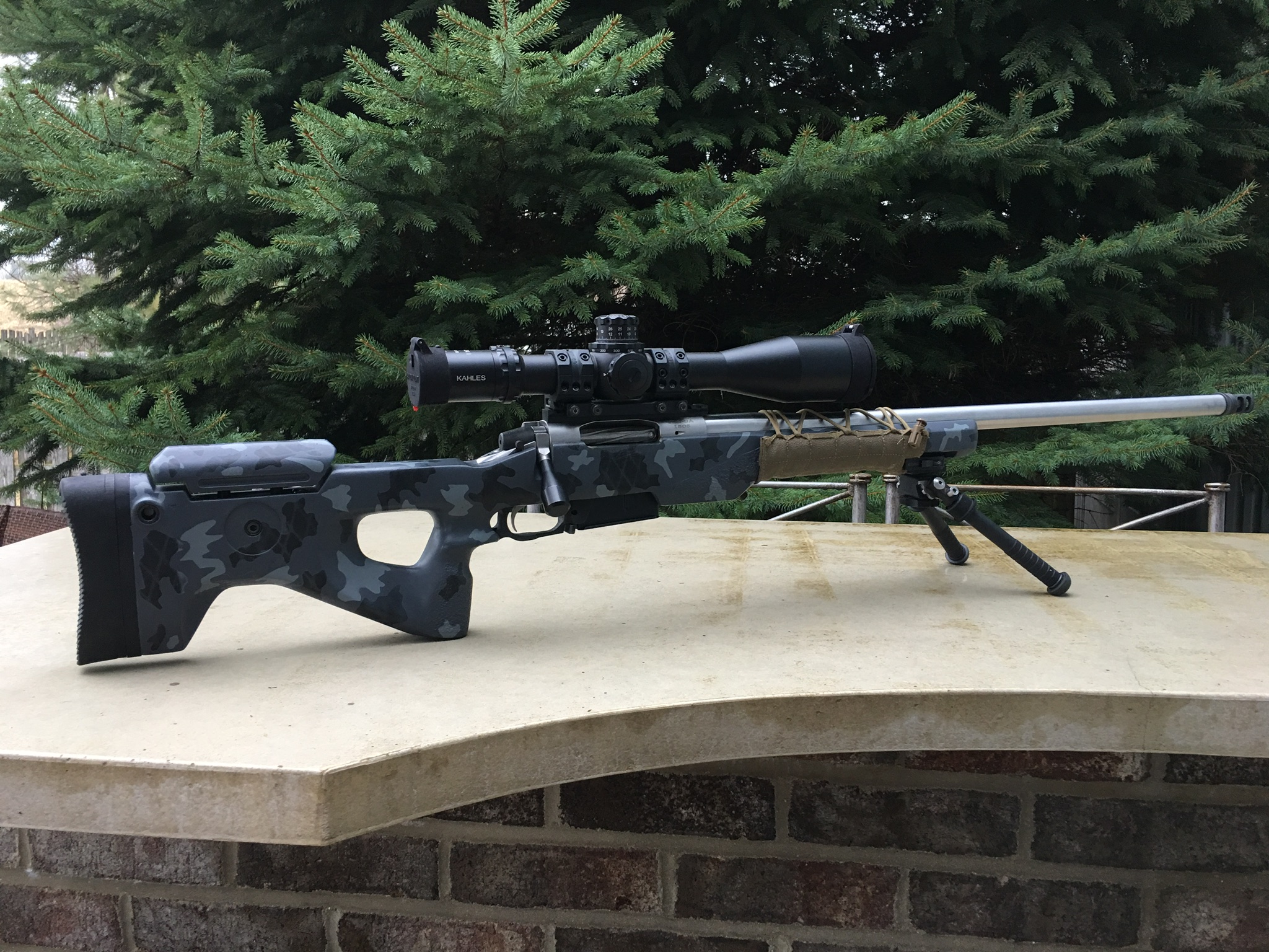

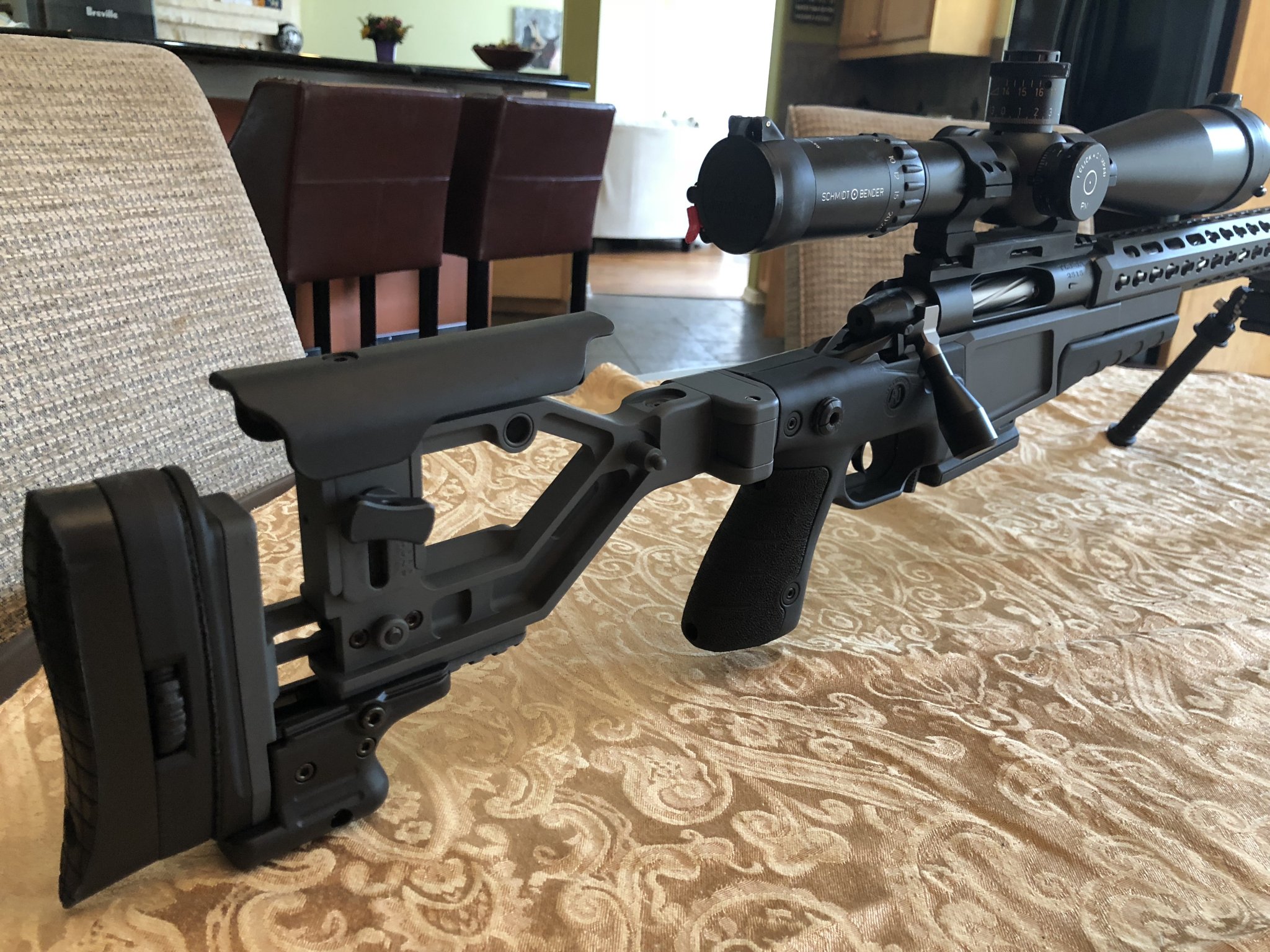

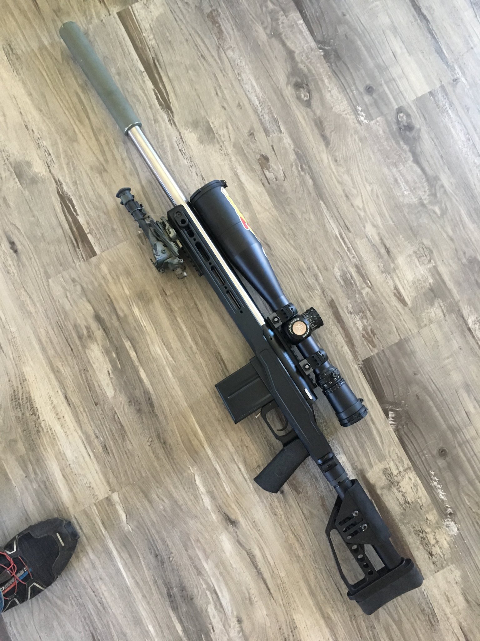

Recently moved to a LH TL3 on my match rig, had this rightie sittin around so thought WTF....sent it to Shaen Rifles and put it to work.
Bartlien 2B cut at 18", chambered 6.5 CM, 8 twist
Huber 2 stage
Mesa Precision DBM, Accurate binderless mags
Manners SuperLite
SWFA 3-9
9lbs on the nose all up with 5 in the belly, SilCo Harvester, and Rifles Only Skinny. Cunthair under 8 naked

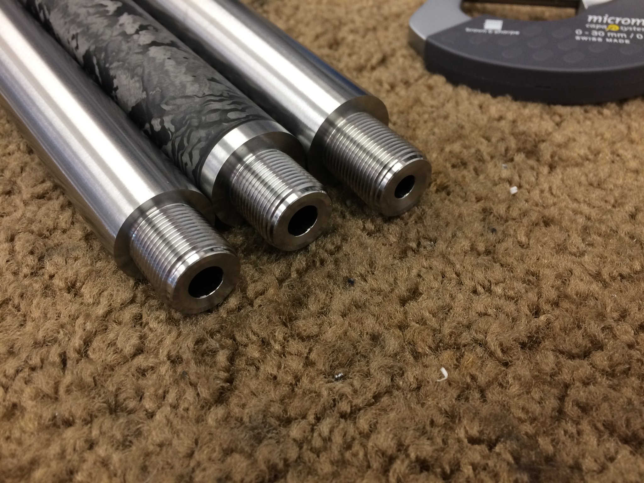

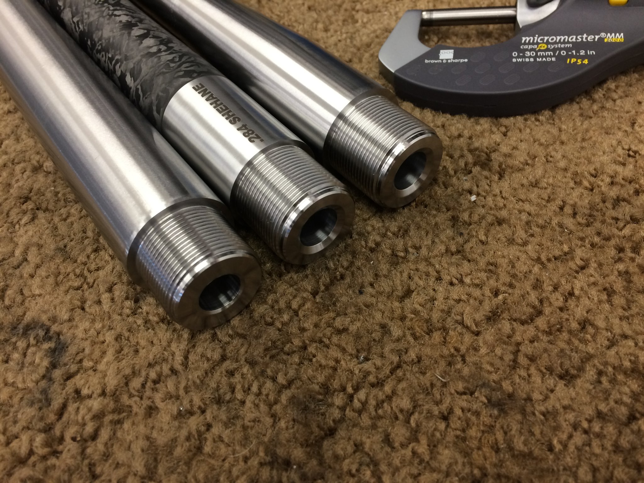

Cut a 22BR for a short action and a couple 284 Shehanes for a long action yesterday.

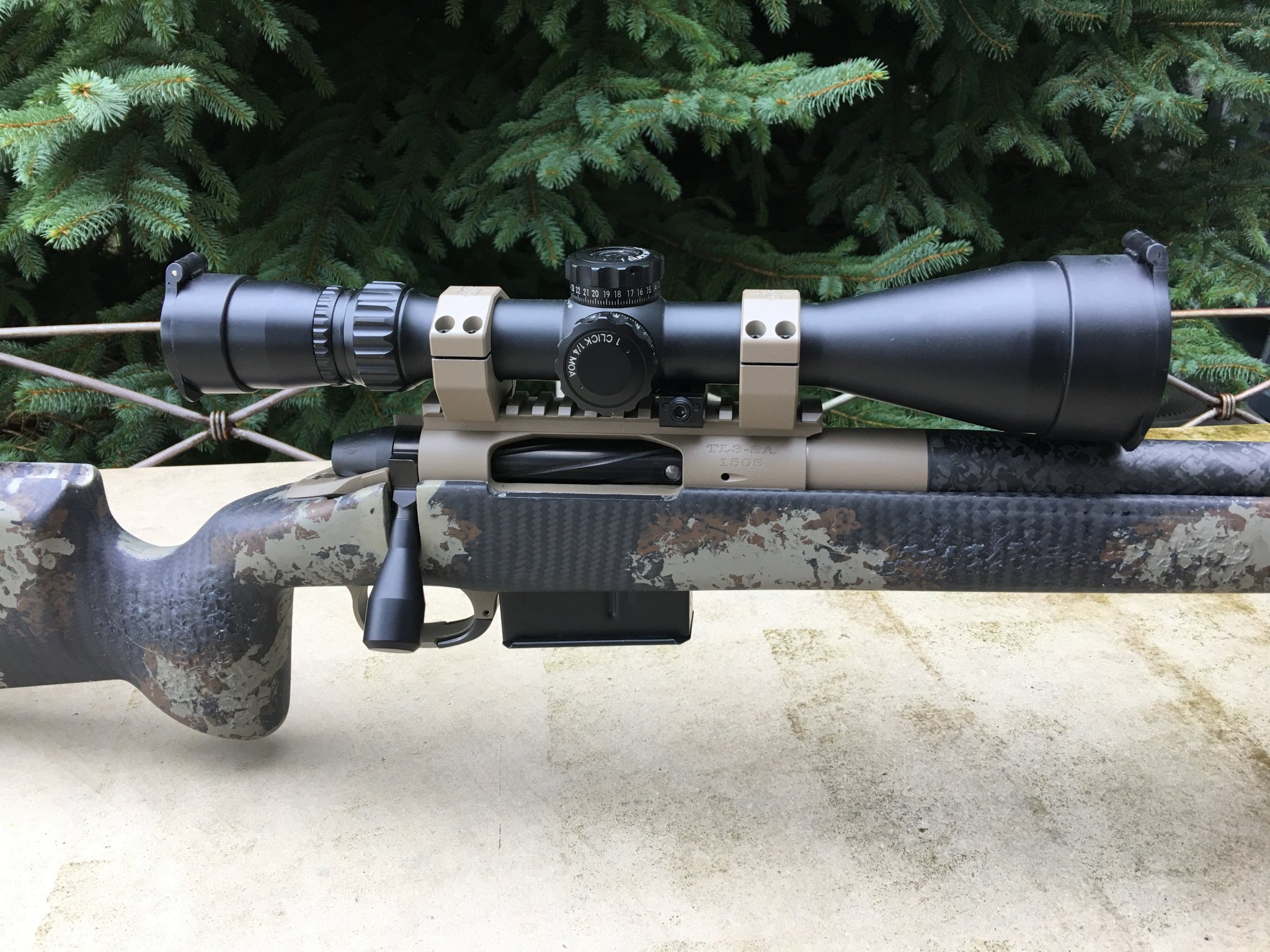

received my SR3/Proof barreled action from Bighorn yesterday. Bolted it together last night and wrung it out today. 2 shots to sight in at 100, then 3 rounds at 200 for zero. I leave tonight for elk camp. Ol' Ray and Aaron cut it close, but they came thru in the clutch. Thanks again guys.
Easiest. Sight-in. Ever....
2 at a 100. Shot, adjusted up and right for a 200 yd zero. Shot, adjusted a bit more. Then fired 3 at 200. First 5 rounds outta the rifle....
100 yd, first 2
the first 3 at 200.
I think it turned out great. I shall name him Percy. Short for P.R.C. McBighorn. My new Irish stepchild.

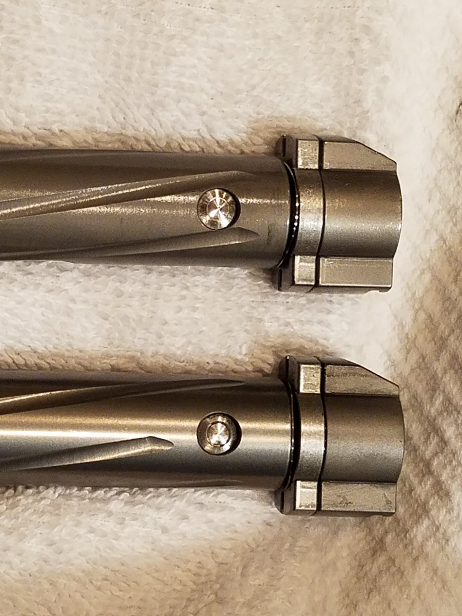

Does anyone else with TL3 with either the helical diamond bolt knob or the tactical bolt knob tend to bind when pushing the bolt forward slightly off axis from the end of the bolt handle? I feel like it's just my TL3 and it's not a detriment to function but it requires i manipulate it without error when trying to run it fast. Vice versa my dad's SR3 doesn't exhibit this at all it's extremely smooth.
I had the reciever DLCd and cerakoted the bolt with elite cerakote thinking the slight increase in diameter of the bolt body might help alleviate it. It's better but it's still bindy when it nears the mechanical ejector. I wonder if it's just mine. My buddies TL3 that is completely cerakoted in elite doesn't exhibit this. I haven't handled my brothers origin yet so i can't comment on it.
Two of my 3 TL3's exhibit the same binding you speak of. All 3 are DLC coated. (Serial #'s 16XX, 21XX, 26XX) The newest TL3 I have does not exibit the binding. BigHorn has actually altered the placement of fluting on the bolt to help alleviate the binding on the newer actions.
My original TL3 has actually gotten less prone to binding the more cycles I get on the bolt.
Older bolt is on the top and you can see how the flutes run on both sides of the bolt head retaining pin. Newest bolt is on the bottom.
