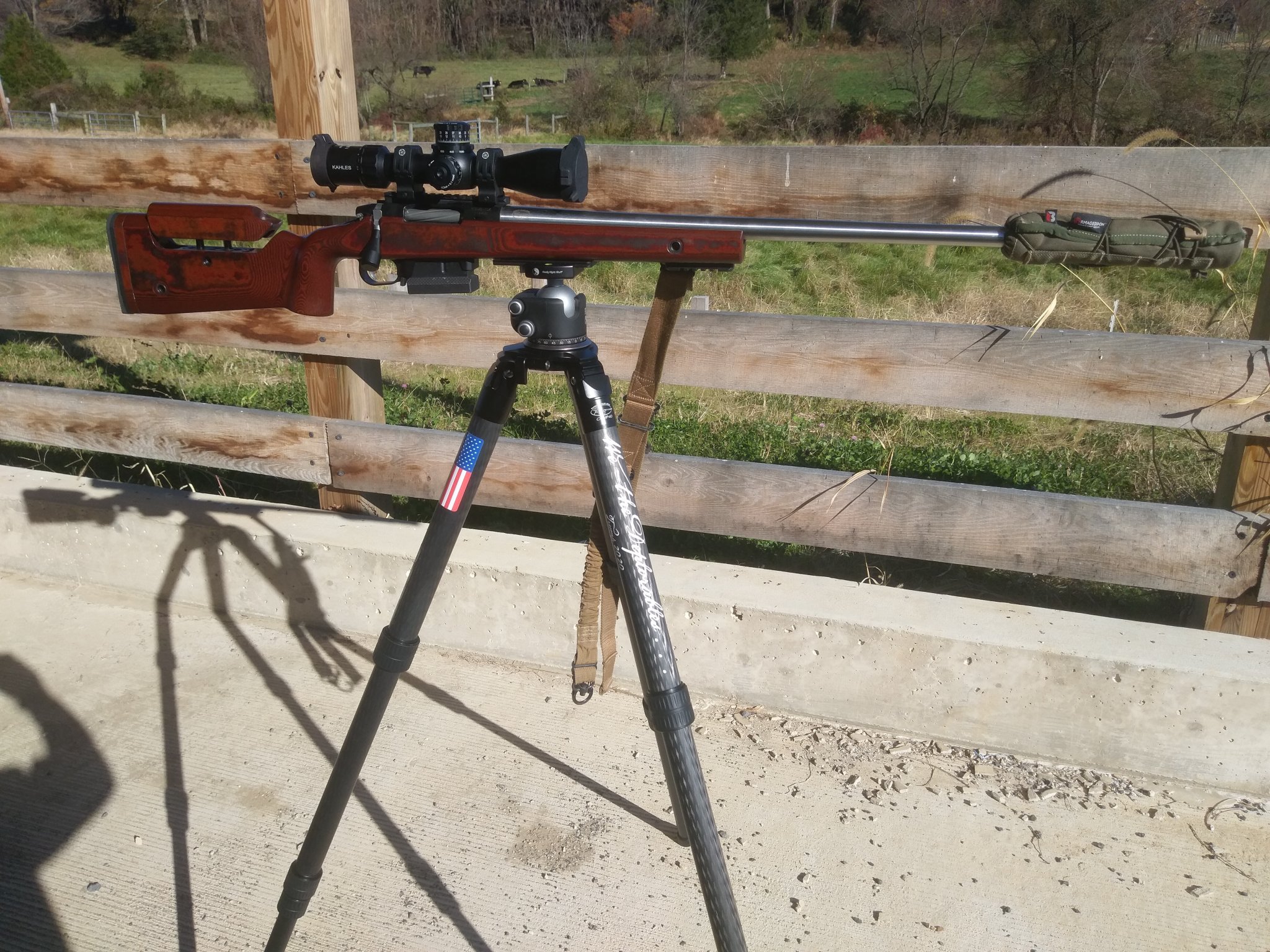

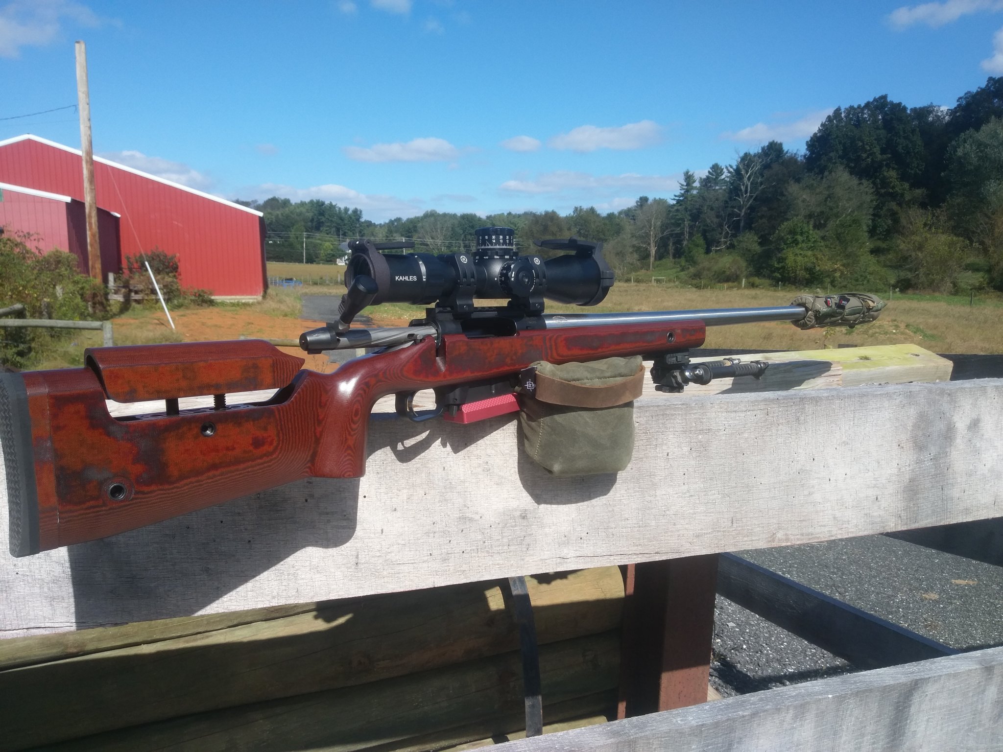

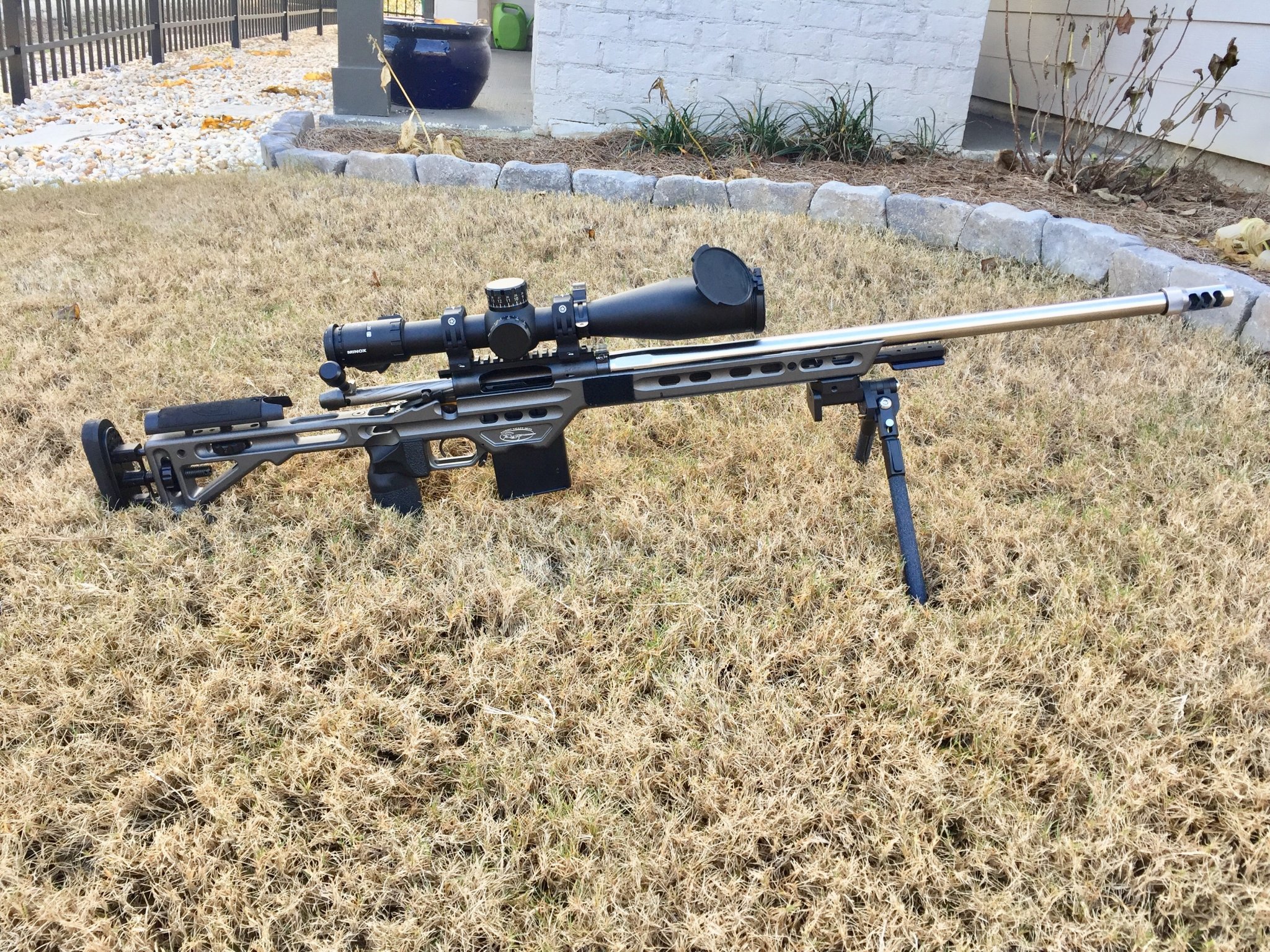

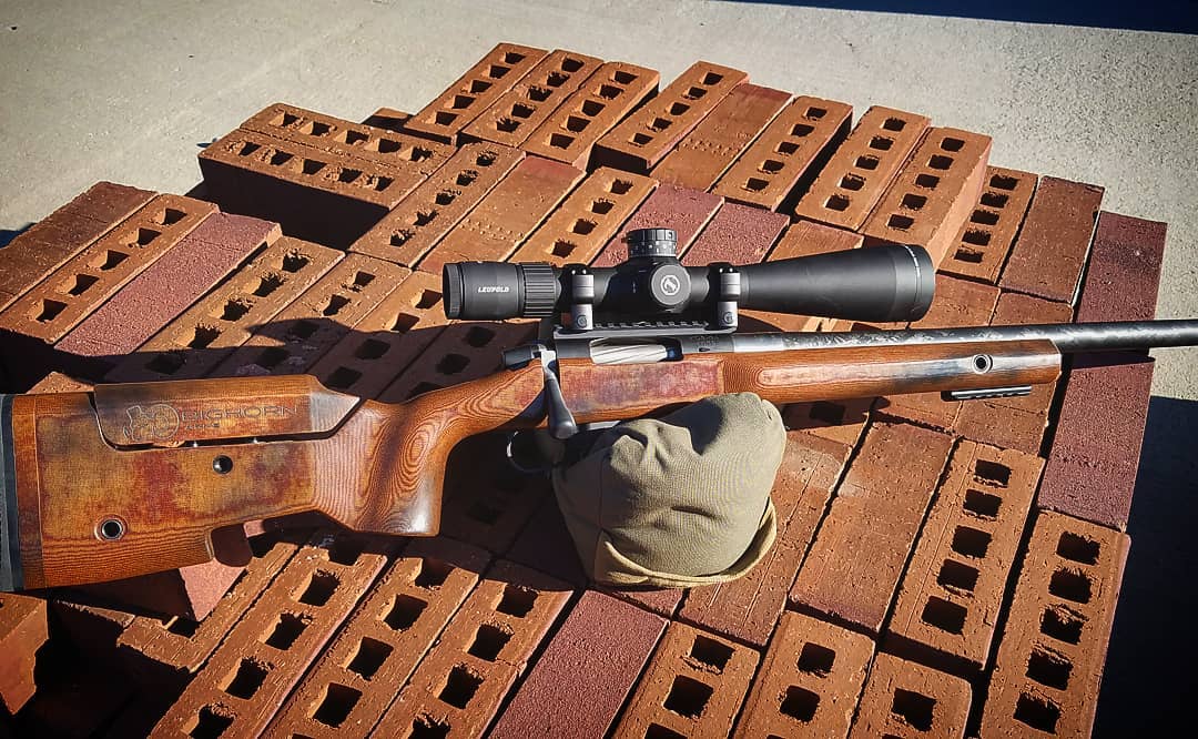

Finally joined the Bighorn family by finishing off these two TL3/Barloc builds about the same time. One by Josh/Jeremy at PVA the other by GAP... No complaints thus far.

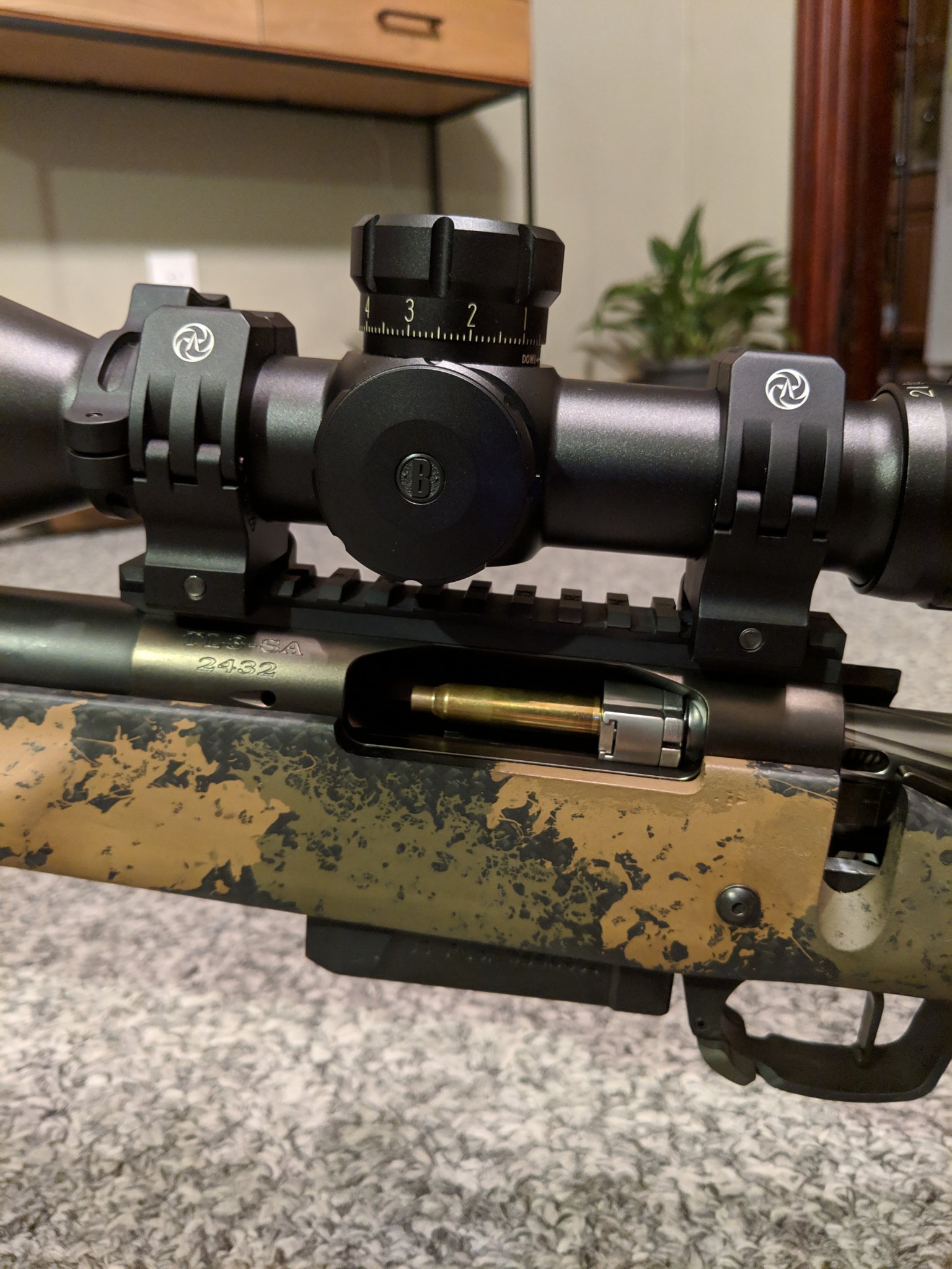

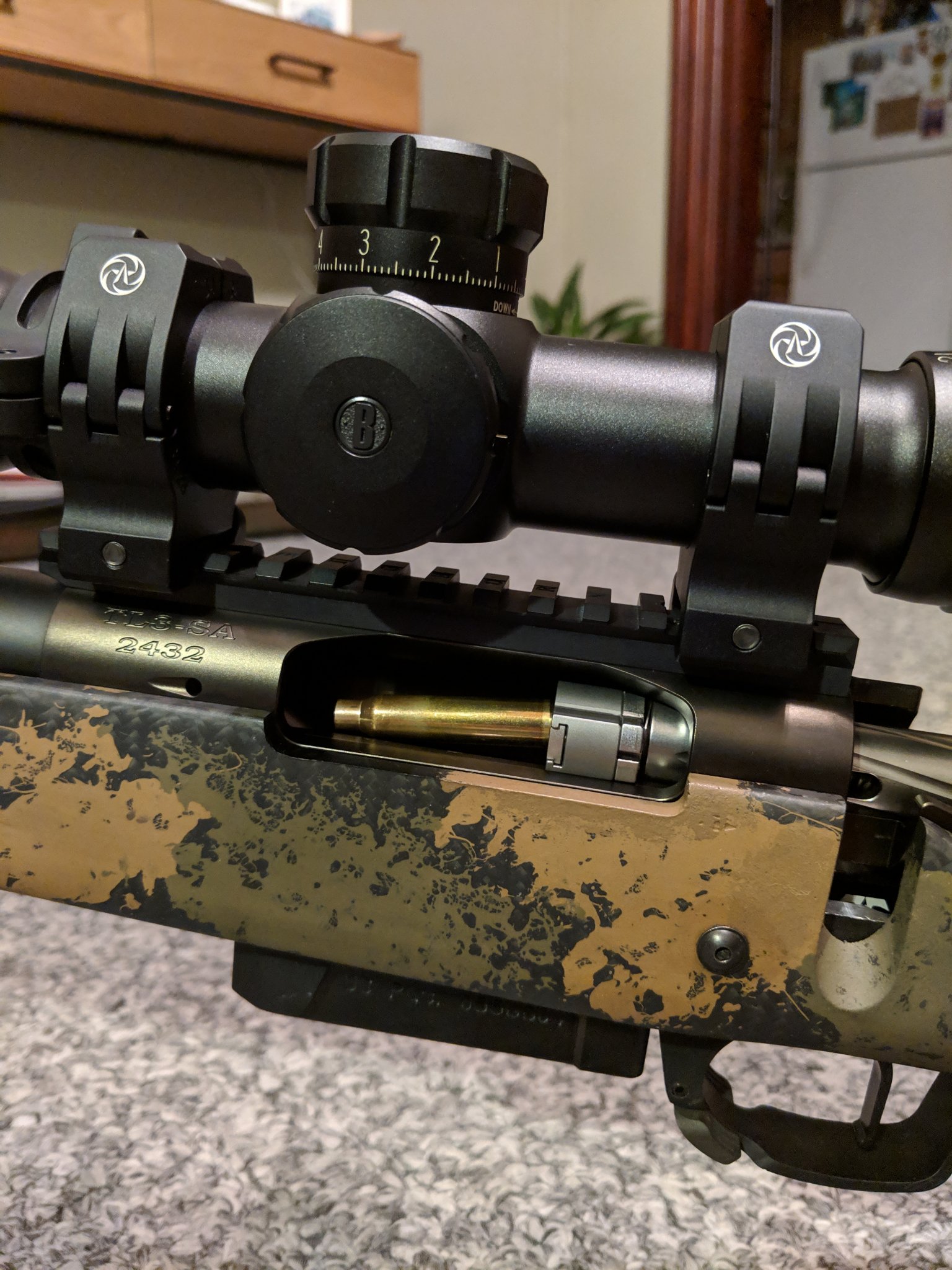

For those running 223 Rem with the TL3's... Has anyone noticed that upon ejection the cartridge is essentially thrown into the side of the lug raceway and then out of the ejection port?
I have experimented a bit, running the bolt really slow, and really fast, with a few different mags, and the result is always the same. I also have two 223 bolt heads (one CRF, and one push feed) and they both exhibit this behavior. I think the problem is exacerbated with an empty mag, because it allows the cartridge to hang more freely as the bolt is being pulled rearward.
Basically, the extractor is at the 9 o'clock position (for a LH action) and the mechanical ejector is at the 3 o'clock position, so the ejection angle is essentially horizontal and the shoulder junction of the cartridge makes contact with the inner edge of the lug raceway. I first noticed this when I saw some very light and minor ding marks at the junction between the cartridge body and shoulder.
I can try to take a video later if I'm not being clear, but I'm just curious if anyone else has experienced this. The round always ejects successfully, but it is not thrown "clear" of the ejection port, it makes contact with the receiver raceway almost 100% (and I say almost cause I just haven't watched every single ejection).

Can you post a video? We're looking into it with one of our 223's right now.
Are you experiencing a situation where the cartridge is being moved into the receiver and then out (moving away from the ejection port first, then out the ejection port)? Where does the brass end up in relation to the rifle? Does it exhibit this with an empty cartridge only or loaded as well?

I will get a video tonight. I can't answer your first question right now, but the brass usually just ends up besides the rifle, no real consistent pattern because of how it is being thrown into the raceway and then out of the port. Definitely exhibits this with both empty and loaded cartridges. Like I mentioned above, my cartridge "droops" alot when it is just being supported in the bolt face by the extractor. I will get some pictures and a video, but you will see that there's no chance the cartridge will clear the ejection port by how much the neck of the cartridge hangs down relative to the receiver centerline.
This is with your 223 push feed bolt head, and I will have to confirm whether the droop is the same with the CRF bolt head I have.

Alright, we've got it figured out. It's in the extractor of the PF bolt face. If you could get in touch with us privately and send your shipping information, I'd be happy to send you an extractor that will eliminate the issue.
For future reference, the PUSH FEED 223 bolt head in a TL3 (they exist for the purpose of 223 AI) will be good to go with this revelation. It's a very simple fix and we are changing out the extractors in what we have on hand here. There are only 6 of these bolt heads in the wild and we can back track who ordered them.

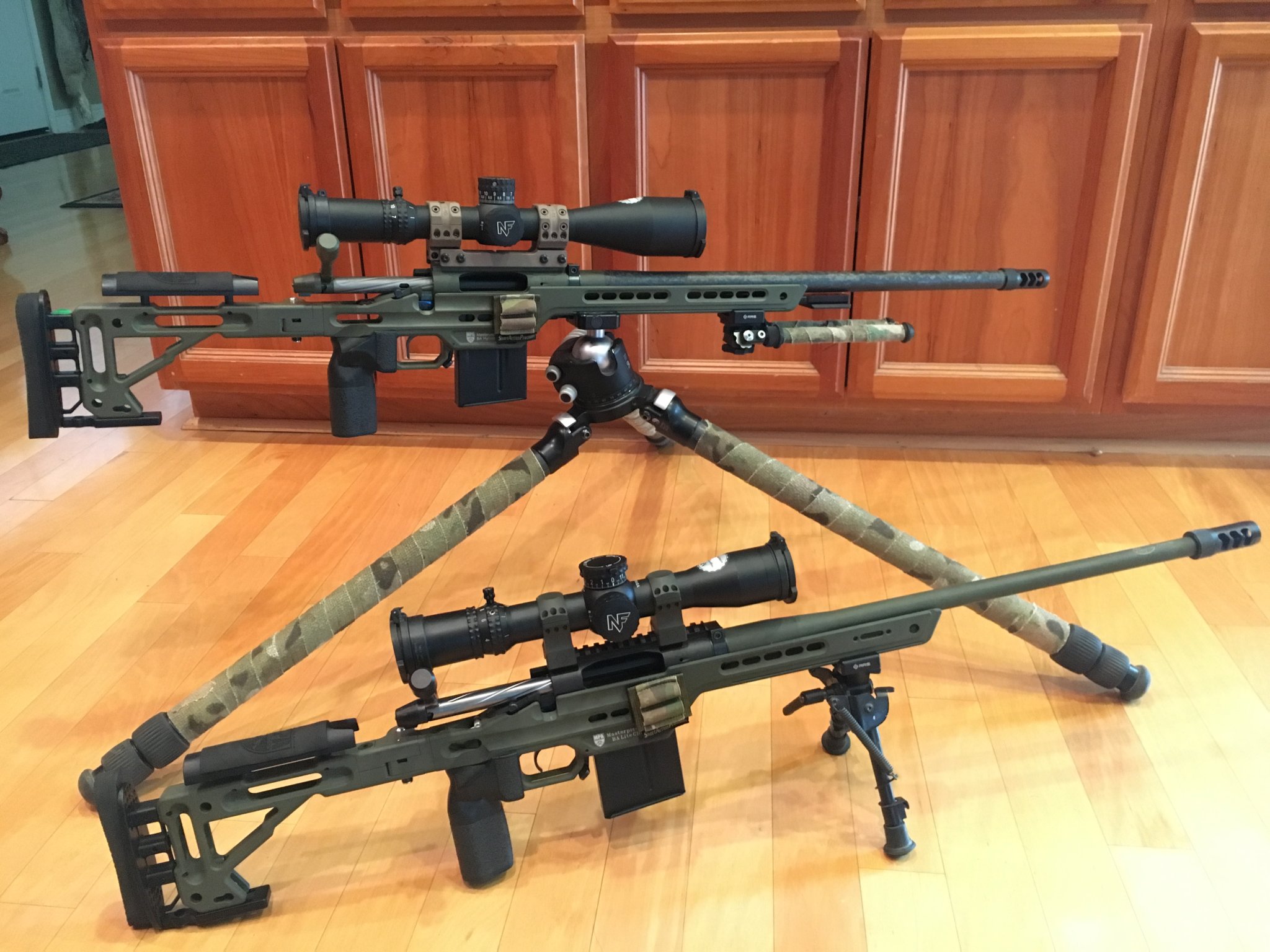

Is that the Exodus in the top two pictures? Been talking to John Kyle about getting one for my coyote rig. They are a little heavier than I’d like but I think adding a proof will make it balance well
Yea, they are actually the same barreled action but I had the genesis light first. I wanted the exedous but it wasn't in stock at core at the time. Once one came available I bought it and sold the genesis. I liked the genesis but it wasn't what I needed. I love the exedous light. It's perfect. I am thinking about going proof as well to drop a bit of weight but as well as this balances as it is currently configured it realy doesn't feel as heavy as what I would think it weighs. It's not a tank, but not as light as an EH1a obviously. The bennifits far outweigh any drawbacks I can find, that's for sure.

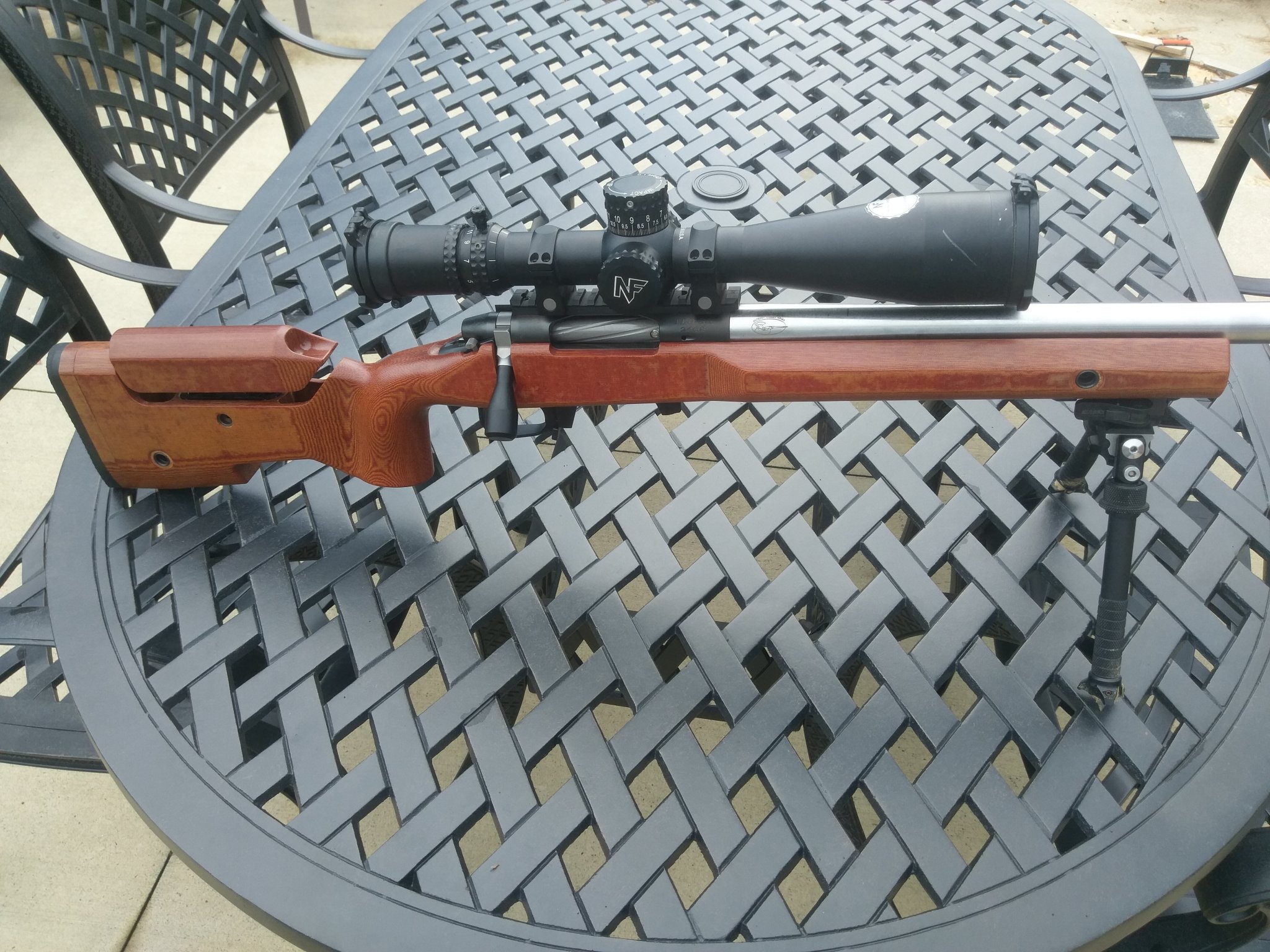

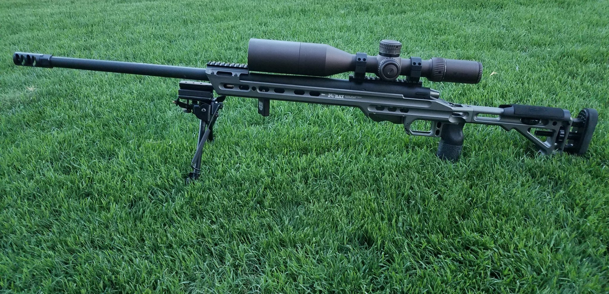

Finally got my TL3 action in after 12 weeks, and thanks to you guys about 5k later she’s done. Turned out exactly how I wanted as a lightweight hunting/prs gun. Without a mag and bipod it came in right at 10.5lbs.
Is that the bull/strait contour or is the standard contour? It looks like it doesn’t step down at the breach/chamber area if it’s the standard contour. It’s looks really good!!!

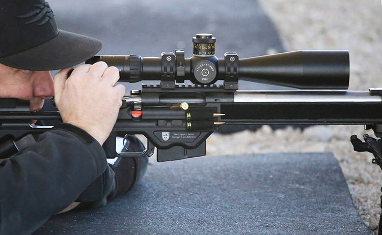

Happy with how my TL3 ran at the PRS Finale this weekend. Plenty of dust, lots of wind on Day 1, tight time limits so you couldn't afford any gear issues. Action ran perfect all weekend without a hiccup, was able to pull a 32nd place finish out of 150 shooters. Definitely going to stick with it for next year.
yep- it was a rough match for a lot of shooters because of the fine lime stoney dust. multiple defiances went down as did 5 impact DQs. May or may not have been related to the action - (most are reporting trigger issues- and one a ND) . But in an impact dominated field, TL3 was still holding its own.
Impact DQs? Disqualifications? Doesn't matter to me as obviously i own both, just curious how an actin DQs you? Less i've got that acronym wrong?
From everything I heard the DQ's were all from inadvertenly touching off a round after closing the bolt. Didn't matter if the round went right next to the target, if you didn't mean to pull the trigger that was a match DQ. Tight stage time limits and finale pressure makes it challenging.
Reactions: 5RWill and jafo96
Yeah. Just curious how they were all impact actions. Maybe just a function of their overall volume in prs.
@5RWill yes - disqualification. Maybe it is just a function of educated ROs actually calling it. Jim see called his own gentleman’s do, but there was 4 others. You would need to check in with those individuals for the full story. But I know a few who were messing with lighter firing pin spring’s, or trying to polish on the bolt recess notch because it has such a pronounced “catch” when closing the bolt. So interfering with this can result in home gunsmithing errors. Ie: decocking, slam fires, sear engagement issues, thus negligent discharges.
Also anybody reading- please note I am not inferring an action problem with impacts- rather just pointing out odd results from the finale. Since it seems like a lot of people come down to this decision of Impact or TL3 with general consensus always defaulting to impact. Obviously it’s a solid action. But so are the tl3s.

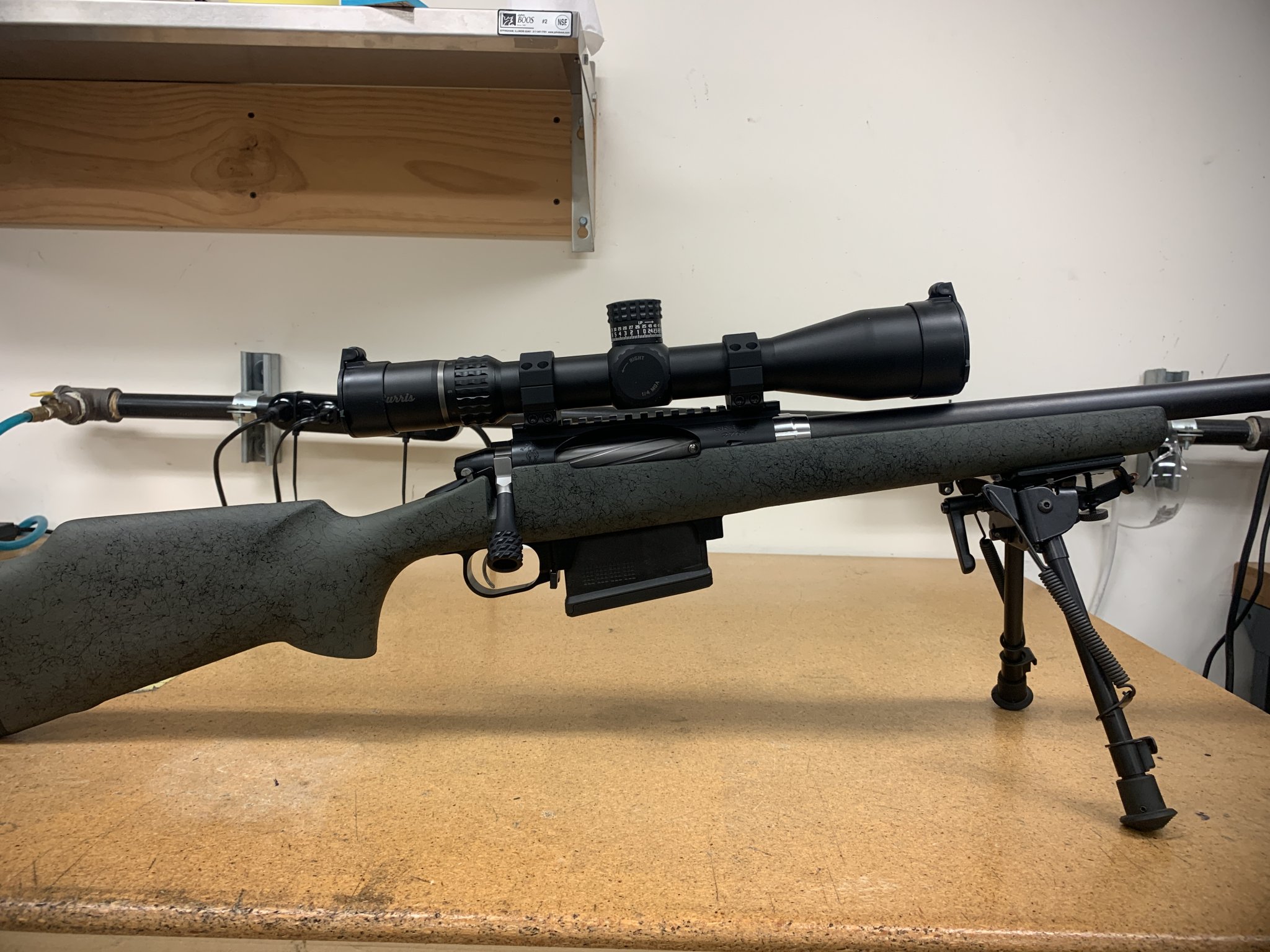

Just shamelessly piling on here, I already posted pics of mine in another thread. Anyway, the rifle is a Bighorn TL3 action with the 30 MOA rail and a medium tang, a Bartlein barrel chambered in 260 REM, sitting in a KRG X-Ray chassis with a Timney Calvin Elite trigger, topped with a Vortex Razor 4.5-27x56 and tipped with Thunder Beast's Ultra 7. So far she seems to be liking the ELD-Ms, now if I could just find those available somewhere.
Such a great looking rig!

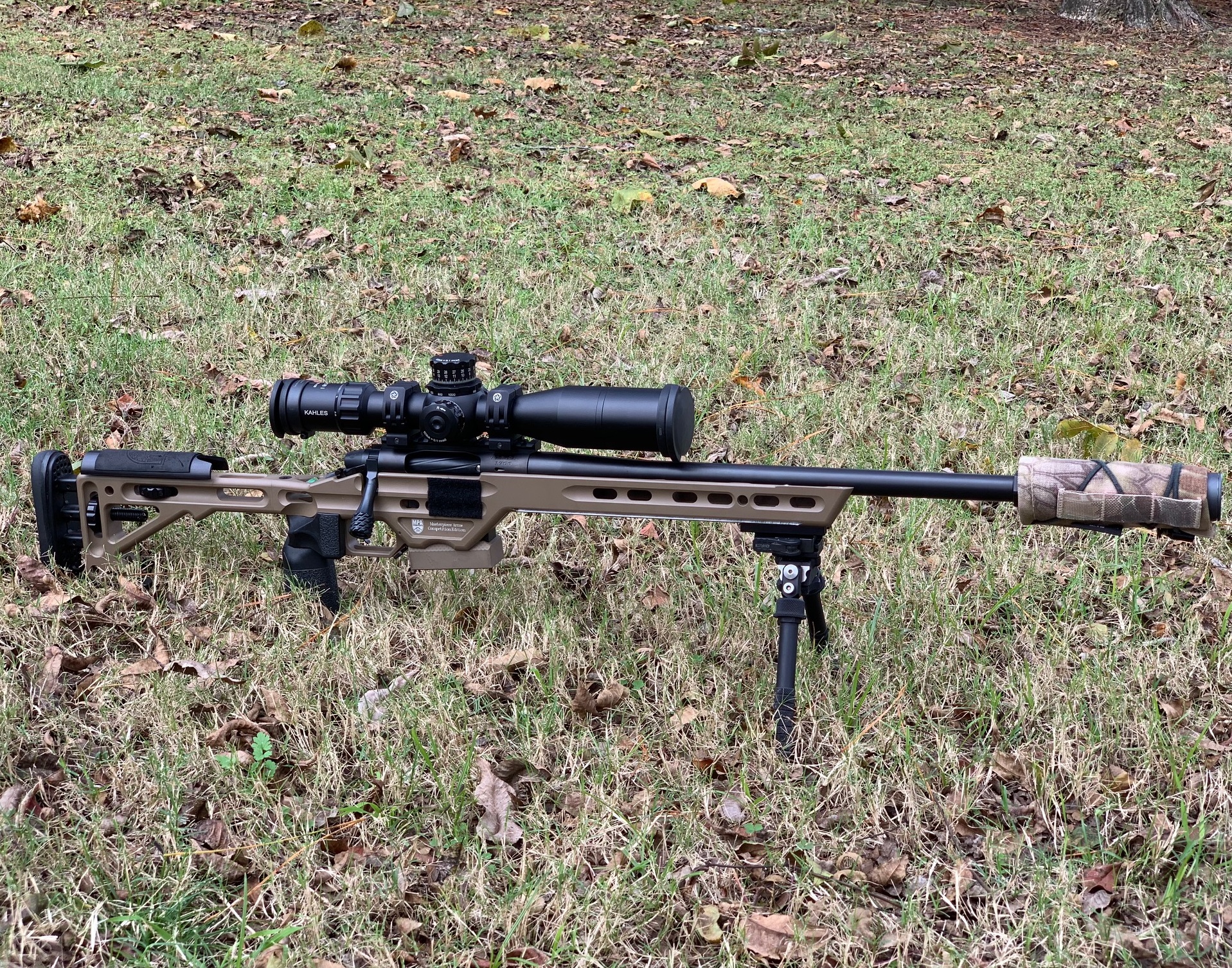

Cool. Bighorn had a RBLP TL3 on the shelf yesterday so I picked that up and ordered an Exodus Light from Foundation. Trying to decide on calibers but I’m going to run a proof sendero and MTU Brux topped off with an AMG
Reactions: Estes640

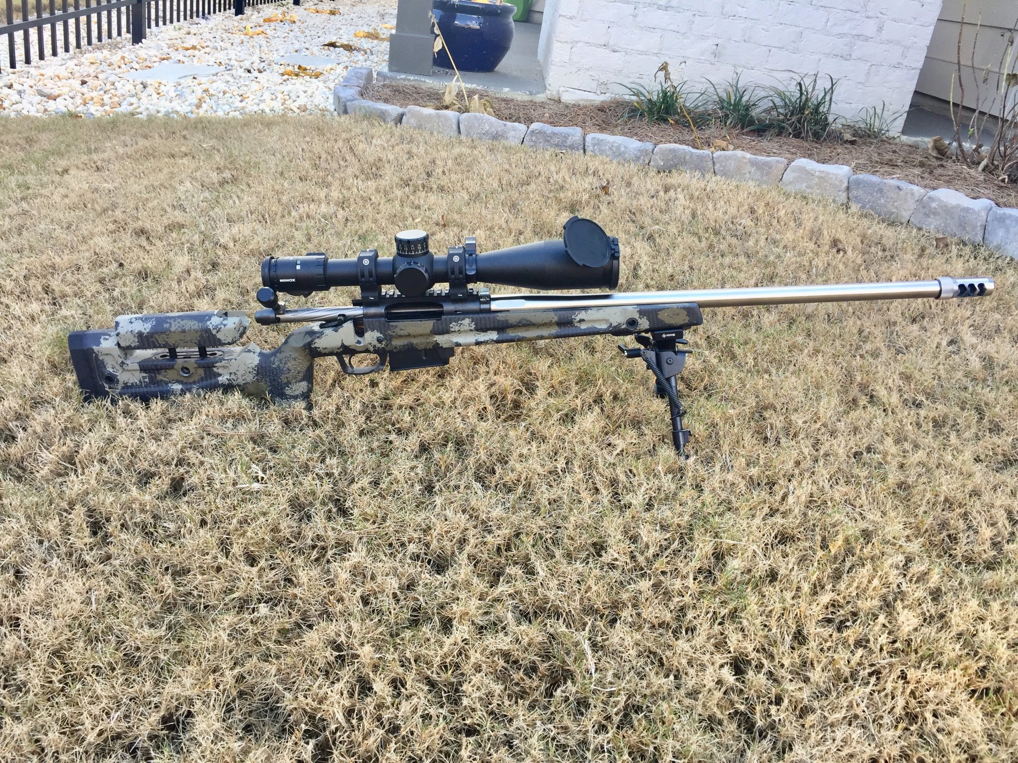

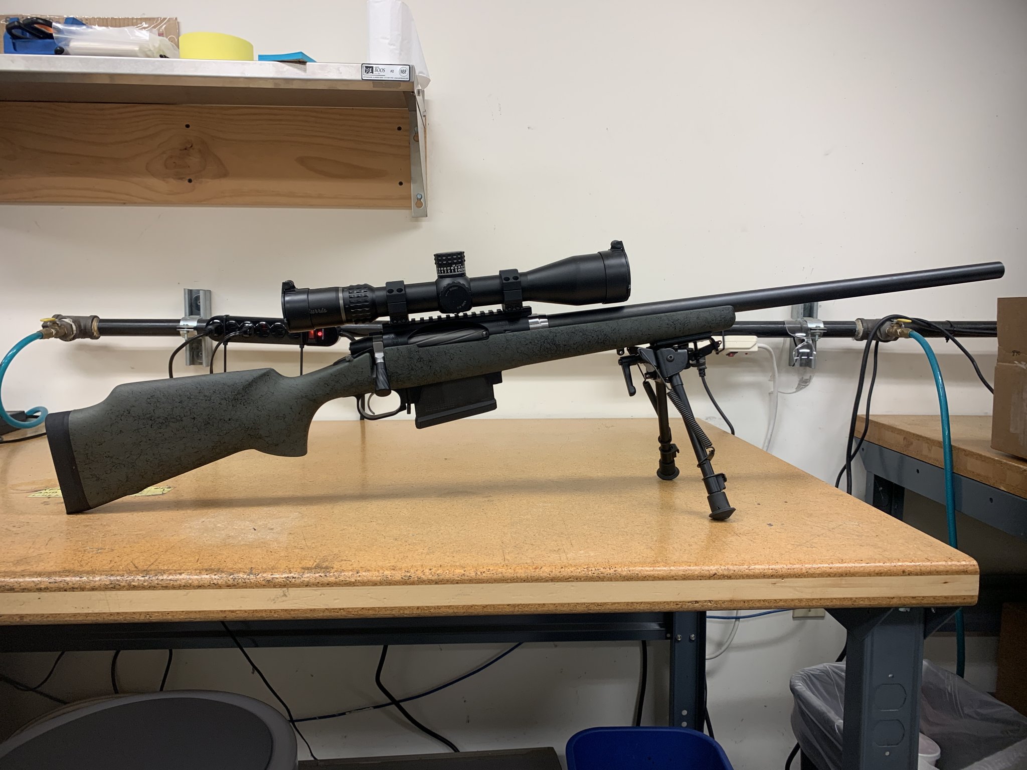

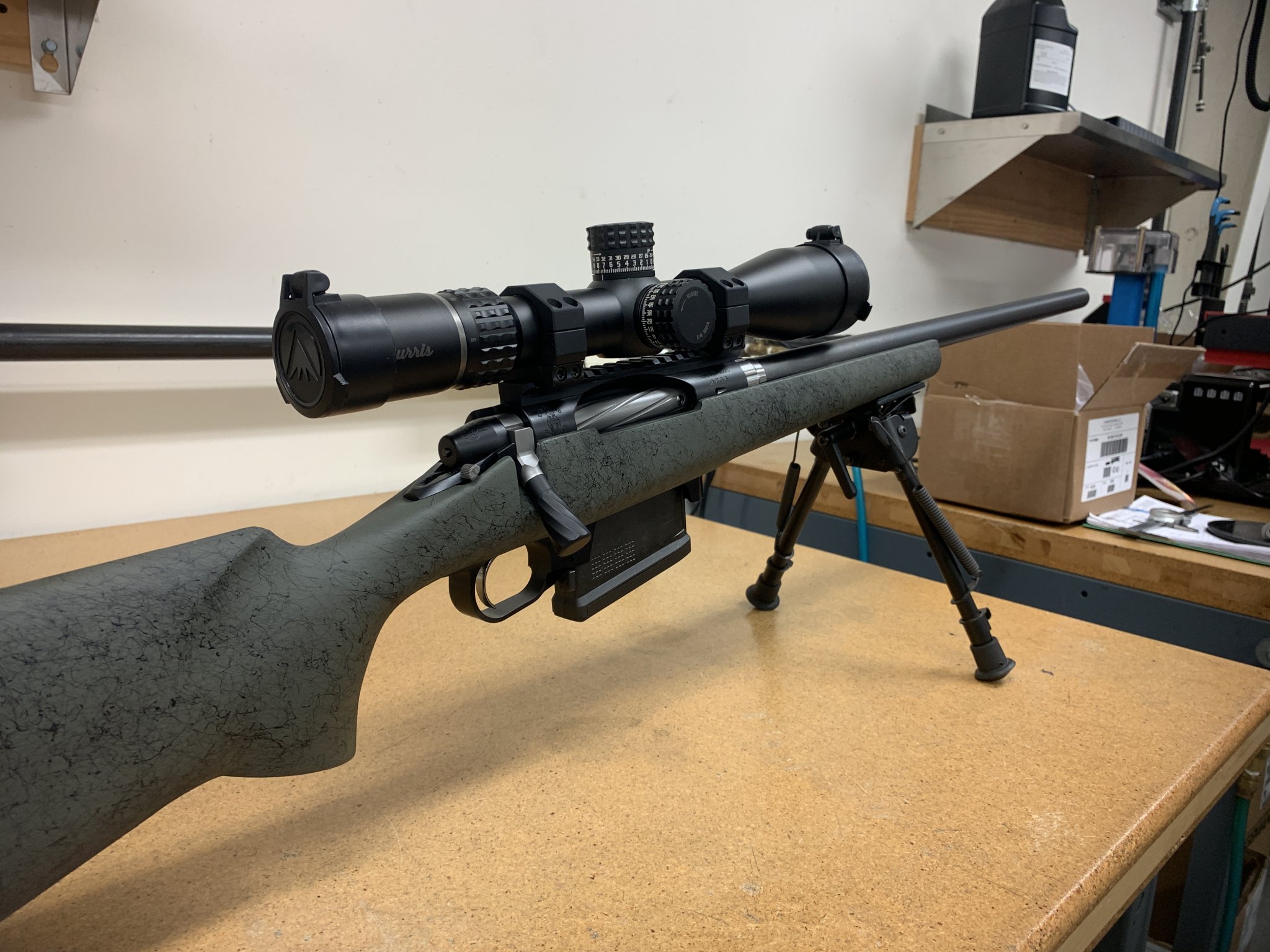

Long awaited rifle upgrade...
SR3 LA Mag Boltface
Grayboe Terrain
Hawkins M5 DBM
Magpul AI LA Mag (doesn’t work need to get a metal AI mag)
TriggerTech Special
7 Rem Mag 24” factory Savage Varmint barrel, NSS barrel nut, going to shoot this thing til I can afford a Proof CF barrel.
Not sure on Bolt Knobs yet, definitely like the larger, longer knob better, but maybe switch to the Tactical instead of the Knurled for me...
Stock needs some fitting work, barrel’s not floating at all, bolt touching stock cutout. It’s going to my local Smith this week for a full pillar and glass bedding job. Will have him fix the stock issues as well. Love it so far, definitely too heavy, will need to get that Proof sooner than later. Thanks for all the inspiration on this thread.
Reactions: Chargerguy
