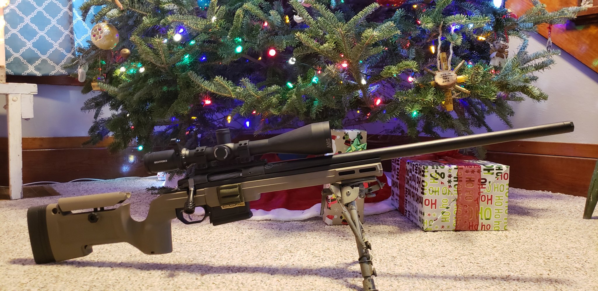

Well, I dont think the wife appreciates this Christmas decoration, but I am pretty excited for my first TL3.
Pva 6.5 creed 24 inch barrel, with a 6 creed and 223 on the way

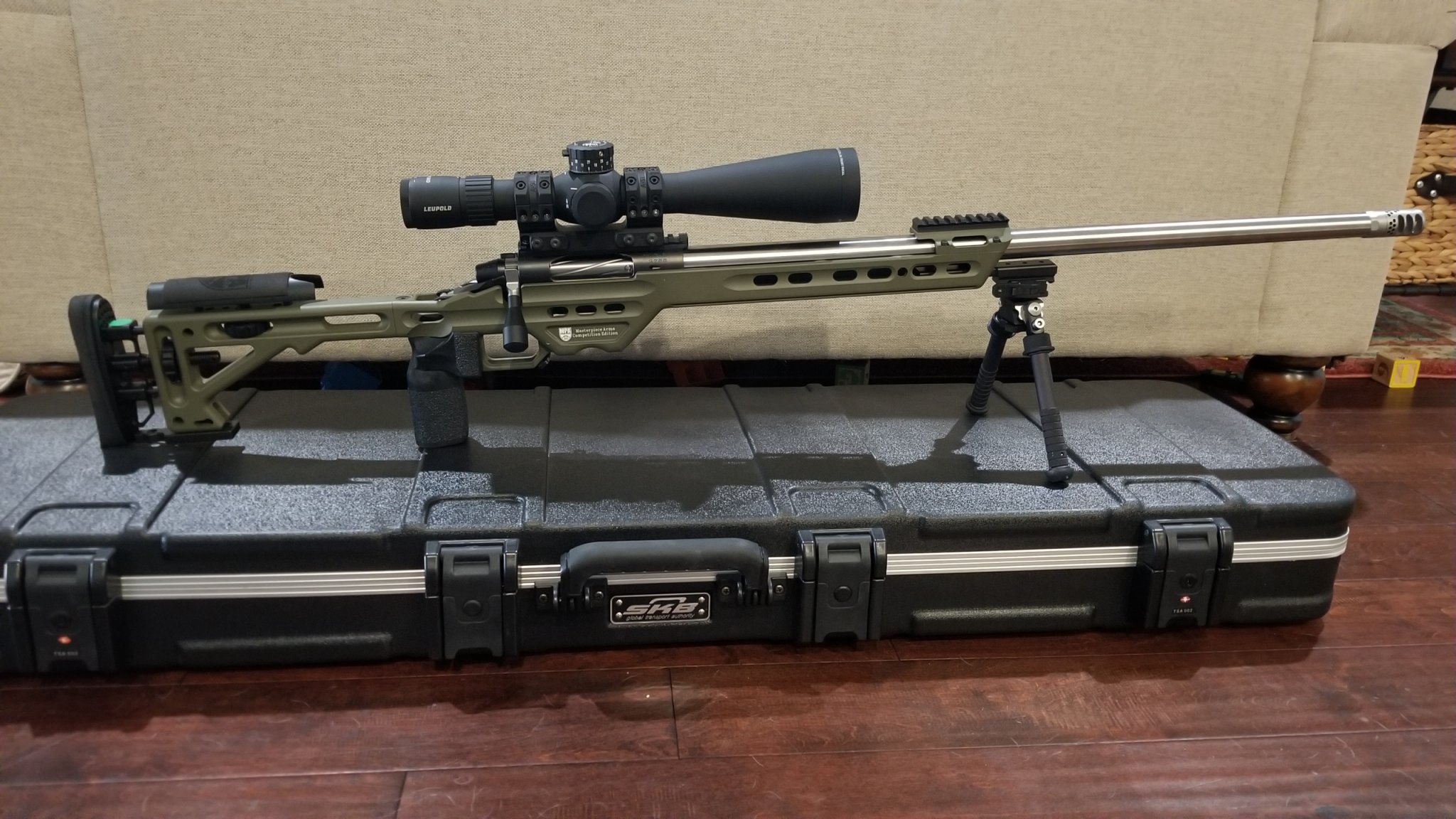

Here is my rifle!
  • Bighorn Arms TL3 Left Hand Short Action with standard bolt face
  • KRG Bravo fitted now to take a left hand action.
  • 20" Fluted and threaded .308 barrel
  • 40X trigger
  • 10 round AW Magazine
  • Magpul Bipod
Awesome! Do you find the bravo "worthy" of the action? Anything lacking? Im thinking about getting a bravo for my build.
