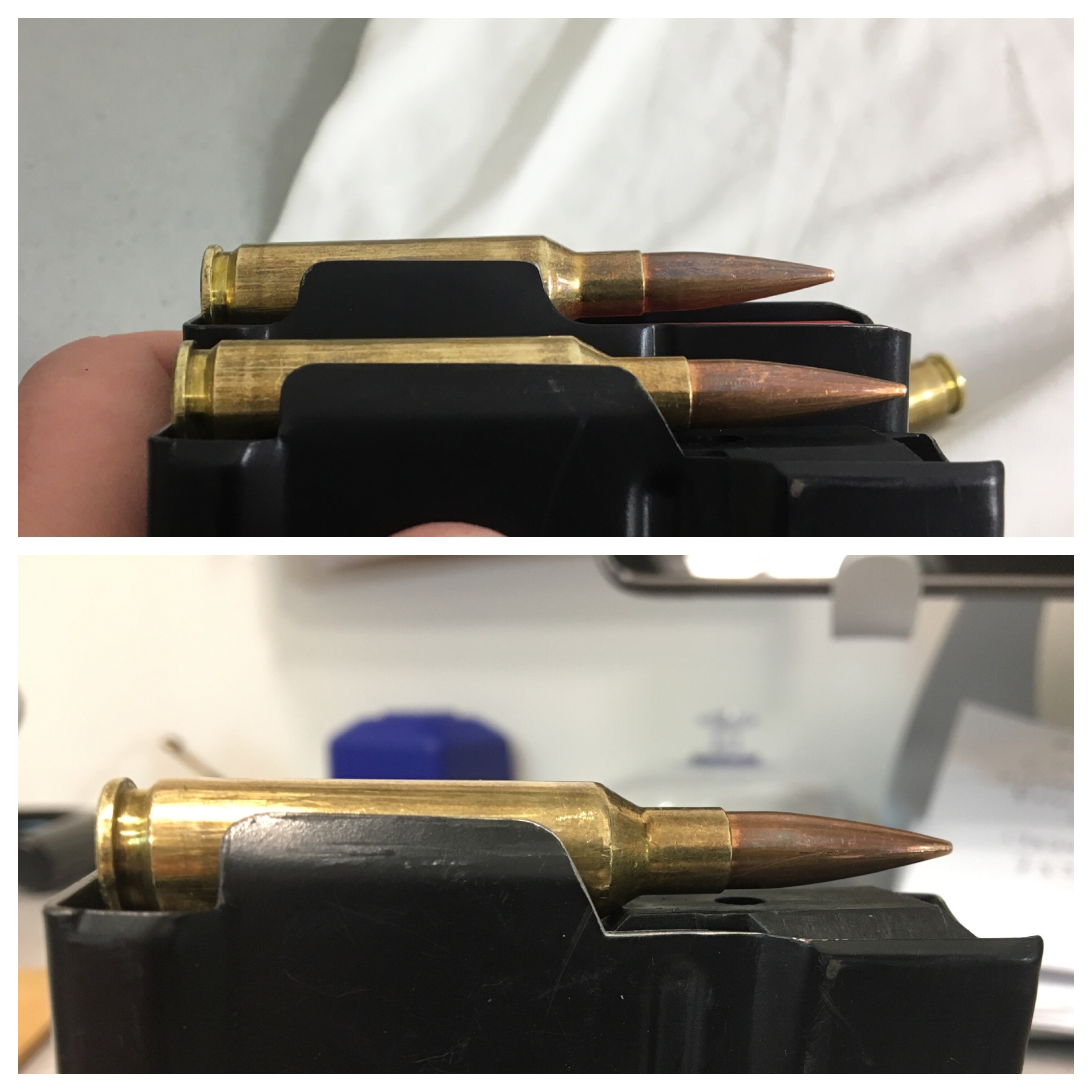

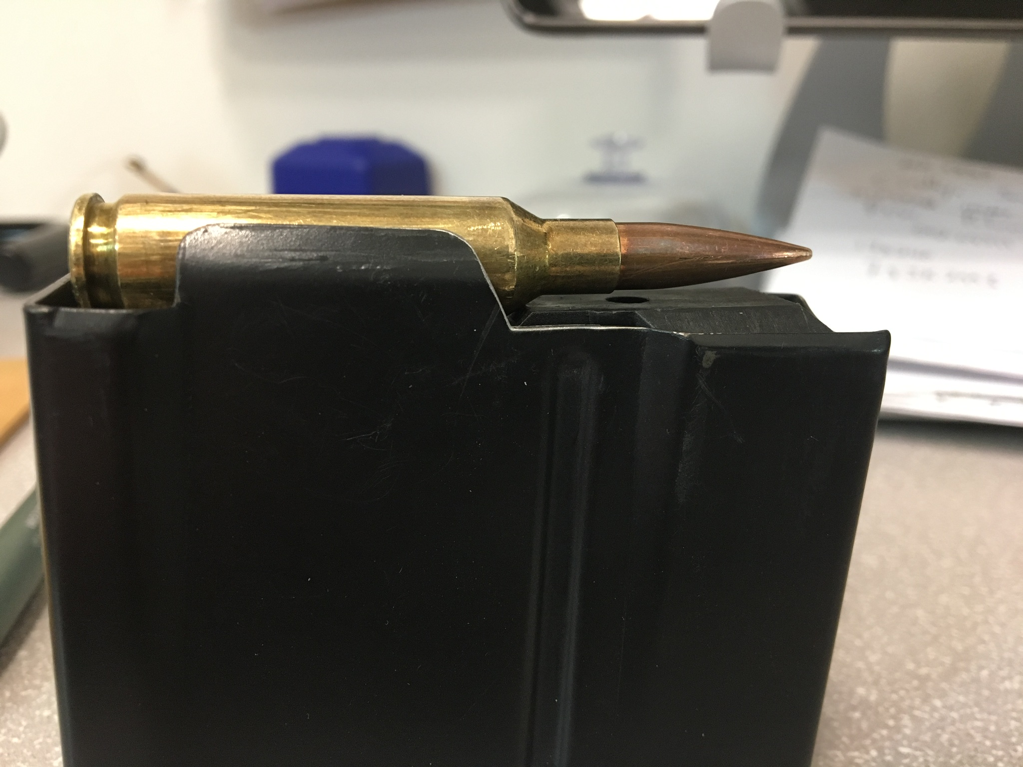

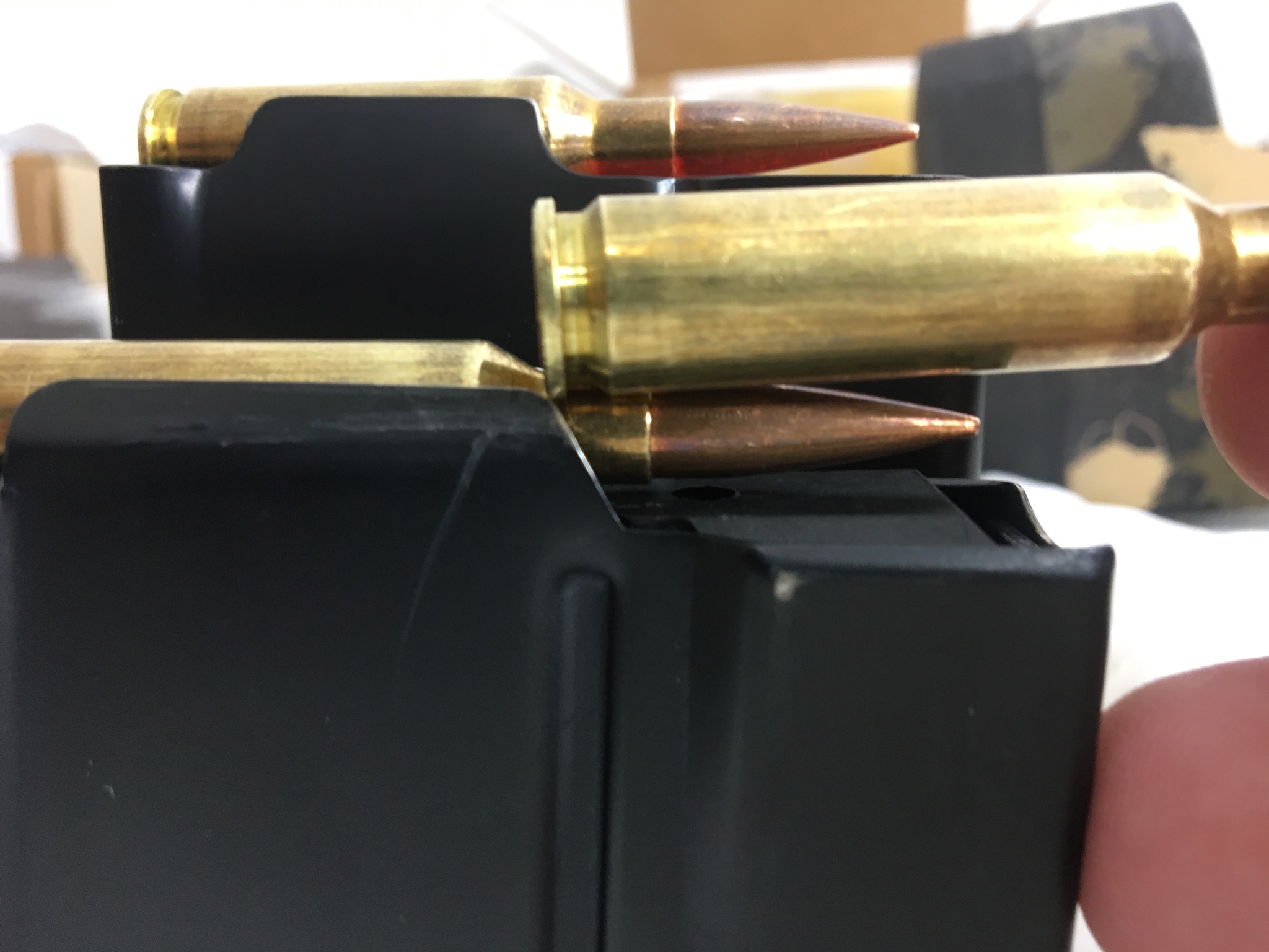

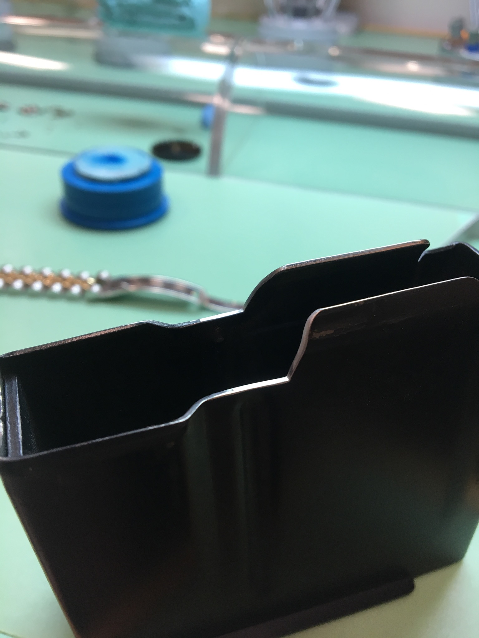

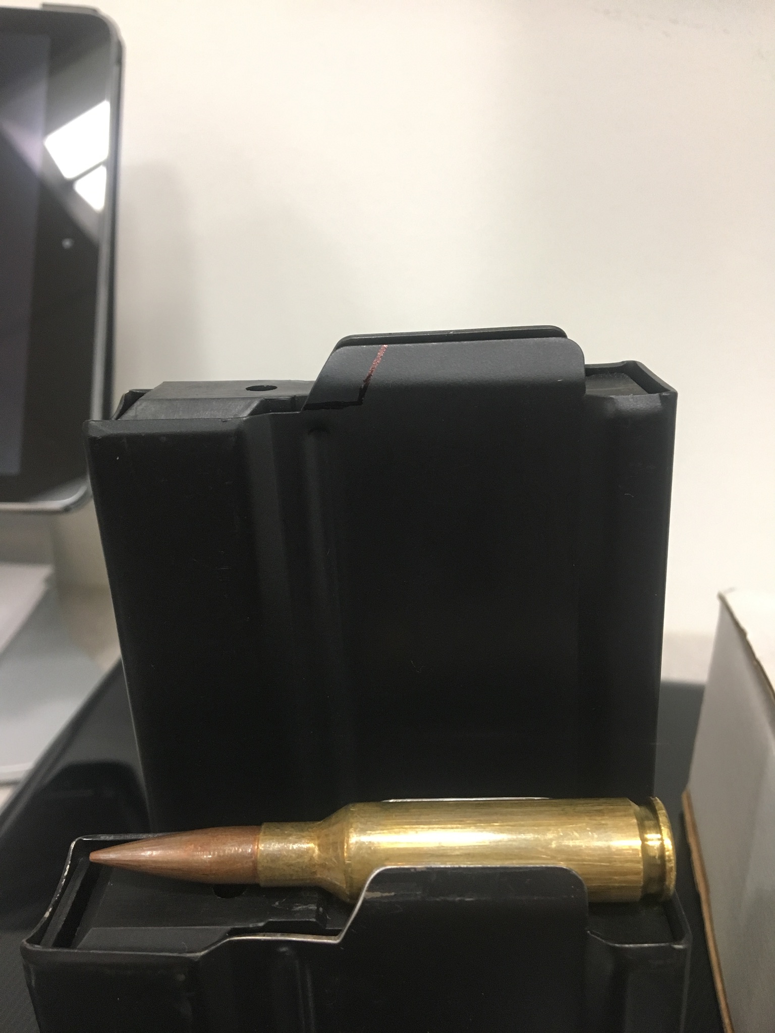

You can see how the timing on the magazine is crucial to match the cartridge length for CRF. This magazine has had the feed lip shortened so that the lower cartridge presents a bit of the body instead of the neck to push up on the upper cartridge as it clears the feed lip. If the lower neck is presented upward it doesn’t have enough height to push the upper cartridge into the bolt face fully. If the shoulder is presented when the upper cartridge clears the feed lips it will pop the upper cartridge forward faster than up resulting in push feeding.
Factory AICS magazine in foreground (note the lower case is pushing up with the neck. ARC magazine in the background (pushing up/forward) with the shoulder. Cartridge is 6.5Creedmoor

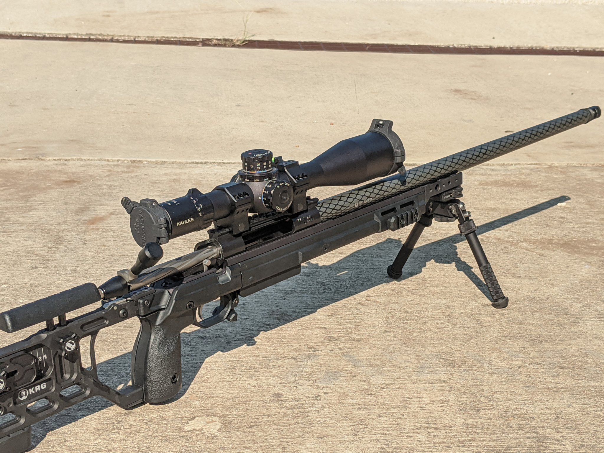

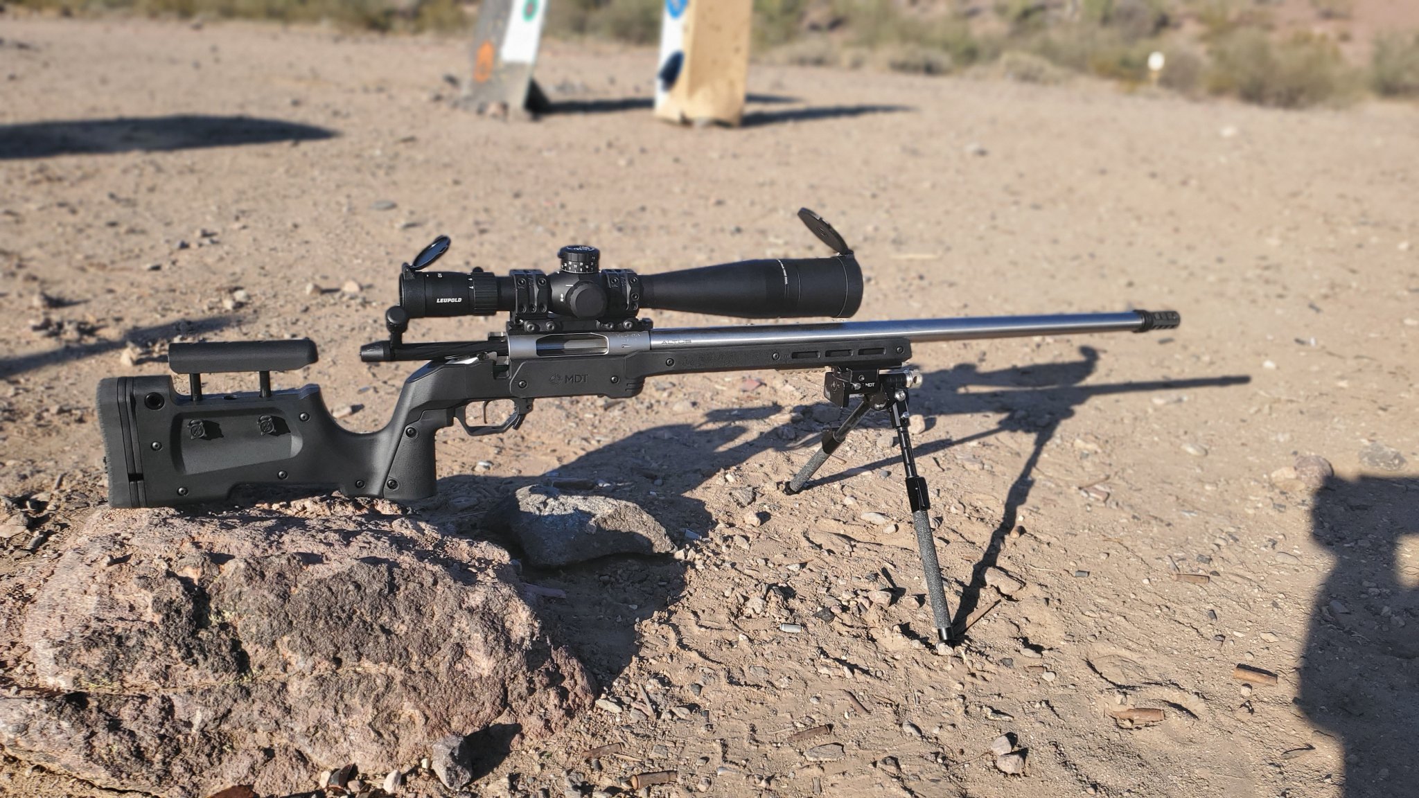

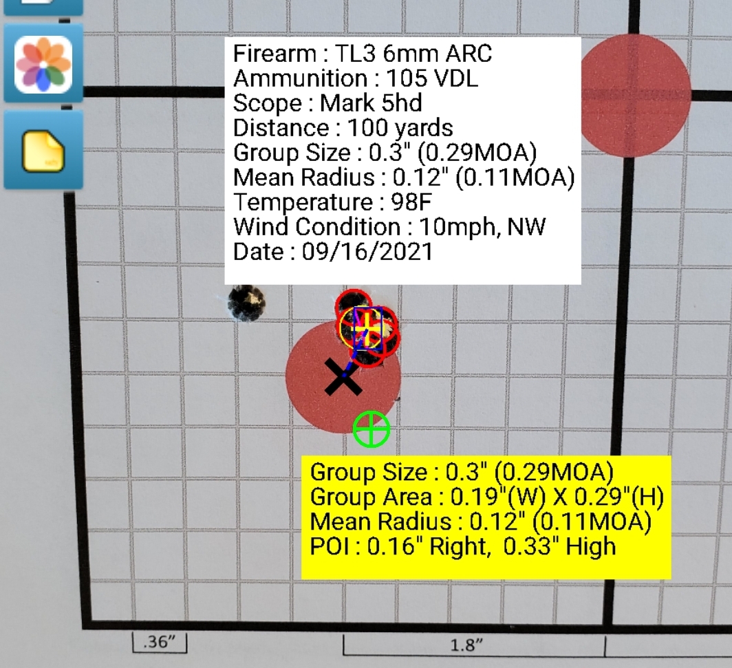

TL3 in 6mm ARC with manners PRS TCS. And mark 5hd 5-25x56 used for PRS type shooting
That is an awesome rig... Even in 6ARC!
To be honest, if I were starting over today, that's exactly how I would set mine up. I have an early stainless model TL3, but I much prefer the black, I have a T6A, but the PRS-TCS wasn't available back then, otherwise I would have bought that.

So are you saying all magazines need to be modified to be used in the TL3? Or just ARC mags?
Yes, no. The brand of magazine doesn’t matter here, the ARC mag JUST comes standard with shorter feed lios than factory AICS magazines. ALL feed lips need to pair with cartridge length for CRFing. Shorter feed lips will CRF more (longer) cartridges than longer lips but too short of feeding lips and you may find stability isdues where the cartridges will want to escape out the front 2/3 (or whatever) under impact. This trim to properly fit the cartridge bring used.

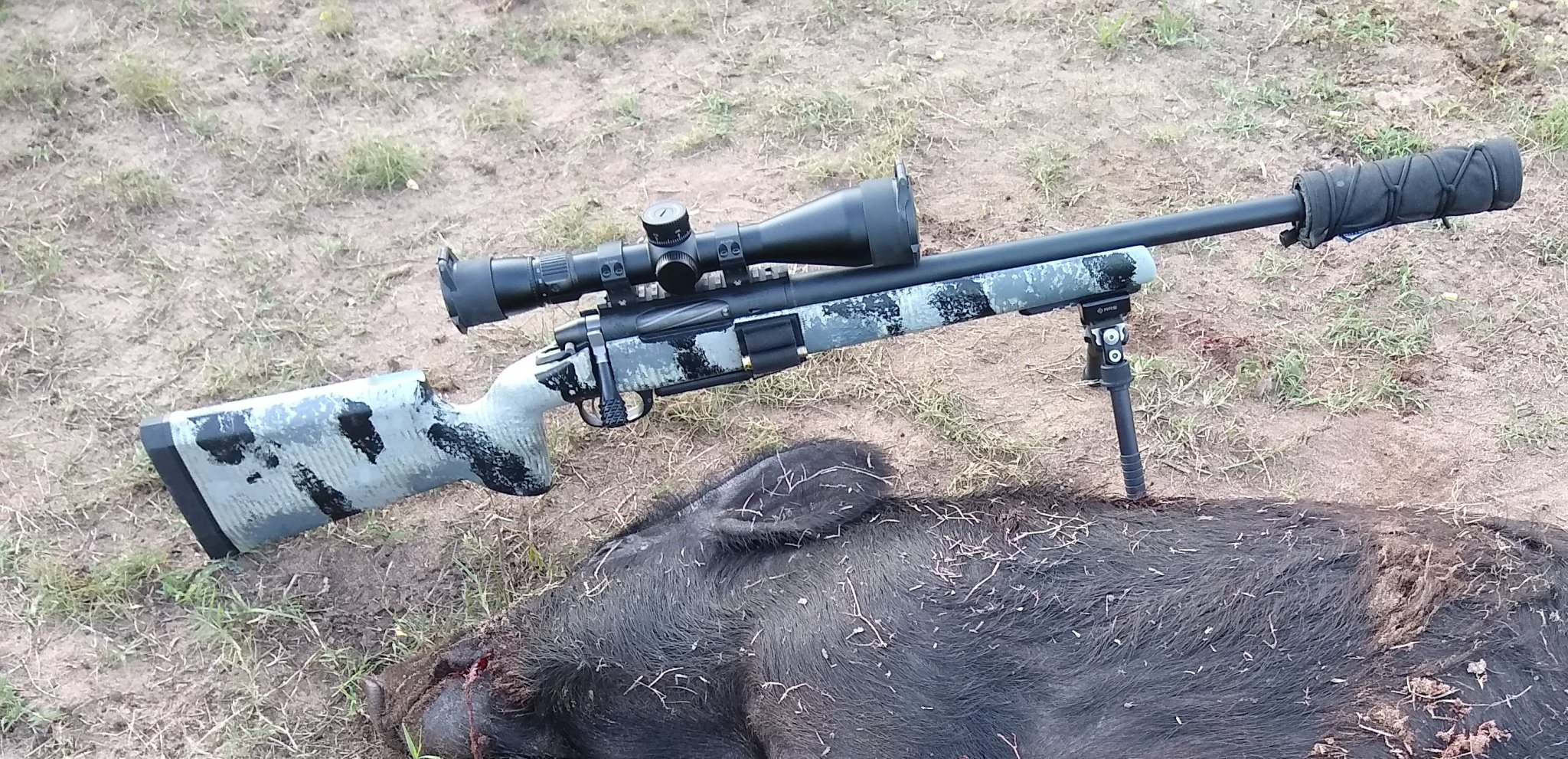

Took my TL3 chambered in 22-250 AI out for a spin in WY this weekend - it's shooting very well with the 88 gr ELDMs and RL-23. Smoked a coyote at 600 yards Friday evening and then shot my buck at 315 yards the next morning. The TL3 just continues to impress!
Bighorn TL3
X-Caliber 22" 22-250AI 1:8 twist
Manners PRS2 w/ mini chassis
Triggertech Special
Gunwerks 8ight suppressor
Vortex PST II 5-25

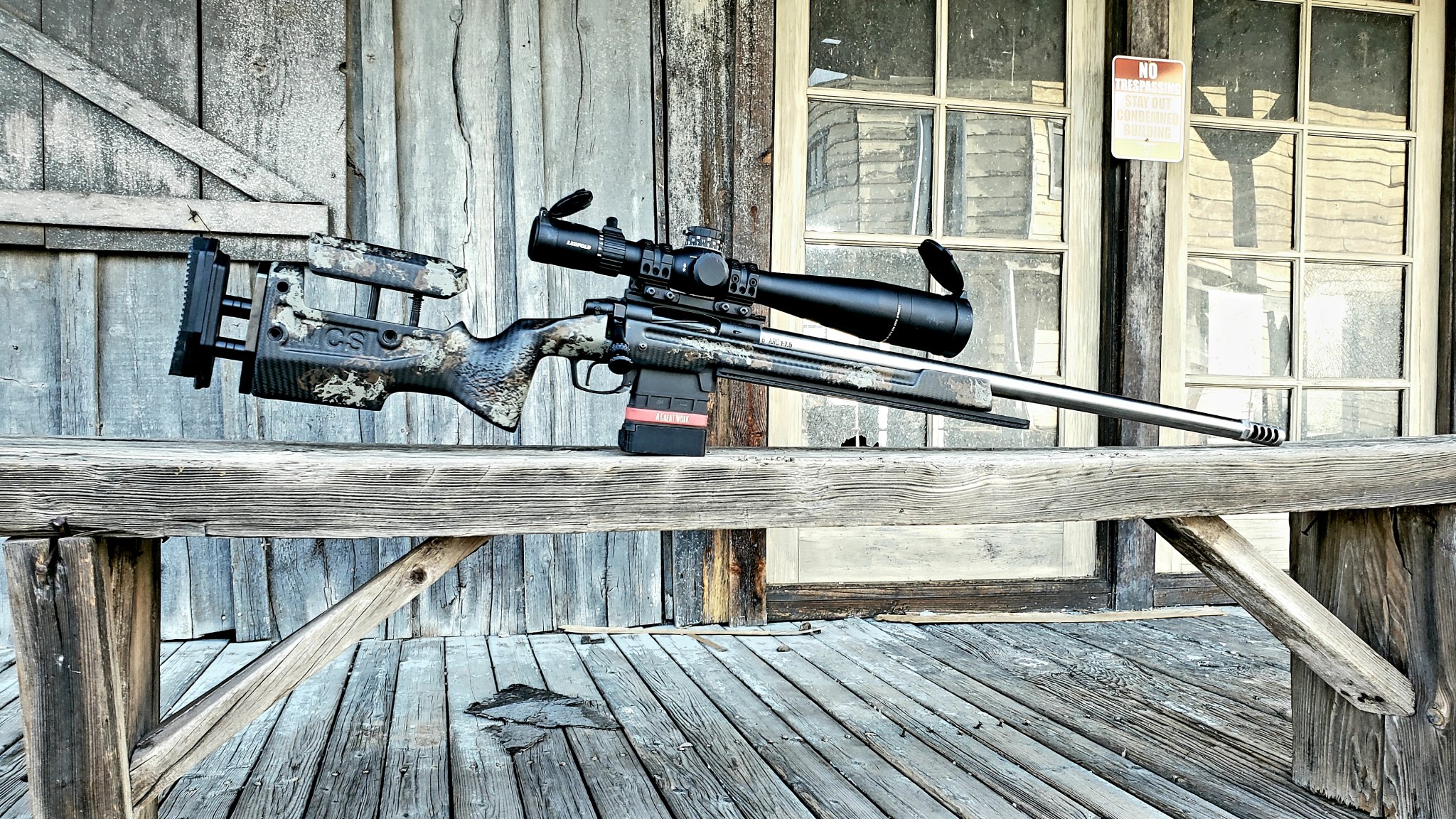

How my TL3 currently sits. Mostly used for hunting, but sometimes I'll put it in a chassis for local matches.
Bighorn TL3
TT special
Manners EH1
Vortex Razor LHT 4.5-22x50
18" bartlein .308, 24" proof CF 65prc, 26"6cm, 20" 65cm on the way.

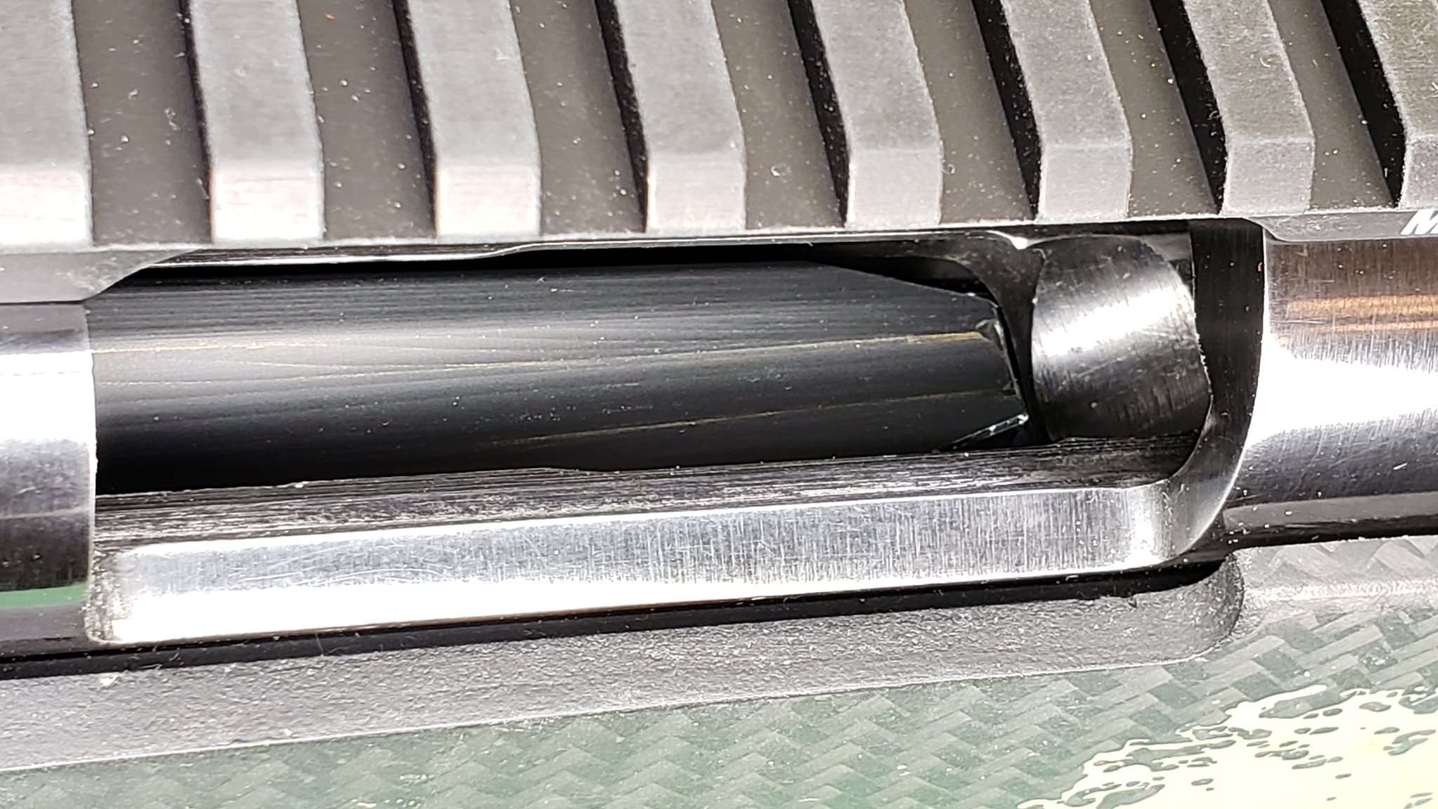

I know Zermatt can build these in a single shot configuration. Any issues with the extractor plate sliding over cases braking or having extraction issues when these bolt heads are ran in single shot mode?

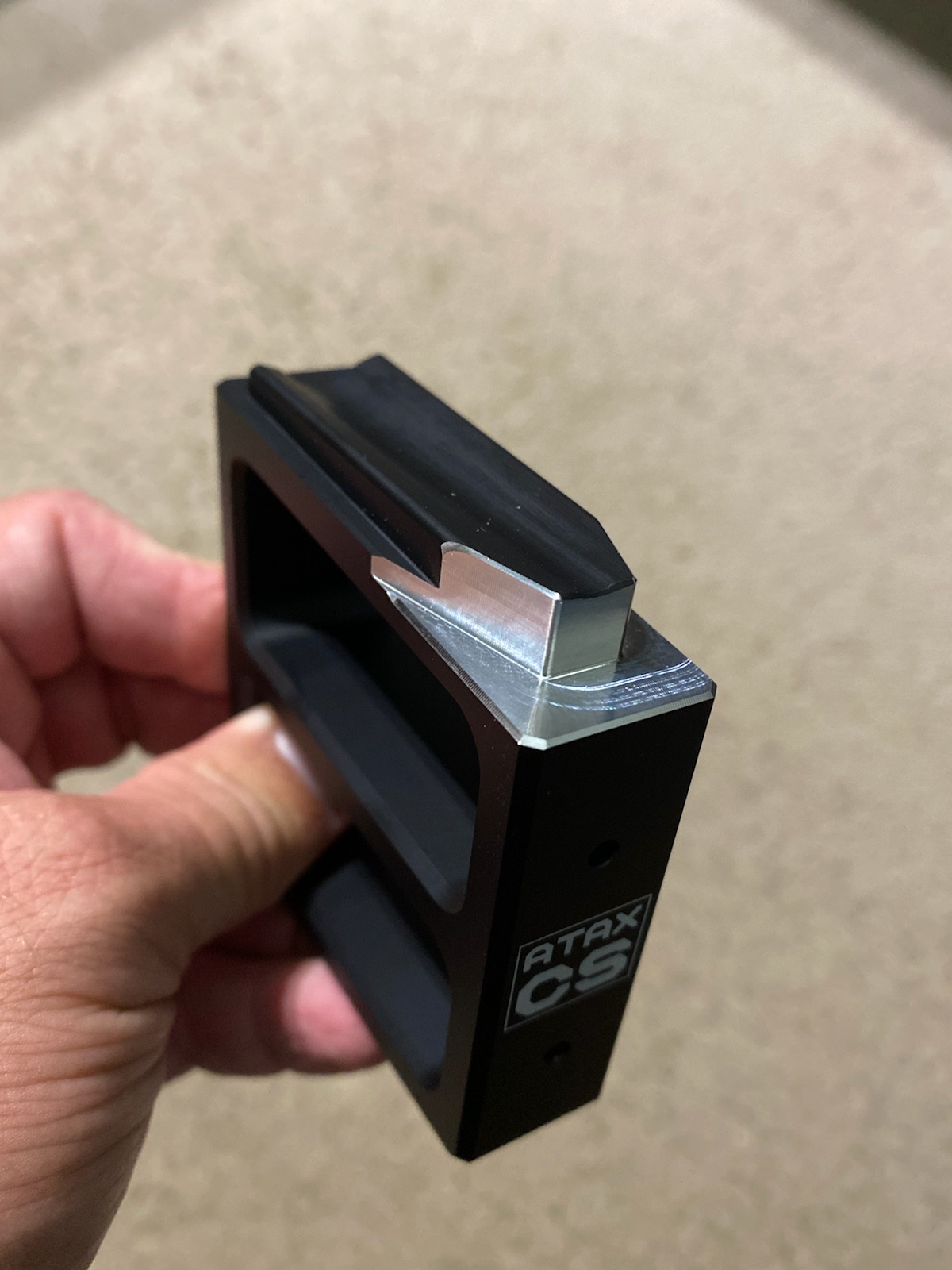

Range and load development I run sleds from CNC Werks. Will also let you know if your TL3 is AI cut the AICS/CS sled will need modified and CNCSWERKS can make it happen, just let them know when ordering. The sled they offer for AW requires no additional mods. Hope this helps.
These work on origin actions?
