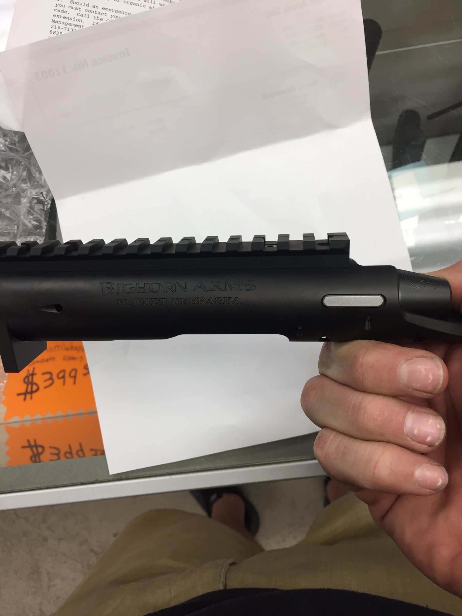

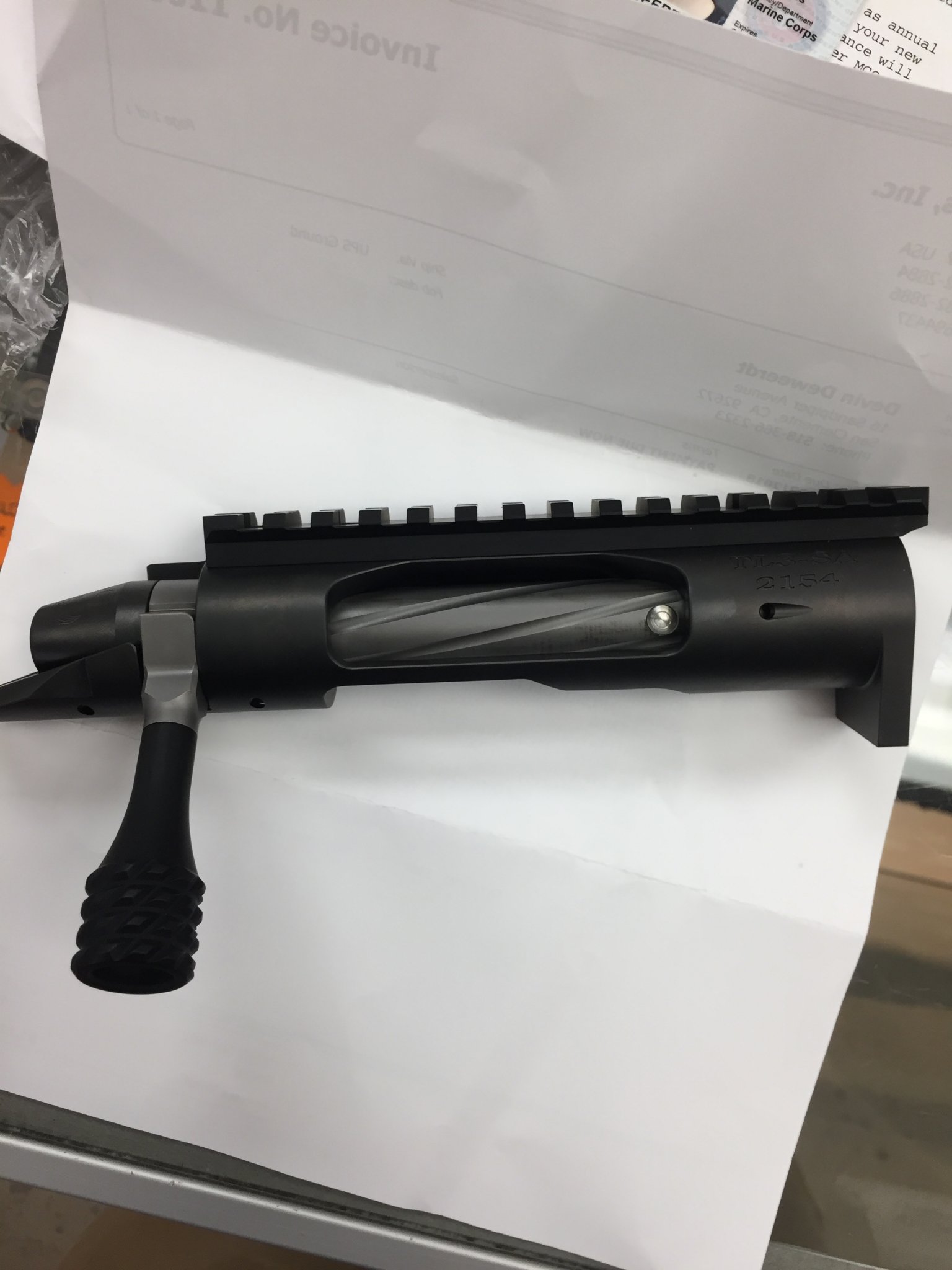

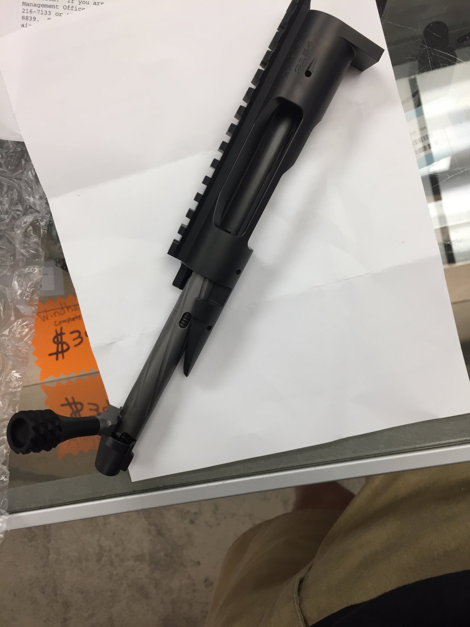

Okay, had to get some pics for you guys. :)
[IMG2=JSON]{"data-align":"none","data-size":"full","src":"https:\/\/i.imgur.com\/EwclQTo.jpg"}[/IMG2]
[IMG2=JSON]{"data-align":"none","data-size":"full","src":"https:\/\/i.imgur.com\/rC1Nxp5.jpg"}[/IMG2]
Chad at CCG was good to deal with. Easy to get ahold of, answered all my questions and gave me an honest quote on lead times and then met the low end of his estimate. I got the action in hand straight from Bighorn, did no prep work on it other than to disassemble it completely and send just the bare receiver body and bolt release button to Chad. I think prices recently went up but it's around $120 for the bare receiver and then another $10-15 for the bolt release, plus shipping. A bit more expensive than Bighorn, plus the logistics, so if I'd known Bighorn was going to start offering it I would have probably gone that way.
I'm definitely a fan of DLC coating, both my actions are DLC. Between the two I do notice that the older one is slicker. Both are very low effort to cycle the bolt but my first action is a bit more glassy and ultra smooth. Looking back on it they both felt about the same at the start but the first one has 3k live rounds and 10-15k dry fire cycles on it.
Love having a pair of the TL-3 actions. They both match perfectly for headspace, the barrels clock identically with the engraving in the same spot. Have multiple barrels from 223 all the way up through 7 SAUM so can basically make whatever rifle I want at the drop of a hat. Right now the Manners is a 223 trainer and the MPA is my competition rifle in 6 Dasher, though I'm always experimenting.
It's to mention if you don't remove the button like Sheldon did you will get charged more. When i saw his prices for disassembled i assumed the bare receiver was fine and didn't touch the mechanical ejector or bolt stop button, which cost me some and drove the price up. But he does great work as Shelon noted and is just an all around easy guy to deal with. He also offers polishing as well, which to be fair i still haven't come across an action as smooth as my tempest i let him polish and DLC.
