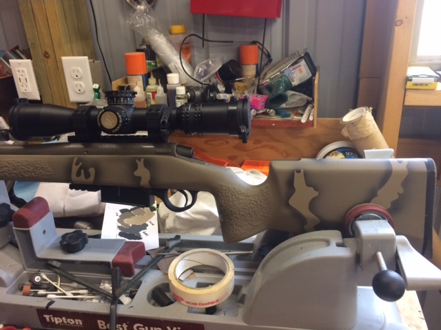

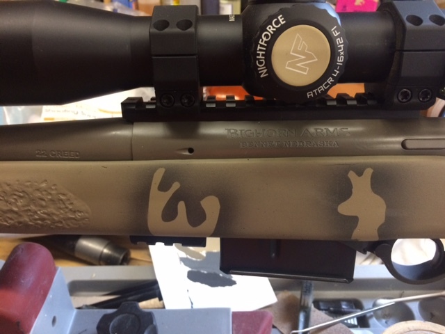

I built this a couple months ago on a TL3. 26" Bartlein Rem varmint contour 7.7 twist, Manners EH1 (painted it with Cerakote H), Bix 'N Andy Tacsport trigger, Seekins DBM and cerakoted Elite Earth. It's shooting 82 grain Bergers at 3559 fps.
Sweet rig! Love the camo pattern!

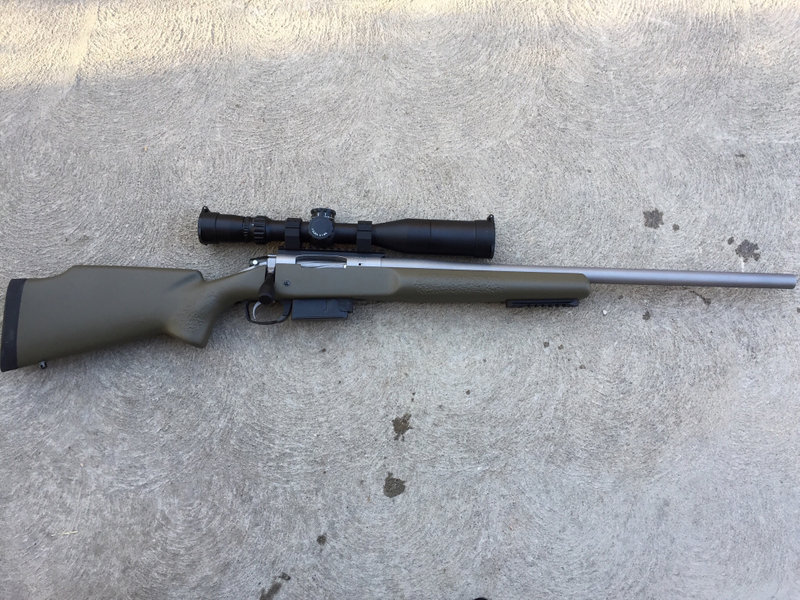

Finally got my action Friday, chambered the barrel yesterday and shot this morning a little. Ordered in December, so it's been quite a wait. 28 nosler, proof 1-8 twist, berger 195 seated at coal 3.730,
