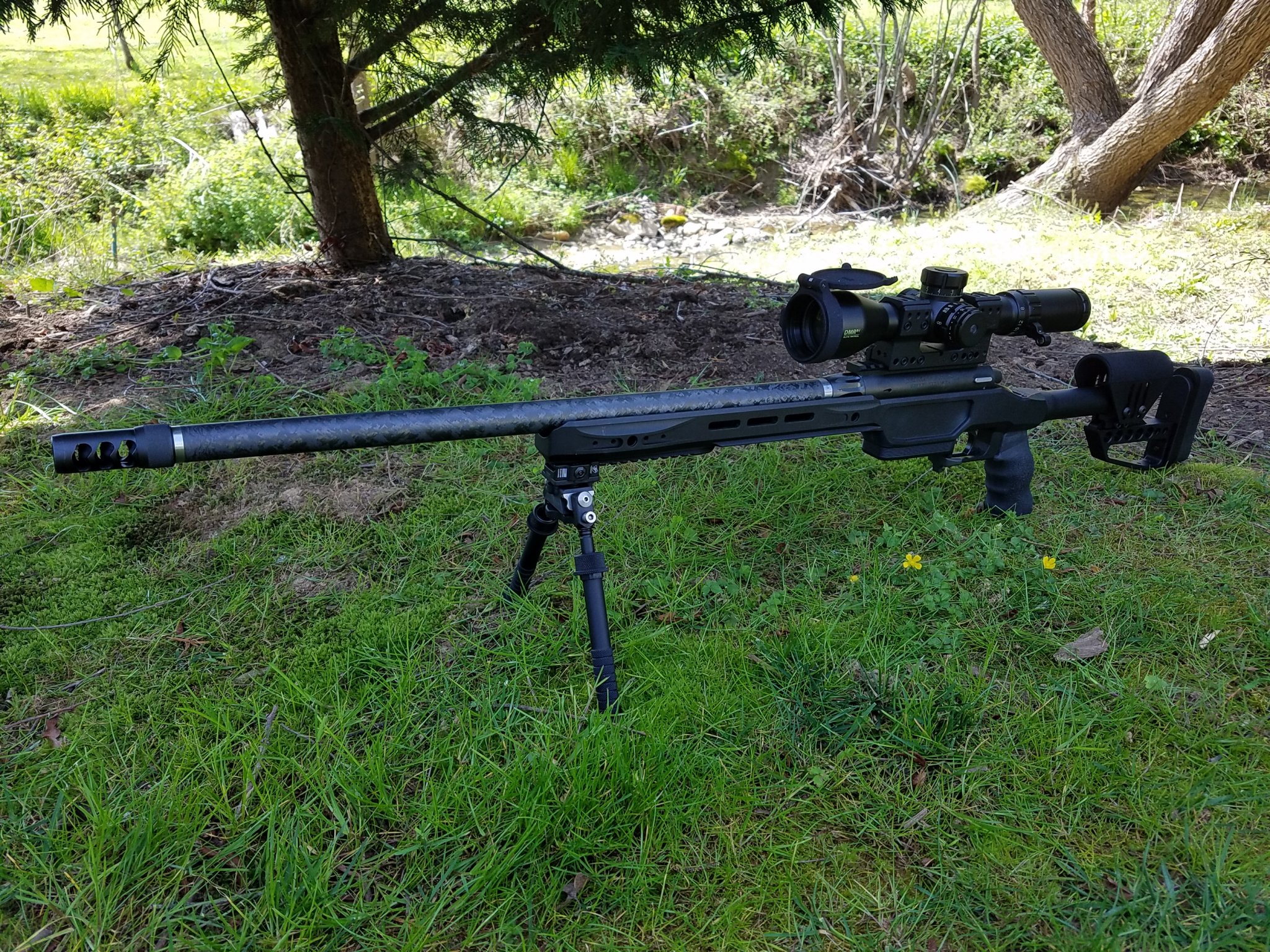

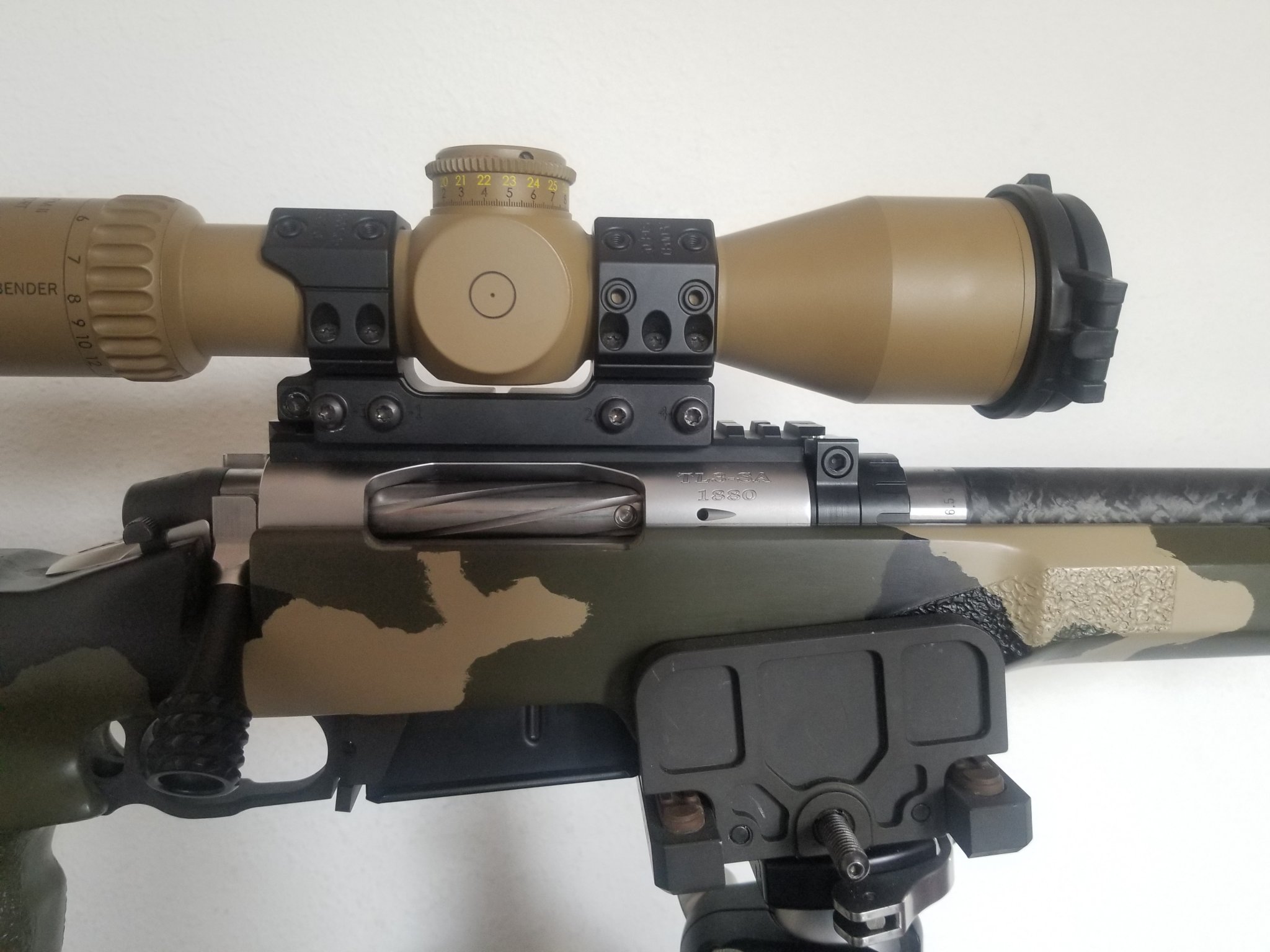

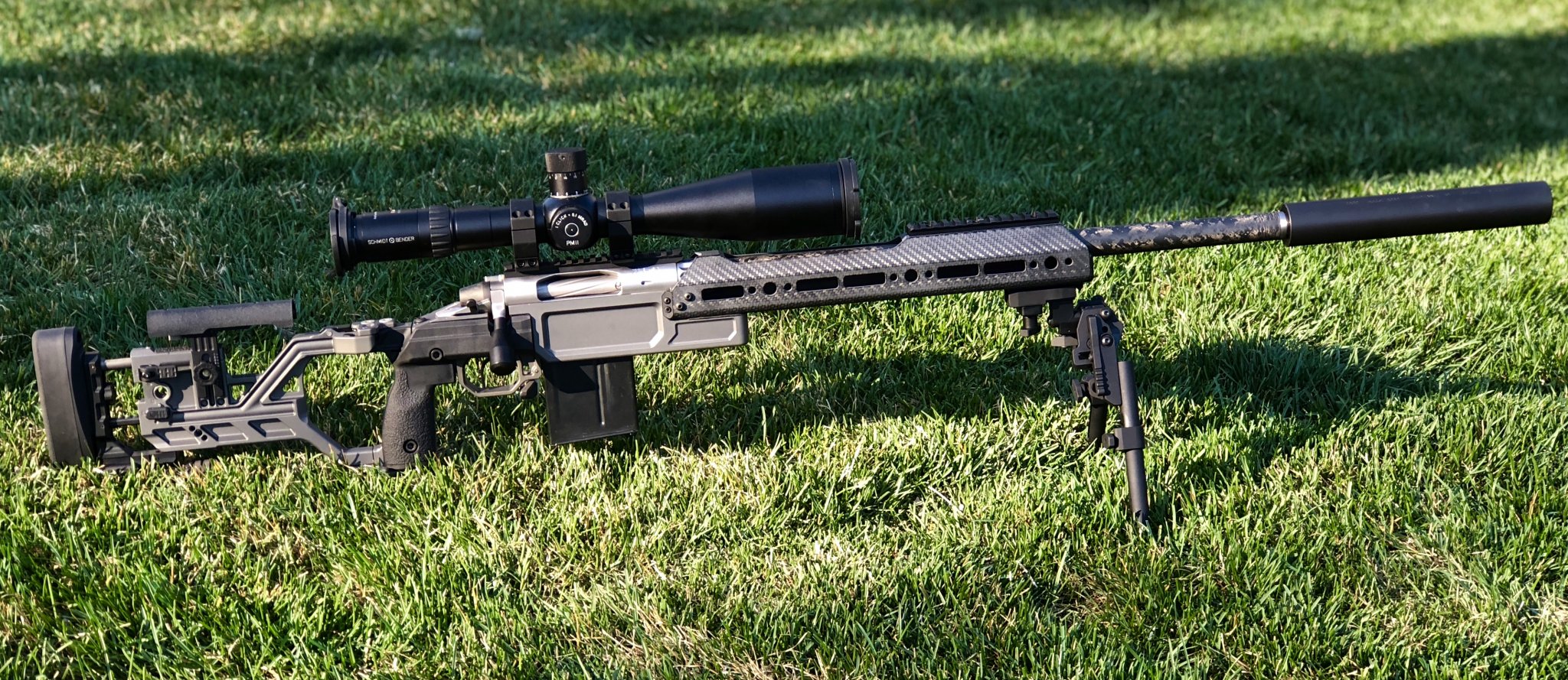

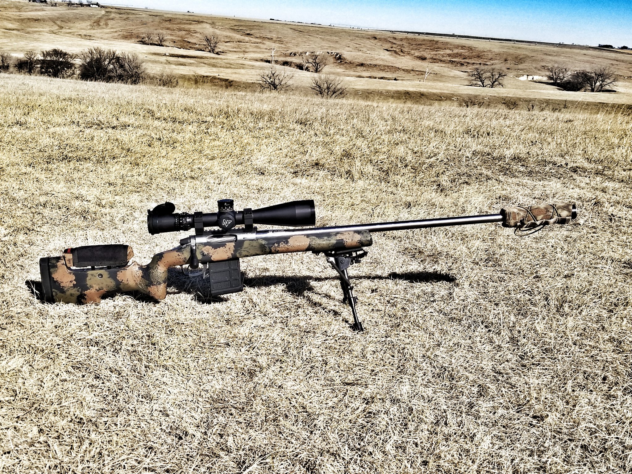

Here she is. Left handed with a k and p 1-8 left hand twist pipe IMG_1306.JPGIMG_1342.JPGIMG_1345.JPG

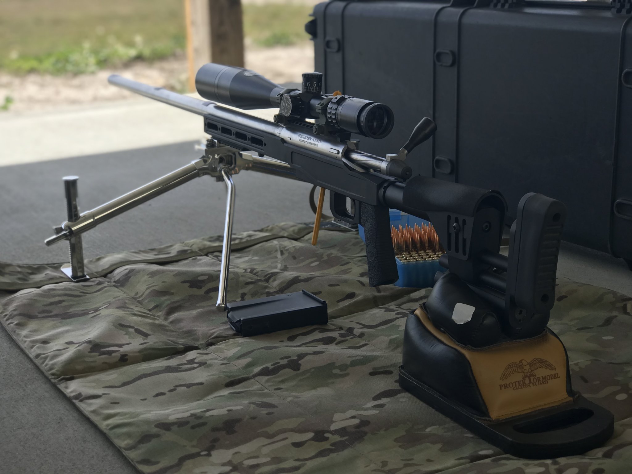

This is my 5th Proof carbon barrel, I've been nothing but impressed with their performance. They shoot every bit as good as my Bartlein's and they don't walk. I can shoot 20 shot's in a row and not get any fliers and then hold the barrel with bare hands.
I'll do a review of the Barloc after I get some rounds down range and do some barrel swaps. Barrel installation was a breeze. I have a 22 Creedmoor barrel for this one too that I'll be installing shortly to burn down some praire dogs and rock chucks with.

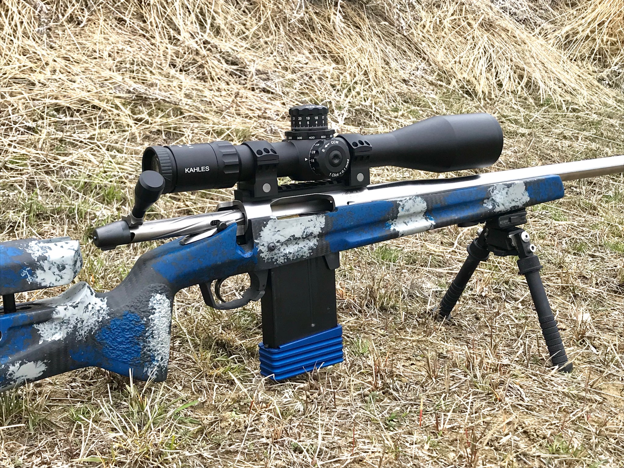

Is anyone running ARC rings on their TL3 with a 50mm objective scope and a M24 (or similar) barrel profile? I have a DMR2 mounted in Seekins low (0.90") rings over a Rem Varmint profile barrel, and I will be moving it to a TL3 build in the near future with a M24 barrel. I am thinking that when I put this scope over the heavier barrel, I am going to be very close to interfering with my scope caps. I am thinking ARC lows (0.94") but I am not sure.
Unless I can find a direct example to lead the way, I will probably just wait till I have the new rig in hand before selecting new rings, if needed at all. Any help is appreciated!
I run TL3 with ARC 0.94 Low rings and a S+B scope with a 56mm objective. The scope will clear the barrel even with a Heavy Varmint contour, though I can't fit scope caps on the Heavy Varmint setup. I can run scope caps with a Heavy Palma, but haven't measured how much extra clearance I have.
With a 50mm objective you should be able to run the low rings just fine.
Thanks you sir. I guess the question now is whether my Seekins low rings will be too close for comfort or if I will need to jump up the extra .04" that the ARC's provide. Secretly hoping for an excuse to pick up a set of the ARC rings... oh my how I long to mount a scope with 4 screws total vs the 12 on the Seekins!

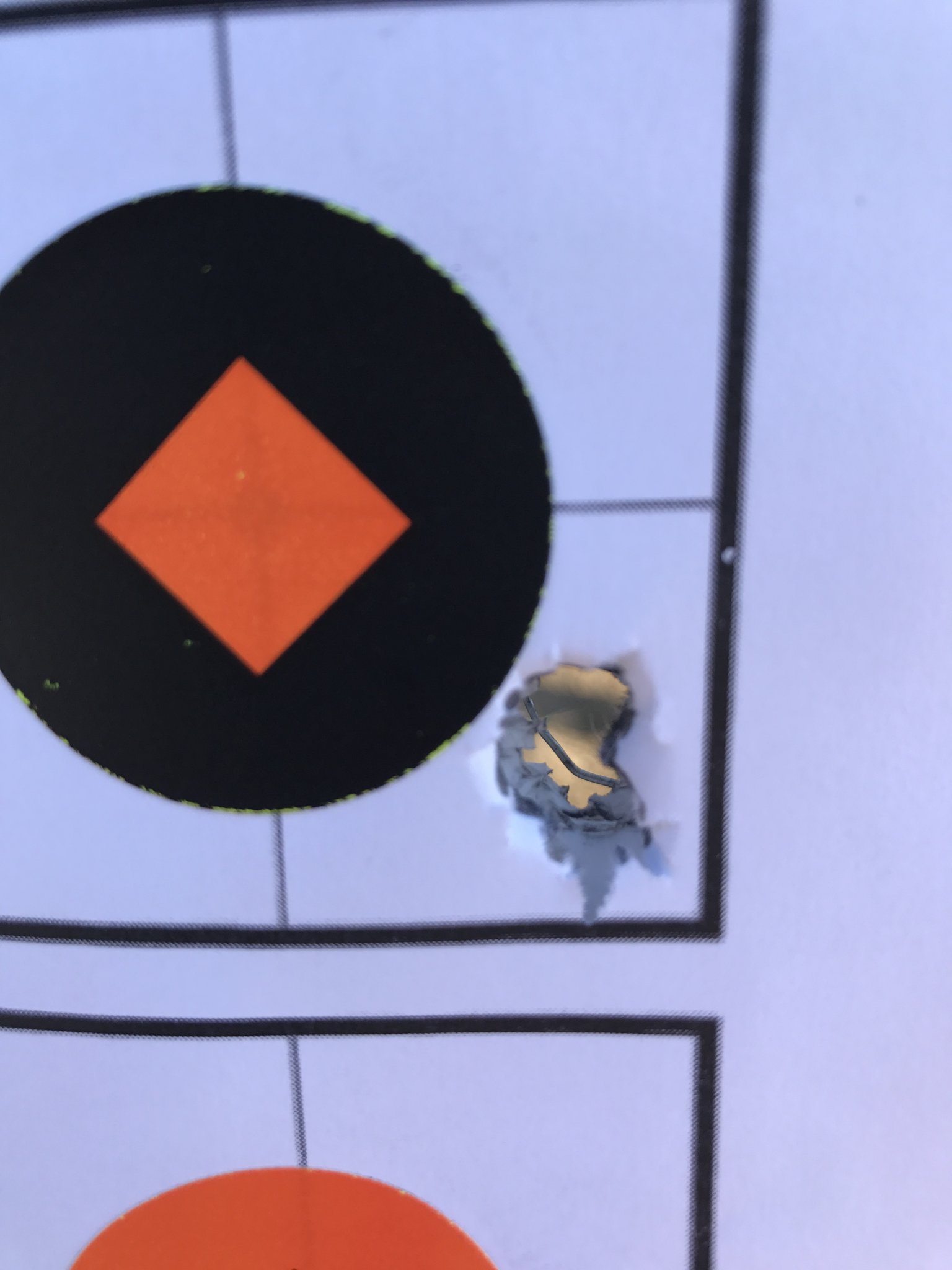

Here is a 4 shot group and a 9 shot group with my TL3. Rock creek barrel done by josh at PVA with out ever laying hands on the action. The larger 9 shot group was 3 different loads.

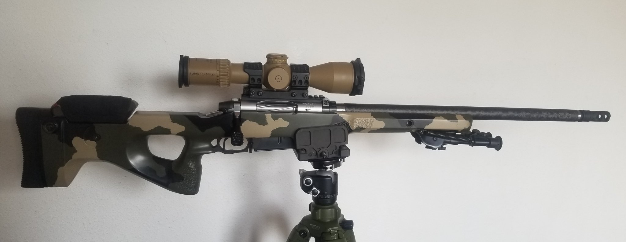

Hey guys I just put together a TL3 this weekend and I am having some feeding issues. It is a SA TL3 with a 223 bolt head, sitting in a Manners mini-chassis. Everything bolted up nicely, but I can't get it to feed at all. I have a MDT polymer mag that I had feeding well in another 223 rifle, and an accurate mag and neither of them worked.
Another thing that I thought was notable, was that I couldn't even get it to feed by placing a round right on top of the magazine through the ejection port. The same type of jam shown below in the picture occurred whether I tried to feed by the mag or just single loading. It almost seems as if the extractor isn't allowing the case rim to slide up into the bolt face easily. It seems free to move with my finger but I am not sure how much resistance there should be. When I pull the bolt out and slide a case under the extractor, it really "clicks" into place and I'm wondering if maybe the extractor is a little tight causing a jam or something?
I contacted Manners and Bighorn and am waiting on some support but I know those guys had a show this weekend and are busy so I am hoping that there might be some advice you guys could offer me.
The first pic is with the bolt removed and showing the height of the cartridge when sitting in the mag. It may be a little low, but you can see the primer so I'm not sure if its low enough to be causing this kind of jam. When I push the magazine up by hand and try to feed, the bolt hits on the top of the feed lips, so it kind of seems like the mag is at the proper height. Second pic is just showing the jam, you can see that the cartridge is angled up, but not being accepted into the bolt face.
Is the jam from the nose of the bullet missing the entrance to the chamber and hitting the flat rear face of the barrel?
FWIW, my MDT 223 mag sits a little higher in the action and shows a tiny bit more primer. Not much difference than what you show in your picture though.
I will have to take a closer look tonight, but yes, I think the nose of the bullet is missing the entrance to the chamber and jamming against the breech face of the barrel. I did slightly modify this MDT mag to work in another 223 bolt gun, and what I did was remove a little bit of the front of the feed lips to allow the cartridge to "angle up" a little more as it is pushed from the mag so this could be contributing to the issue?
I guess I would have to order another MDT mag to see if an unmodified one will still have the same issue. Still seems strange that I am unable to just single load them on top of the magazine tho.
Something you might want to consider is an AICS 223 Bobsled, brownells is the only dealer that carries them. I’ve found it very convenient for single loading in my tikka, which was very problematic when single feeding from the magazine. While it won’t help your magazine problem it’s nice to have.
Try looking for the thread or post having to do with 223 AICS mags. It may be this one . Some people had to make a slight mod to the magazine to get the non Accuracy Iinternational mags to feed correctly. I had some feeding issues when my son would run the bolt slowly but when I would run Accuracy International magazines no issues at all. My setup is different, I'm running an AICS stock.
