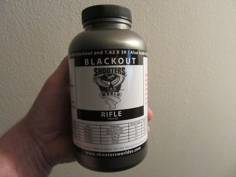

    Need info from someone who has used for. ( high Vel. loads ) .30-221/300blk boltaction - using 110 Vmax's or similar weight .
    I got a couple Lb's that laying around here a while, so need to finally try using it . I have loaded for, and shot 30-223 for many years , but never loaded this powder before .
    .....thanks

    On using the Blackout/shooters world on 110's high Vel. loads . I don't really think it going to workout for me .
    It might be really good on the heavy Sub,Vel loads . Or High Vel. on some of the heavier bullets .
    From some of the #'s I got today, ( running 19.0 to 20.5 grain ) . I think I will only use for subsonic and the heavies . I got a couple big box's of the Missouri coated heavies to burnup anyway, so will just use this couple Lb's shooters world powder on them .
    16-inch Barrel .. 1-8 twist 5R on the boltaction .
    I ran some rounds over the Doppler today . Even with ( 20.5 Grain ) and starting to compress . I was only getting 2077 fps Vel.
    So I am still way off from 2400 fps, not even near what I was looking for for speed with the 110 Vmax's or the 110 sierra varminters . So will just stick to the H-110 / 296 / Vihtv. ,or others I have data on.
