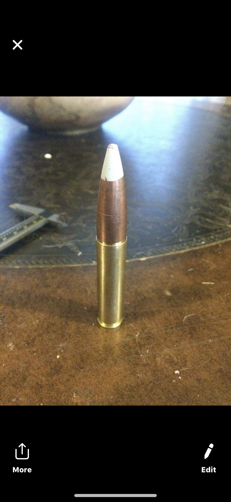

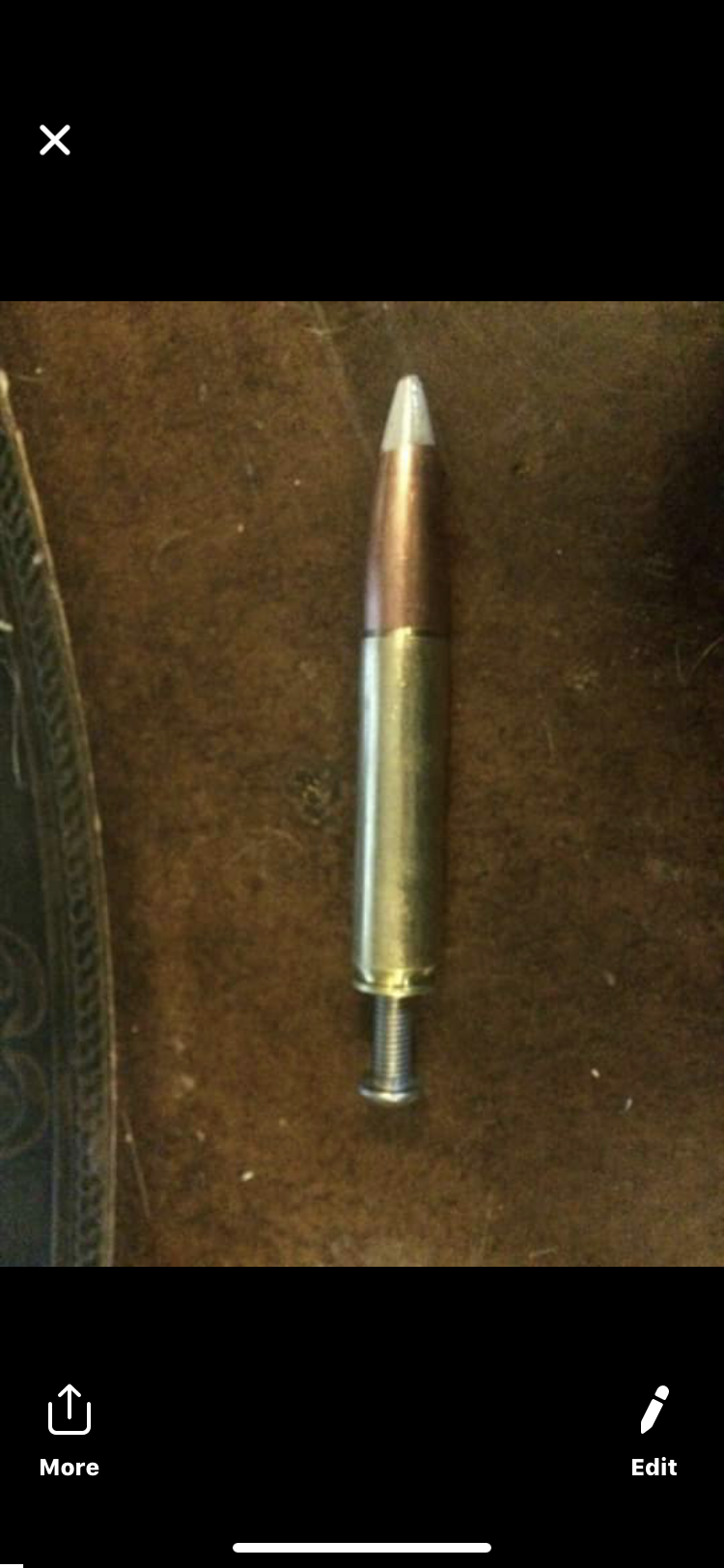

Also if one were to go full out, why couldn’t you figure out a way to load modern .510 projectiles in a bolt gun chambered (fast twist custom barrel of course) in something like 50-90,110,120 sharps. A 750 a-max at 1300fps is still a pretty serious round out to 600.
I was working on this.
It is a 300 RUM cut at 2.10”. Use a 50 Alaskan reamer. You can use standard RUM dies to size the cases.
You can single feed using 50 BMG pills or mag fed with more square bullets.
It is basically a rimless 50 Alaskan. A friend wanted to shoot 50 BMG pills supersonic to 1,800 yards. Don’t think was was going to be possible. He quit being interested when he realized this would be launched from a 10 pound gun.
