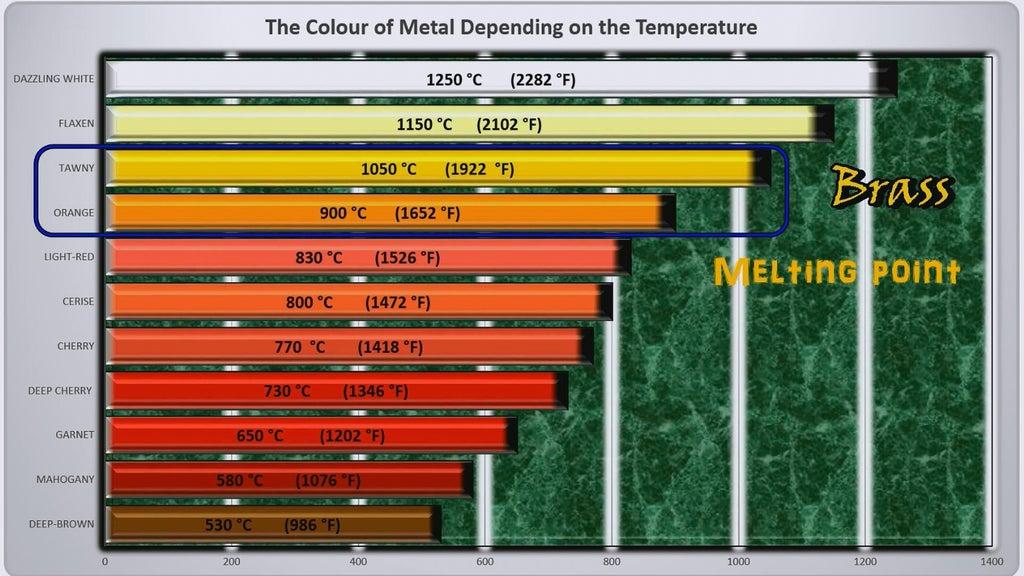

That's right. . .650°C is at 1,200°F and that's were you see the brass glow red. It's not going to fry your brass as you might think as you're really only dealing with a second or so at that temperature (it's not like you get to that temperature instantly). Remember, the annealing process is a function of both temperature and time; very hot for short period less hot for much longer period.
Here's a pic that give you some idea of color to temperature for brass:
Brass color temperatures httpswww.instructables.comMelting-Aluminum-and-Brass-Differences.jpg
