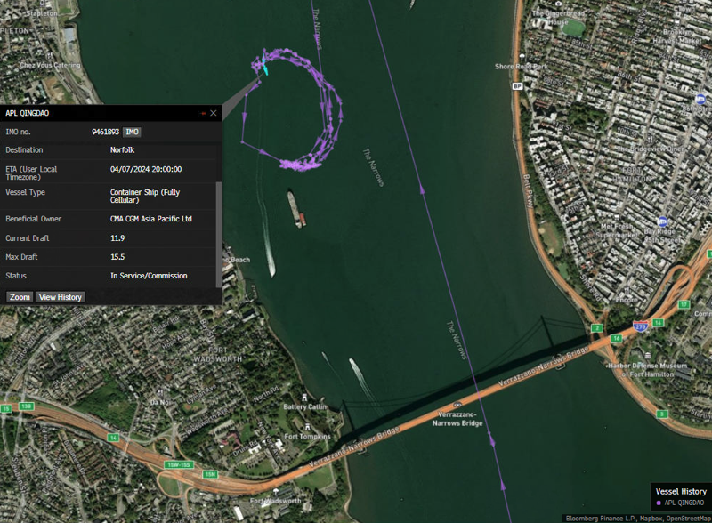

Given that nothing ultimately happened aside from a temporary loss of power and control , and is now under power steaming on its way,

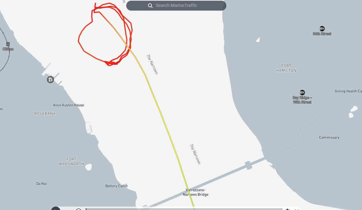

Reports indicate that the container ship APL QINGDAO lost power while transiting the port of New York.Three tugboats were dispatched to assist, but three additional tugs were required to gain control. Eventually, the ship's electrical problem was resolved, and it anchored near the Verrazano Bridge.''
Track of movement is a bit unusual
