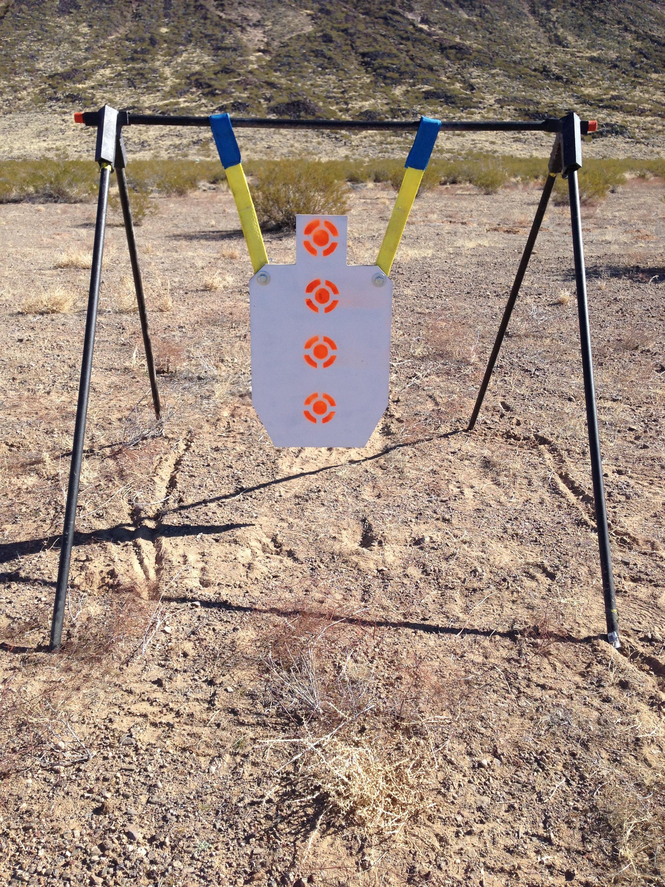

1. LV Steel target brackets
2. 6 foot piping from Home Depot
3. Heavy duty tie down straps - cut them and made the holes with a soldering iron. Burns right through like a hot knife through butter and cauterizes the cut so there no fraying
4. 100% IPSC 1/2 inch 500 AR steel target - bought the steel had them cut a 30"x18" square ($100) then took it to get water jetted ($100). There was left over metals so the guy was really cool and made two 6" round targets

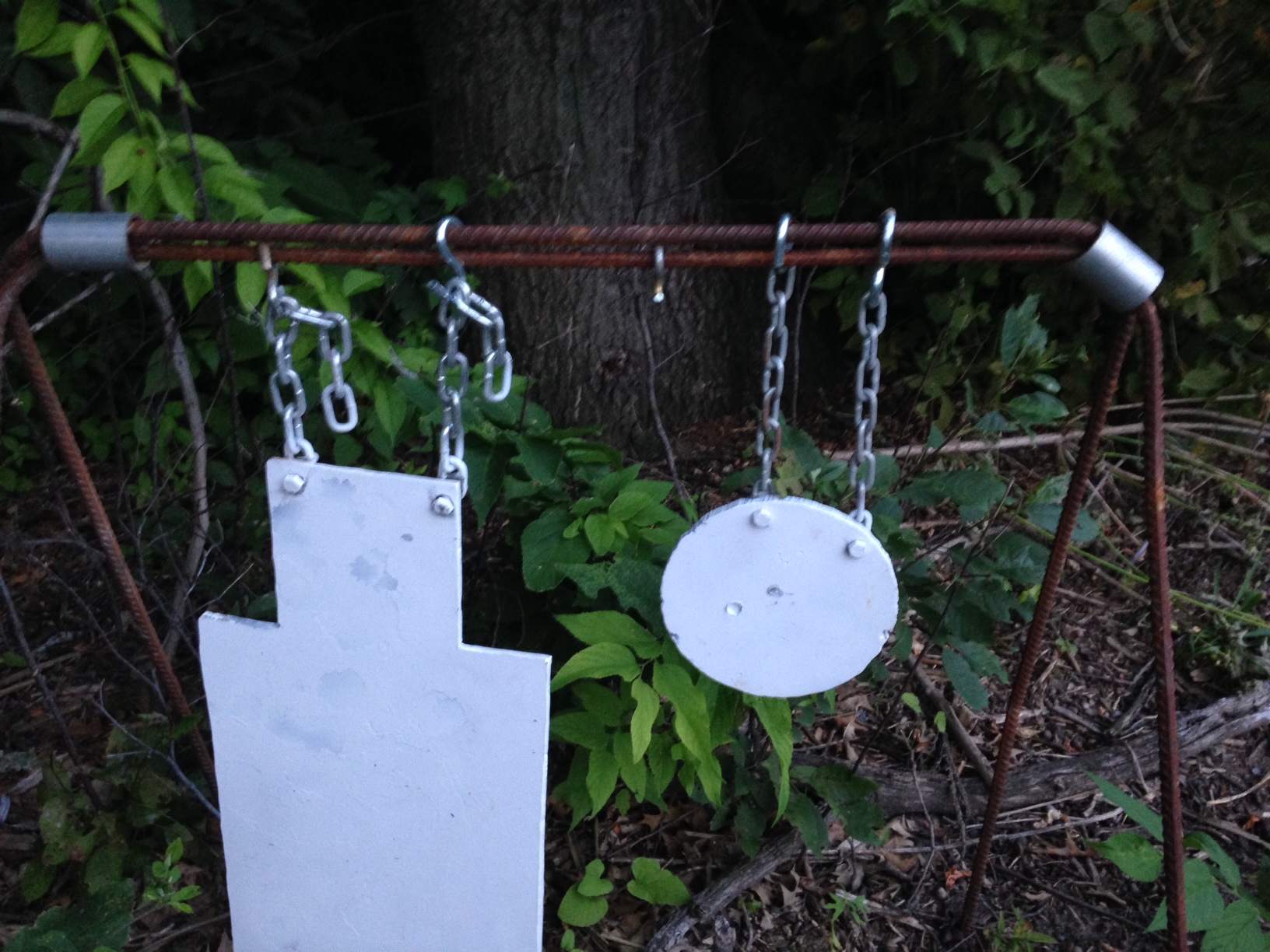

Boys,
My portable stands are made from two 10' sticks of 1/2" rebar. A person could vary the height or width depending on what you wanted to hang from it. The connecting pieces in this picture are pieces of pipe cut about 2" long. Wire could be substituted. No welding. Everything folds flat.

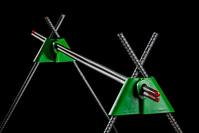

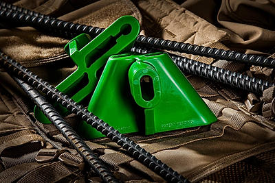

Easy? Portable? I can carry enough equipment on my BACK to set up 3 targets in just over 3 minutes.
I had to develop this system because many of the places we set targets are inaccessible by vehicle.
The pack is an Eberlestock Dragonfly.
3 minute steel target setup - YouTube
Shot with .223 55gr @ 3100 fps 125 yards
3 target stack - YouTube
