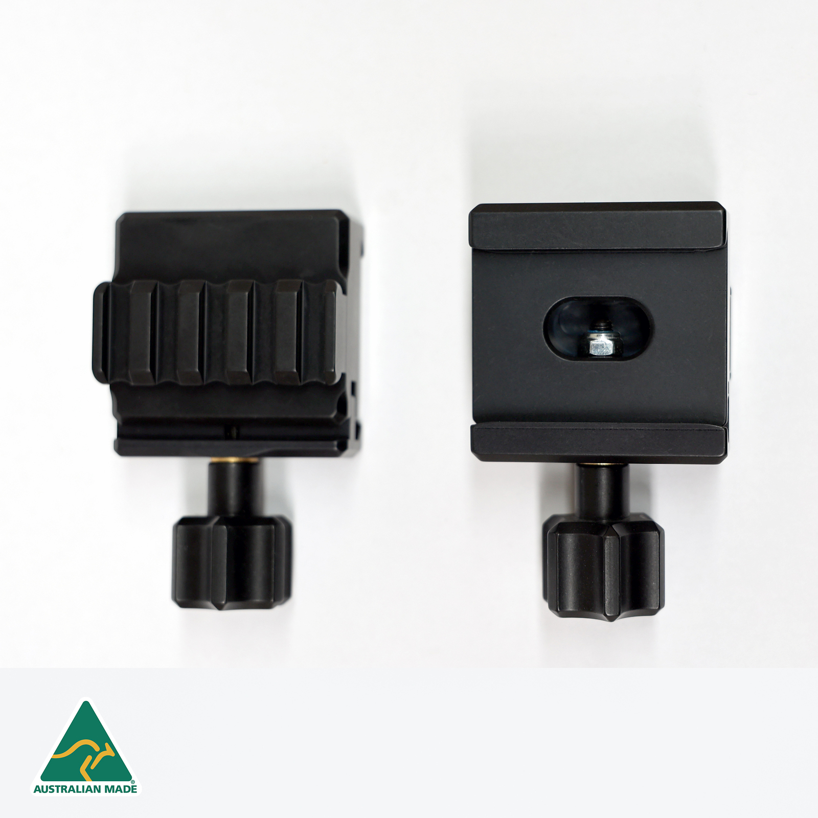

Can anyone suggest a mount option for small tripod as the bulletseeker comes with a pic rail.
How could you mount that on a tripod. Any suggestions welcomed.
Mine is on the way. Thanks in advance.
A smaller one that uses a nut:
6.5SH - This is exactly what I was looking for. Where could you buy this ? I don’t have access to a 3D printer ? Thanks 🙏
There are services online that can do it. You might check to see if there is a "maker space" in your area as well, many can do it for you or teach you how on their equipment.
That being said it may end up being cheaper to just get a small section of pic rail, drill bit and 1/4-20 tap if there isn't a printer local to you.
