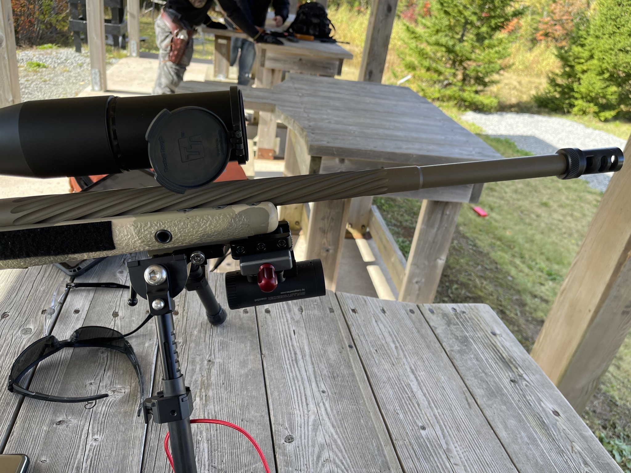

Works perfectly when attached to pic rail on my braked .308. However fails to pick up any shots on my unbraked 6.5 when attached in a simalar position on the arca rail or my manners stock with a 2 inch longer barrel. Bit of a head scratcher.
....IIRC, saw some references to the "muzzle blast gas cloud (?)" potentially causing some issues. Since the brake redirects gas to the sides could be why it "reads better" 🤷‍♂️
Wouldnt that be ironic. Have a parabolic bracket on order, will see if that helps.
With the AndiScan and a brake I had to move the position around on my arca rail to get it to read. With a suppressor or rimfire it really didn't matter where it was. I'm guessing we don't see this issue with the LabRadar because it sits so far off the side.
I have this problem all the damn time with the Labradar, frankly it’s why I bought the Bulletseeker to try out. My big magnums with muzzle brakes cause the Labradar to drop detections like 30-40% of the time even with a big offset or moving it way forward/aft. It finally improved with a tall quad pod, I shoot prone underneath it, but that’s obnoxious to set up and use.
