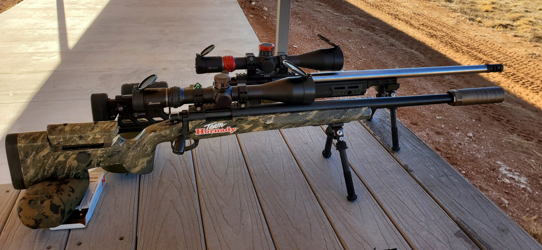

My son shot his first match and NRL ever this weekend. He is 9. Had a pretty good battle for top youth with another kid and edged him on the last day by 1 point!! 90 to 89. Unbelievable. So much stress for me.
Not only was he top youth but he was 13th overall. Still geeking out.
He used the XTR Pro for the whole match and it tracked amazing on my rifle as well as his. The large FOV made it easy for him to find his targets, which if you shoot with kids you know to be a big problem.
We def need to work on our comms and my patients lol but I am so impressed with him doing so well with this scope. Also, its the first time he shot a large bore rifle (6.5x47) and even tho it had a huge brake, he didnt complain for recoil. hashtaghumblebrag haha. he did complain about the weight tho. it was 15 lbs. ha. still finished the match carrying all his own gear and ammo.
I tied my career best at a 2 day match with 2nd overall. This scope has no problems tracking and I am still impressed with the glass.

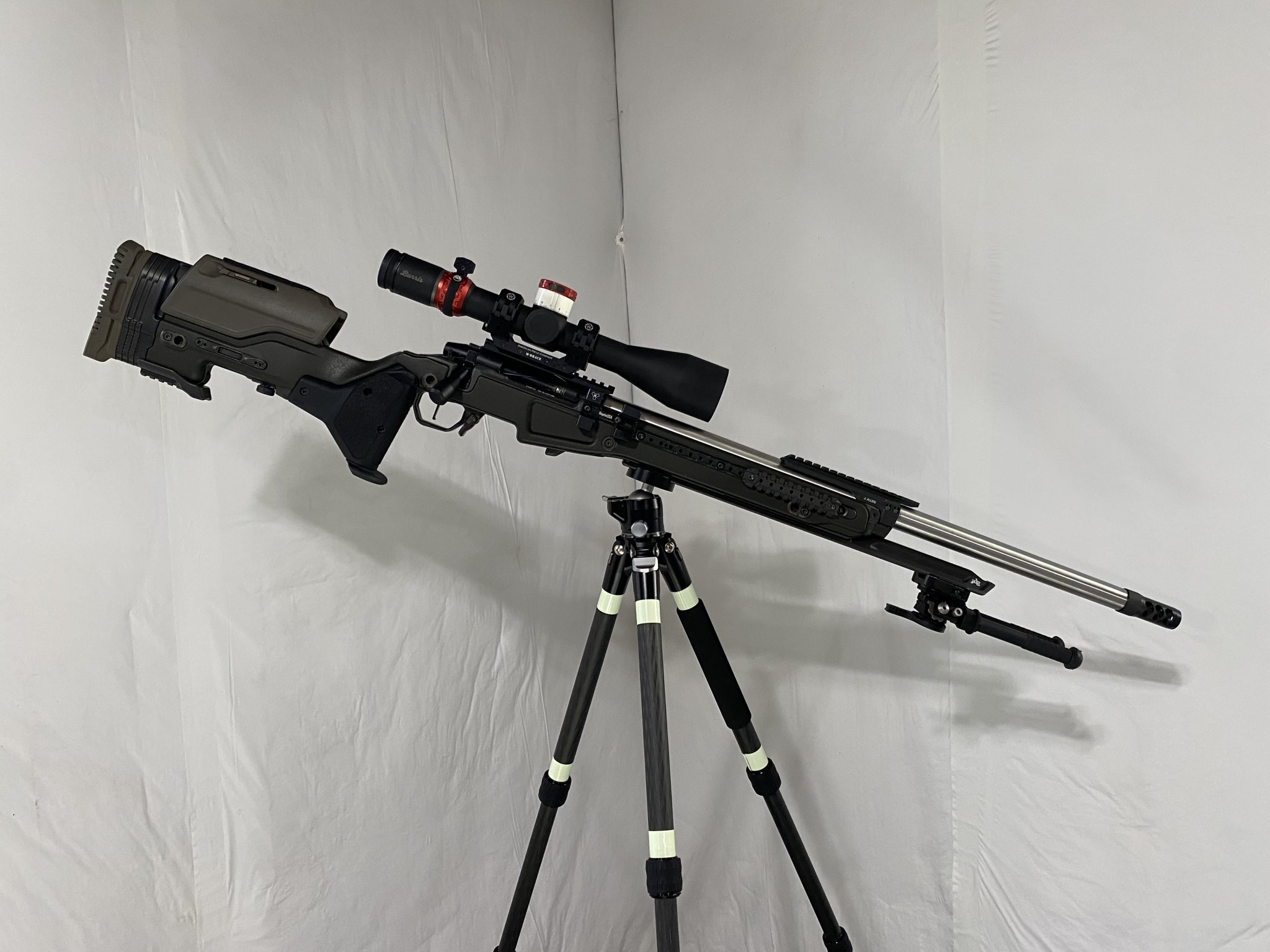

Well guys, I put my money where my mouth is. I was seriously so impressed with big johns burris pro that I just sold my kahles tonight and will be ordering a pro tomorrow. Can’t wait to get more time with the pro!
I can’t wait for the next match to run them together lol. You are going to love the race dial. I gotta cut out to Oklahoma to pack up stuff at my old house so I will probably catch the Cheyenne or Laramie match.
