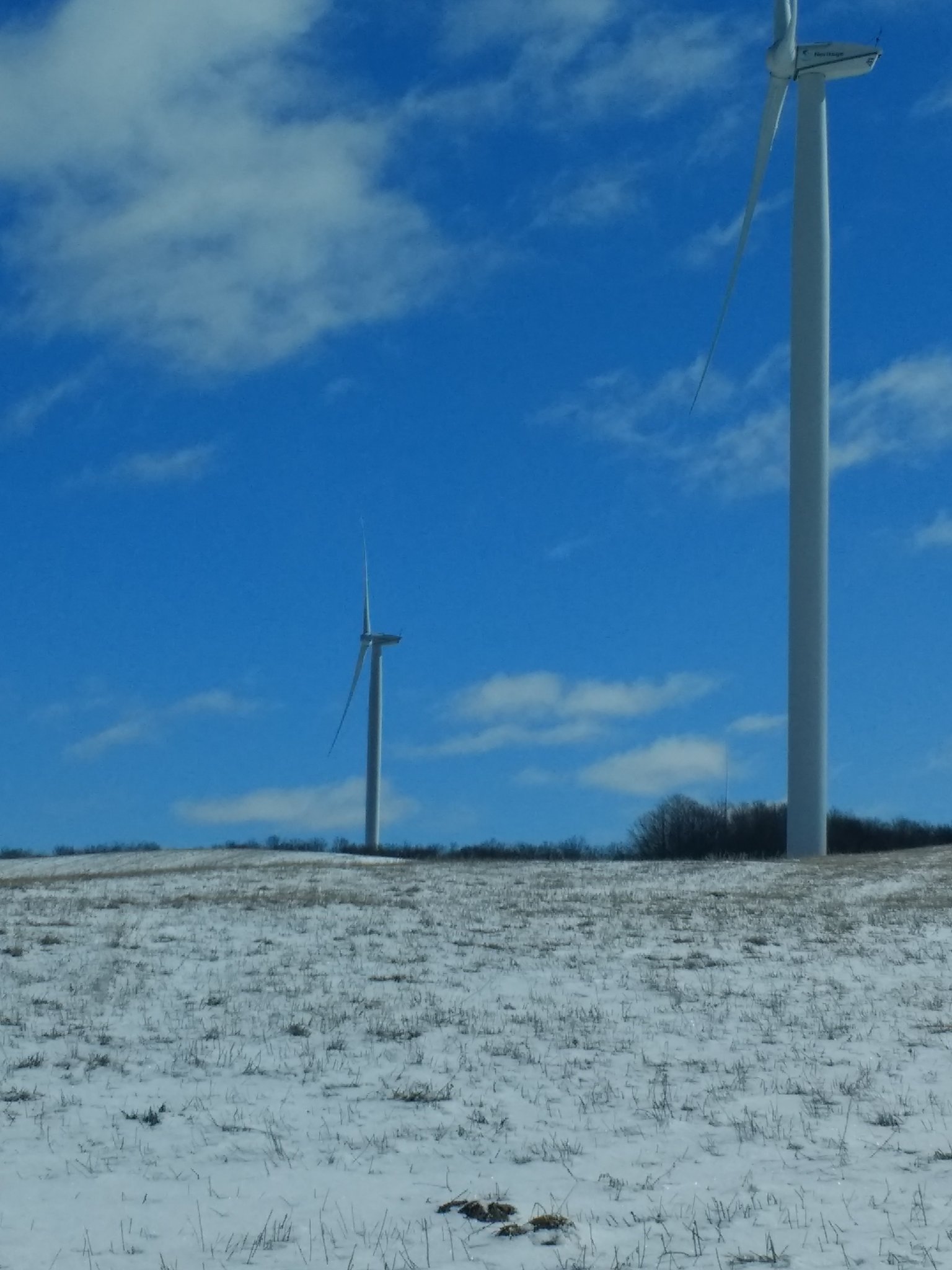

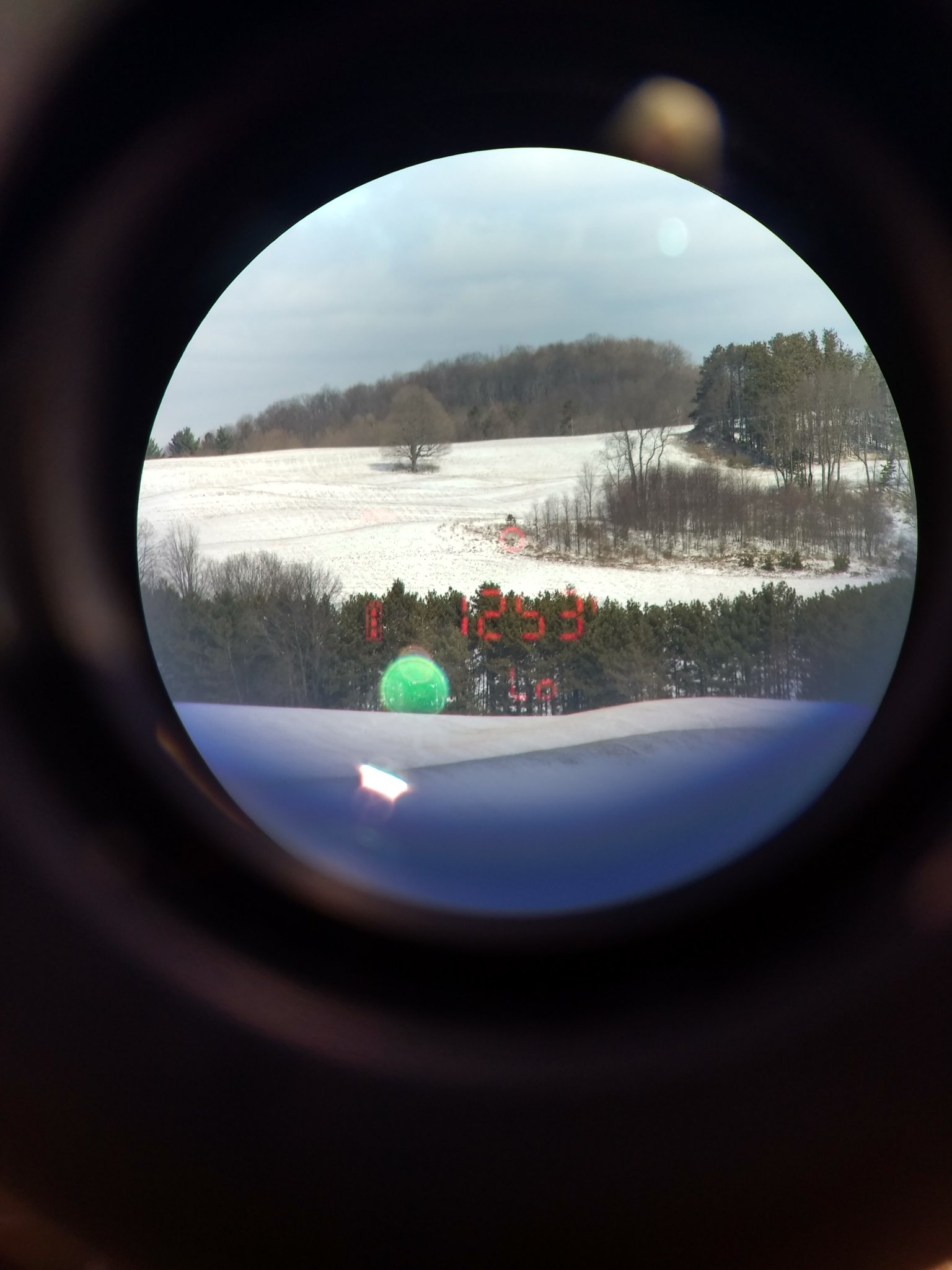

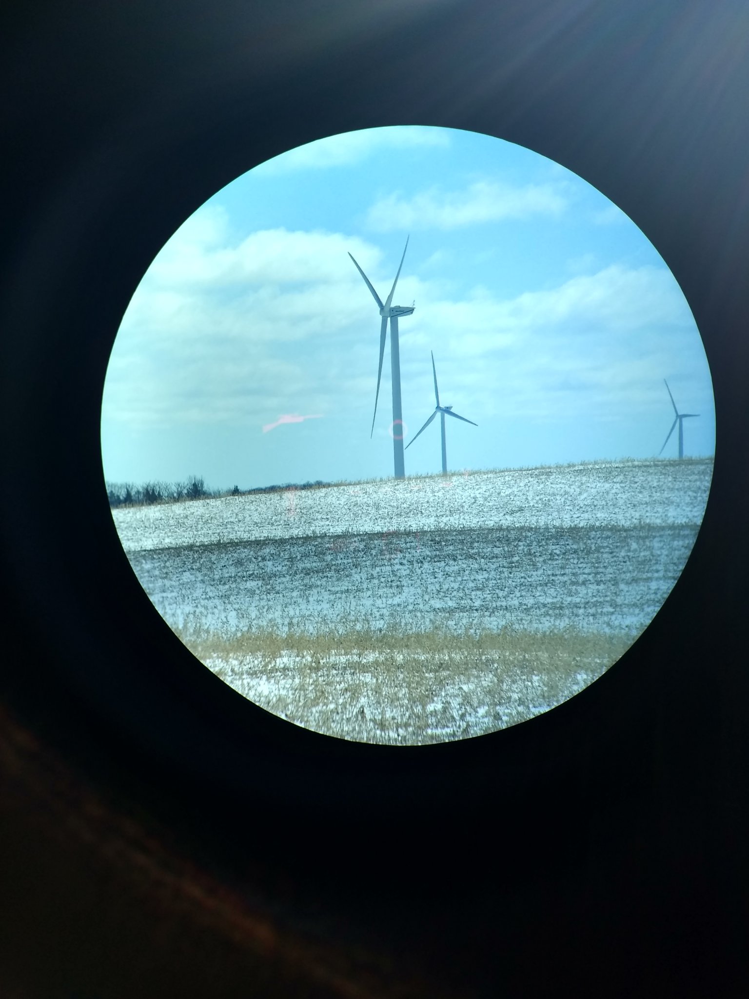

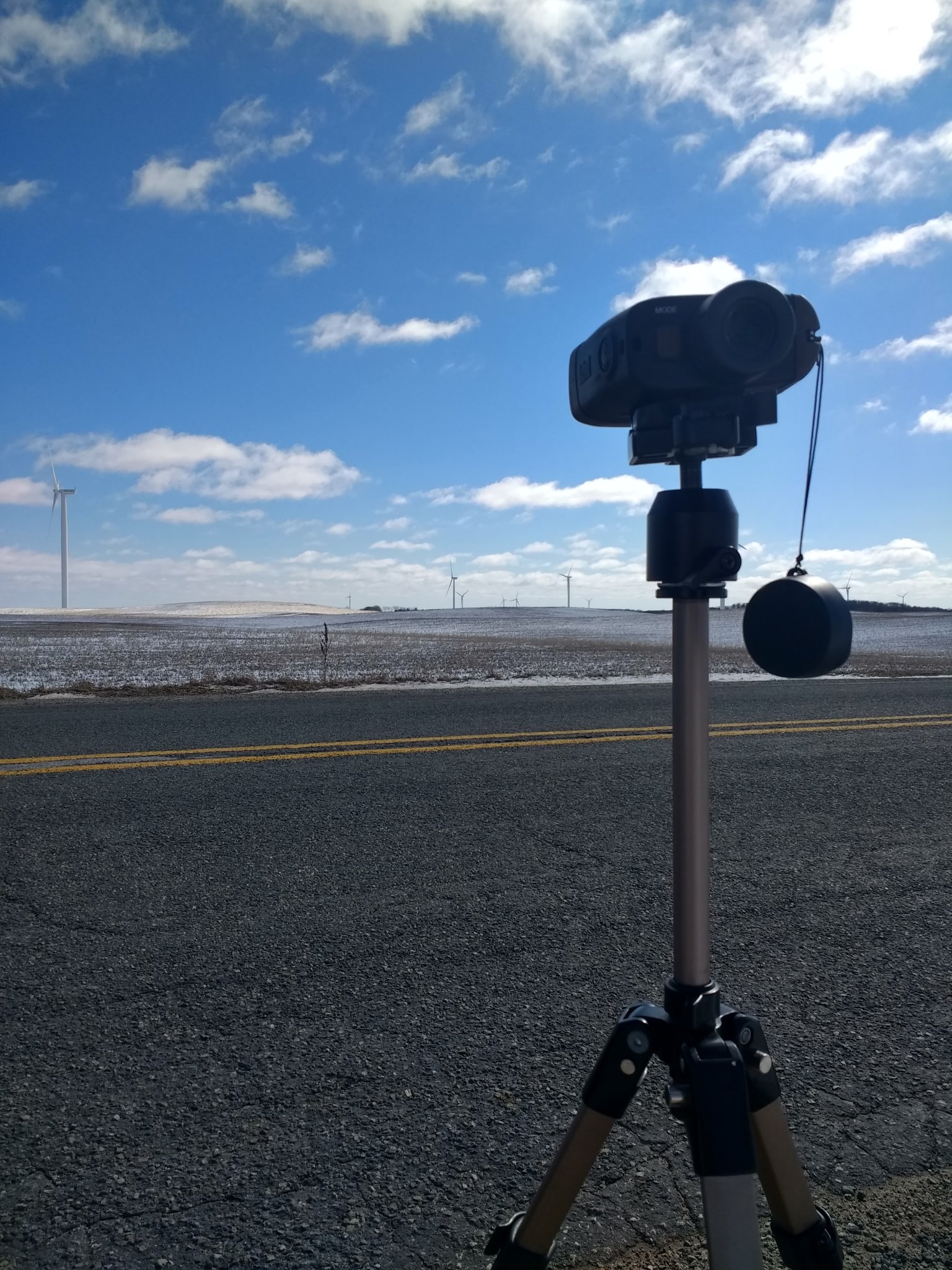

So I went out for a few hours today. After hiking a couple miles and not getting to see too far I decided to take a drive. I've got a few pictures and thought about posting a review in its own thread, or I could just throw it all in here.
Bottom Line, I wasn't able to get a reading past 1550 yards. That was on a steel building. The longest I was able to get on a giant windmill was 1200 ish.. I'm thinking they have a non-reflective coating on them to some degree.
Ranging under 600 yards it pretty much point and shoot and you'll get anything you aim at.
800- 1k is still pretty easy to do off hand, on trees and larger items.
Anything over 1k takes a steady hand or a tripod. Any you need to be patient.
The longest brown thing I could zap today was a dog at 400 yards.. I didnt need to range the dog to know it would do that.
As I was coming home I hit up a couple 1 mile fields. I could range a small pine at 1253, but couldnt get a giant ALONE maple a couple hundred yards behind this. I figured that it wasnt going to happen and drove forward. I found a new opening and hit the maple again and was able to get 1483, at the base. I was pretty impressed with that. Up to that point I thought " Nah, this thing isnt much good after 1k"
Thinking more on it, I doubt a person could get a SOLO yote, deer, pronghorn past 1k-1200 yard (Maybe if it stood still for 10 minutes). But a group, now i can see that.
Just from my time driving around and ranging everything I could find I came to one conclusion, other than I like this unit (>$300 shipped, TAKE MY MONEY). I figured out that past the instant zap range. Nothing is guaranteed. If i cant range something at 1500 yards from a clear view on spot A, that doesnt mean i cant if i move to a different angle.
One of the downsides to this unit on a bright day, in the sun/snow is that its REALLY hard to see the overlay, regardless of the setting.
*If you want me to put this in a fuller review, its own thread, I can do that. Here's some pictures.*

Nik, I don't think you will have any issues shooting or ranging, 1 MOA at 1400 is 14.658", Someone here was ranging 12" targets at 1300yds and scoring 1st round hits as well, If my Truck was on the road I'd go and try it my self,
That CB aerial I ranged was only 1/4" across at the Tip where I was aiming at 230yds so doing the maths it should be able to range a targets that measures 1.5217" at 1400yds under the right conditions, But I have ranged some small things at crazy ranges things that I never though possible, Unlike the other Bushnell models the ConX does have quite a small beam so it has that in it's favour.

Yeah.... I couldnt range a giant ass windmill past 1200-1300 with a tripod. Tried one at 1500-1600 yards for 5 minutes and could never get it... There's no guarantees with a RF.
