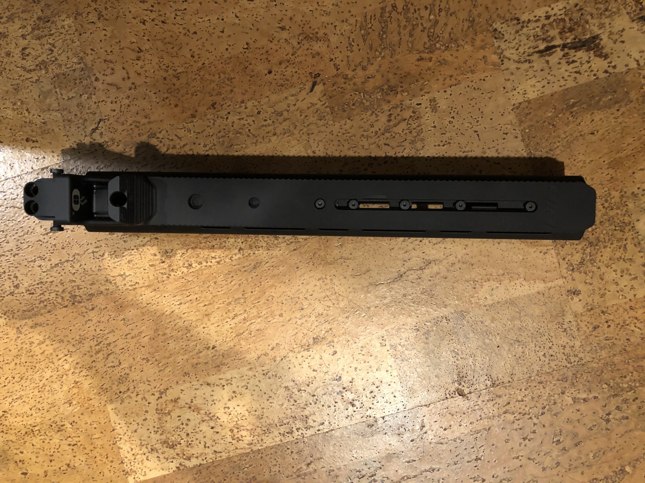

First i loosly installed the 4 mloks into the Area 419 14" rail with 10-24 x 3/8 screws and loctite. Once i had the rail on the hand guard and all 4 MLoKs in each slot. Use the front most screw (10-32 x 3/8) into the sling stud to align the rail forward and aft.
Seems to be pretty sold without drilling any holes toward the rear. Time will tell.

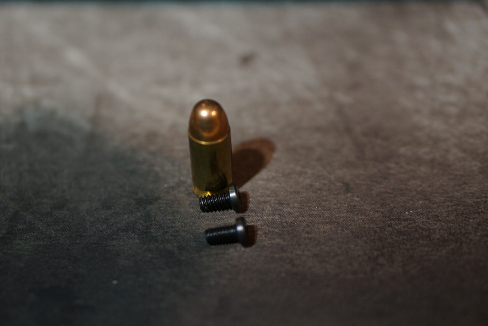

Here are what the two different screws i ordered look like with a 45 Auto for scale:
The cap head screws i found at my local hardware store all sat just above the rail. They would have prevented the arca clamp from sliding. You could probably grind a bit off of those and still have enough depth to grab the hex to tighten if you are in a bind.
The low profile ones sit quite a bit below the rail or order boxes of 25 for a couple scews.

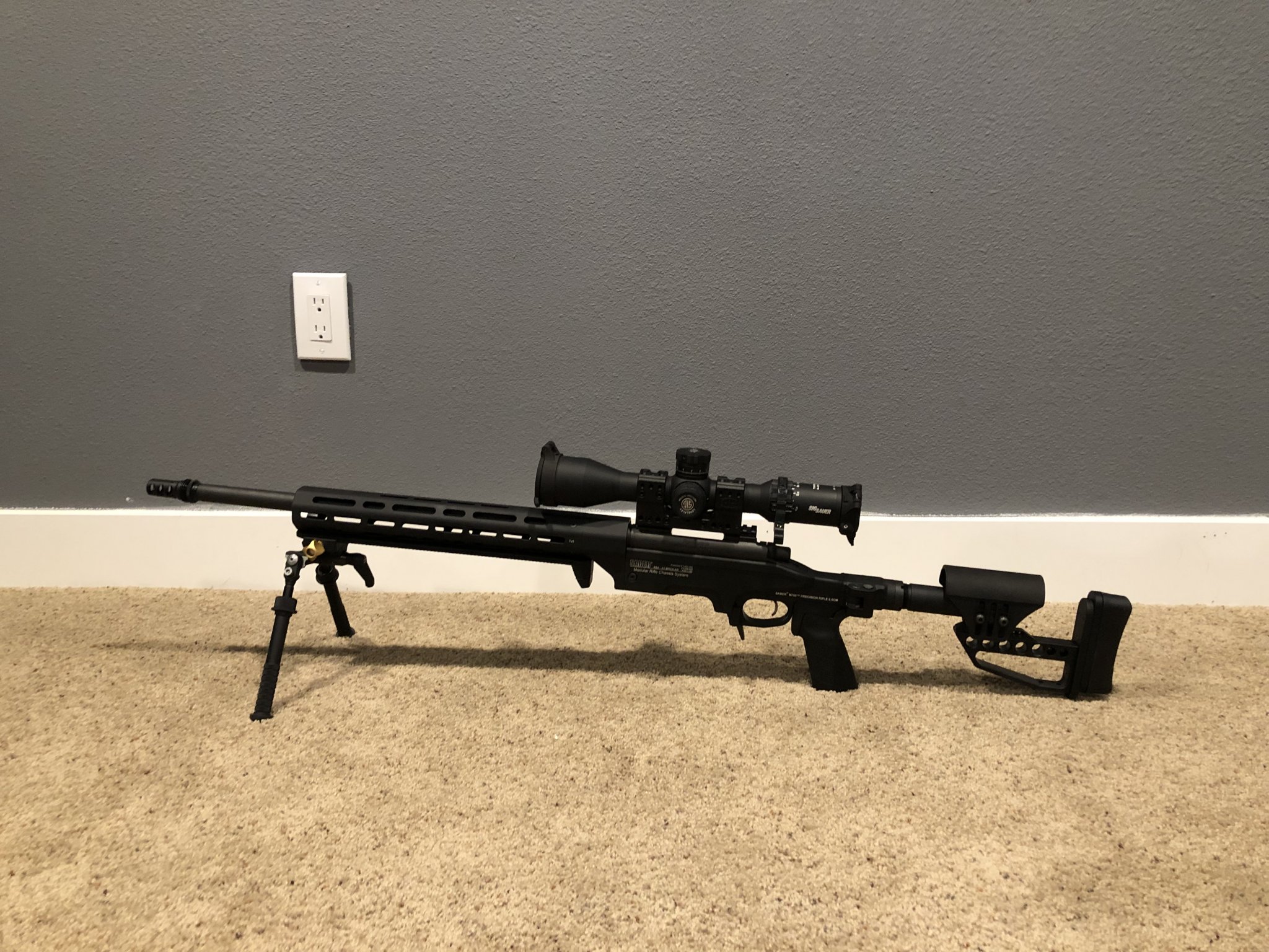

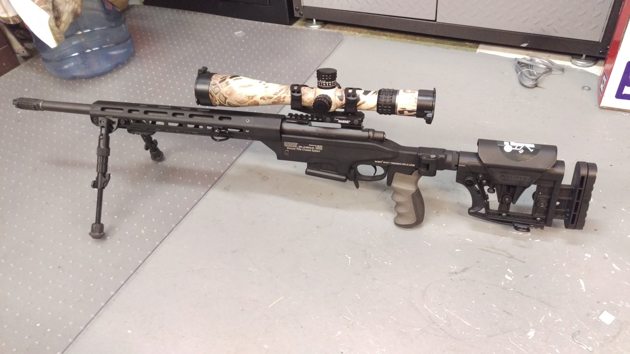

I recently got a cabela's clearance ashbury precision m700 to try out with either an origin or nucleus. Been running one of the savage's for a while and really like it but besides putting a magpul prs on it haven't done anything with it... This thread is really informational and appreciate you sharing your experiences. It will come in handy as I work on my build as I plan on doing quite a bit more customization on the m700 chassis.

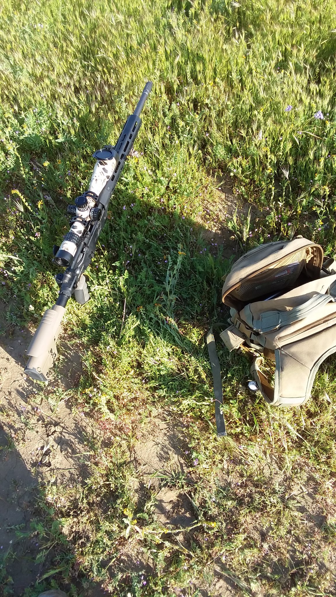

Heres mine out in the wild. On a whim I went out and shot my first match suunday. Also first time shooting the rifle. had to swap out rings 15min before start and zero was a little off. It went bang everytime and that's enough for me.

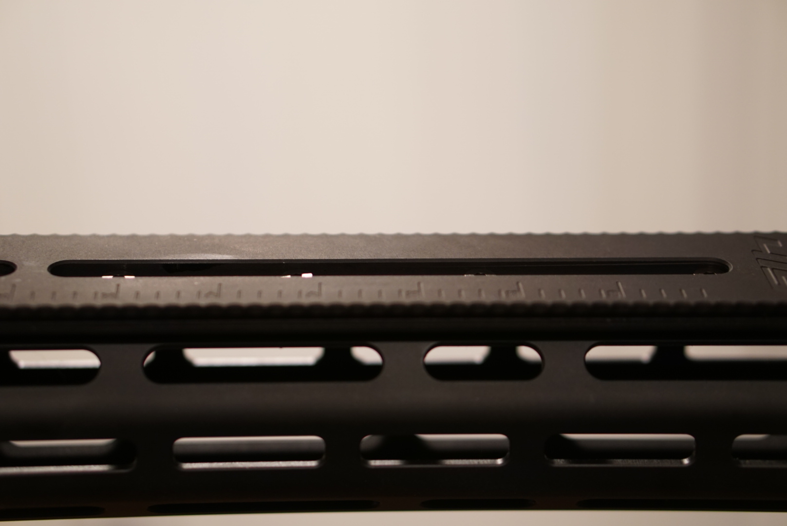

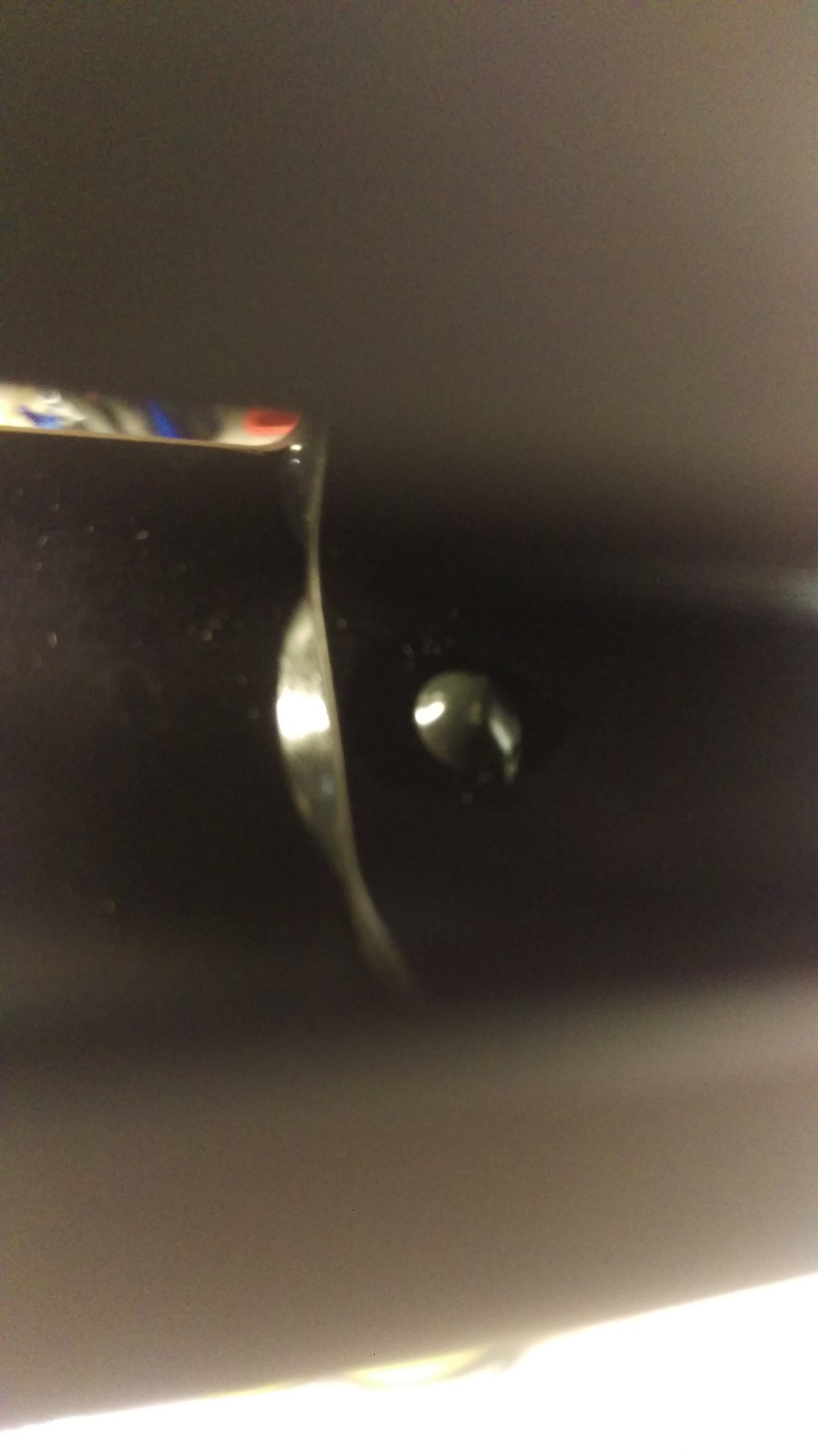

Looks like they used some sort of glue for the rail. This is looking in through the mlock hole. The bump is glue pushed in from the screw.

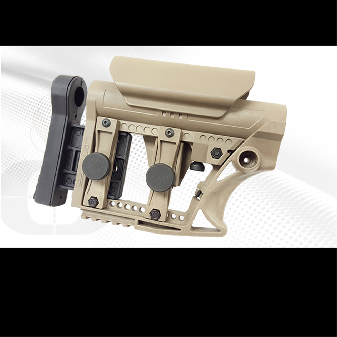

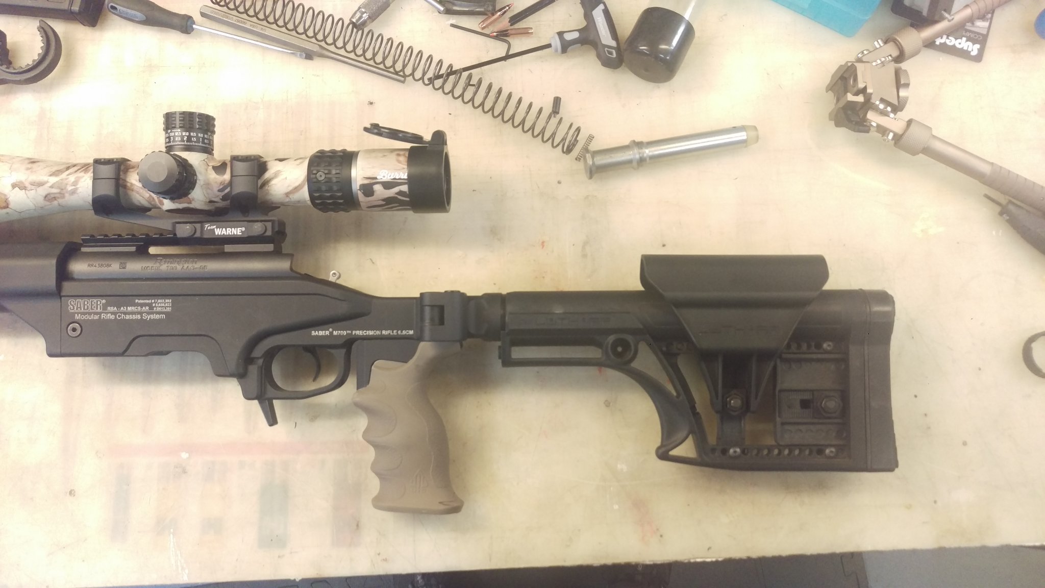

Luth AR came in, looks sweet.
i was messing around with things and found you can reverse the folding mechanism for the stock to fold bolt side. Bolt needs to be partially up with the luth but the right stock may capture the bolt when its down.

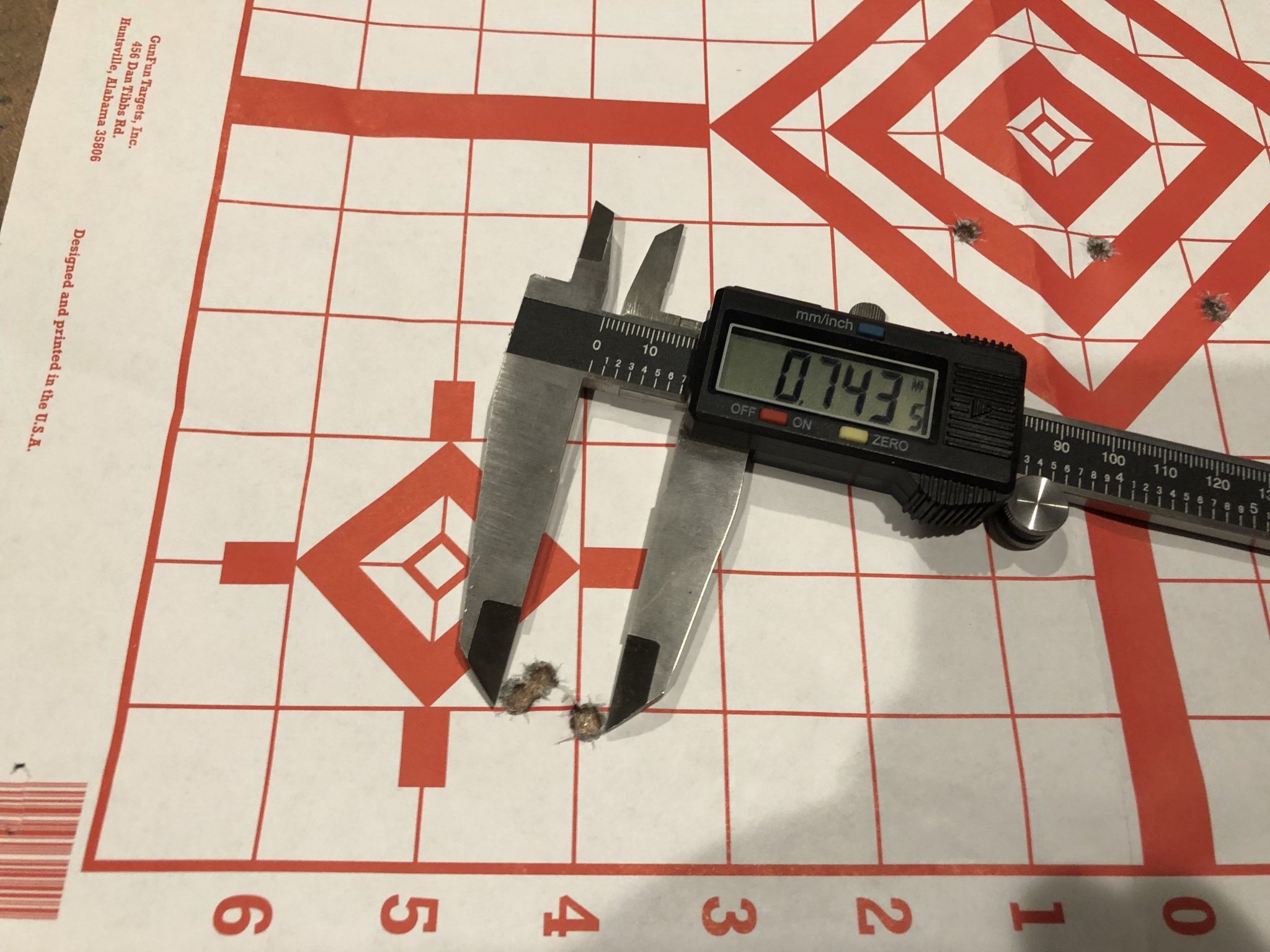

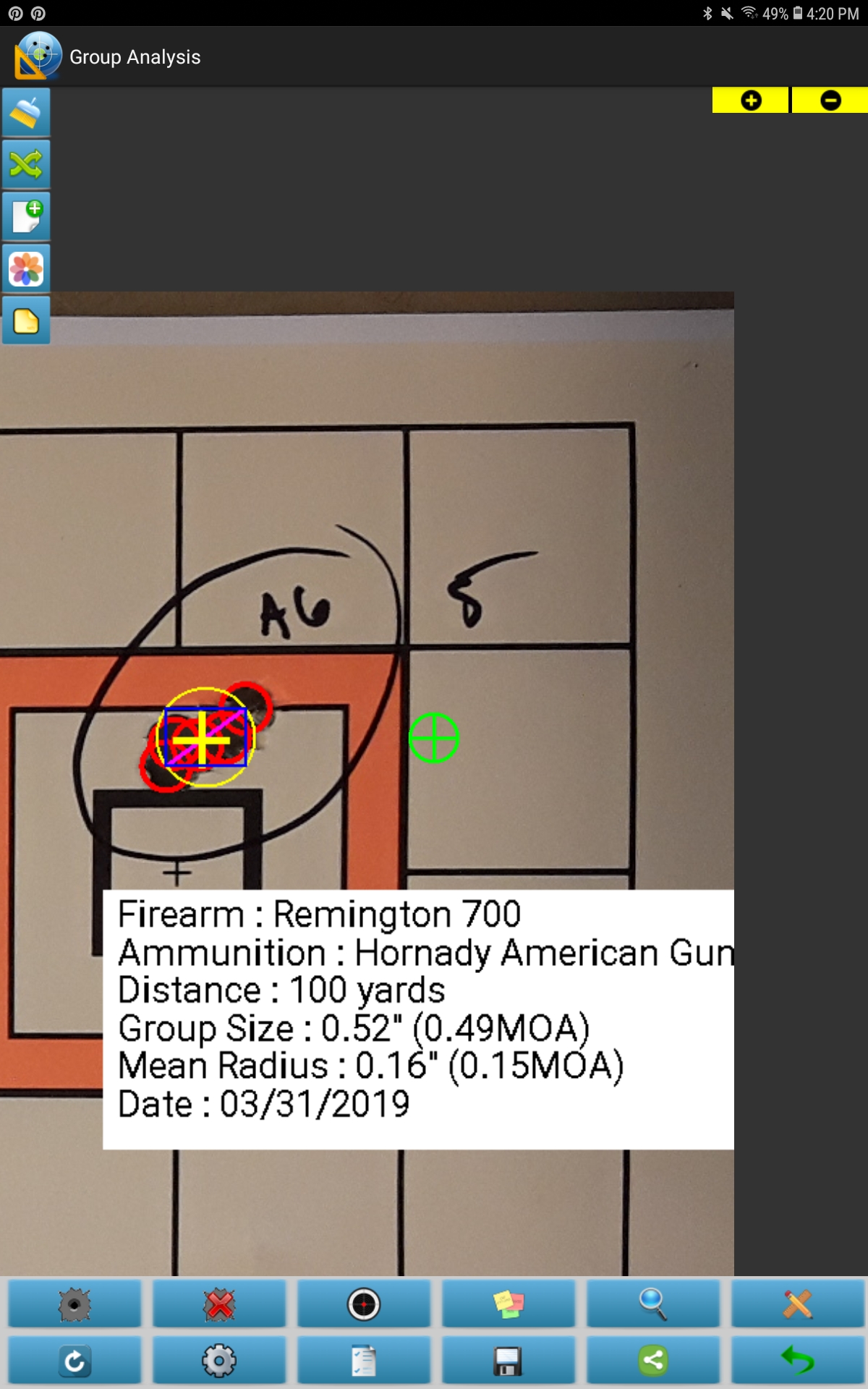

This gun loves factory Hornady American gunner 140s. heres one of the better 5rd groups.
Optic and mount mostly, I would like to change out the stock and the trigger also but that won't prevent me from getting out to the range. I'm some place in between the Vortex HD Gen II, Burris XTR III and Sig just put the Tango 6's on sale 1/2 price. I'm not too worried about reticles at the moment since I don't have enough time behind FFP glass to have a preference. I was thinking of just going basic MRAD whatever.

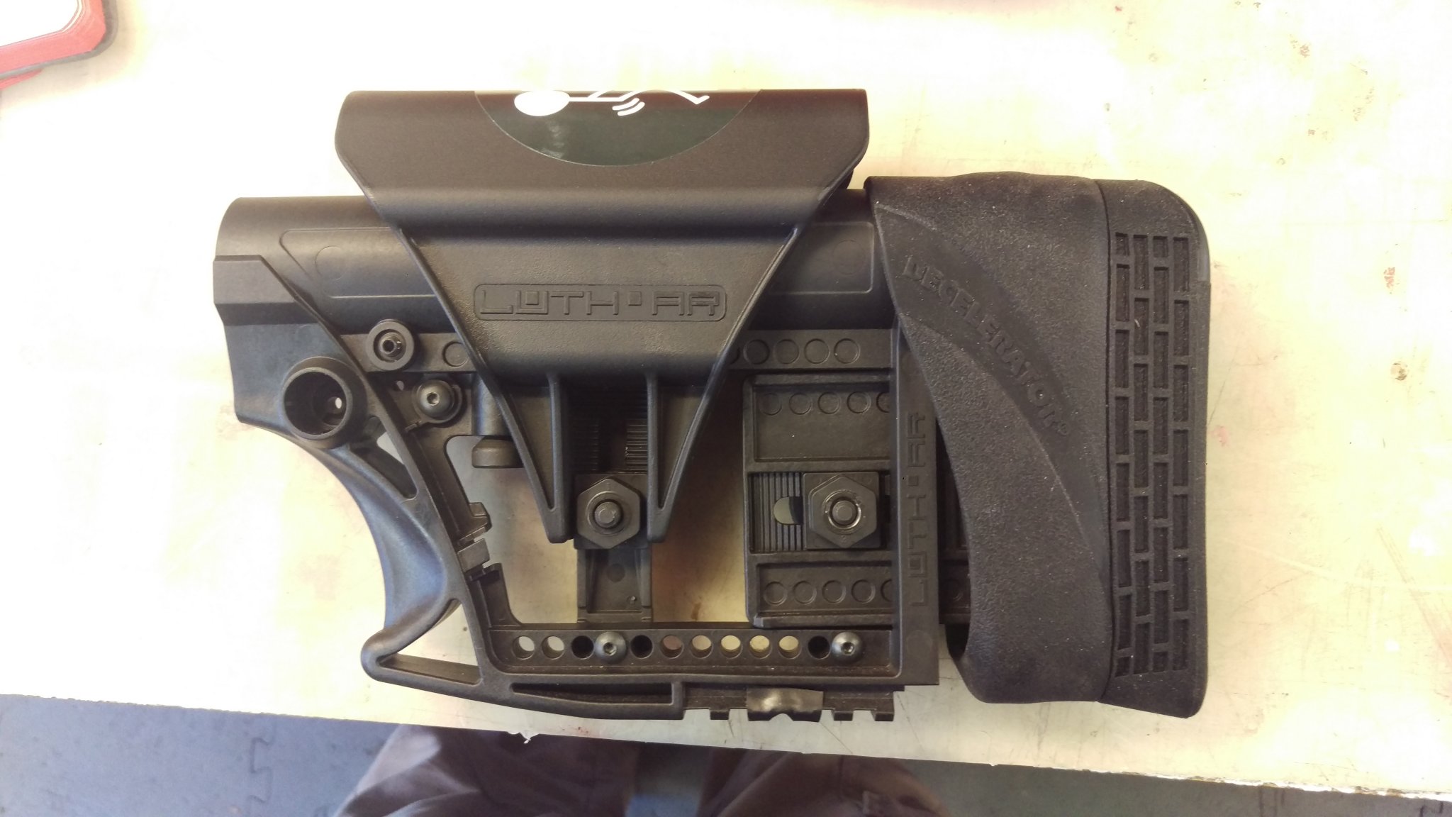

Fyi, not really impressed with the MBA3 luth stock. The rubber but pad is hard and sharp edged. I put a limb saver type pad over it but that sort of slides around. Wondering if the MBA1 is any better.
Distance from scope to handguard is exactly .4", without caps. 1.25" rings would most likely be perfect.
The mba1 doesn’t have a replacement pad offered, it’s just the same hard rubber material you have now on the 3 but a different shape.
Reactions: 2aBaC̶a̶
This puts a wrinkle in my plans, I was really considering picking a MBA-3 up until this. The ~$100ish price for the MBA put it in reach with my budget but the stock is on the bottom of my list at the moment I'm not sure any of the more or way more expensive options are going to make it in the budget anytime soon. Are you going to try the Soft 35 Duro pad? They never show the side profile of it but from what I gather it's the same dimensions just softer material but I could not confirm that.

I may try it. But $24 though? For a little rubber pad, Wtf? That's 1/3 of what I paid for the whole stock.
Duct tape and some medium density foam?
Lol, I picked up one of these. Ill give it a try before i do anything else. Its super comfortable but has a little wobble. Thinking about it i will try to permanently attach it to the existing plate with some rubber glue. ill make a vid and upload it to YT.

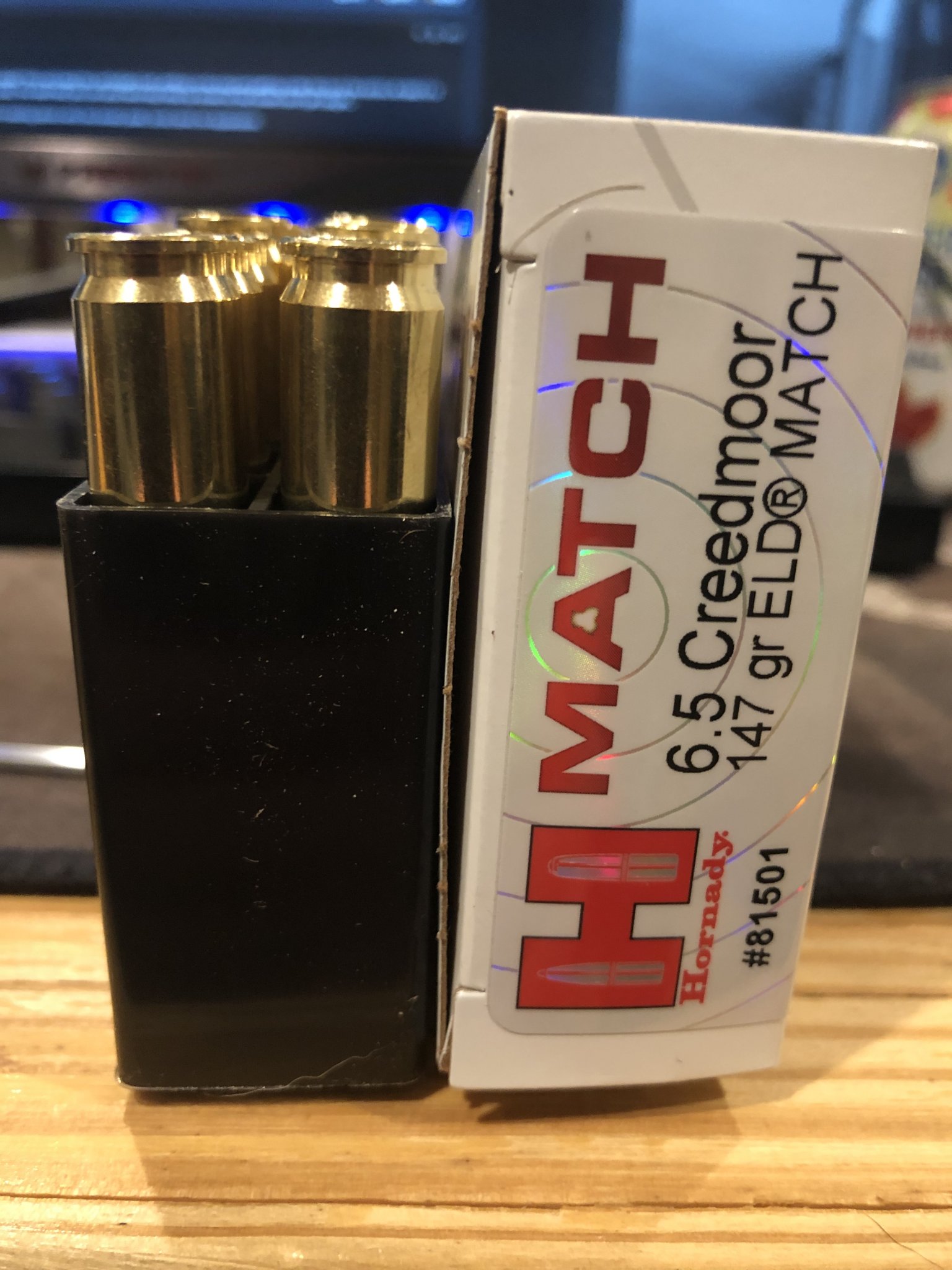

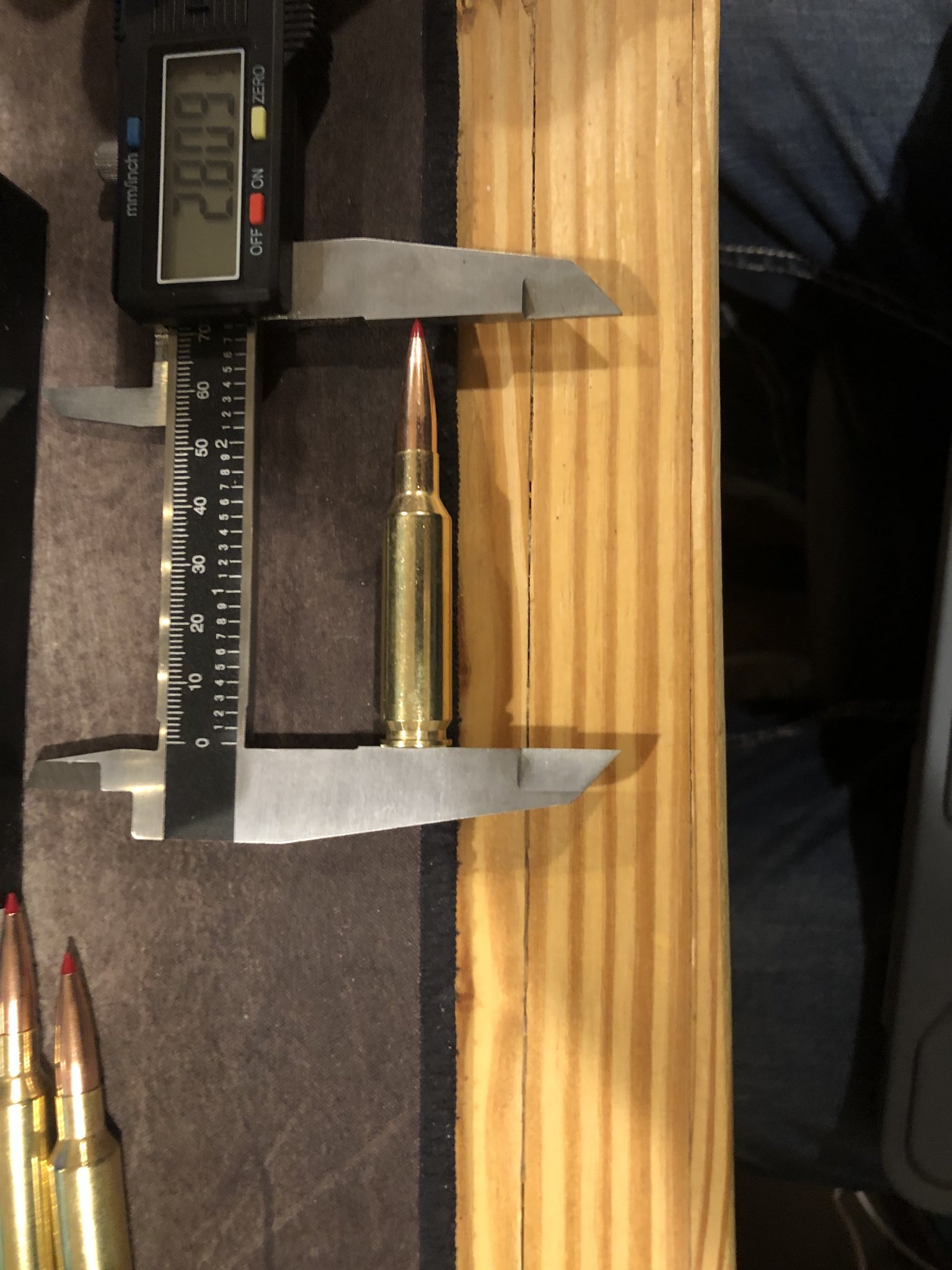

On an urelated note i picked up a box of Hornady 147 ELD match to add to my collection to test.
It cycled in my action just fine without modifications.
Nearly identical length to the 140 ELD Match.
The good news is now i have something to blame when i cant shoot .5 moa groups. Clearly our rifles are way different. I’m sure my jerk slap anticipated recoil trigger pull is not the cause.
I tried some of those out last weekend. The American gunner 140s actually shot better.

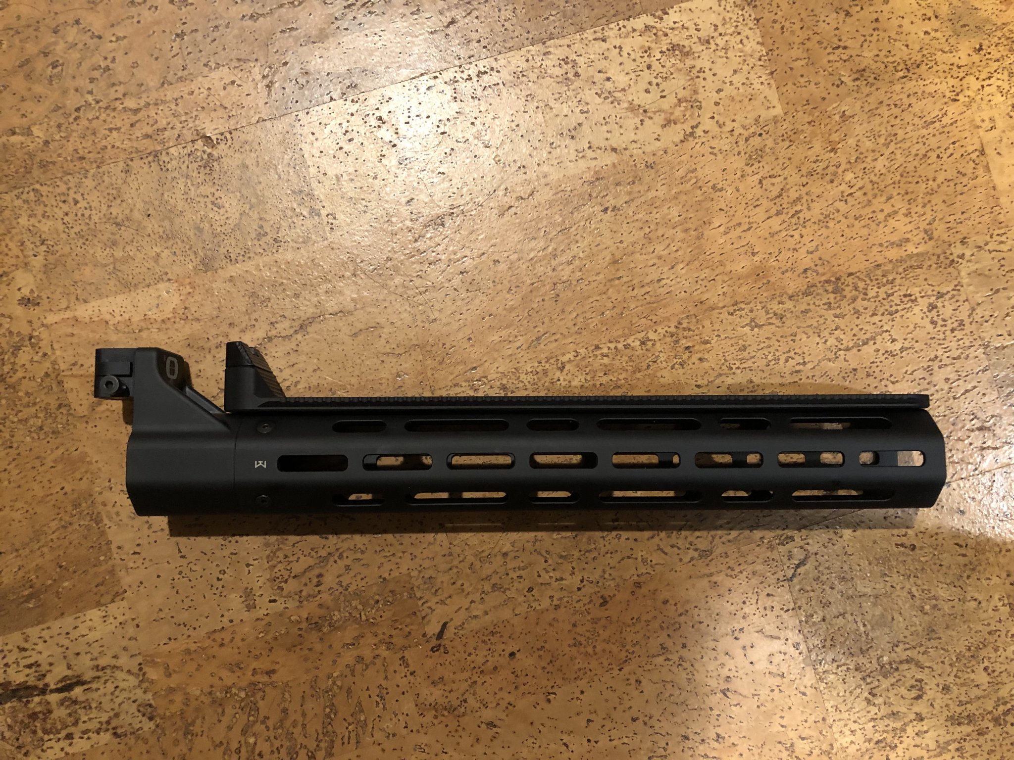

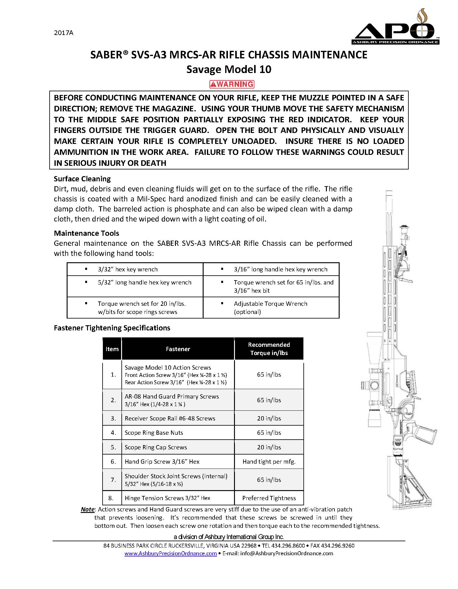

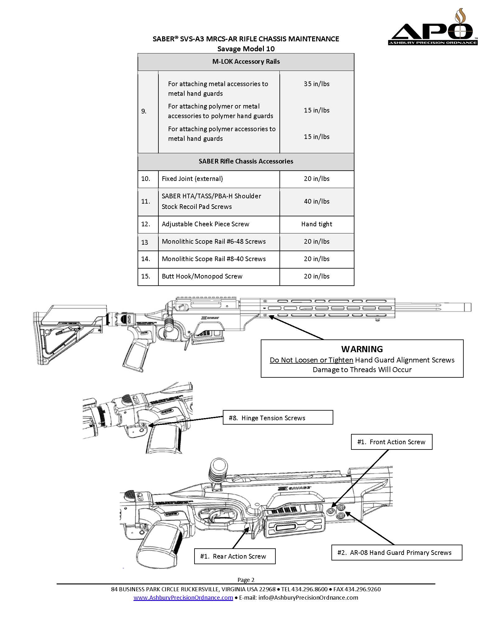

Hey guys i'm Matt from APO and i saw that you guys were asking about our handguard and it is proprietary to APO. Please check out the PDF bulletin for both SAVAGE and Remington versions of our handguard. If you guy have any questions feel free to hit me up here our give our sales and pro staff team a call 434.296.8600 or email [email protected]

Yeah like i said I couldn’t get it apart with moderate force. The problem with AR handgards is no standard.
@MADMATZ
So I took off the screws clearly labeled do not loosen or tighten, should I be worried? They came out and went back in ok.
@MADMATZ
No worries they 5 screws are used for alingment for assembly of our handguard. If do pull the screws out as long as they are not striped the screw can screw back into the hole with some adhesive so they don't back out under recoil.

That is the stock pad i was wondering about. It can be ordered separately from Luth. The hard rubber is the same just without the sharp edge. which is probably enough to not take issue with it. Limbsaver still feels the best.
To be honest the stock one isnt bad unless your shooting 200 rds in a Tshirt and or recoil sensitive.
Check this out below. A friend brought over his AR with a luth MB1 and let me fit it up. Its a little long and would need some extra screws to secure it properly. It could work.

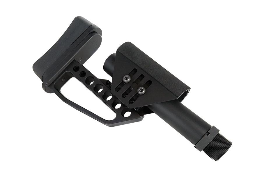

I saw these on a Bergera and thought they looked nice. I think I'm going to pick one of these up this week (payday!) and give it a try.
They say LOP is from 12-15 and if you add the 1.75-2 for the folding bracket by my rough caculations i should be ok to get my 14.25” target with a bit of room to go shorter or longer.
Presumably the only real limit is buffer tube length so if its too long i might be able to find a shorter one. Better be mil spec!
I will call them on Monday to see what they say about the tube.
XLR sells a shorter tube for use with the XLR folding mechanism. You may find it's a better fit for the Ashbury chassis than the standard AR carbine length tube they ship with their stocks.

I watched a few video reviews and they confirmed it is a larger proprietary outside dimension but internally still correct for an AR so long as you get the carbine length tube and not the short one. It was done because they use the same tube on all the stocks including the 50 BMG stock and it needed thicker side walls to support the recoil for that.
I'm going to call them and see if I need to buy the extra tube in the shorter configuration (1.7" shorter) for $32 or if they can switch it out for me with the longer one.

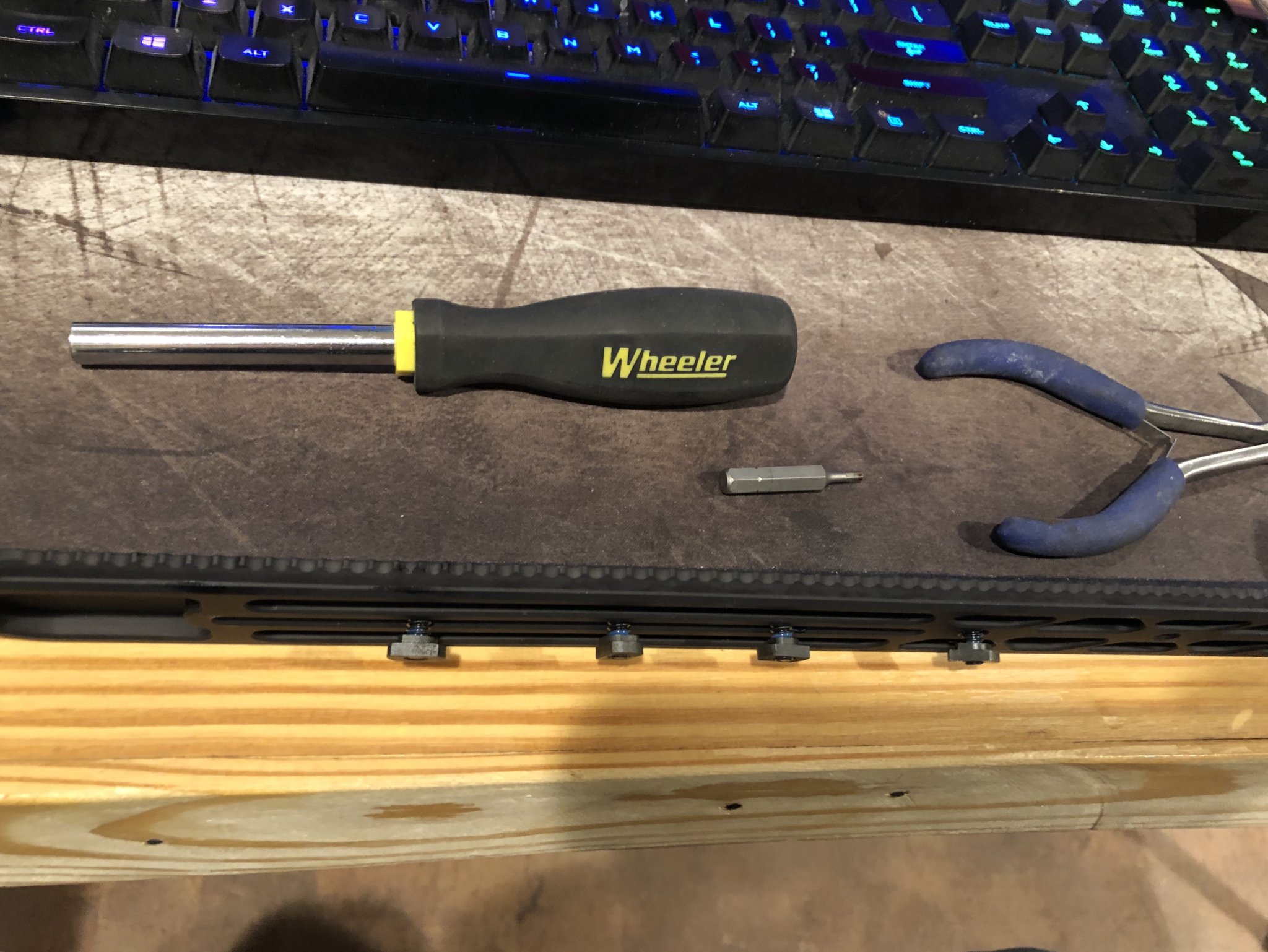

The stock tube was installed with red loctite so it does take a bit to get free. I ended up having a shop with a vice break it free for me.

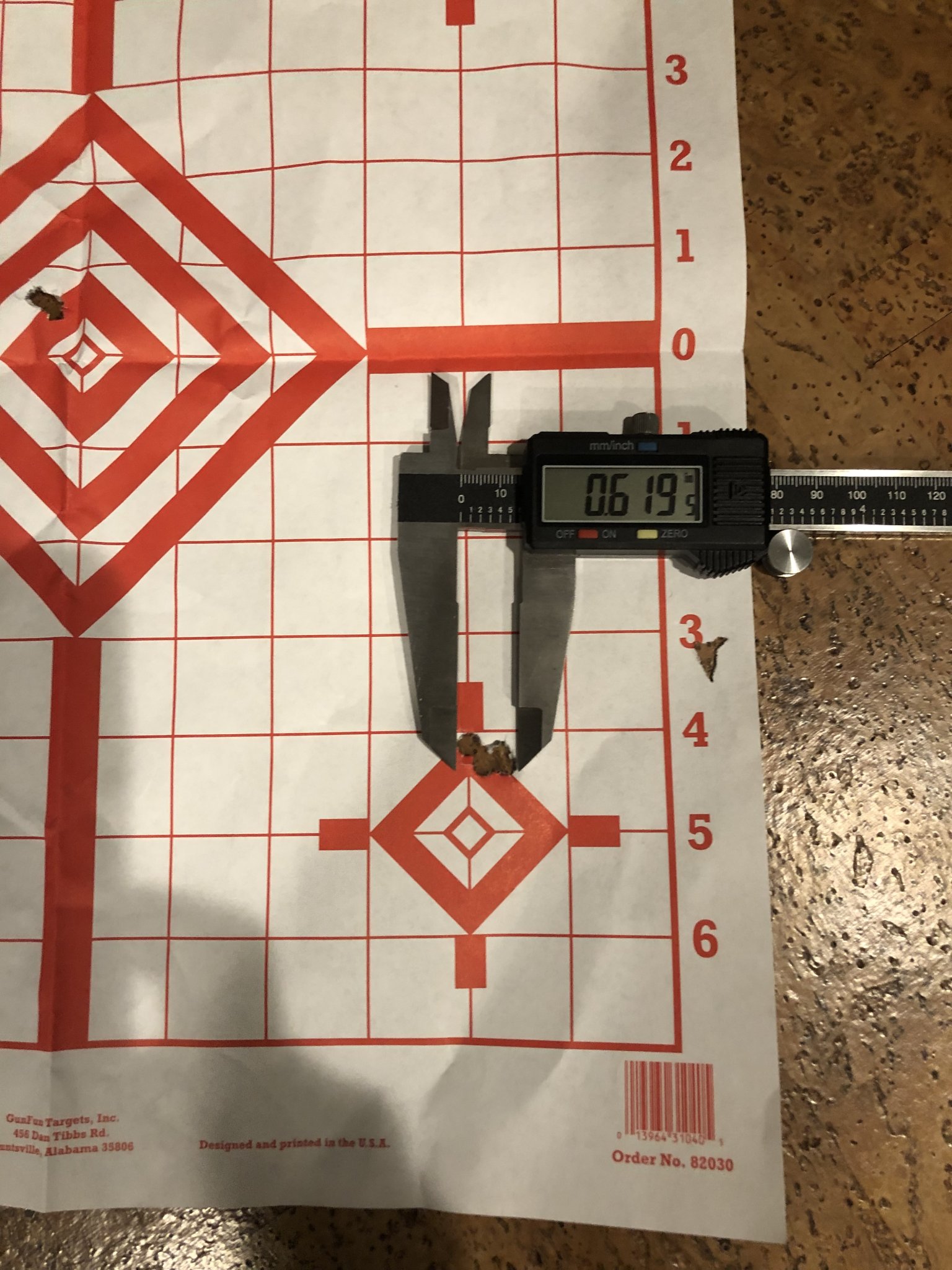

Finally got to shoot it today. Im an idiot and didn't have tools to adjust the zero stop so i had to do a hold over. Only shot about 10 rounds. The last 3 are the group below.
Works out to .488 i believe. @MADMATZ !!
