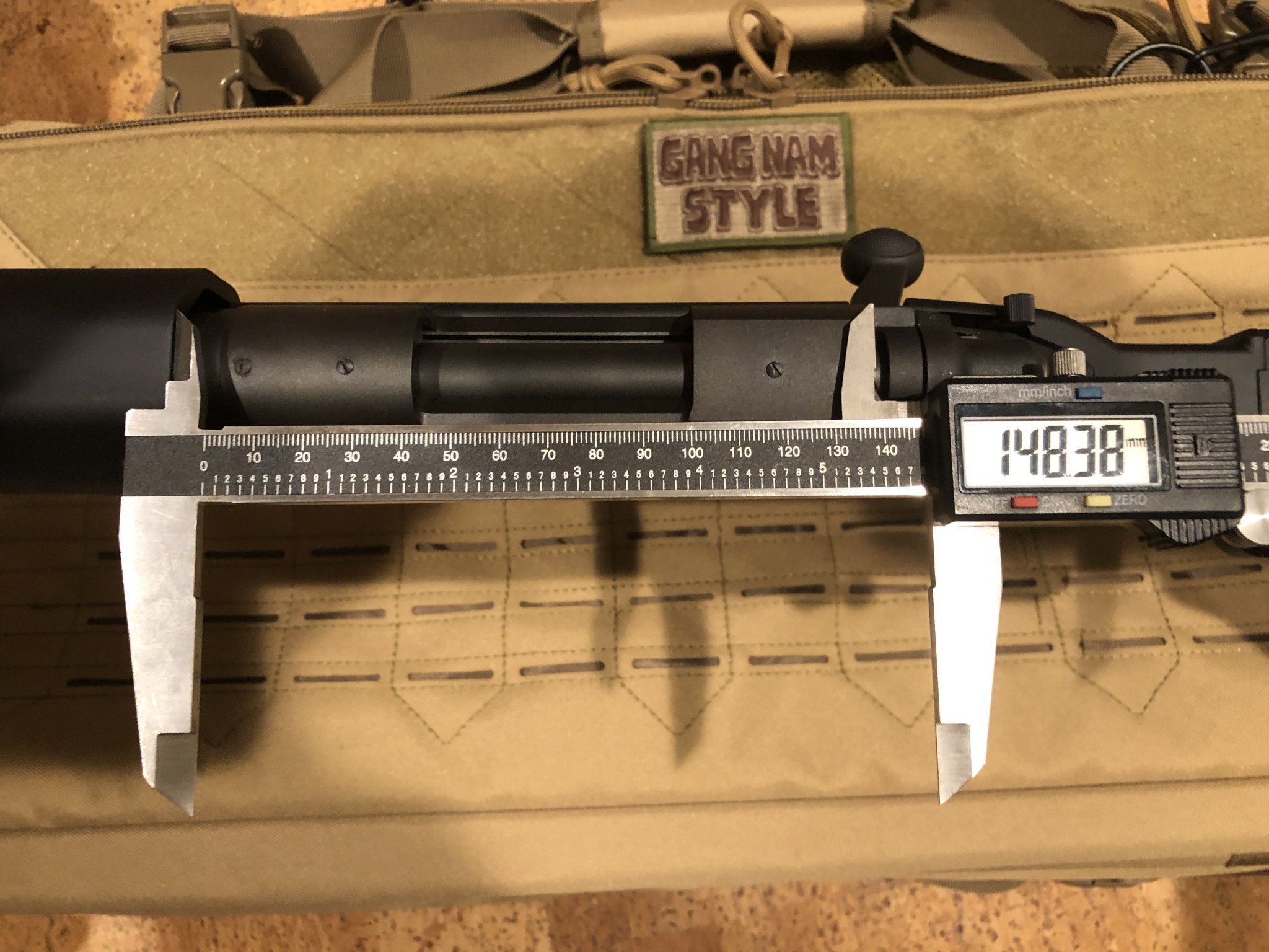

I measures 148.38mm (5.84”) from the hand guard to the back of the action.
7042627
The APO 20 MOA scope base is only 139.7mm (5.5") long so it easily fits.
Spuhr R-7601 6mil scope base is 145mm (5.7”) so it should fit but may be tight. I hope to get down to MHSA and try one on for size this week.
Badger Ordnance 306-06 / 306-06A looks like it will be too long with the extra overhang up front. They don't list dimensions but I'm betting not.

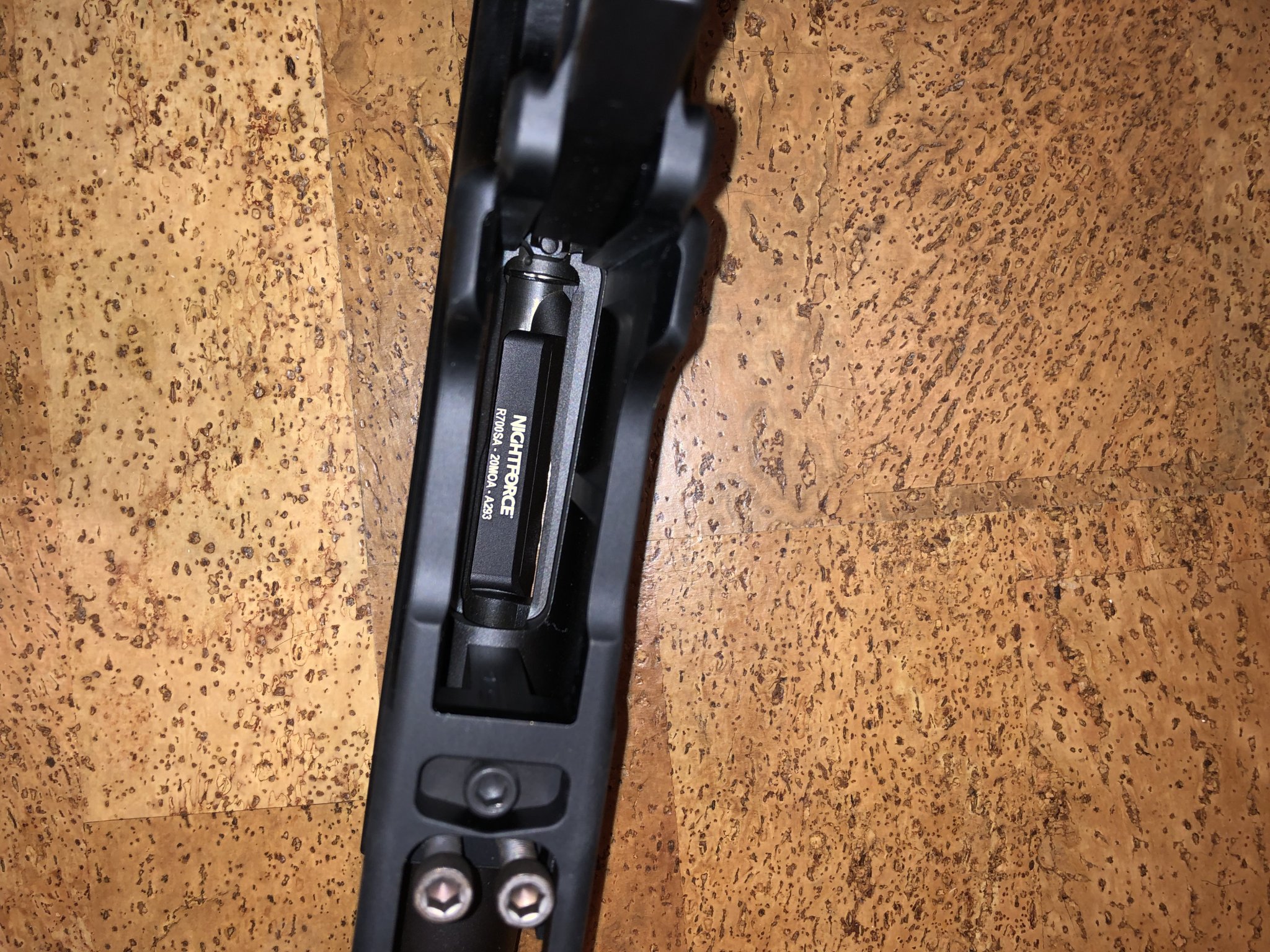

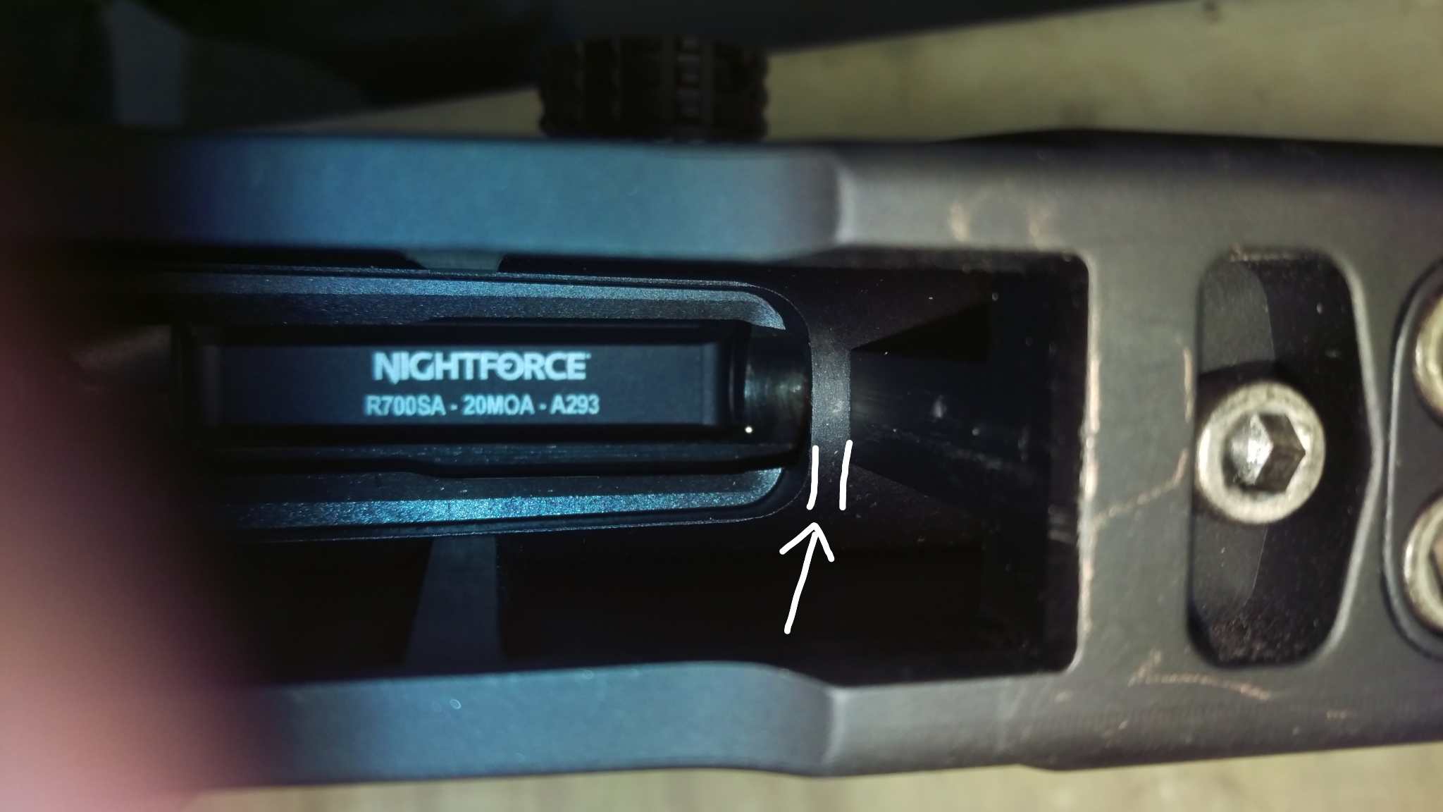

Nightforce A293 Aluminum - Confirmed fits by both 2aBaCa and myself.
Nightforce A115 Steel - Too long
I just put on the nightforce 20 moa, like # 296
I think you meant A293, also to note this is the standard duty aluminum version, the extreme duty steel version looks like it has an extended front that would not fit.
I think i may order me this exact same base tonight. I cant justify the extra 35% cost for a Spuhr aluminum base.

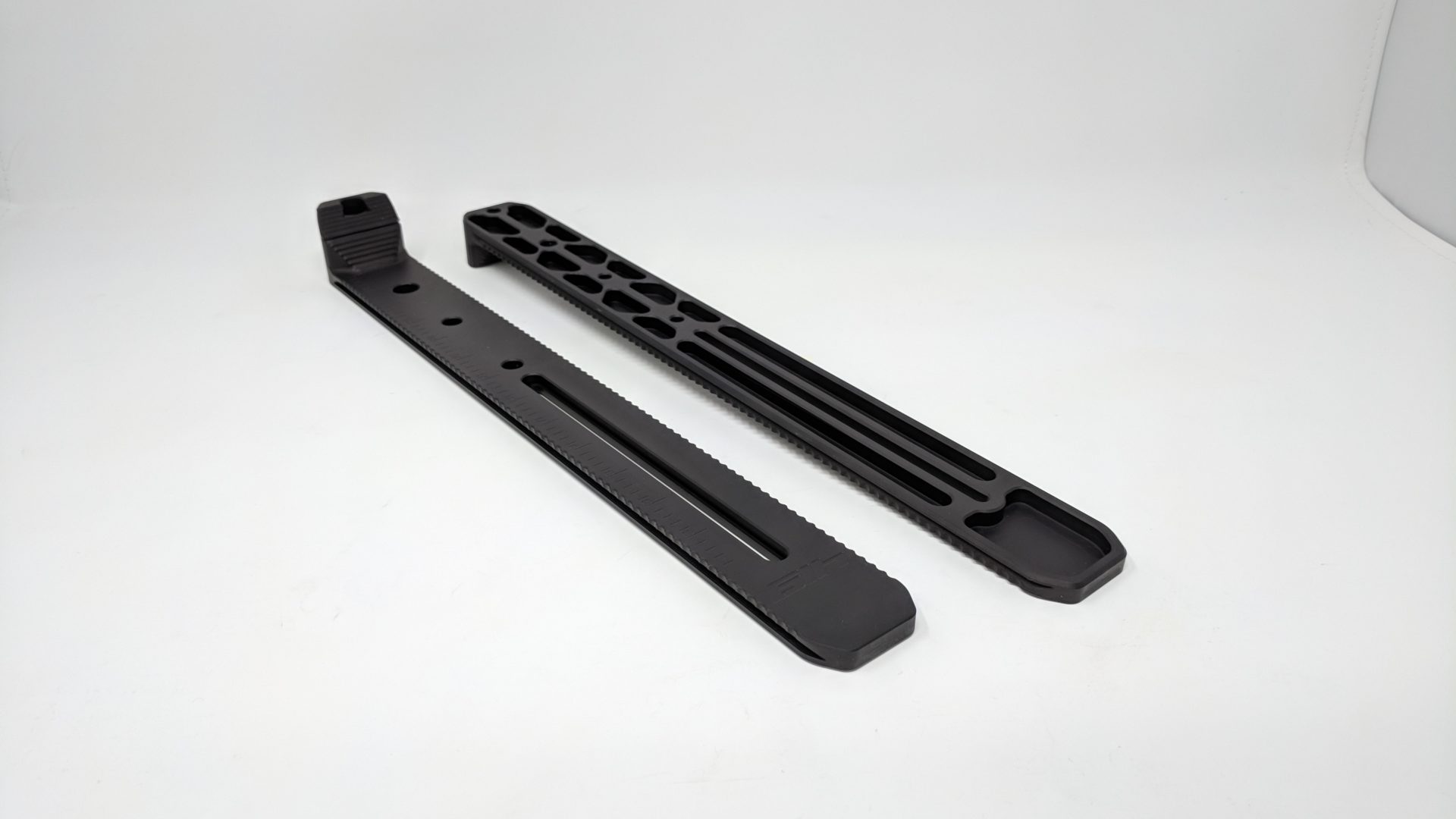

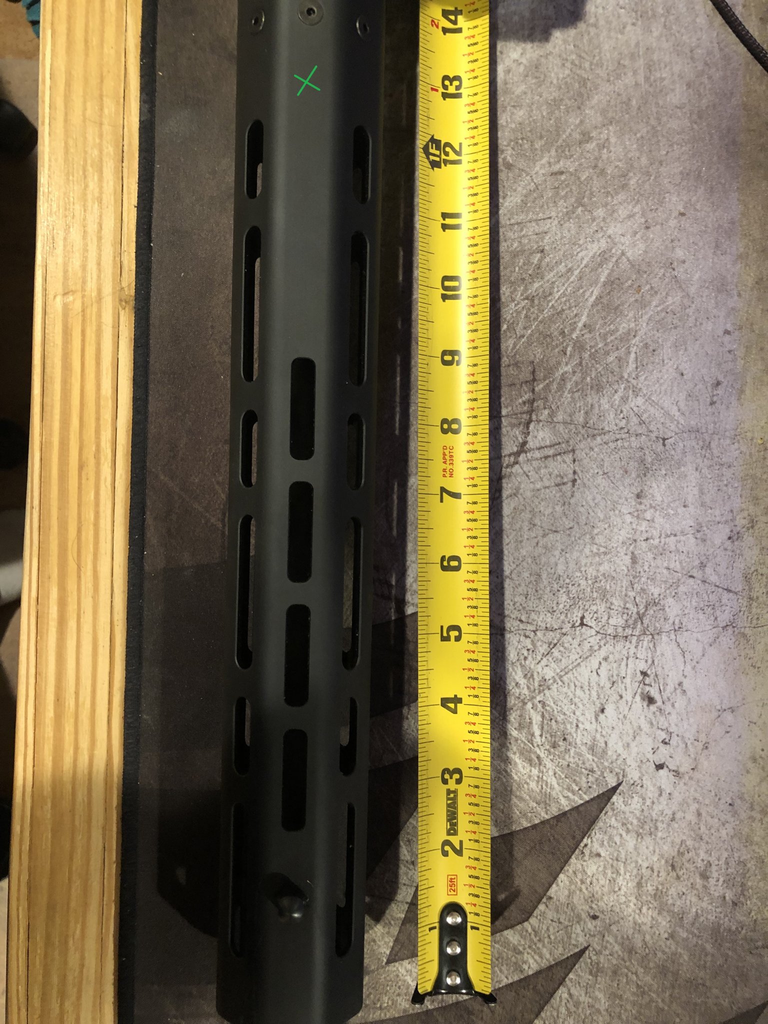

Today's Saber M700 time sink was to find a ARCA or RRS spec full length dovetail. I had asked Frank in his thread for the SH edition about what his plans were and he suggested he was going to use a 9" or 11" HRD universal rail kit. I liked his idea but the hand guard is 13.5" long so I went looking for longer options. Then I found this:
Area 419 - ARCALOCK 14″ Universal Dovetail Rail
7043525

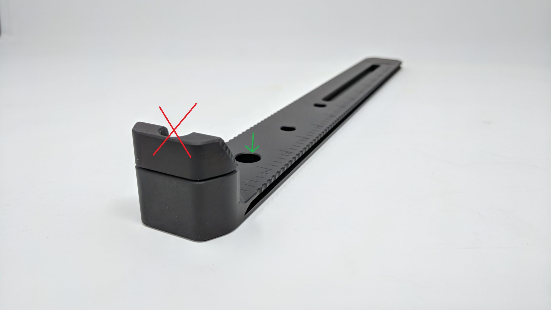

It looks like I can cheat maybe 1/4-1/3 of inch back past the hand guard so with the 13.5 + the rear cheat it might overhang 1/4 or a little less up front. I think I can live with that.
My plan is to use the forward part with the generic holes to interface with MLOK slots toward the front and perhaps use the existing sling stud hole if it lines up.
For the rear I would skip using the action through bolt ( see red X) and instead drill a hole in the hand guard on the next hole (green arrow) closest to the action. Additional holes will be drilled in the two forward holes if needed for strength. Who does not like drilling a brand new rifle :)
7043526
That will put the hole some place around here.
7043528

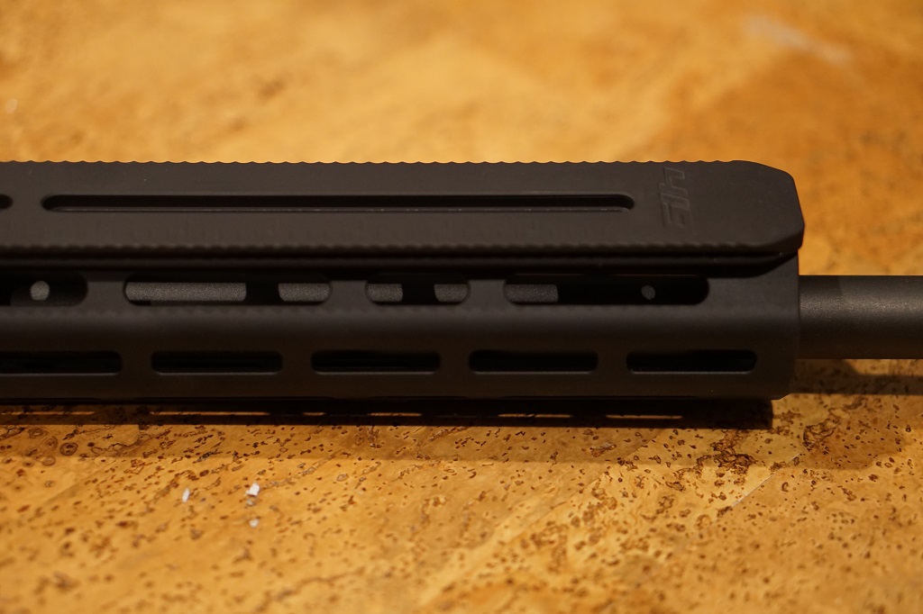

Area 419 Universal 14" rail! Looks like it will fit perfect and I only have to drill one hole in the rear.
Note: Magpul MLOK screw heads are too big to fit in the universal channel however Area 419 said they have some you can purchase with the rail.
The screws that come with it are 10-32 and have a head measurement of .312 wide and are about .102 thick.
Since you need 10-24 screws for the MLOK nuts I ordered these for the MLOK:
https://www.mcmaster.com/#92220A162
These 10-32 for the sling stud and other holes I drill and tap:
https://www.mcmaster.com/#92220A172

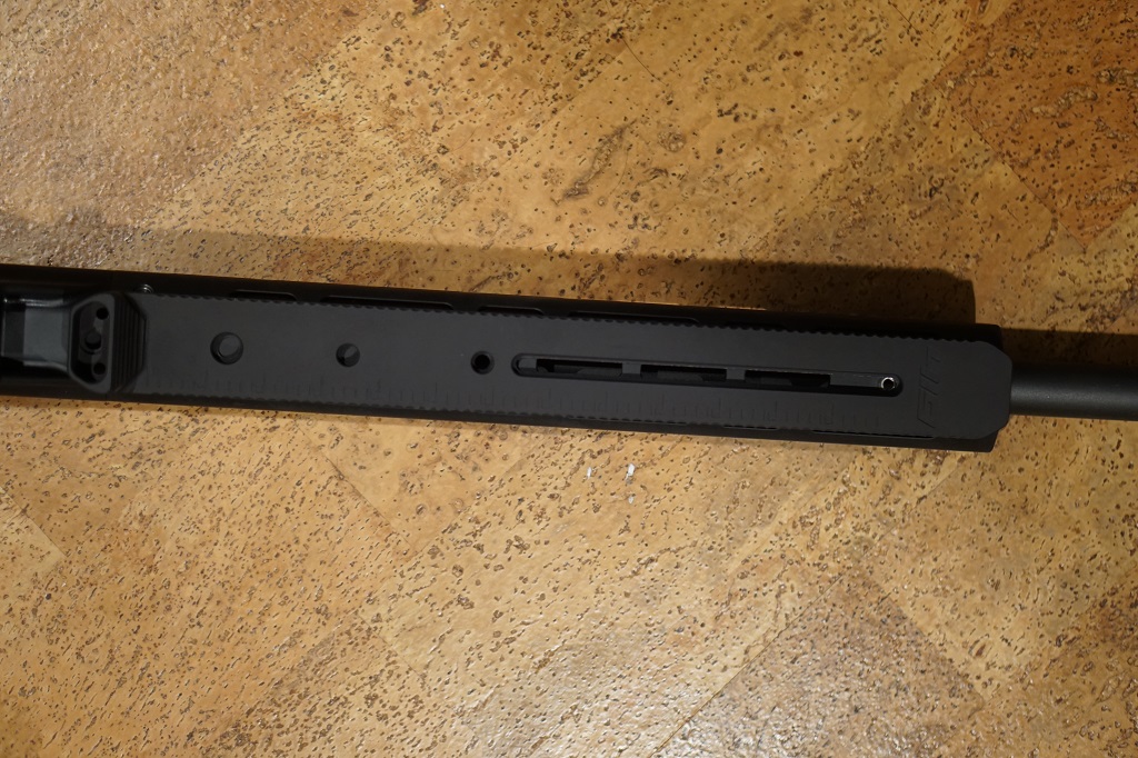

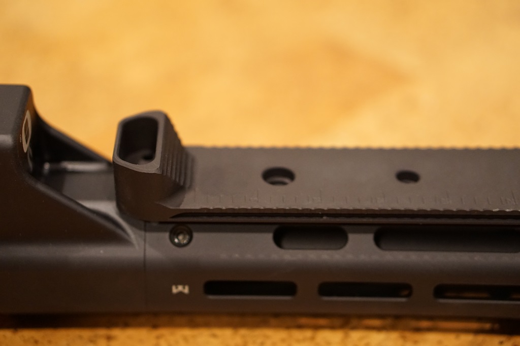

The last hole before the barricade stop is bigger, I'm going to try using the hole in front of it, with a bolt. The hole closest to the universal slot hits the 4th and most rear MLOK slot, so I'll use that. 3 MLOK nuts into the other SLOTS and lastly one bolt into the existing sling stud. Hopefully 5 bolts with one on either end preventing shifting forward and aft movement should be rock solid.
7045075
7045076
7045077

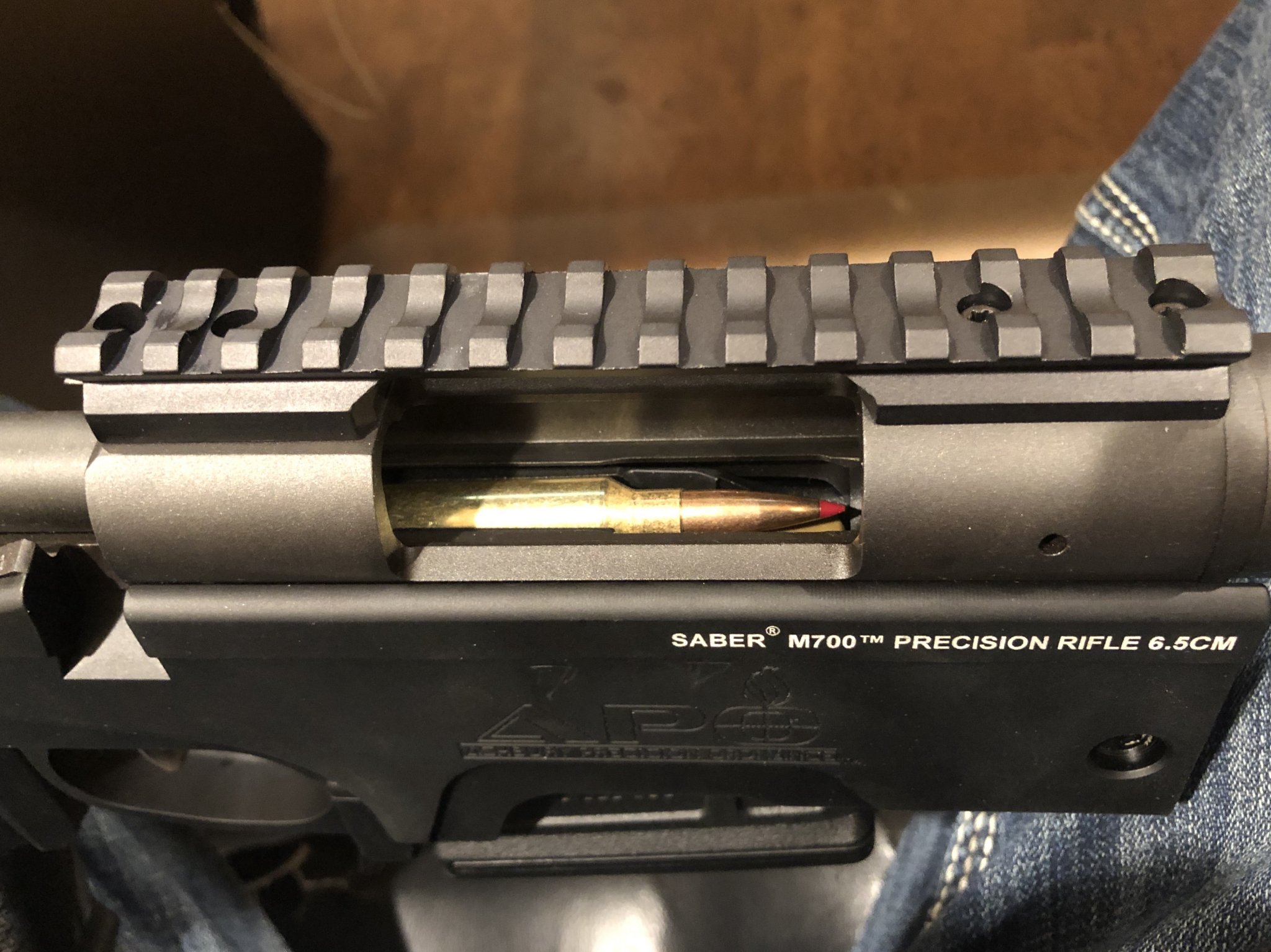

Have you cycled a full mag of rounds through it? I have with some dummy rounds and encountered an issue feeding.
Not yet, I don't have any dummy rounds and I'm not brave dumb enough to try that with live rounds in my house. What sort of issue did you have?

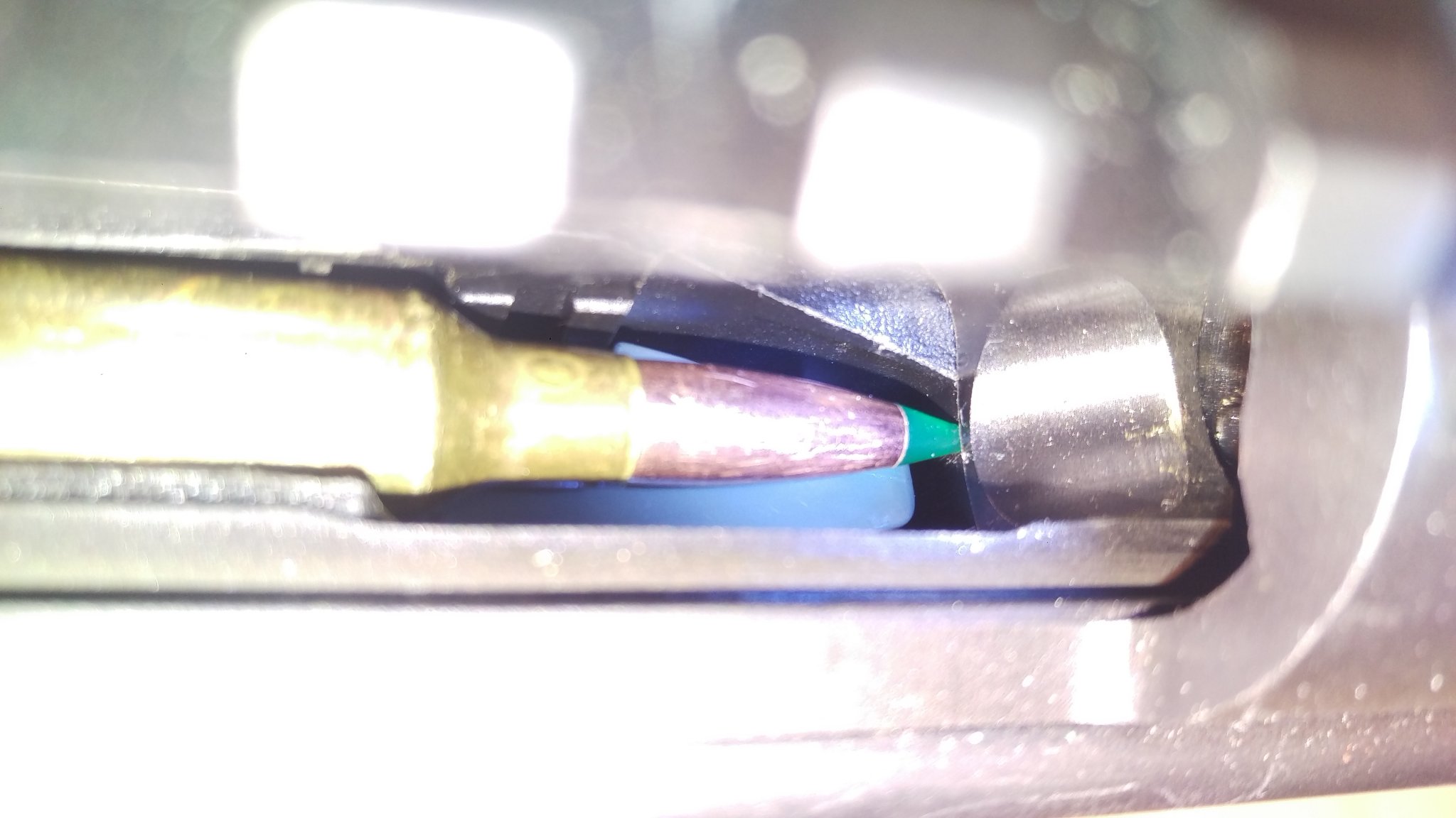

The tips of the bullet hit the bottom of the feed ramp and nosedive causing a jam.

Happens if the bullets shift forward in the mag, sometimes just the friction of the sliding round being removed from the mag is enough to shift the on deck round forward just enough.

With an empty mag in can you feel a lip under the feed ramp?
Cant remember off the top of my head but shorter than a hornady match eld 147. Longer than cheap winchester 140.
No lip, mine is pretty smooth.

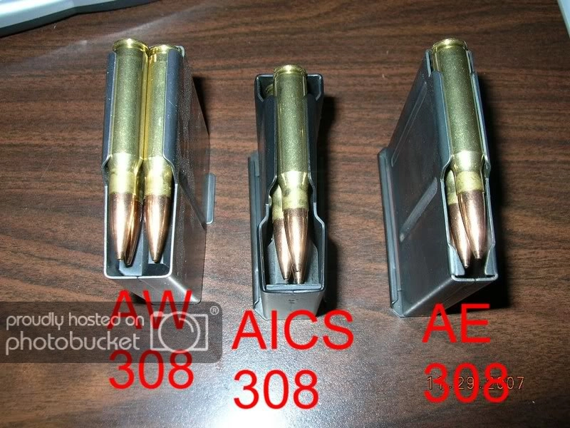

Does your magazine have a binder plate? This will keep the cartridges from shifting in the mag and getting under the lip in the action. At least it is supposed to. It also shortens max coal. I’ve read that you can also have that little lip milled so that bullets don’t get caught...
Just in case you don’t know what I’m talking about with the binder plate. Scroll down for explanation.

Savage actions typically can run the long coal mags fine but I think most Remington 700’s need to be notched for them.

What mag are you using? (see hlees link above for decription and illustration)

That is strange that its happening with the magpul, saw your blue follower and figured it was an mk machining in an arc mag or something. But I can see the magpul wall geometry now. Does seem weird that the magpul is letting that happen...
No, you cant easily get the aw to fit, the action would need to be opened up an then a longer release lever to get it at the proper height.
Notice that the aics is much skinnier, and that its a single feed. You would need to open up the feed port in the action to even allow it to be inserted and then you have to overcome the fact that single stacks present the round relatively higher than the double stack does.
7045730
(also notice that the aics has a binder plate present, that stops the bullet from being so far forward that it catches under the feed lip as demonstrated in the MDT link from hlee)

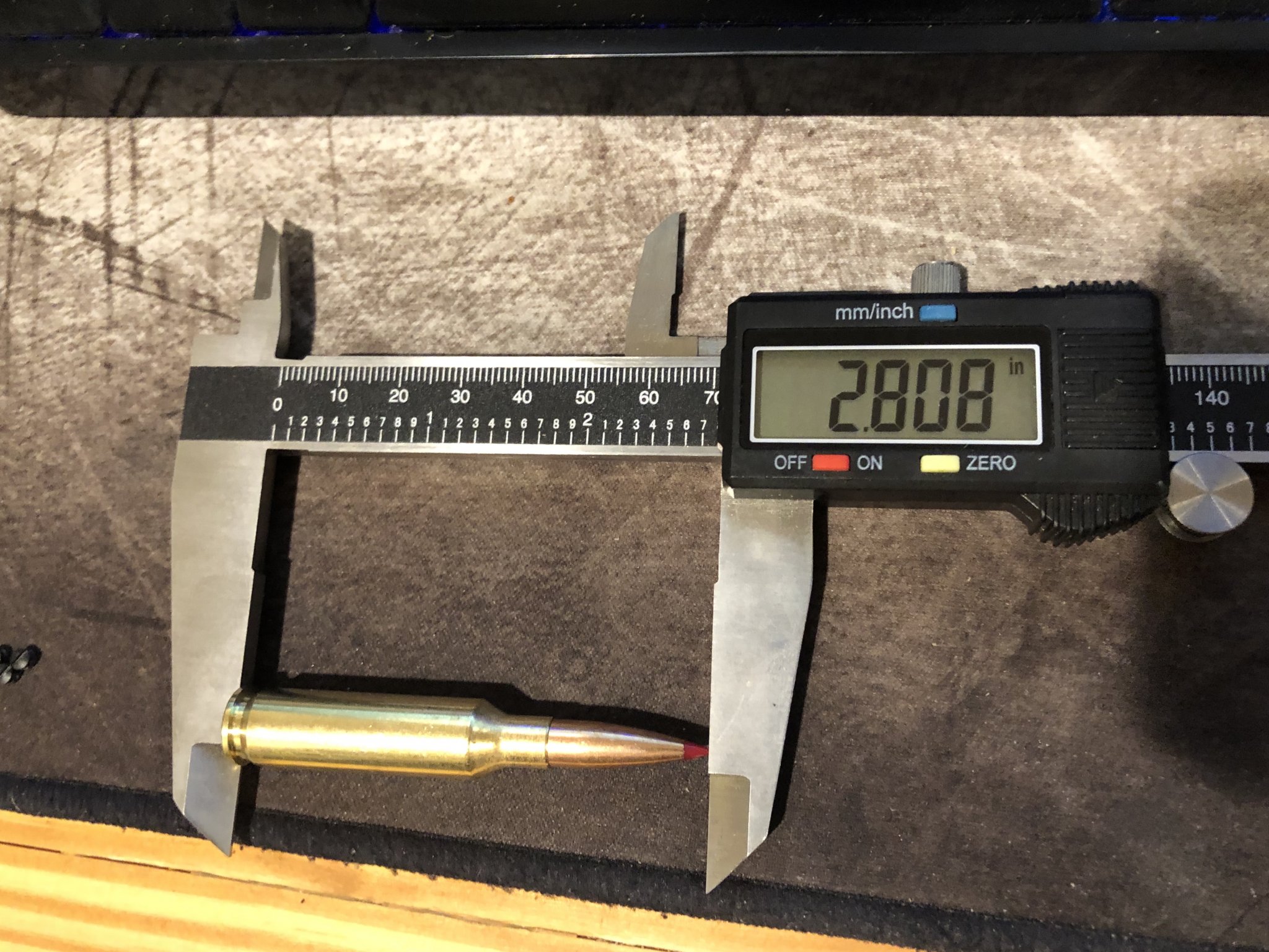

What caliber are you running and what ammo is that? Im guessing thats the sierra tipped matchking or gamechanger?
6.5CM It's a dummy round from a pack I bought off Amazon. Its oal is shorter than the Hornady Match 140s. Which hit it just by inserting the mag. The dummy's dont always hit, maybe every other mag one slides forward just enough. With an empty mag inserted I can reach in, push down the follower and feel the lip under the feed ramp.
Edit for clarity.
6.5CM It's a dummy round from a pack I bought off Amazon. Its oal is shorter than the Hornady Match 140s. Which hit it just by inserting the mag. It doesn't always happen, maybe every other mag. With mag inserted I can reach in, push down the follower and feel the lip under the feed ramp.
Strange, first time Ive ever heard of the magpuls not feeding properly. I would call up APO on the phone and have them discuss it with you.
5 minutes with a dremmel and its done. ?
video uploading.

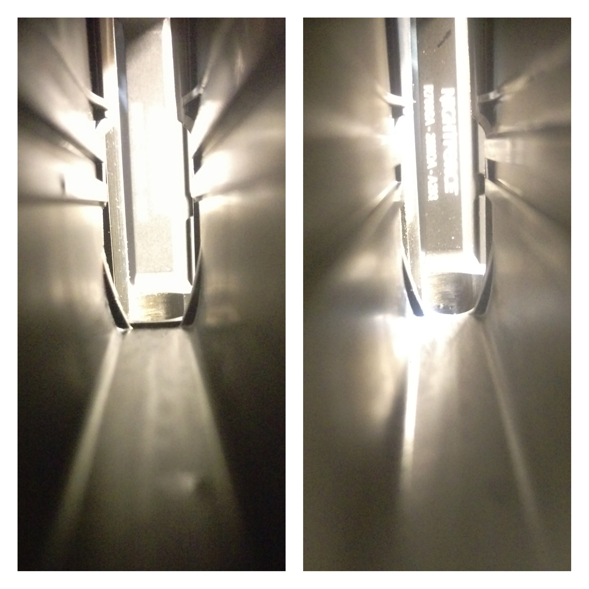

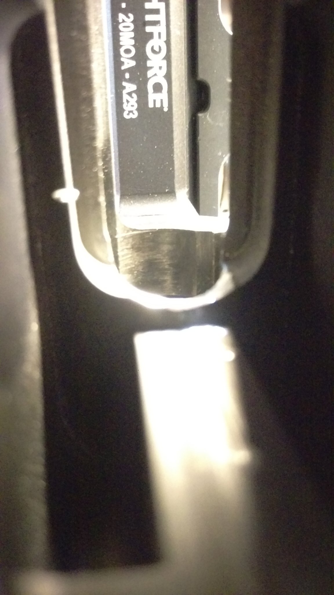

Before and after pic. Looking through the bottom of the Pmag installed. Floorplate removed. You can clearly see the feed ramp lip the one on the left that the bullets used to hit. On the right smooth sailing. Cycled about 100 dummy rounds not one jam up.
Nice! - Cycles the dummy rounds fine now?
