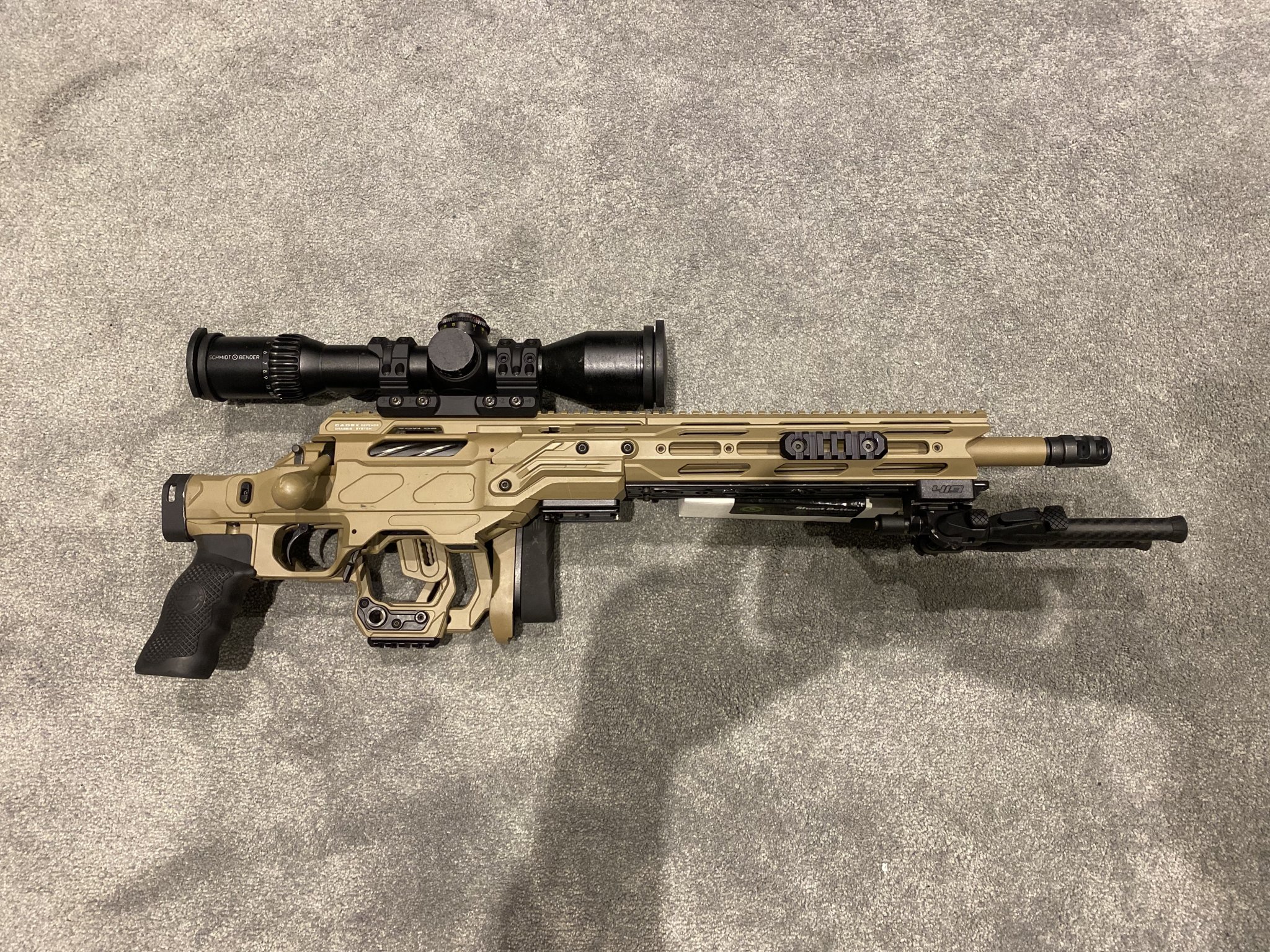

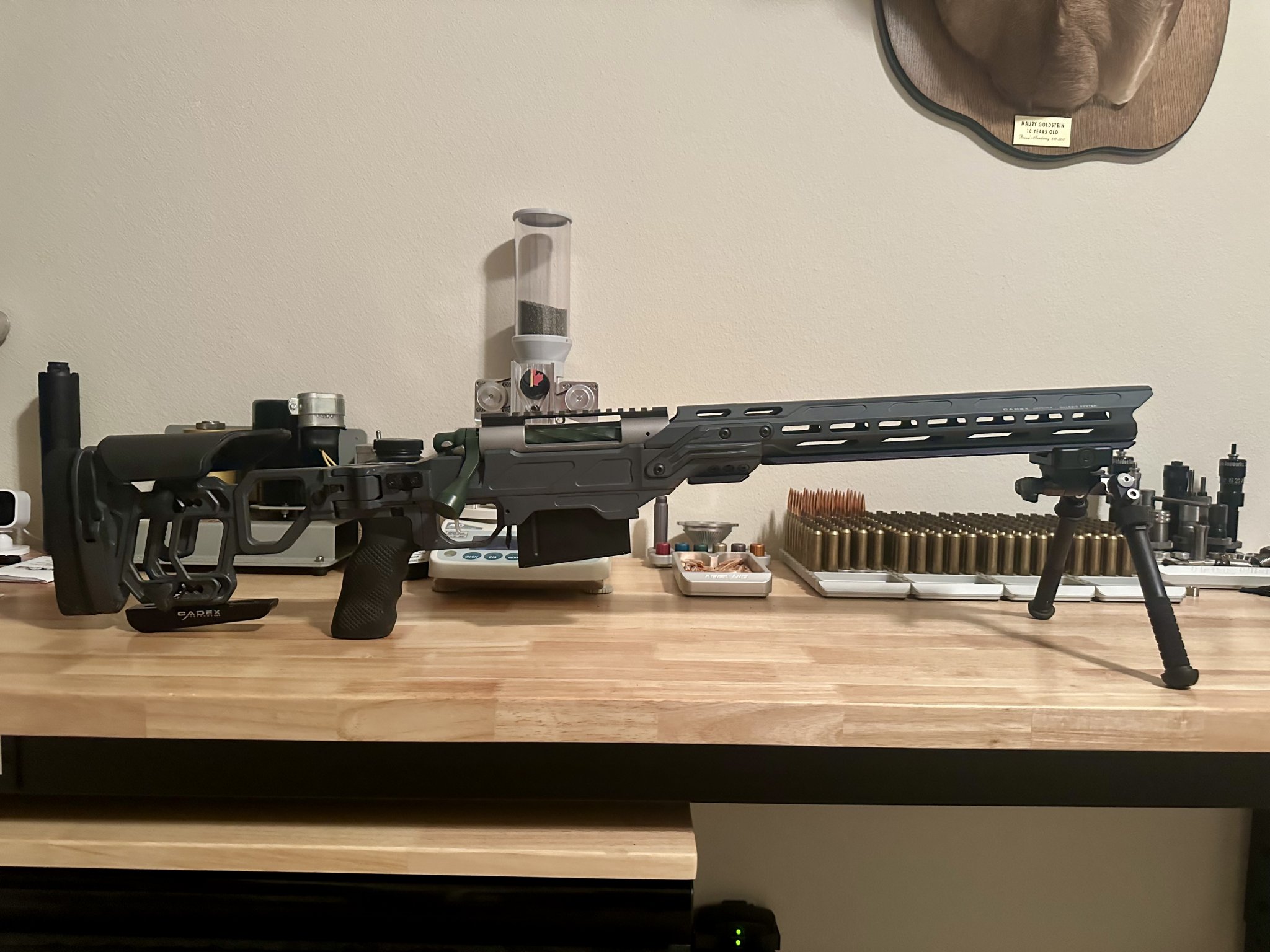

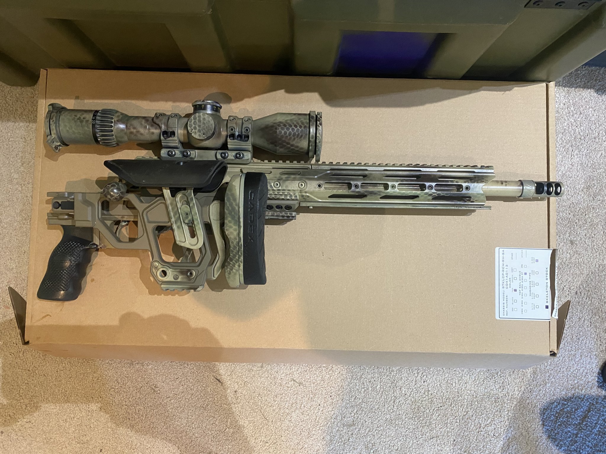

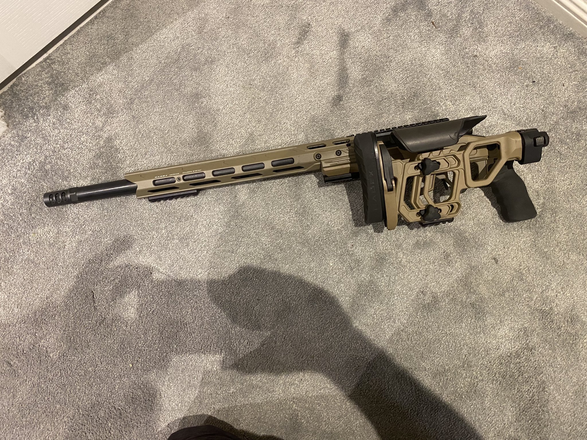

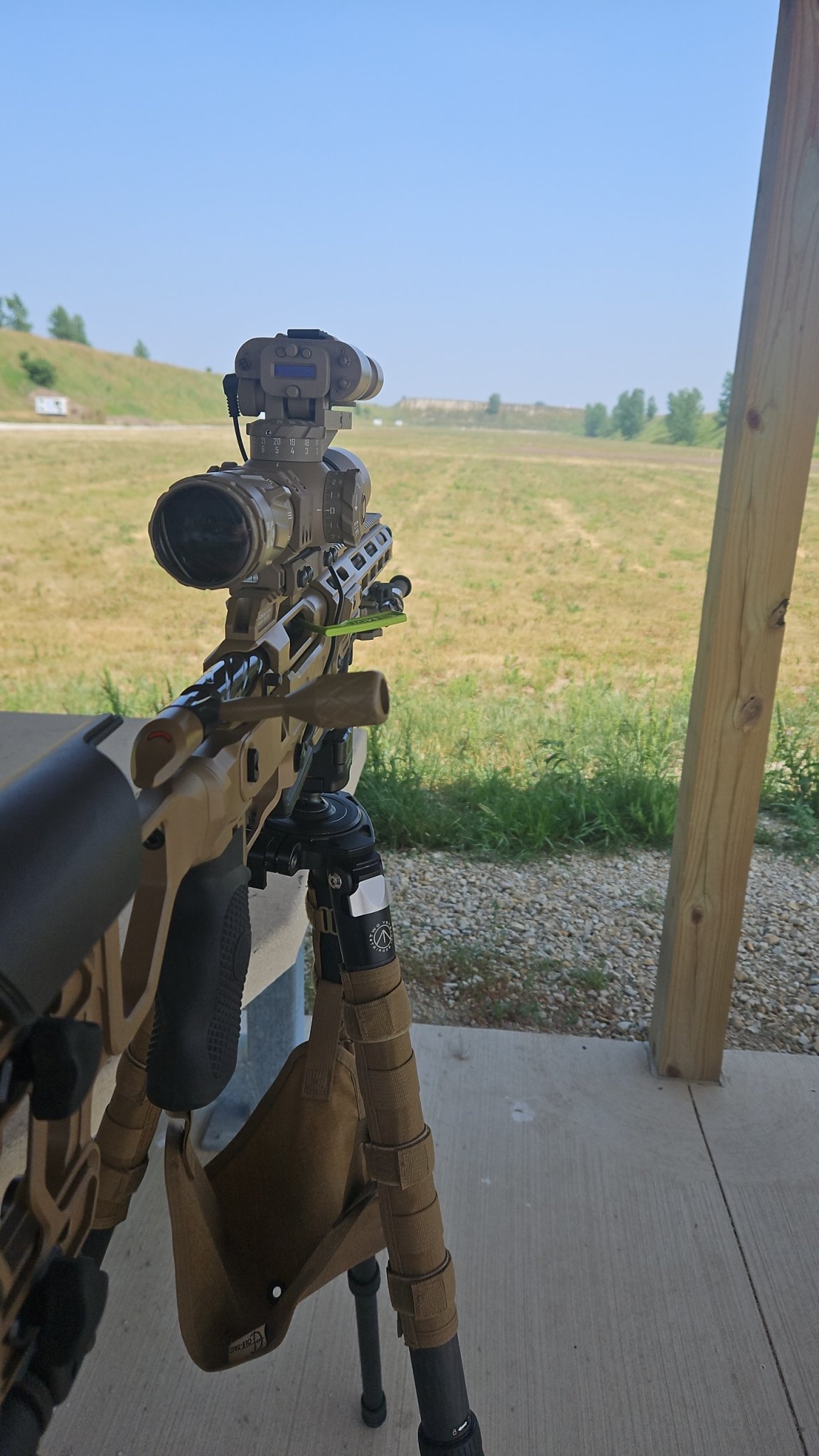

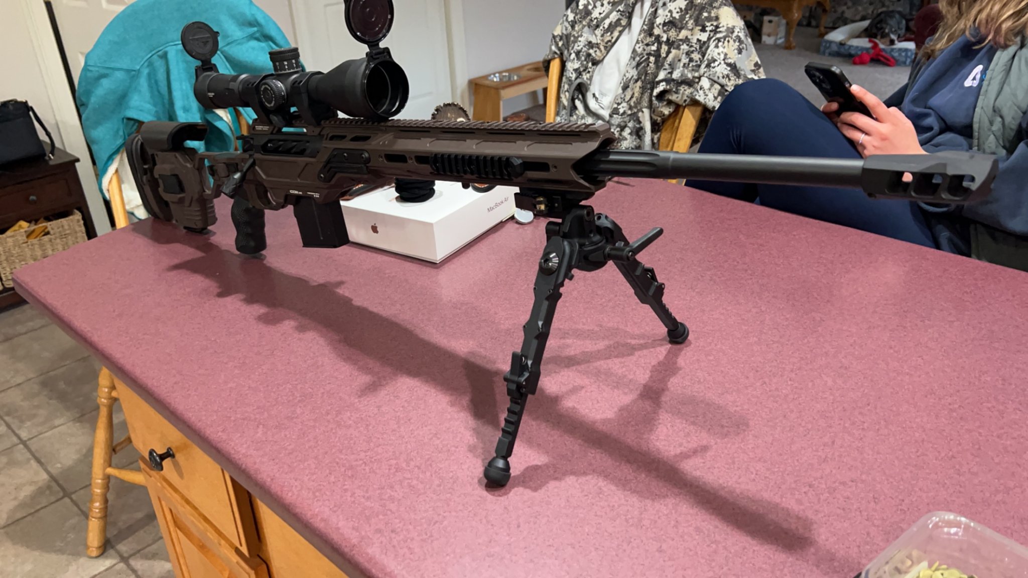

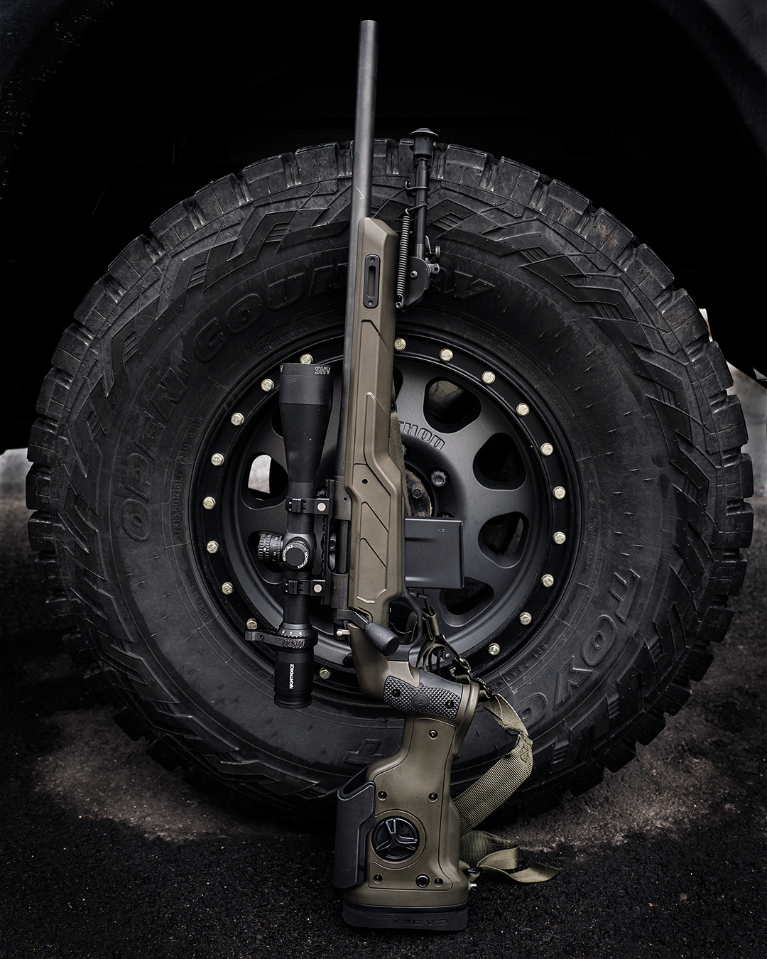

Converted the takedown to a folder. This took some fuckery to sort.

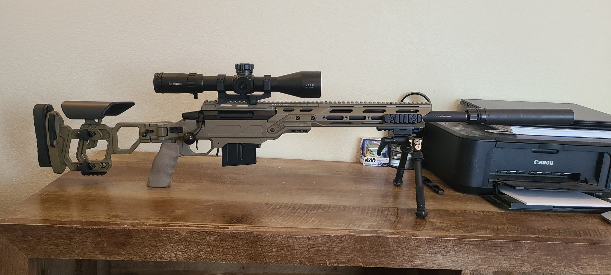

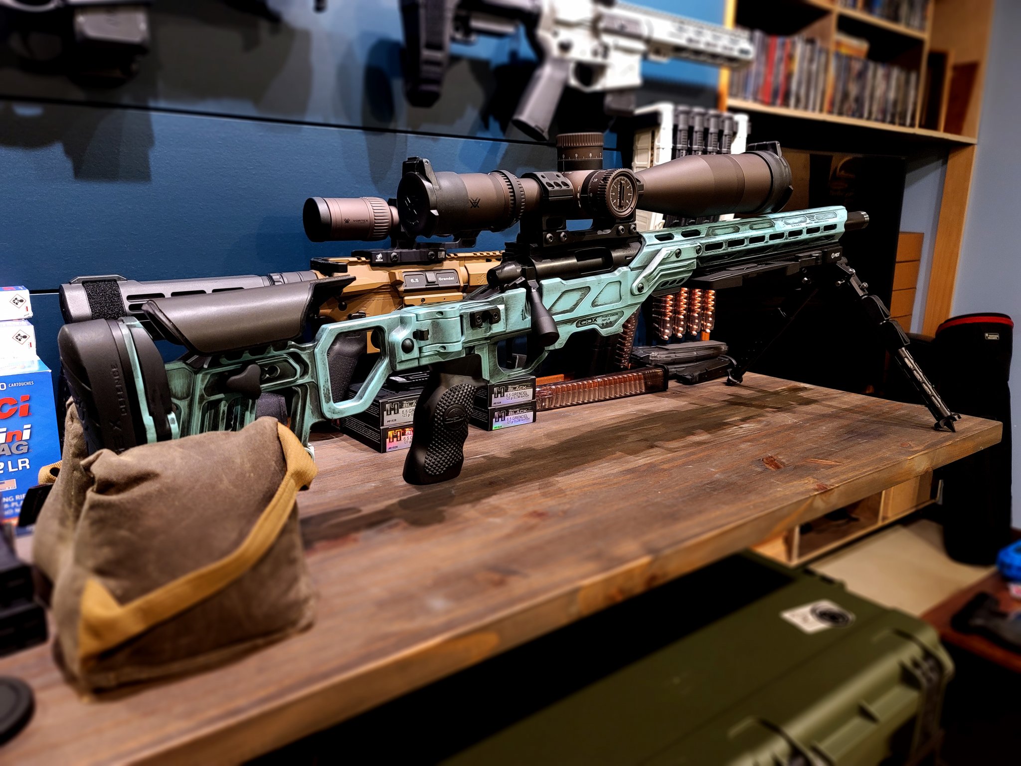

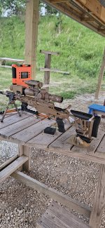

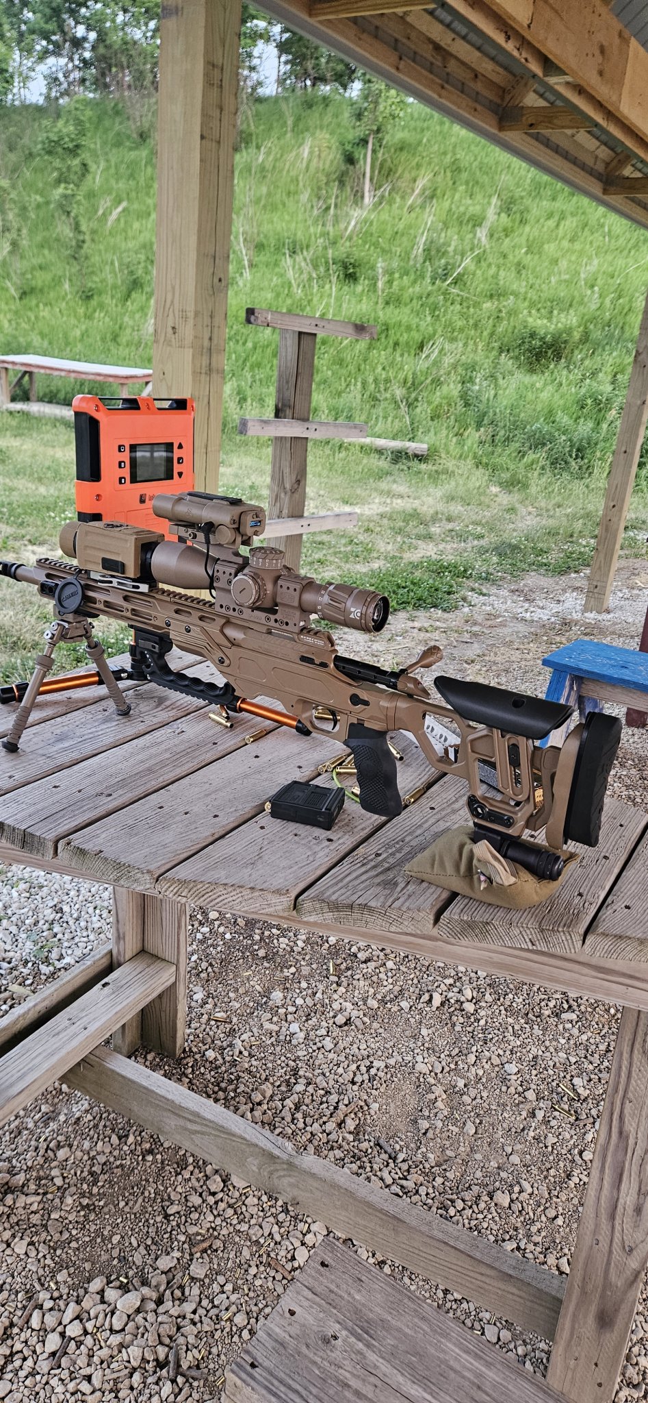

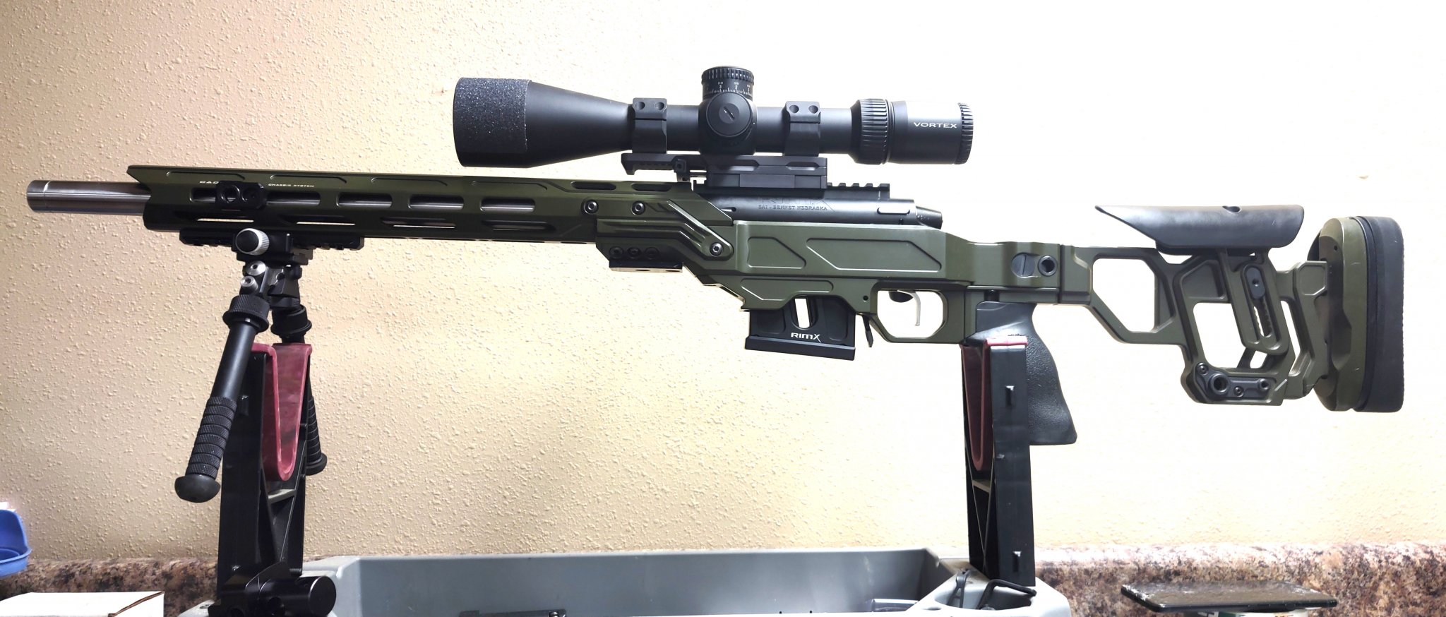

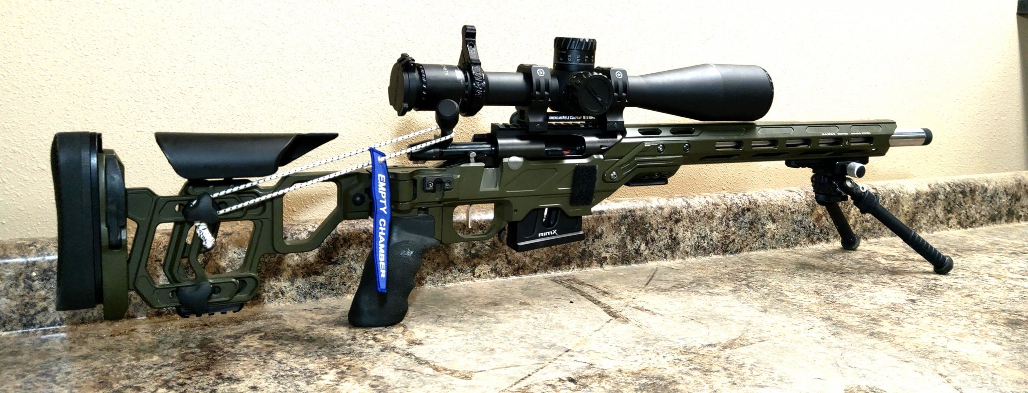

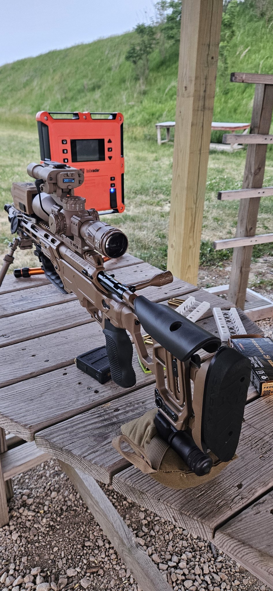

Man that’s one sexy rig, how does it shoot out to distance? Might have to build myself one 🧐
Thanks, hitting a full size IPSC plate at 500 yards I am about a 80% hit ratio, at 300 I am probably 95% with my 208gr. subsonic handloads. Significantly more hits with 125gr. supers at all ranges out to 700 yards.
All credit for this build goes to @Conquorer. I saw his build here last year and copied what he did.
Nice, I’m waiting on a kraken I just ordered but I might be building a clone of your rifle next

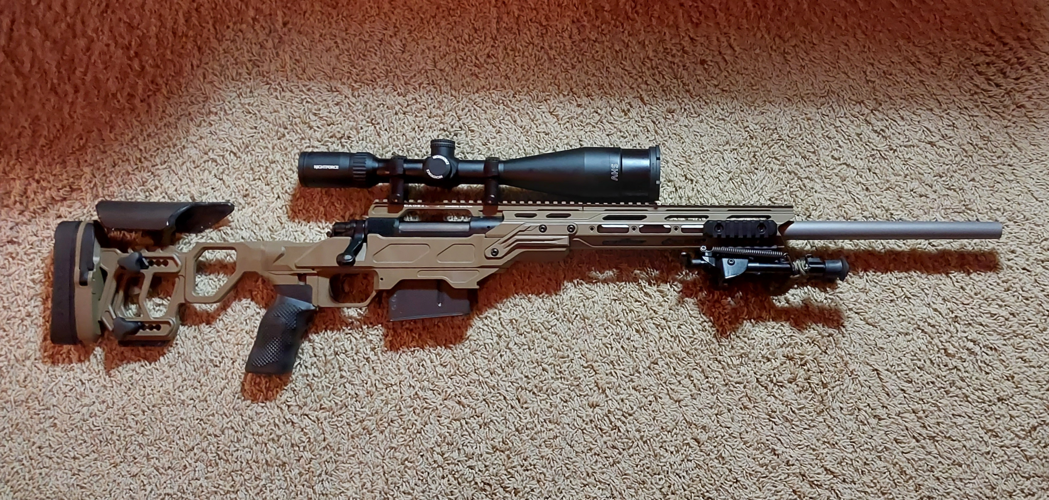

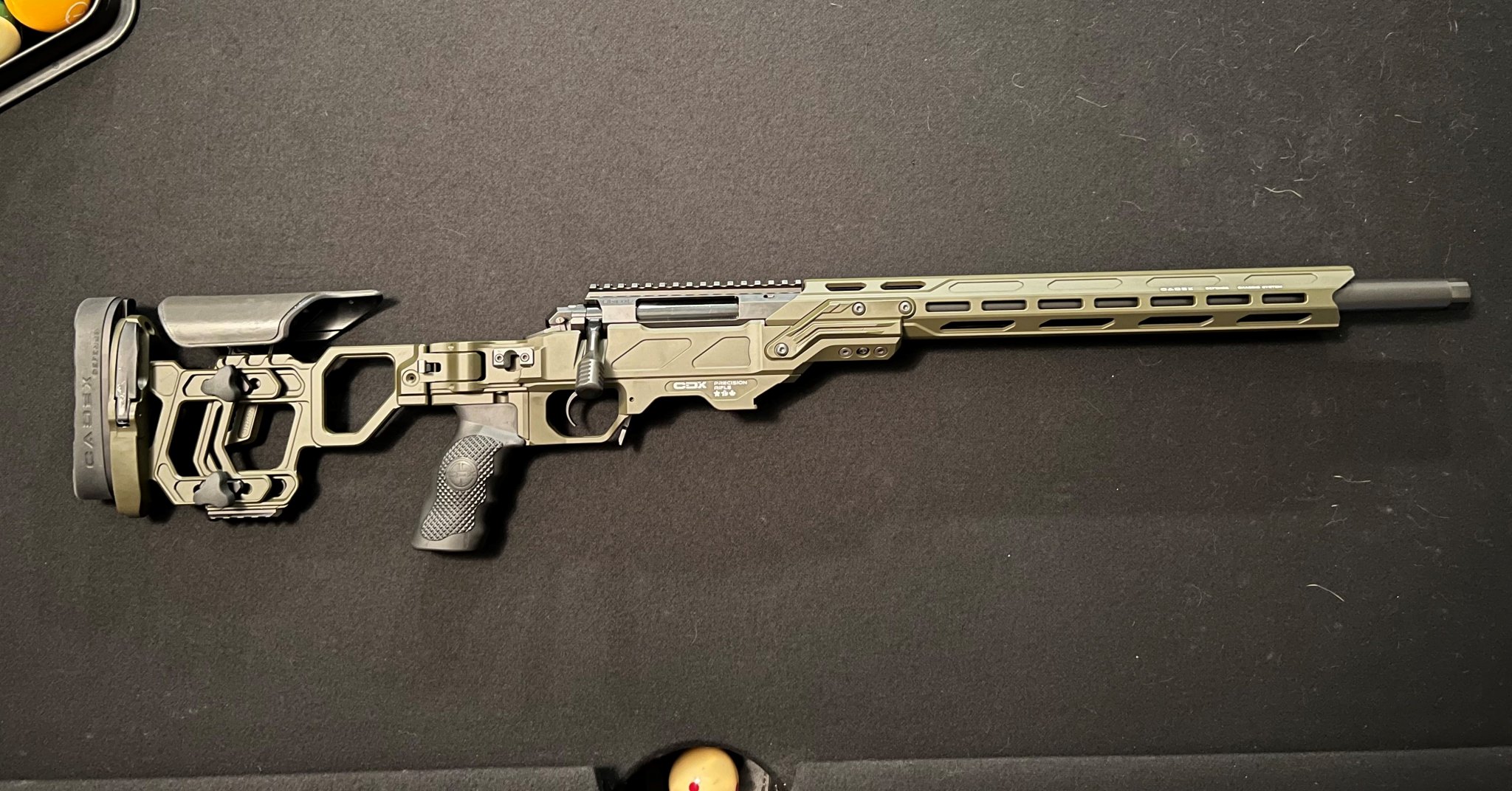

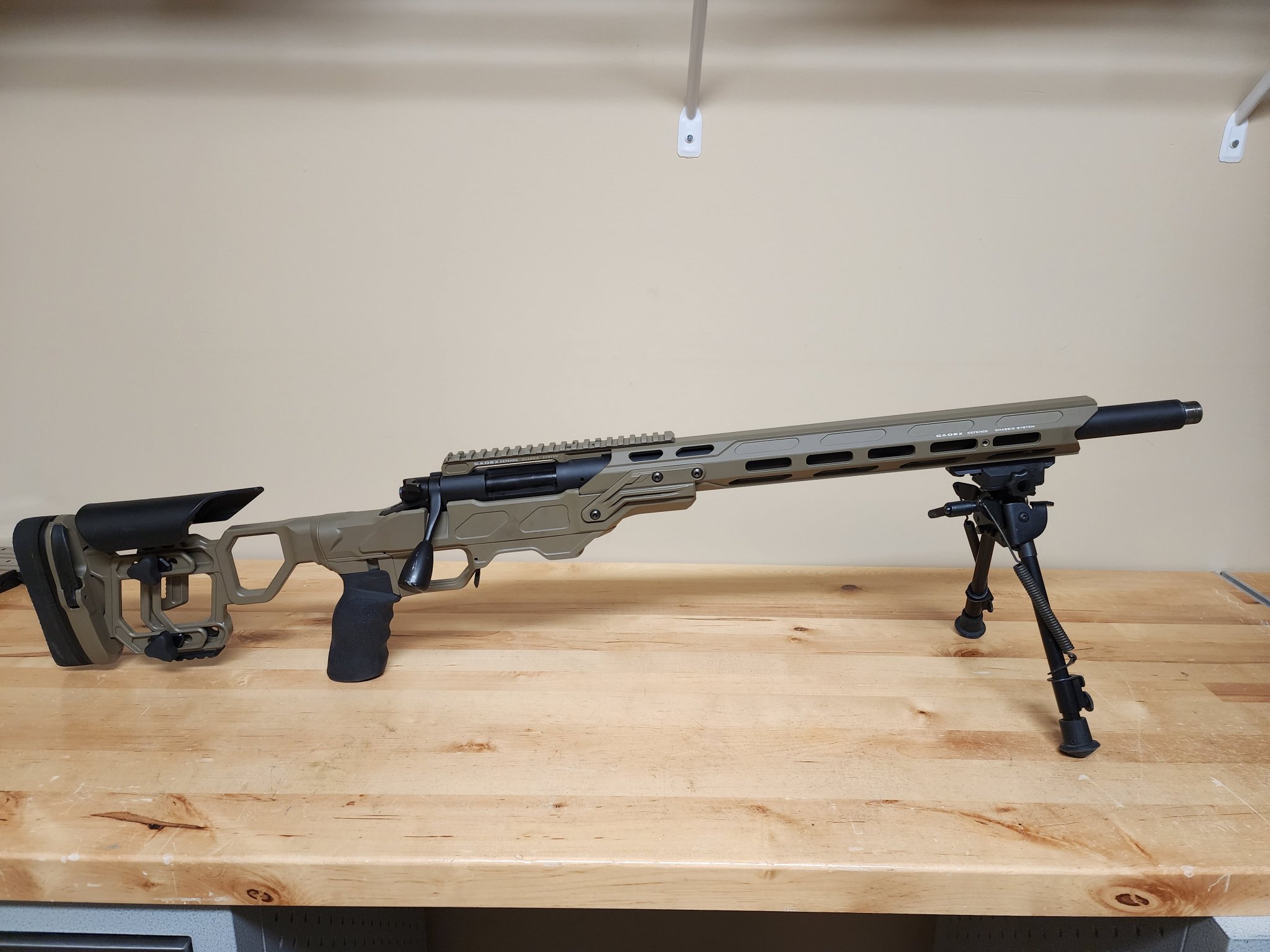

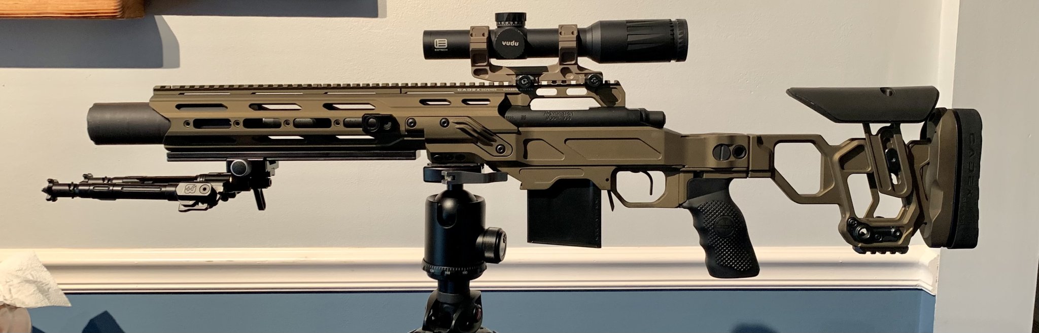

Has anyone added the 9” pic rail the top of competition chassis?

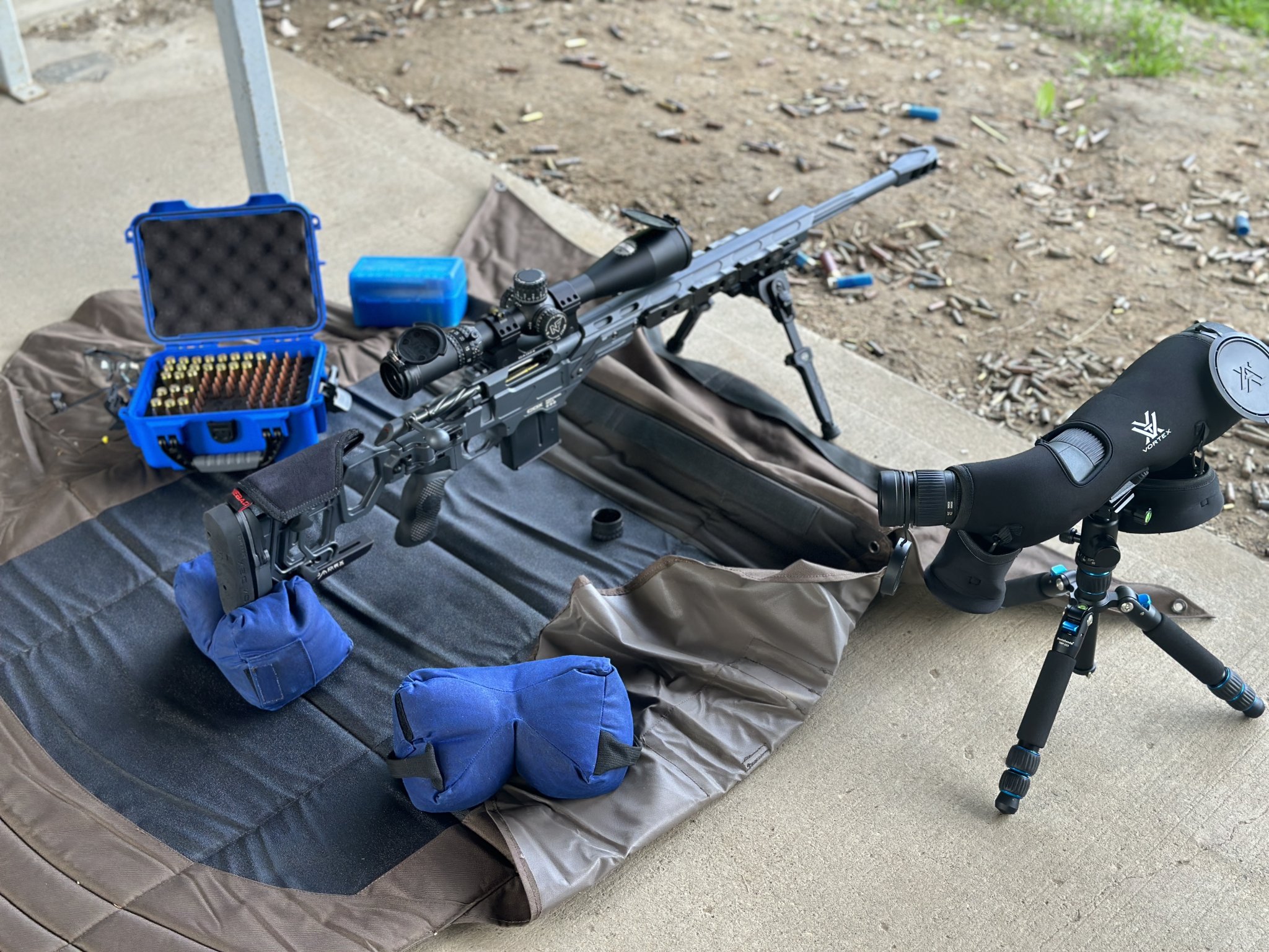

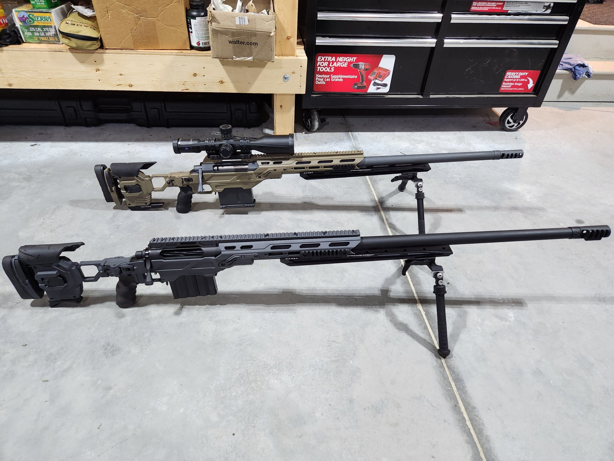

Yeah, I added it to both of my competition chassis. The pick below is a HS action with the Rem700 pic rail and I also have a Stiller action with the Stiller specific pic rail. Note the 700 rail comes drilled for #6 screws. The Still rail came drilled for #8 screws. I like them both as it makes the rifle look cleaner.
Reactions: xxflyingturtlexx
I didn't know I could buy that - I didn't;t see it on their website. is that a 20moa?

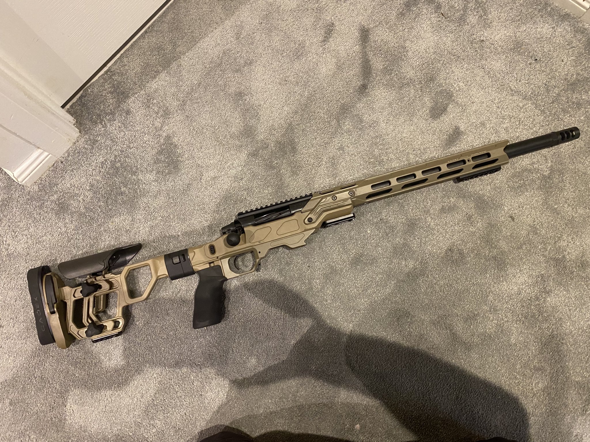

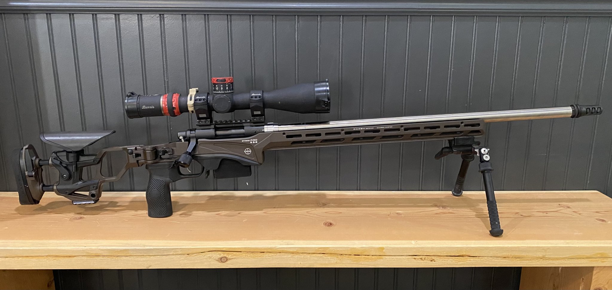

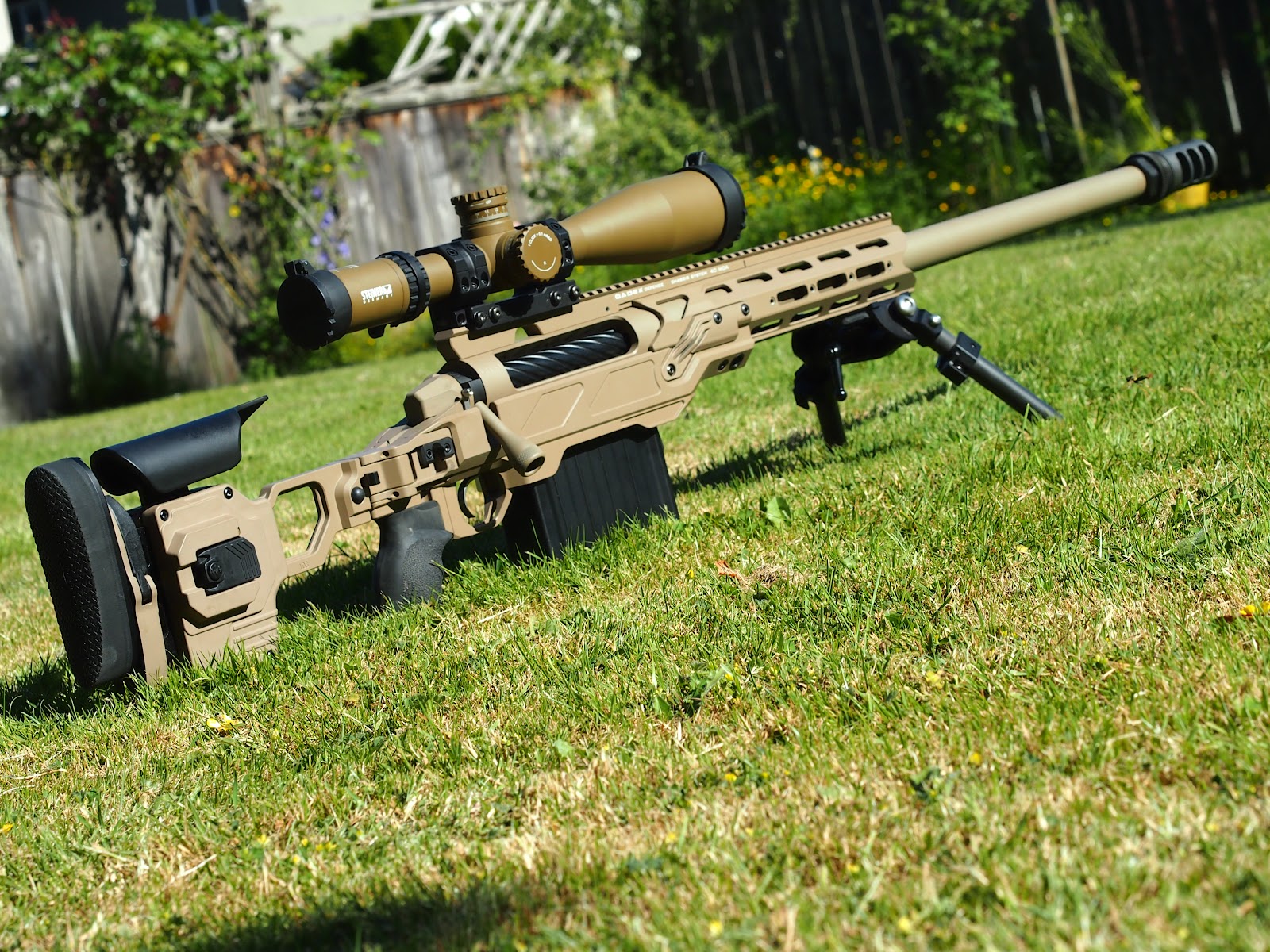

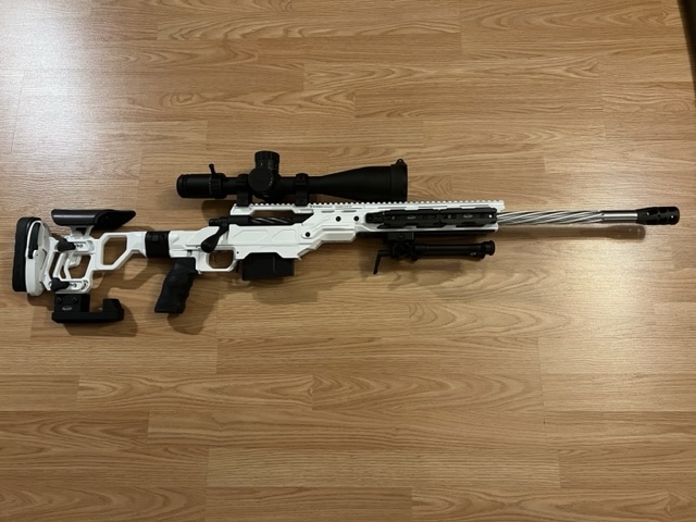

Never really paid much attention to cadex until I saw this photo, and let’s just say I was inspired.
How do you like this optic height with the Geissele mount? Conqueror went for ultra low scope rings; looks like you and another member have opted for a classic 1.54" unimount. Curious to see what you think is most comfortable for prone shooting, given the already tall picatinny section over the action.

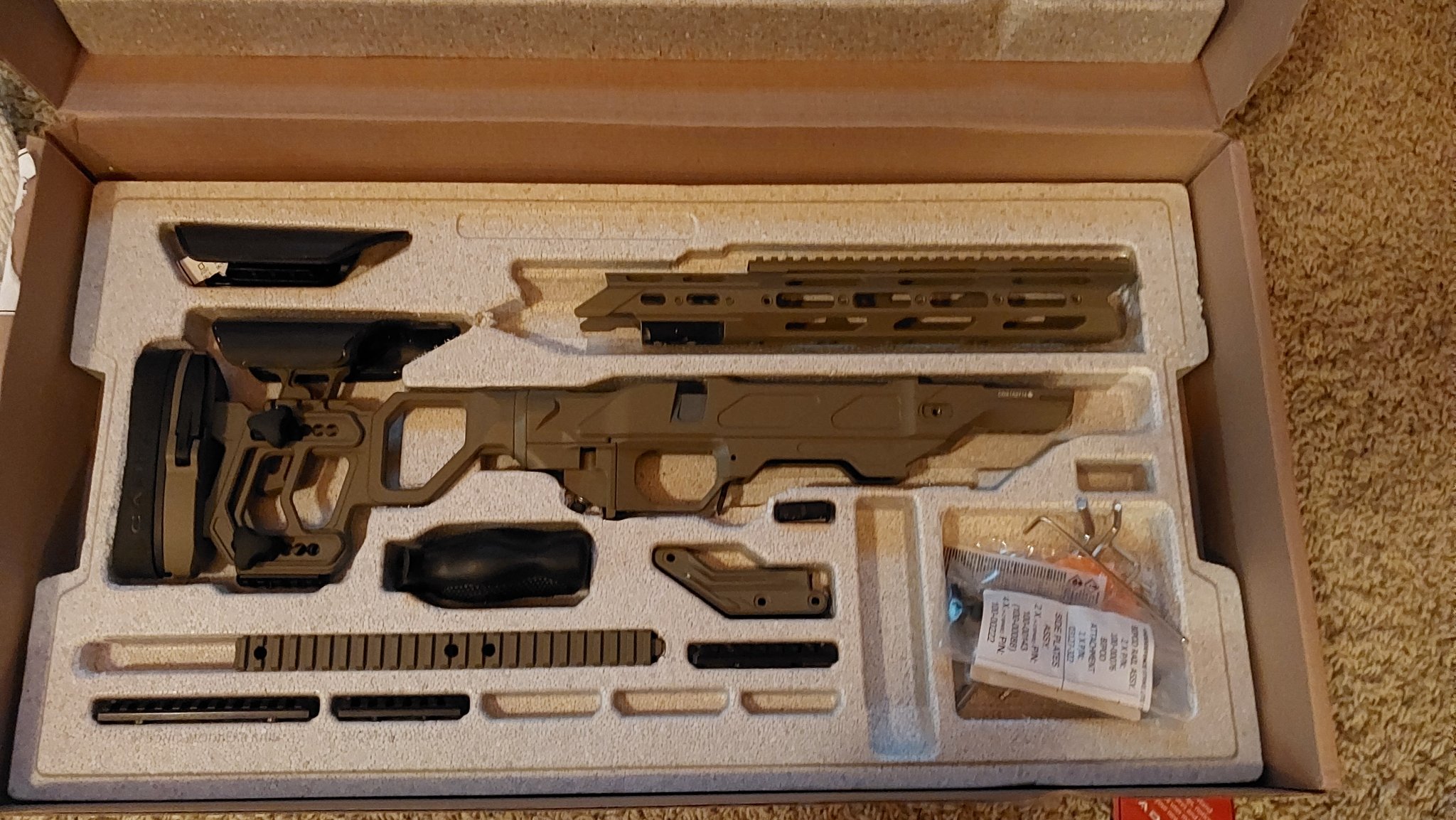

Bought a Dual Strike off the exchange here and I’m trying to pick an action for it now. On the regular Rem 700 Short action chassis would the Stiller Tac 30 or Predator short action fit? I’m looking at the Stiller Predator here. Any other suggestions/recommendations? Thanks in advance!
I can help you out here since I went down this wormhole myself. On the Rem700 version of the chassis that you have, only a Rem700 action will fit. This is due to clones of the Rem700 action having true round action bridges (versus the flat rear bridge of the Rem700) and different top action rail screw spacing and size. Rem700 action uses #6-48 screws and the Stiller Tac 30 uses #8-40 for the top rail, in addition to different spacing. The Predator Short uses #6-48 screws but you're still running into the issue of round vs flat action bridge in the rear and different hole spacing.
It's annoying that stainless Rem700 actions are seemingly out of stock everywhere, so my plan (and the reason I keep shooting you a note about buying your chassis off you) is to custom fabricate a brand new top integral picatinny rail that fits the action I want to run (Zermatt Origin). Not cheap or easy, but I have the means to do so and it's better than running such a junk action (looking at you Rem700) in such a nice chassis. Any recent serial (RR) Remington action is going to be plagued by bad bolt handle timing which gives it almost no primary extraction, and just generally won't be super square or have the ability to run prefit barrels which in today's modern age is kind of silly.

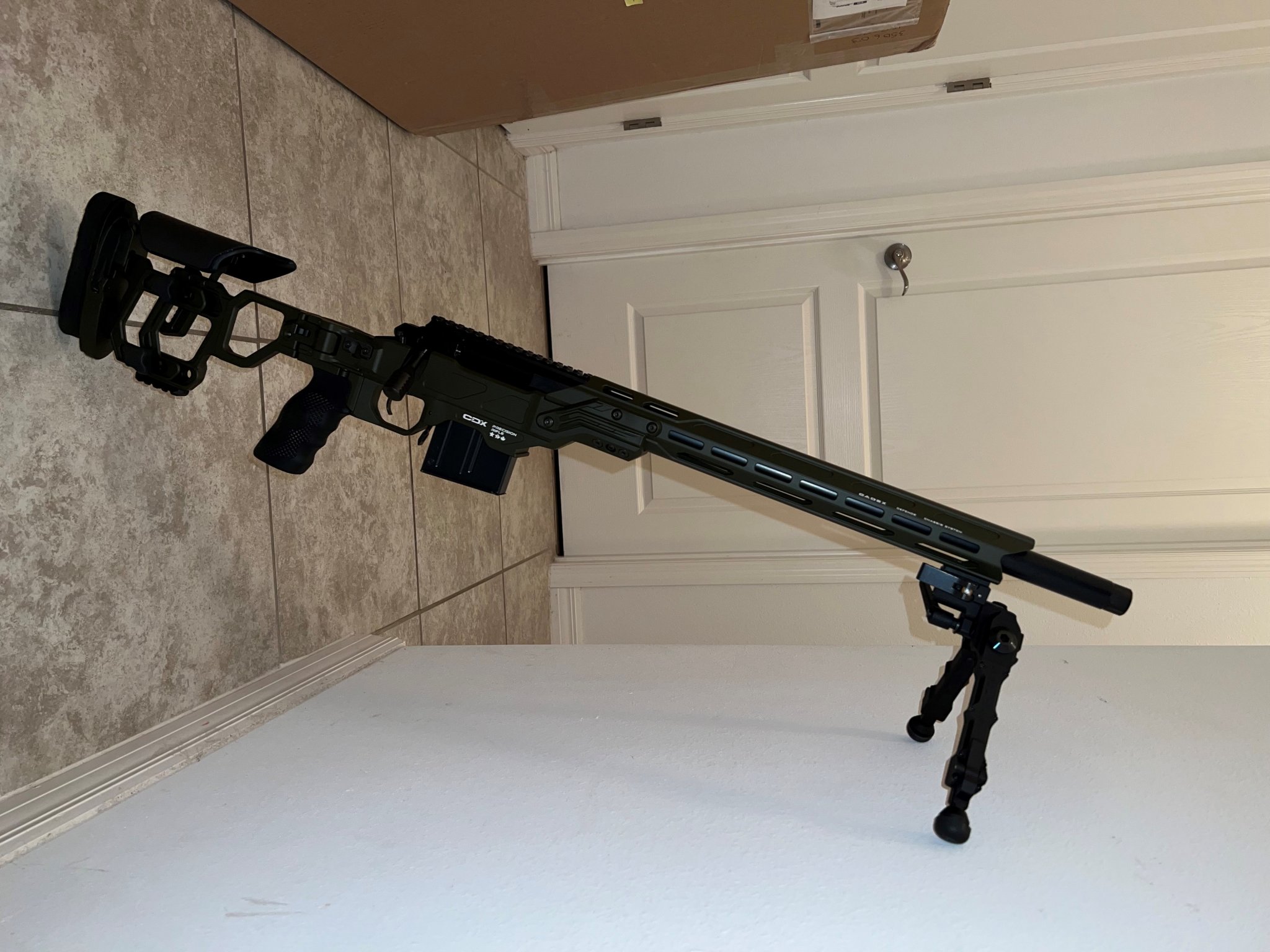

Is anyone running the Zermatt RimX action in the Cadex Lite Competition Chassis? Did you have any problems installing it?
I was told from a dealer that the Rimx won't fit the lite comp chassis and only the strike nuke and strike pro due to the Actions cantilever scope rail, but I have seen cadex post the lite competition with the RimX action on their facebook page.

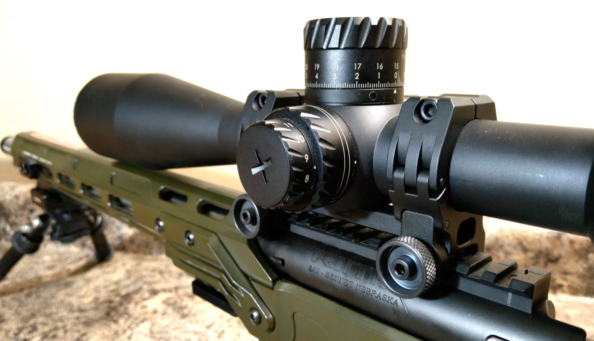

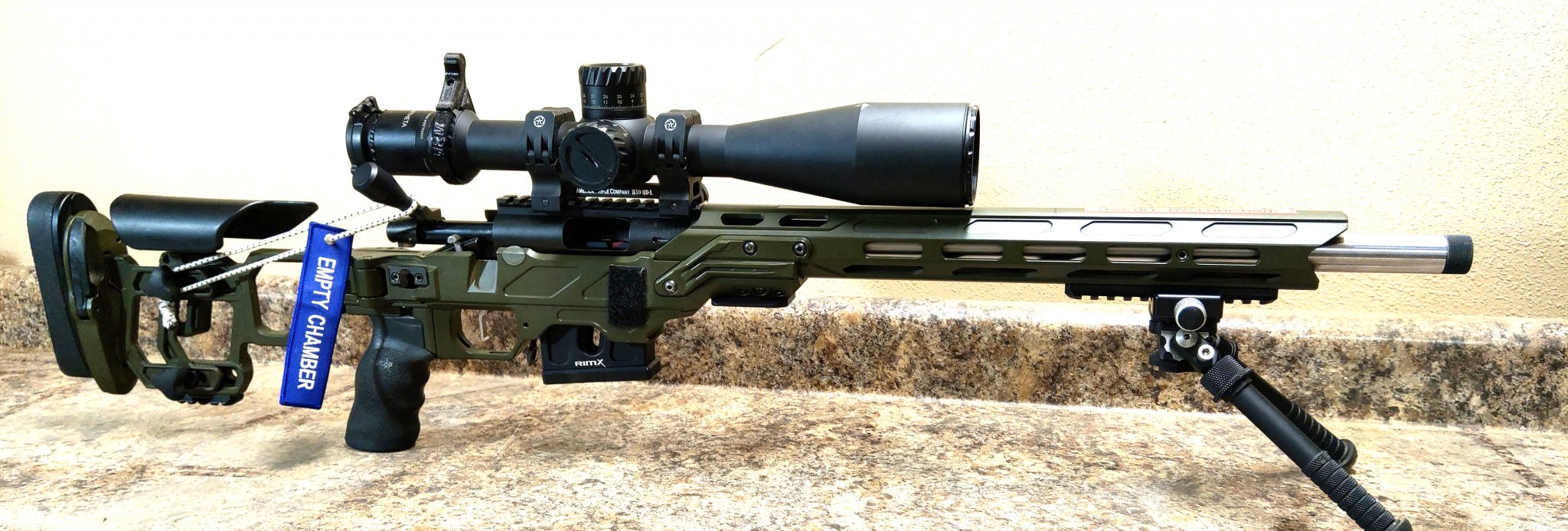

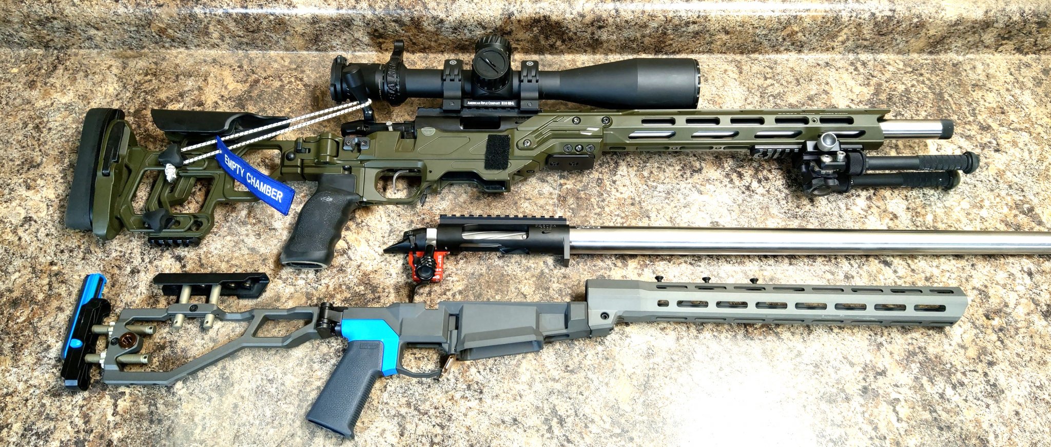

Technically your dealer is correct...but it's not hard to have a machinist nip off the 1 rail section to make it fit. You could do it with hand tools pretty easy too if you're careful.
In fact...I have one (probably 2) that I don't use anymore that I'll let you have cheap. I put a Mausingfield M7 into my cadex comp and had a custom 60moa rail made for my RimX so the two I had modified aren't being used at the moment.

I actually got it figured out, I'm actually a machinist and I milled off the end! Thanks tho
