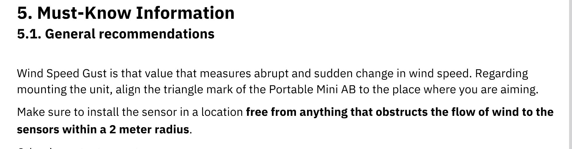

Straight from the manual -
I was able to use both my Mini AB and Sig Kilo 10k at the same time.

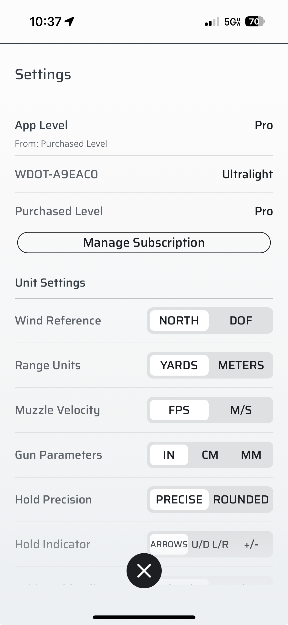

With the latest update to AB Quantum. That Depends. You can now switch between pointed North and pointed Target in the settings. This only works with the Calypso AB Mini paired to AB Quantum, Garmins, and Kestrels.
So does this functionality exist if a pair of Vectronix Vector X LRF binos are paired directly with a Calypso mini AB? Or do both devices need to be paired with AB Quantum for the pointed North/DOF option to be available?
This function only works when paired directly to AB Quantum. Only one device can be paired to AB Quantum at a time.
I’ve been playing with this thing for a long time. We have always pointed it towards the DOF. I see that yesterday I got an update on the AB app. I see this setting in the system settings. Haven’t tried it out yet but I will. Not even sure this applies to the AB mini.
