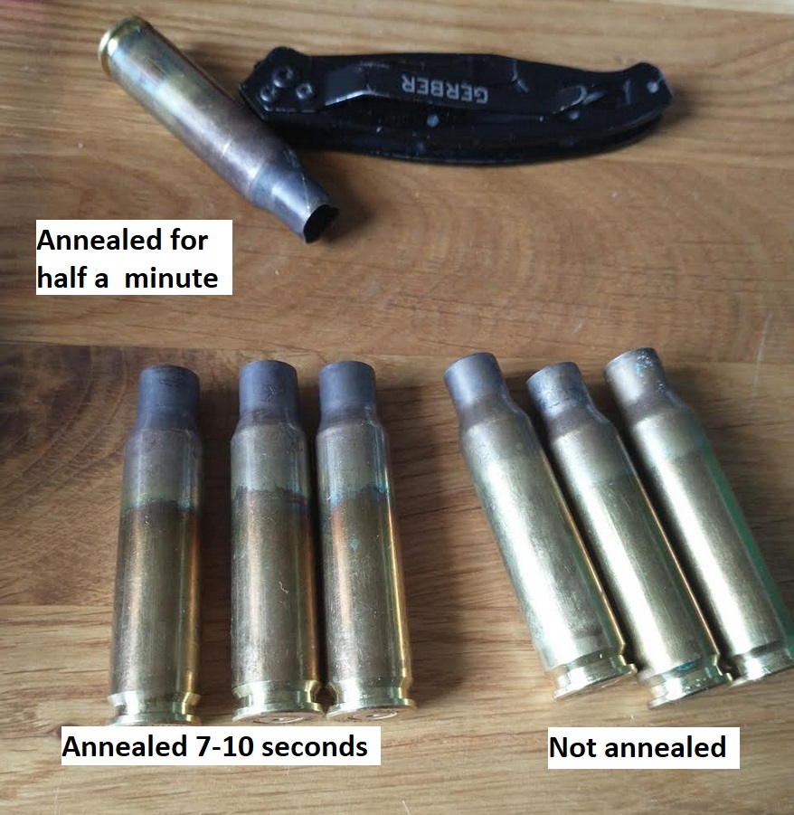

So I'm trying annealing for the first time. I'm using a European brand of brass that is rumoured to have good consistency but rather stiff necks. After about 3 times reloading these cases I put them in a hex socket mounted to a handheld drill and held the shoulder of the case in front of a butane/propane mixed gas burner. It says 1925 C on the can but that doesn't worry me too much. I kept the case spinning slowly for 7-10 seconds, dropping the case out of the socket when I saw the neck and shoulder area change colour. I've read that you're supposed to look for a blueish tint, but I got mostly silver.
The base of the case were too hot to touch when I quit heating the case up, but the discoloration from the heating is far from the base of the base.
Does it sound like these cases are safe to fire or am I going out on a thin branch?
I've read that you're supposed to be prepared to lose some brass when learning annealing. How am I supposed to know when I should discard a piece?
I also tried "annealing" a case for 20-30 seconds. It turned all kinds of colours, including silver all the way down to the base. The neck on that case can be deformed easily. It's definitely wasted.
The purpose of the annealing is to improve accuracy after having some problems that I associate to uneven neck tension, mainly that the overall length can vary significantly within a batch of reloads even though I have the same settings, lube and lever stroke on every round in the batch.
I belive you have a problem. You have two potential issues. If you have over annealed the neck when resized and a bullet is inserted, the brass is too soft and the bullet will have little or no neck tension holding it.
If you have overheated the body, it will also be soft. When this happens the body above (neck side) the head junction can be crushed easily with a pair of pliers.
I recommed you take one of your annealed cases and try crushing it with pliers. Then take an non-annealed piece and do the same. If you feel a difference then you have most probably ruined the brass and I would NOT shoot it. You have the potential for a full case head seperation.
Using a butane/propane torch in itself should not be a problem, but 7 to 10 seconds seems excessive, even for propane only. I anneal for 5 to 6 seconds with a small torch (WT2201) for 308 LC brass.

Good information already. My gut feeling is you heated too long and ruined the cases.
I use to do what you're doing but only heated them until they started to glow when viewed in a darkened room. The key there is a darken room. If the area is lighted you can't see the red glow start.
Thank you all for your input. I've actually watched that guide video and some of Cortinas videos before, but I figured I'd need some more time in the flame as I have a single torch. I was also waiting for something visual to happen with the brass, and I started to get a real colour shift at a count of 8 or so.
I now realize I did my annealing in a very well lit environment (sunny) . I'll do it again in a dark room to see at what time I get that red flame. I reckon that all setups are different.
I sized the brass side by side with unannealed cases and the annealed cases weren't at all easier to size, at least as far as I could feel it. I'll try annealing in a dark room as well as crushing a couple of cases.

So this brass is .308 Winchester brass from a 400 pack of match ammo I got a couple of years ago. I can spare 10-20 pieces for the sake of science.
I redid the annealing in a dark room. I used a smartphone timer and I found that if I remove the case after about 7-8 seconds, the neck will glow red for a moment when it's out of the flame. Usually I got more red flames shooting out from the case at 6+ seconds, but since my brass is dirty that's kind of unreliable.
So anyway, 7-8 seconds gave me glowing necks. 10 seconds gave me a glowing shoulder. If I held the case in a pincer grasp I could keep it in there for 5-6 seconds before it became uncomfortable, but I really don't like glancing over at the timer while having my fingers a couple of inches from that torch, while moving them around to get an even heat treatment on the brass... So I switched to the drill and socket method and did a bunch of cases at 5-6 seconds in the flame. Maybe saw a shimmer of glowing necks at a few of them, definitely saw some red flame. According to Primal Rights, that's bad. Eric Cortina doesn't seem to mind at all. In his video on his own proper process, he explicitly states that he wants there to be a little red in there. Don't know who's right but I think neither of them is completely wrong.
I'm going to examine them and perhaps discard a few that has less or more discolouration than the average of the bunch, but it's really deceptive to use the colouration as a measure, as the brass has a discolouration from the factory, and it's dirty, which proably has an effect on the surface as it burns. That guide video above from Primal Rights also stated that the brass changes colour in time. I suppose that makes sense, and that's even more of an argument against primarily relying on what the brass itself looks like.
So now, with my 5-6 second flamed brass cases, do you think I'm at a higher than normal risk of injury if I load it up and shoot it? I'll wear eye protection and keep my first aid kit close....
I'm a little concerned that the ones that went at 5.0 seconds might be less ideally annealed than those that went at 5.9 seconds, but I'll live with that for now.
Based on my nominal knowledge of annealing you should be fine. That said let's see what the more experienced annealers have to say.
It's just my opinion here but people worry a lot about the body of the case getting hot, which is ok but some people worry about it too much because of stuff floating around the internet. All I know is when the brass comes out of my gun it's really hot too. Hotter to the touch at least than what I got annealing. That said I've seen some people throw away brass because it basically 'got warm'...not hot...just warm when annealing. I think where people get in trouble is when they let their cases marinate in heat for a long time. By "a long time" I mean 8-10+ seconds or longer. Less than that I would think isn't an issue from a safety perspective.
4 seconds vs 6 seconds or something like that when it comes to effectiveness in regards to accuracy or whatever is supposed to make a difference, but most likely nothing to do with safety.

I can't answer your question in regards to 110% annealing. All I know is that the issue occurred after introducing a single variable, and went away after that variable was removed from my process. I have no interest in changing my process in hopes of making an incorrect AMP pilot work, especially now that I have the correct pilot. I believe that a repeatable reloading process is key to reloading success, and since I have that already going for me, I have no plans on changing that.
AMP says this on their website, I'm assuming this had something to do with my issues. I haven't further explored the issue beyond what I outlined above, so I will take their word for it:
Depth of insertion into the air gap is critical. A variation of only a few millimeters can make a difference of 20 HV (Hardness Vickers) or more in the result. Therefore we supply depth specific pilot which do not need adjustment. Just thread them all the way in and they are ready to go. There is still some commonality. For example, the family .243 W, 7-08 R and 308 W all share the same pilot #11.
