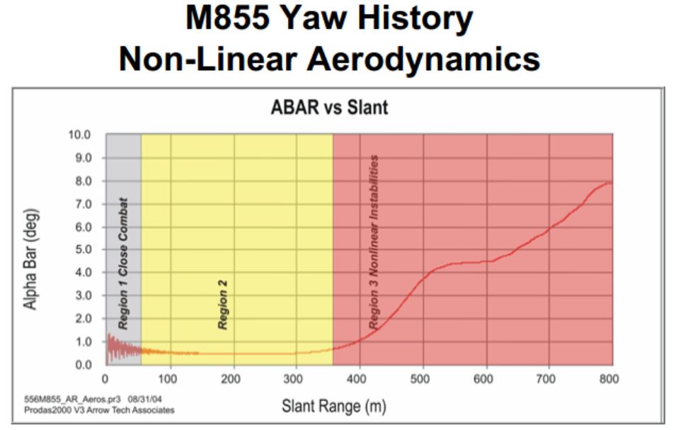

A "stability" problem that shows up at 1500 yards is a dynamic stability problem.
Gyroscopic stability problems will show up inside of 50 yards. If the bullet does not outright tumble, then it will demonstrate increased drag and large shot to shot variations in drag if there is a gyroscopic stability problem.
When one calls a paper on gyroscopic stability into question based on observations from long range shots, they are confounding the issues.
You said your observations did not track with our paper on gyroscopic stability of OTM bullets.
I asked for hard data regarding gyroscopic stability and you referred to observations at 1500 yards.
Here's a link with brief descriptions:
Bullet Stability
The attached graph from ARL helps illuminate the difference. The flight characteristics and damping of pitch and yaw in the first 100 yards indicate good gyroscopic stability. The behavior in region 3 shows a dynamic stability problem that will impact the bullet flight at long range.
