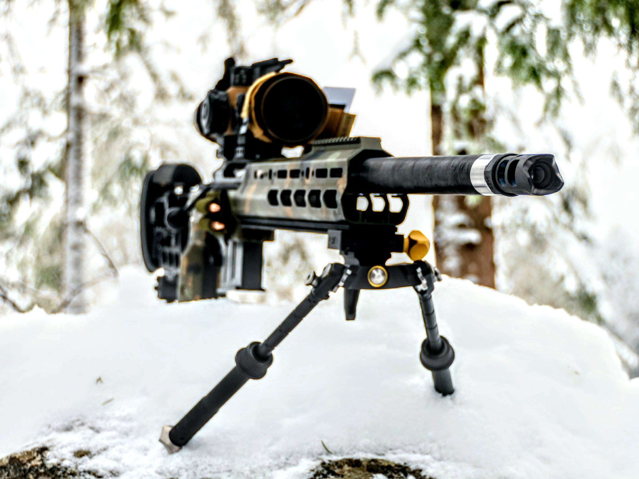

123gr Scenar N160, that fifth got away, 4 shot´s is 0.2 MOA.
Firts shot´s with this barrel today, shot total 35 rounds, not seen POI changes when it did get hot.
I shot with 2 different suppressor and muzzle brake.
So far so good :)
