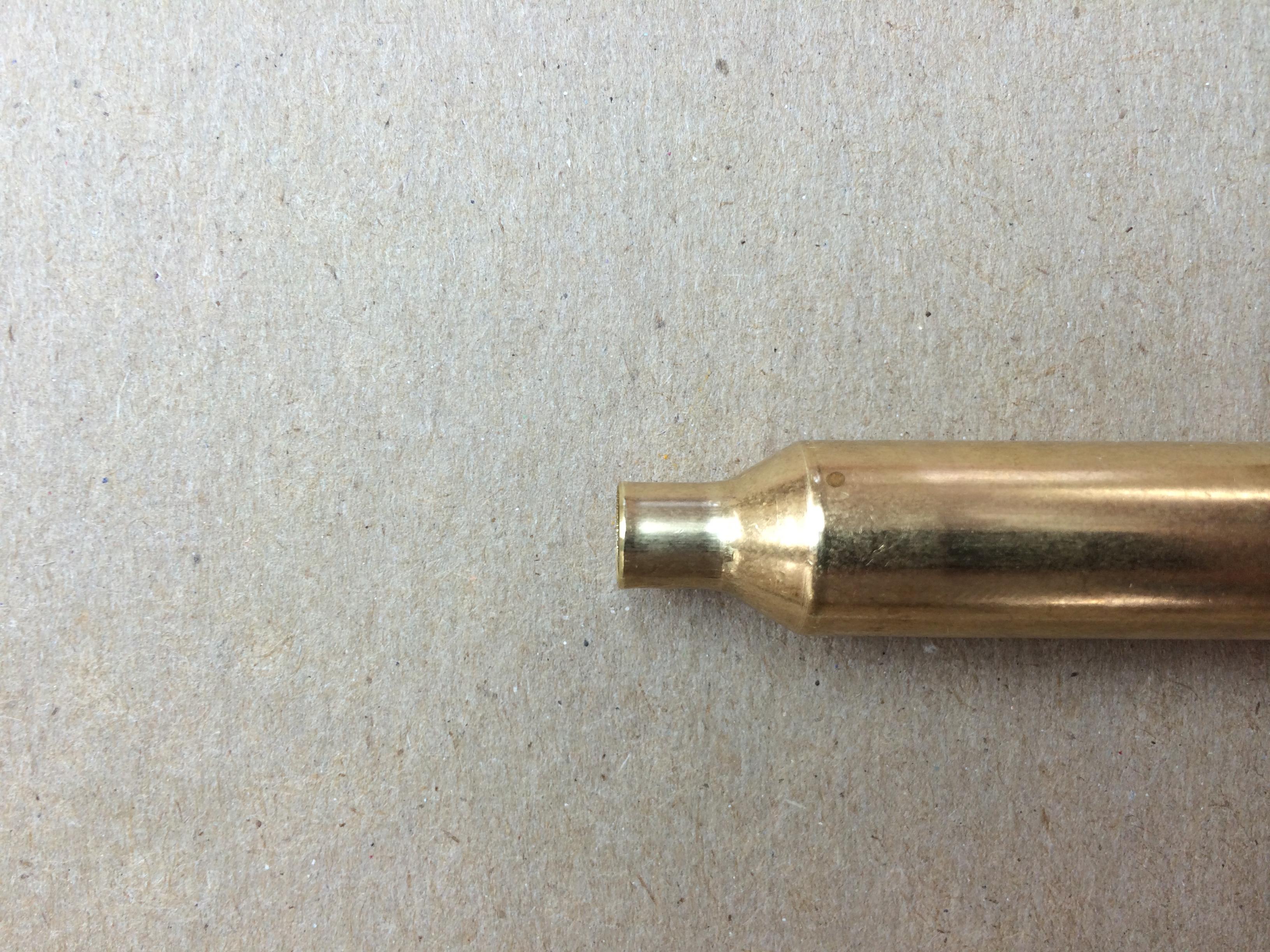

Just started necking down my 7mm SAUM brass with a .295 bushing and the mouth of neck is flared (see photo).
Flared end of neck has an OD of .294"
Rest of neck has an OD of .289"
Also, the reduced part stops short of the neck-shoulder junction. I'm using a Co-Ax press, the die is set with a slight cam-over and the bushing is screwed down tight.
What am I doing wrong?

You need to start with larger bushings and gradually work down. I had the same thing with the 300 SAUM. I use .320 or so, .315,.310,.305,.298 then .295.
I had wondered about that, always reading that resizing by more than .005" should be done in more than 1 step.
See my post above, also had the same thing going on with my 7mm brass.
The flaring at the top of the neck can happen when the neck tops out in the die, and the top of the neck is then pushed out into the bevel of the bushing. Check your COAL before you size, in my situation I am trimming them before sizing to prevent this. Check the length of your bushing and the length of your case neck, and make sure that your neck is not significantly longer, this can help with both issues.
The lack of sizing at the bottom of the neck will depend on your setup, with mine I had the same problem and had to shave about .030 off of the shell holder to get it to size the neck all of the way down.
Thanks for the reply. Pat suggested that maybe my bushing was undersized. I measured it and it was .0015" small. That may be the cause of the flared mouth. It may also be that I need to neck down in steps. I have bushings on order to experiment with both scenarios and I'll post my results.
As for the neck not getting sized completely down to the shoulder, the neck down part on my shoulders stops about .03" before the shoulder (although it's nowhere near as dramatic as in your photos). Part of the problem is that Redding bushings have a chamfer at their mouths. I measured it at about .025" long so you are never going to get the neck sized all the way to the shoulder unless you remove the chamfer on the bushing. I believe that only LE Wilson bushings come w/o the chamfer (on one end only). I'm just going to keep an eye on the brass as I fire it and see what happens.
I just called Redding to get some more information about the 2 problems. Their answer runs contrary to the information that has been posted here. I'm not trying to stir up a hornets nest and I realize that there is more than one way of doing things. I just want to pass on what they suggest. They told me that in order to fully reduce a neck, you should use a FL sizing die. This avoids the unaltered .03" or so that we have been getting and eliminates the risk of thinning down the neck/shoulder area when turning. They also say that using this die will likely not give you the flared mouth that I have been getting on the case necks. If anyone is interested, the die that they sell is #91758. Its called something like 6.5/300 SAUM. Clearly many thousands of rounds have been successfully formed w/ the bushing die so take this advice with a grain of salt.
The standard full length die will still cause a flaring at the case mouth. During the neck down process.
The full length die was made to spec for the .298" neck so it can't be used with the new reamer for adequate sizing.
When necking down using bushing dies there is always a portion of the neck that is not sized at the neck shoulder junction.
Necking down using a .295" bushing, turning to .014" neck thickness down .050-.075" onto the shoulder I have not had any neck seperations with now 6 firings on Norma brass.
