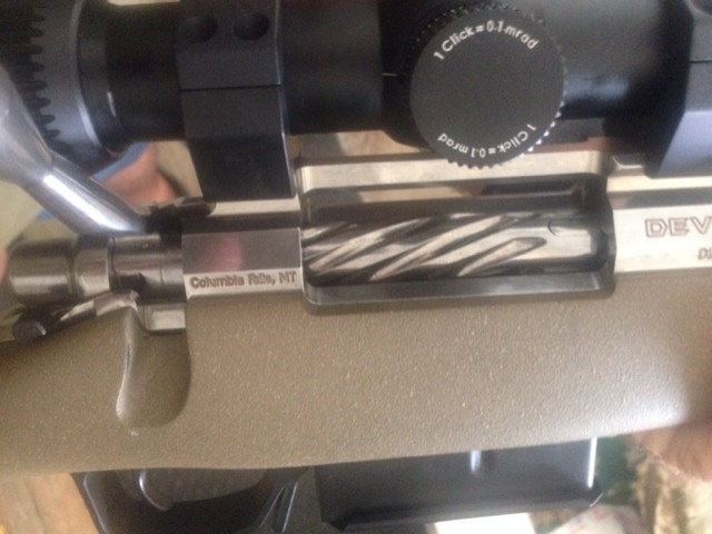

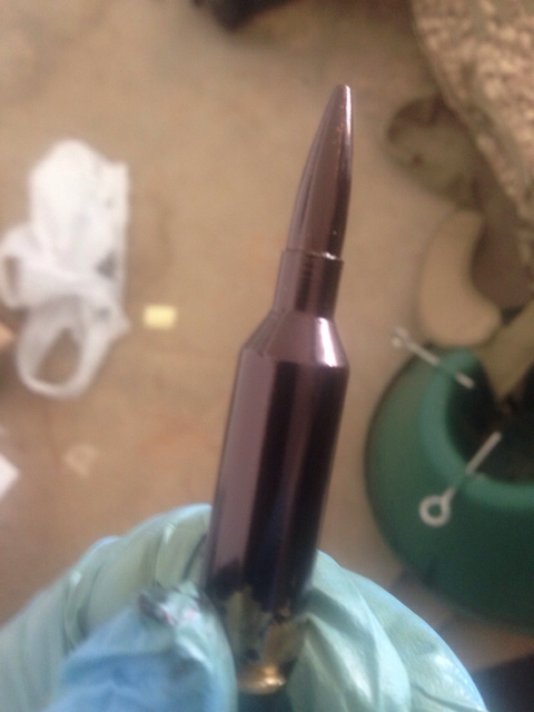

Guys I need some help. I have a 6.5 saum from SAC. I have the redding die set from copper creek as well as 50 pieces of brass processed from them as well. I loaded the initial 50 and was able to chamber them ok with the occasional one having a little resistance closing the bolt. I cleaned and sized them with .291 bushing. They all chamber ok with empty cases. When I load a bullet the goes about 1/4-1/2" from closing and stops. I resized brass again and still same issues. Any ideas on something to check?? Brass is. 2.015 and empty neck is .290-.293. Loaded necks are .294-.295. Loaded initial rounds 2.820" with 139 scenar . Tried the same and down to 2.78 so it not a coal issue.
ImageUploadedByTapatalk1409363348.833570.jpgImageUploadedByTapatalk1409363370.066953.jpg
I marked a cases and don't see any areas up front with obvious signs of rub/hitting
