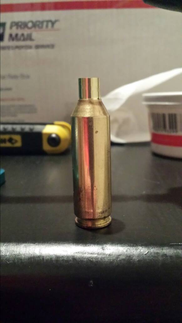

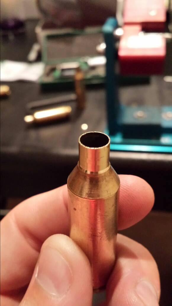

Got mine out for the first time today. Just getting on paper and breaking in the barrel/fireforming brass. I threw 61 grains of H1000 under Berger 140 Hybrids into the lands, Fed 215M primers, Norma 7mm SAUM brass. No load development yet but this is what I got. First 3 were in .141" and the last two spoiled it, could have been me. What kind of jump do the Hybrids like?
Do I need to turn the shoulder back more on these rounds? uploadfromtaptalk1403846559233.jpguploadfromtaptalk1403846567734.jpg
Also, I am having a hell of a time getting the brass over the turning mandrel. It's once fired 300 RSAUM brass. I am using the .330, to .315, to .305, to .295 bushings the turning then I will use the .291 bushing. What am I doing wrong? Should I get a .297 bushing to turn the necks because it's so hard to get the brass over the neck turning mandrel. I'm using the 6.5 mm mandrels
Do I need to turn the shoulder back more on these rounds? View attachment 41548View attachment 41549
Are you using the .264 expander mandrel before you neck turn?
Better use some imperial die wax and turn real slow to avoid heat build up.
Mine were a little looser over the mandrel after being expanded than I would have preferred.
I am using a good amount of wax hoping it would help. Nope. I'm man handling the brass to fit. Maybe I should use a larger bushing, say .298 and neck turn then use the .295 and .291?... not sure
Thanks . Even when I use the .264 expander mandrel it's tough as nails getting it to fit on the .264 turning mandrel
Yes I am just using the expander and turning mandrel grin 21st Century shooting.
Yep, sorry hadn't read your posts before responding!
Only thing that comes to mind is that you could somehow have an undersized mandrel on the expander?
Or, the mandrel isn't set deep enough to fully expand the length of the neck to consistent .264" ID?
And/or there's a 'donut' inside the case @ neck/shoulder junction that the expander mandrel never hit ?
If that is the case, K&M sells a carbide cutter pilot for their neck turner.
Considering your dilemma, you might consider investing in one to clean up the ID on your necks...
