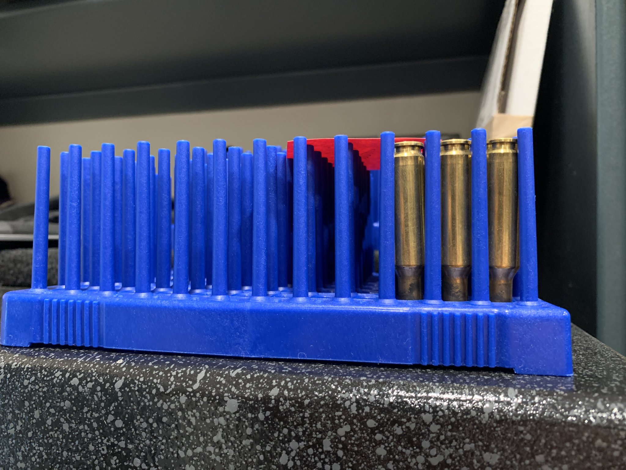

Test tube drying rack...
that’s 6.5 creed
