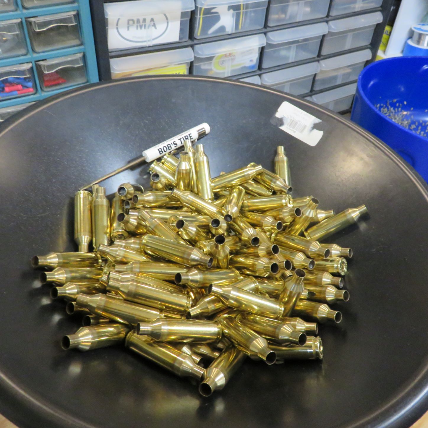

Note. . . these fired brass are annealed then necks cleaned with steel wool and then sized before putting them in the this tumbler to take off the lube.

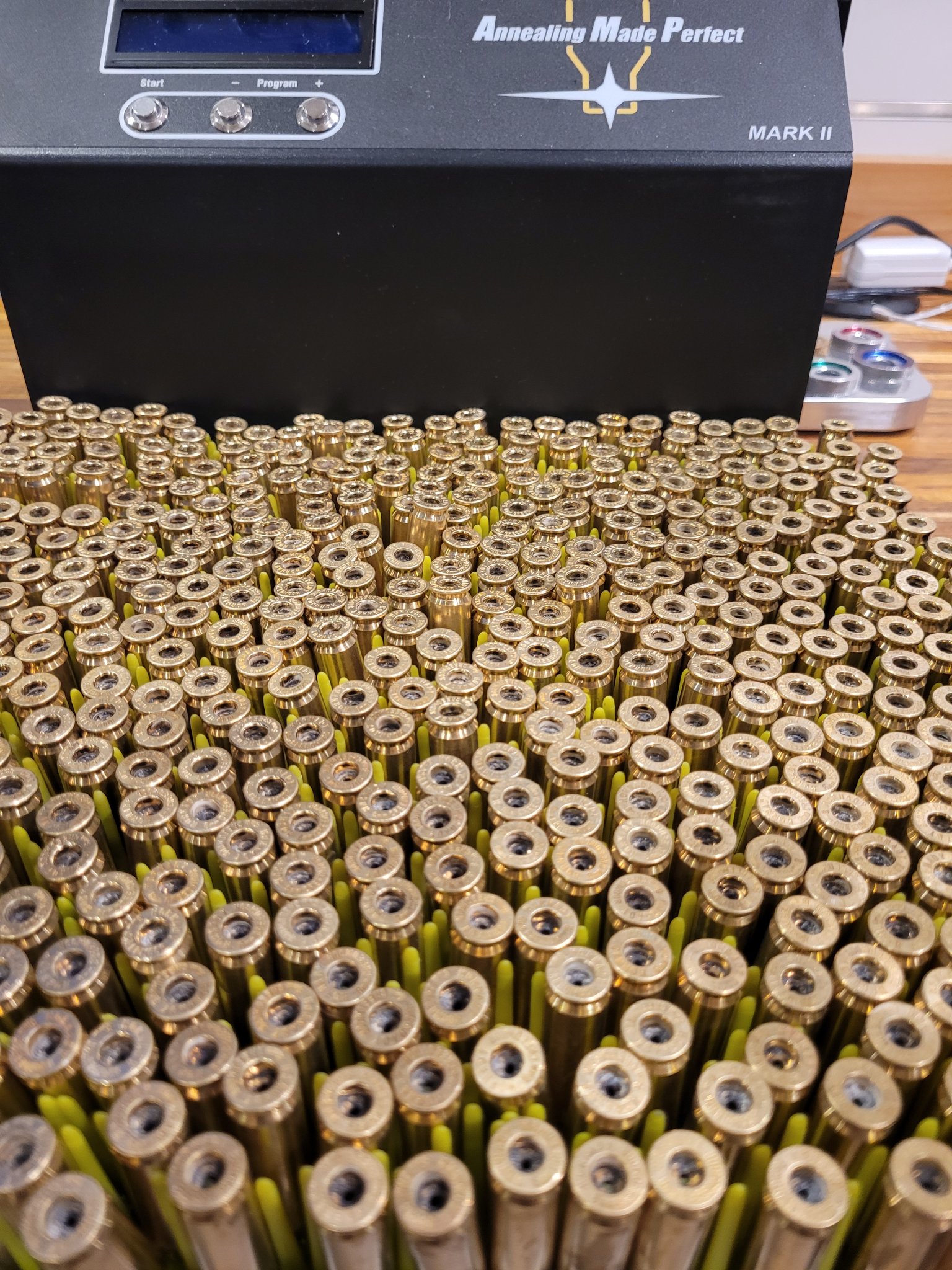

I do, just to get the soot off the necks before annealing. Then I tumble after anneal to get that anneal residue off before loading. That anneal residue can get grippy and play hell with seating depths.

However, if you anneal your brass, the annealing process does leave an abrasive oxidation film on the surface and I don't like what that abrasiveness can do to my sizing dies or how it effect seating consistency. Therefore, I'll use steel wool to clean up the necks (and that tends to do the shoulder as well) and it really doesn't take much effort or time. Then I'll clean with vibrater tumbler after using sizing to remove the lube. If I don't use lube, like when neck sizing with a Lee collet die, I only run a brush through the neck after the steel wool cleaning.
For sure, the brass does not need to look squeaky clean and will perform just fine without cleaning. Some of this really depends on the level of shooting one does. If you're a competing bench rest shooter, then . . .???

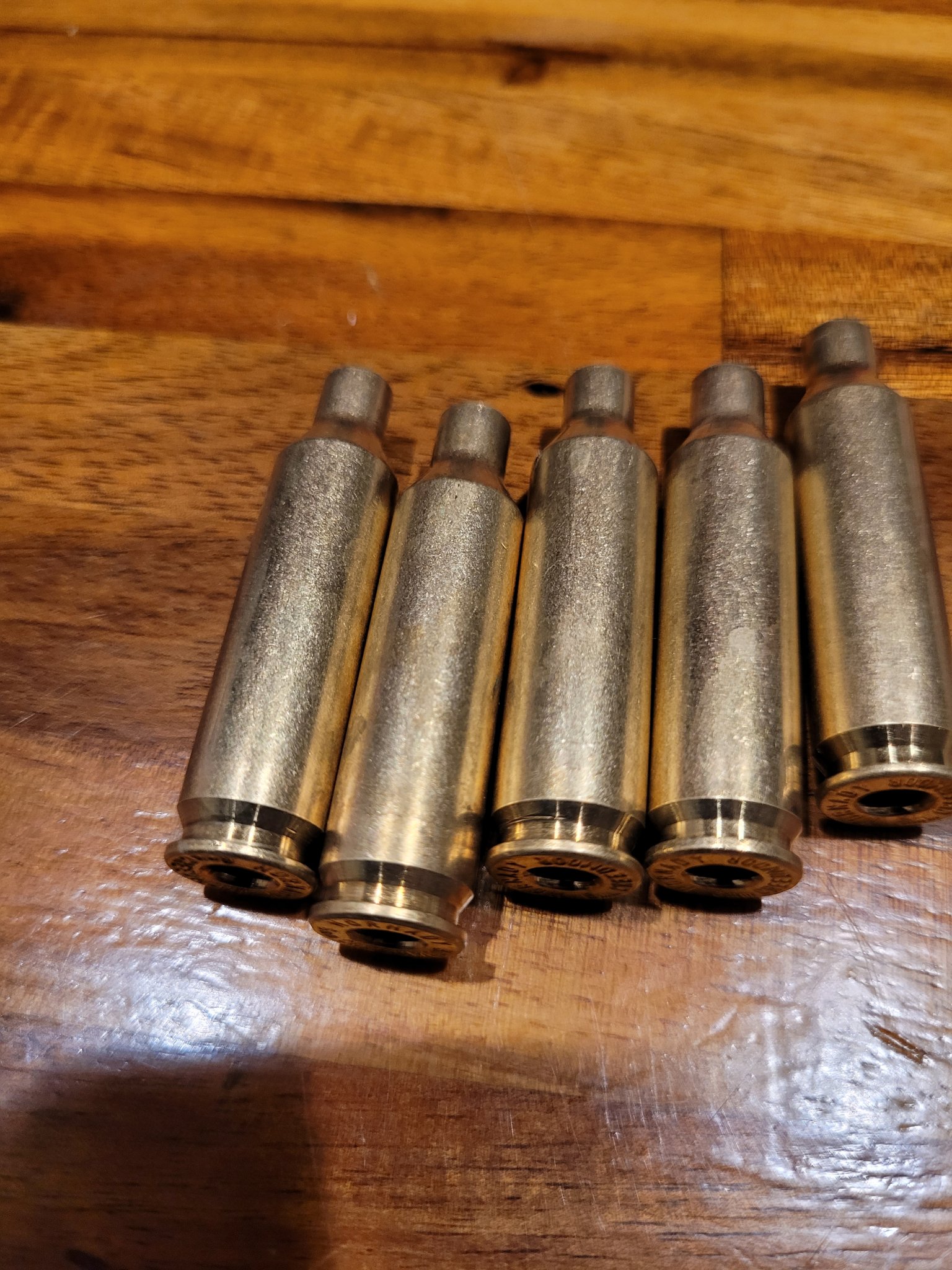

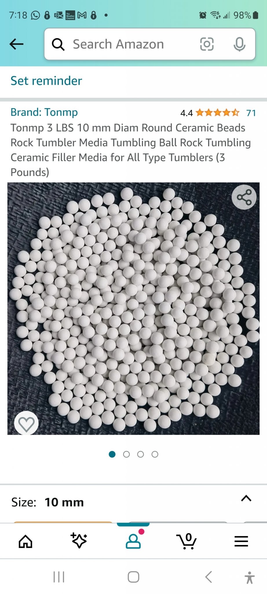

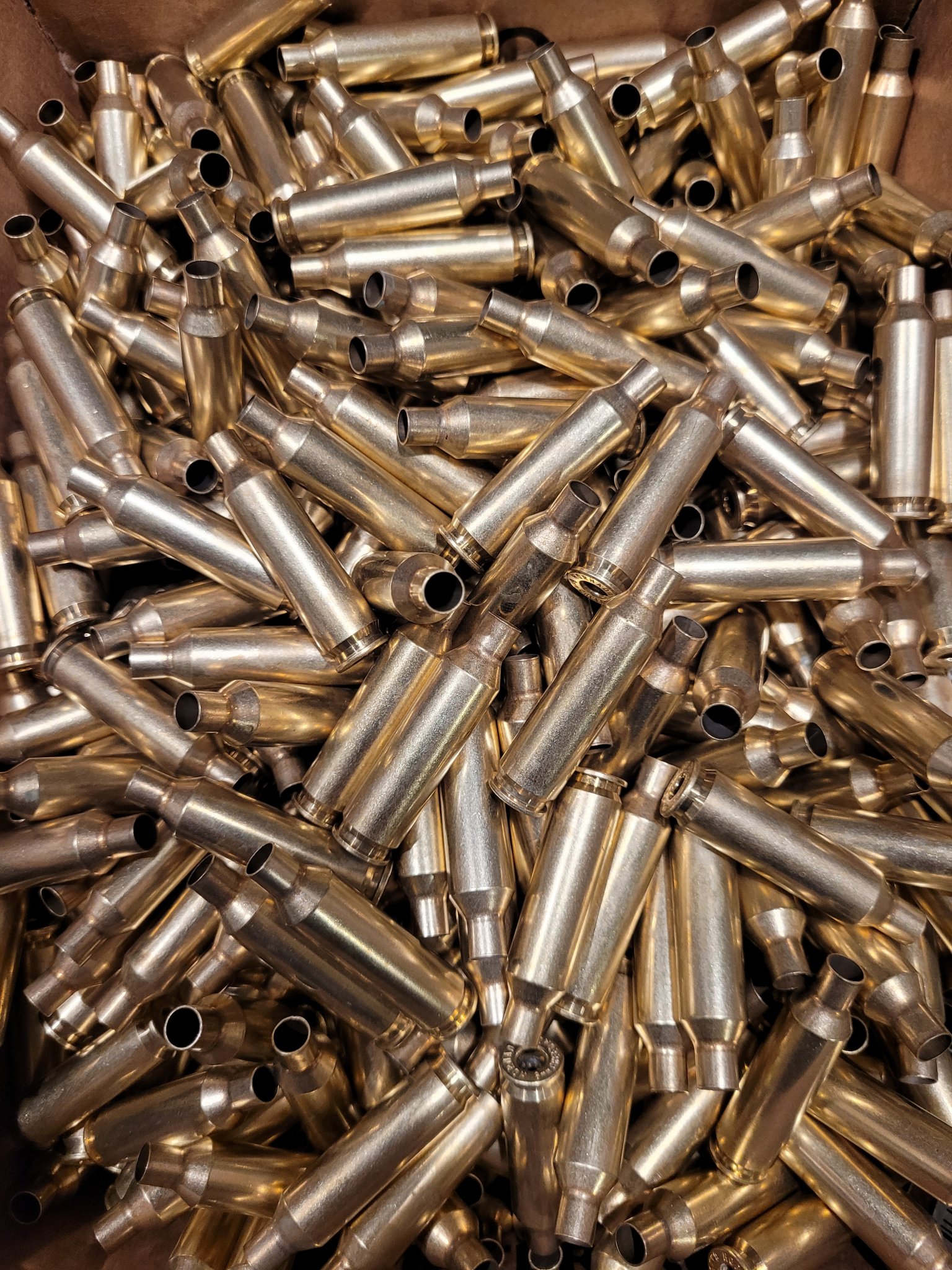

Thought I'd bring this one back to life and show you guys something I tried and see what yall had to say about it. I got some of these to wet tumble in. I was looking for something that would be easier and not fit into case mouths and found these. They definitely worked well but they leave a more Matt finish vs shiny. I tried a few different batches od Hornady brass vs trying my good brass.
I actually forgot about the first batch and let me go way longer than I'd ever planned to, which was about 1.5hrs. So obviously they got clean and all.
The next batch I ran for 15 min and they got clean as well. Actually look the same.
Any thoughts on this potentially damaging my brass or thinning it too much over time? I don't know that I could measure any difference without it being over many many cleanings. Here's what they look like

SWAG here, but I think primer pockets would fail before an appreciable amount of thinning could be made to render the brass unserviceable.
Wonder how those balls would work in a vibratory tumbler? To hell with the walnut media dust.
Daggum homie! 15 min tumble and done?! Sign me up!
That's why I was looking. I don't mind wet tumbling that much and if I can do it that fast even less so. These things are pretty smooth but without the water it might be a little too much banging around and have the same issues as steel pins. I am not a fan of the dust that vibratory gives off and I'd rather dump out water than mess with the tiny media so....
They are ceramic beads and I doubt they'd ever really wear but wasn't sure about them possibly taking too much brass off over 10+ cleanings. They don't seem to have done any kind of damage at all. They don't clean the primer pockets of course due to their size but I don't care about that. So far so good with them and they are super fast. I feel sure they'd work in a vibratory, just don't know if that would increase wear an appreciable amount.
How do the primer pockets look? Thats why I love the chips, they clean those pockets in no time vs the pins... Cant see how the round balls would clean the pockets at the 90...
They don't really get clean. I put a little but of dawn, lemishine, and simple green, but very little of any, probably with more cleaner it would do a little bit more but the balls not being able to get into the case means they can't get in a primer pocket either. Not an issue for me. There's no real difference in the pockets on the ones that went for a long time vs those that went 15 min.

I don't wet tumble often but when I do, these chips are amazing. Super fast and clean the pockets like new..
I got some new media to test in my dry tumbler....I'm over the Walnut dust. Sheesh
Which chips do you use? Got some info on em? I could add that to mine and be good to go and super fast
The ones I started this thread about. Check out post #1 I posted photos and results. Tumbling time was so much shorter and stupid clean
Oh ok. I thought there was some other ceramic chip thing. You are talking about the stainless ones. Ok Roger that. Sorry I'm slow

Yeah I know the ceramic will abrade some but I figure the balls in water won't be an issue in terms of actually removing too much metal as to effect it. Do you think it will cause me problems after 10+ times?

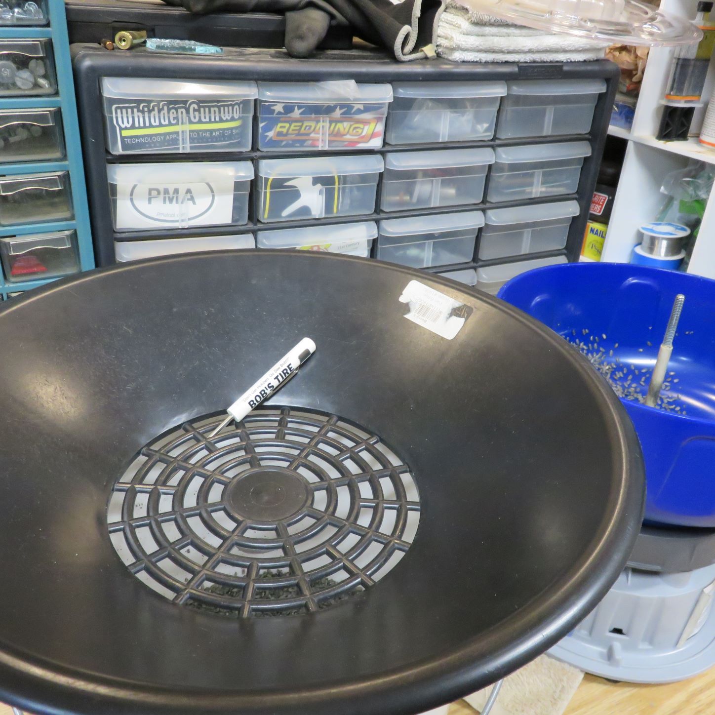

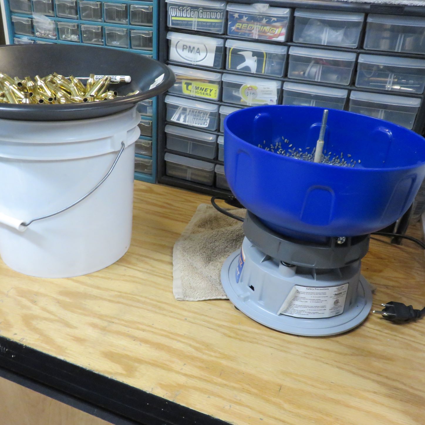

I probably missed it somewhere in the thread, but what’s your process for removing chips prior to drying brass? And how often (if ever) do you have chips left inside brass?
I have a bucket with a strainer that fits in top. I dump the entire Tumbler into the strainer that catches all the brass and 95% of the chips drop through strainer into bottom of bucket.
I have another bucket with a spinning media separator filled with clean water. Dump brass into that and close.. turn the separator handle 20 or so times in the clean water then dump brass into a towel. (This is the key step to get the chips out of the brass.. I have none left in my brass doing this)
For drying, in the summertime I just lay the towel outside in the sun for an hour or so and they are dry as a bone.
In the winter they go on an old cookie sheet and in the oven in lowest temp for 20min or so.
