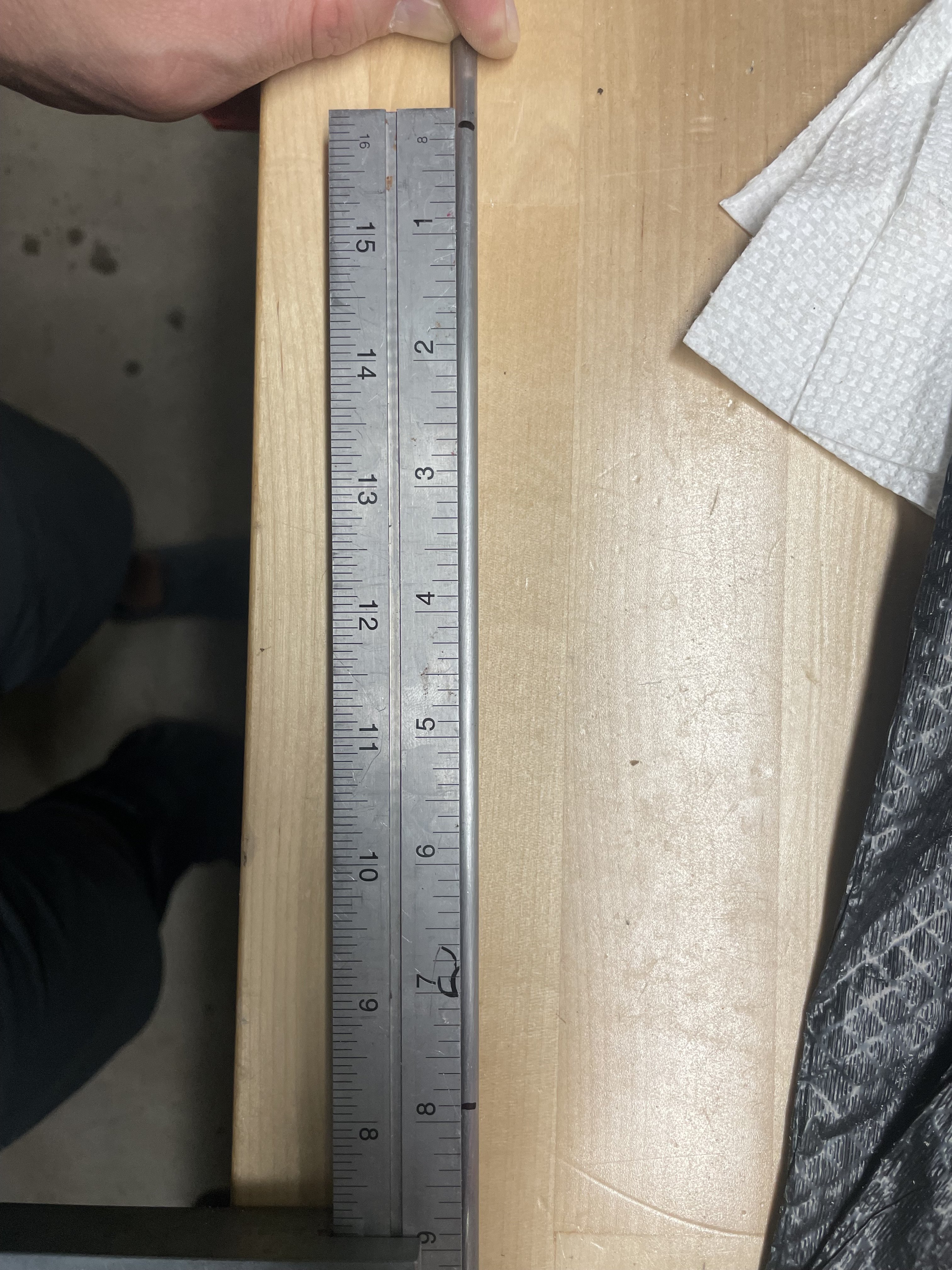

Took a couple measurements to make sure my process was good. Rifling engaged, rod spinning as soon as I started to push, lubed bearings etc.
Looks to be right at 8. Most of my measurements were 8 or barely under. Had one at 8-1/16 but that was before I lubed bearings as this rod sat in the garage a bit.
Camera is centered so it makes it look like lines are inside of 8 on either end but it’s actually pretty dead on to just a hair under 8.
The DA when I was shooting was close to zero. 12.2C @29.92Hg @156 MSL. My Proof barrel is a true 1:8, as I measured and confirmed it as soon as I got it.

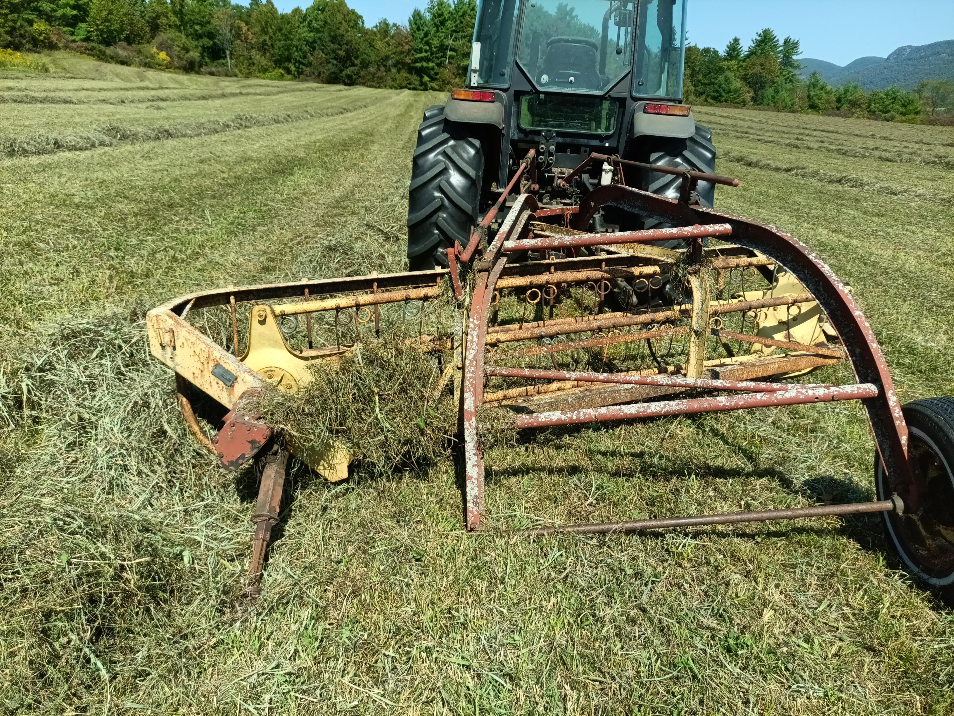

Now it's off to weld the axle on my hay rake! Doh!
D'oh! It's always something with machinery isn't it? Good luck, I hope it's just the axle.

Farmin' with junk! Yeah, it's just the axle.....for the third time. This time it broke all jagged right in the keyway. I have to normalize the axle section, then weld it, then case harden it. Just like a Japanese sword - only very dull, lol. A knotter frame on the old Super hayliner 68 baler broke later that day too. Cast iron, and almost unobtanium. I had to call in the neighbors to finish up.
