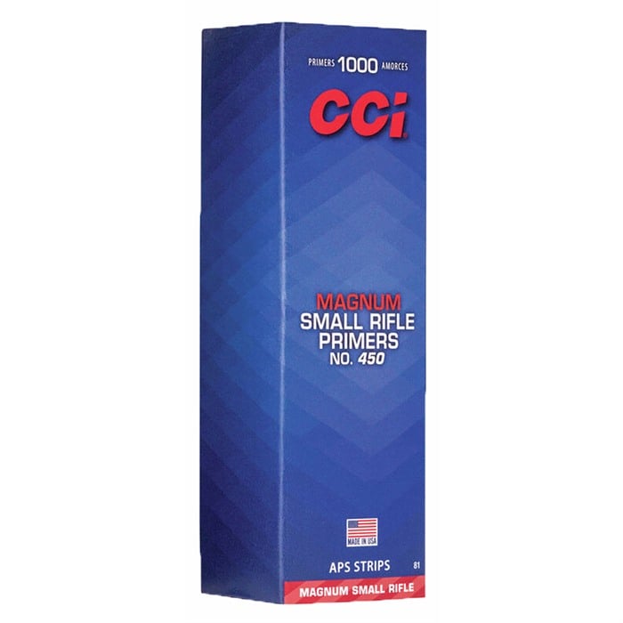

My supply of -450s is depleting much faster than -400s. Does anyone have good data on 400s in 6BR (or similar) using stick powders in warm weather?
I'm gonna give it a try and see what happens, but would welcome input from the community.

I wouldn’t shoot a 400 in a .478 bolt face anything myself.

Because the are thin cupped and not intended for as high of pressures. The br4 has the thicker cup material so it should be suitable.
It’s not the brisance, it’s the ability to hold up to pressure after ignition I’m concerned with.

Make sure you have a smaller .062 firing pin vs a larger .080, or at least a tight fitting pin the hole fitment. Helps the thinner small rifle primer material resist cratering and ultimately punctures.

The cdg will be just fine, it’s set up for high pressure already. All the arc actions are. Most customs. It’s mainly factory that is a concern.

Thanks for the replies, guys. I'll keep the -400s for .223. Trying them in 6BR seemed like a "thing to try" last night; glad I checked in here first.
I've got enough -450s for a couple of years. I've just got even more -400s....
