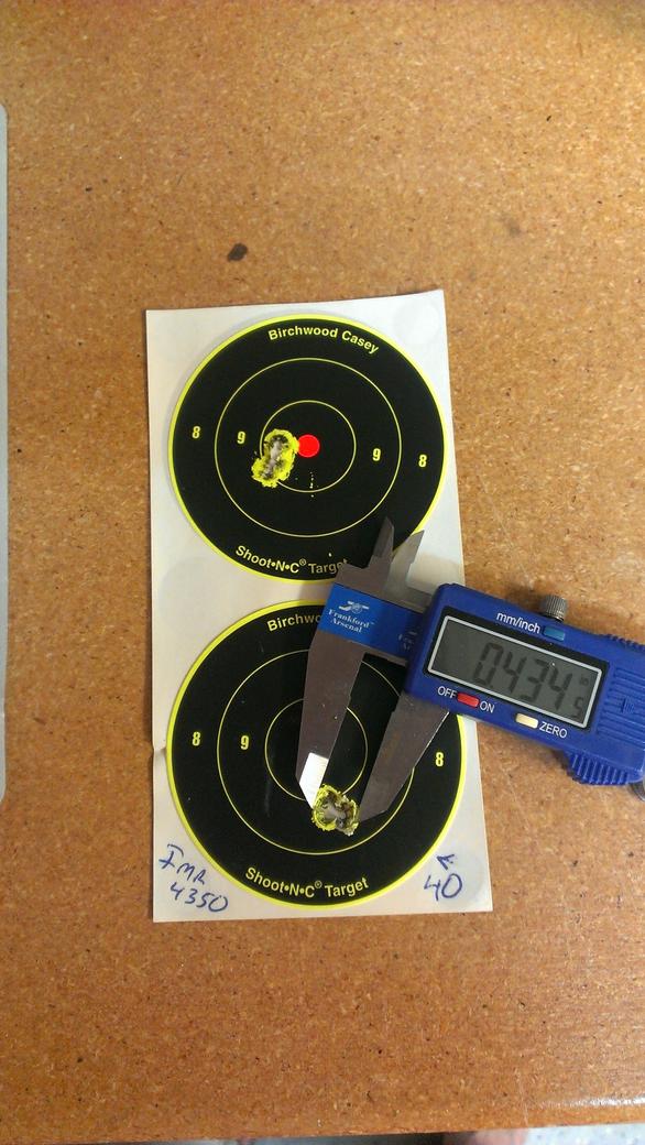

    My last trip out to the range I got these numbers.
    My Load is 41.9g of IMR 4350, Lapua brass, 139 scenar seated .010 off the lands with WLR primer.
    84 degrees out no wind and 75% humidity
    2718
    2716 ES 11
    2707 SD 6
    2711
    2714
