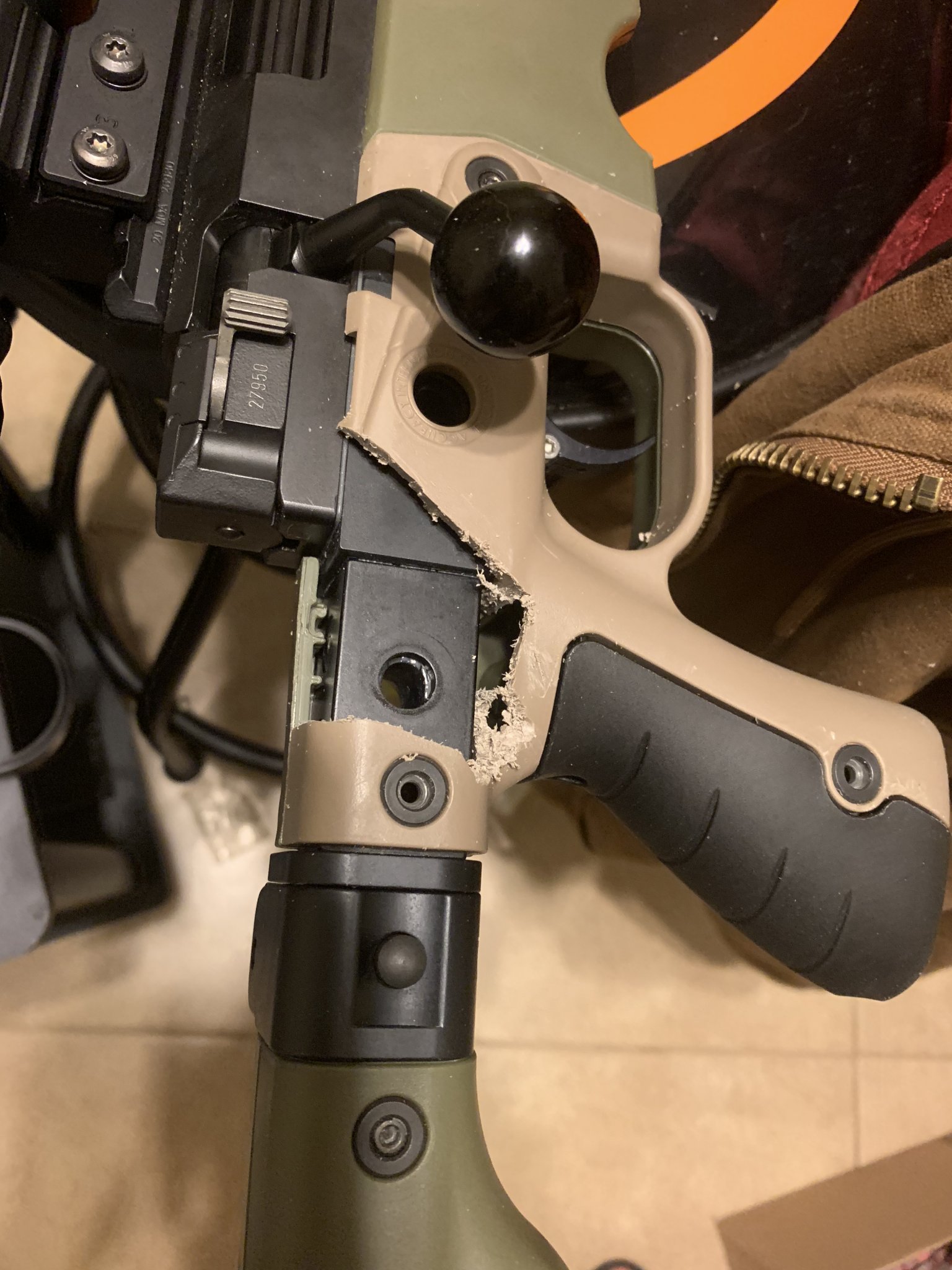

Got the AX chassis yesterday ... piecing it together ...
Current issue is bolt does not close all the way. I can fully cycle dummy rounds thru the gun, the firing pin cocks, but the bolt does not close all the way.
Loosening the front action screw a quarter turn and the bolt closes all the way. So, the front action screw is too long. I need to shorten it !!
But not too much :D

Ok well after six 10 min sessions of grinding on it with a little stone wheel attached to my dremel tool and finally the bolt moves smoothly. ?
I wonder if AI makes them too long on purpose? With the idea better too long than too short ??
All the other chassis' I've had, McReex2 and KRGx1, the action screws just fit. So not sure.
But AFAIK now, the gun is ready to shoot.

Some chassis have washers to use on action screws for certain actions. Not sure if the AI has them.

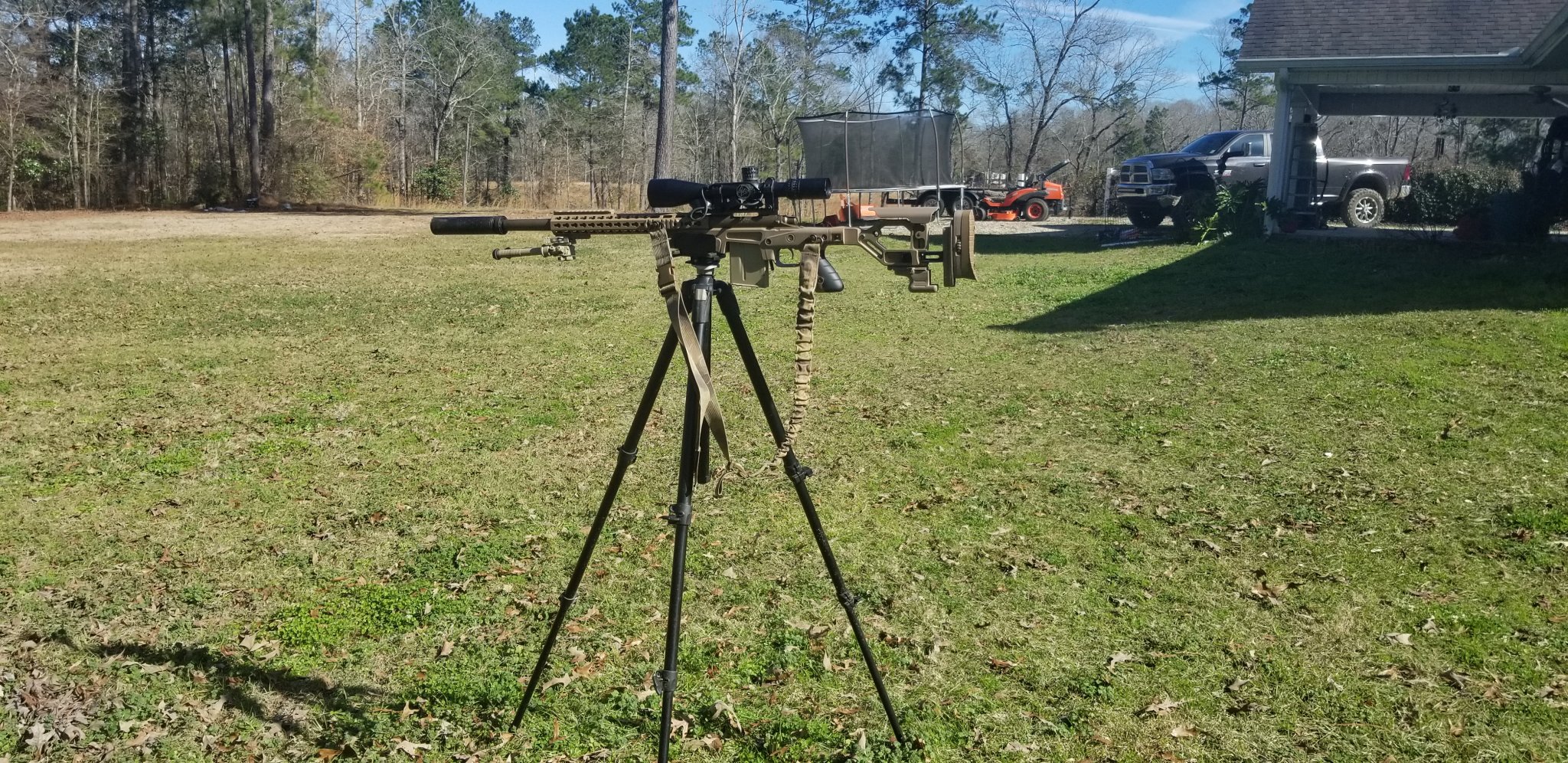

Shot the AX chassis again this weekend. Average group size was 0.83 ... on six groups. One group was 22/16ths ... without that one we were avg exactly 0.75 inches. This is off the RRS tripod. The official goal is under 1 MOA off the tripod for this year, but the stretch goal is uder 0.75 inches.
I think the cheek pad is too high ... I could detect some straining. And for me straining = missing.
Also the forearm came loose, so need to tighten that down further. I don't think it affected the group size, it wasn't rattling around enough to touch the barrel.
