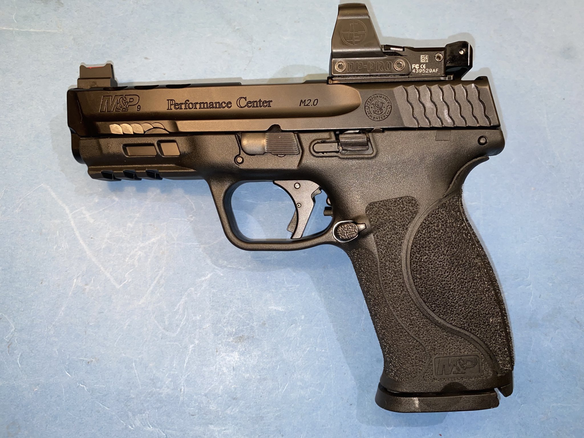

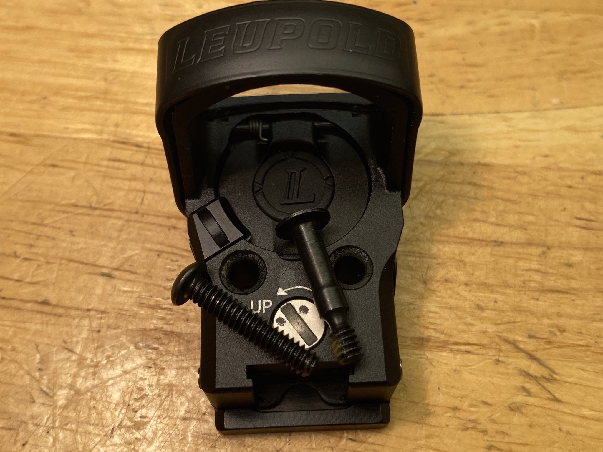

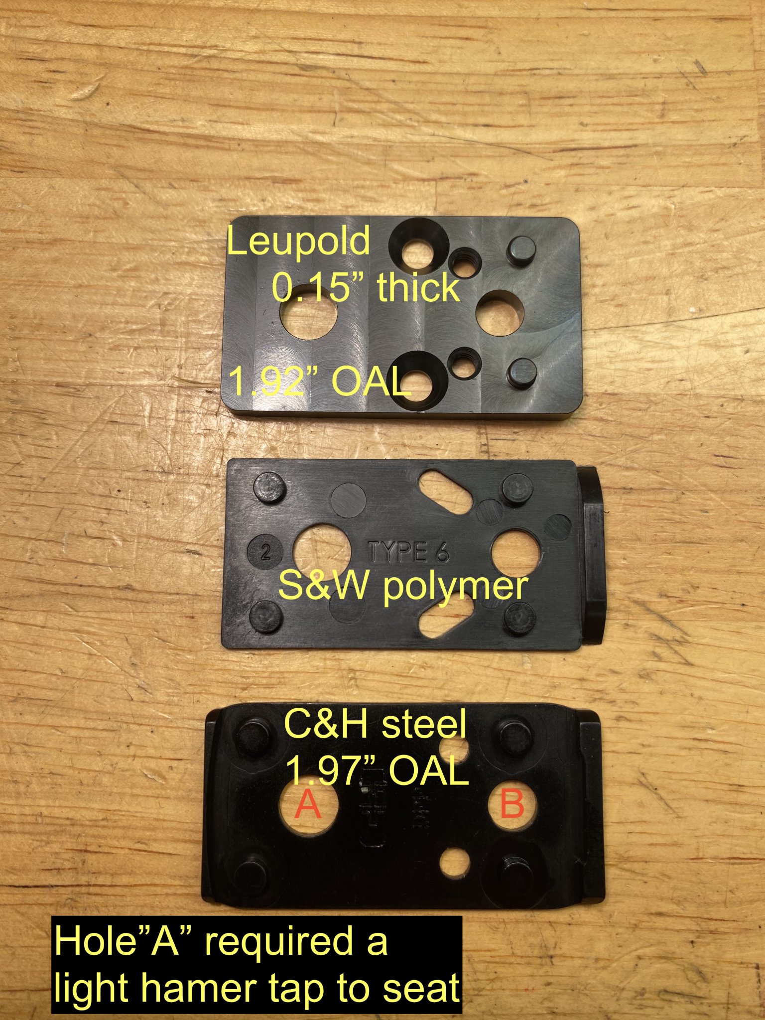

    My experience witha C&H plate could not have been more different.
    Just this week I received a C&H Leupold Delta Point Pro adapter plate for this S&W Performance Center M2.0 C.O.R.E. model. S&W has 7 polymer adapter plates to fit a matrix of red dot optics, my luck the one I required #6 wasn't included in the new factory packaging; their customer service sent one to me within several days. Meanwhile I had ordered the Leupold steel adapter plate which is nicely machined but was designed for the M1.0 C.O.R.E. that has a milled slide 1.92" OAL. I found C&H on the web and ordered one; my appeared nicely machined and was 1/3 the thickness of the Leupold and had the correct updated 1.97" OAL adapter length; it only required a light hammer tap to seat the adapter about the forward circular mortise. S&W sends a variety of hex button head 6-32 screws to fit the various common optics; the Leupold factory torx screws are metric; C&H had 6-32 screws with hex heads. The slide optic mounting sites are tapped thru the entire thickness of the slide which allows maximum thread length engagement. I elected to use
    counter sunk torx plus heads as the optic has been machined to accept that style of fastener and they are much less likely to be stripped than hex heads when tightening or loosening after applying blue Loctite and 22-25 in-lbs of torque. To address the slight difference in major diameter of the holes in the optic housing I fit a proper length section of marine grade shrink tubing (not heated) about the 6-32 screws to disallow any possibility of movement within the housing.

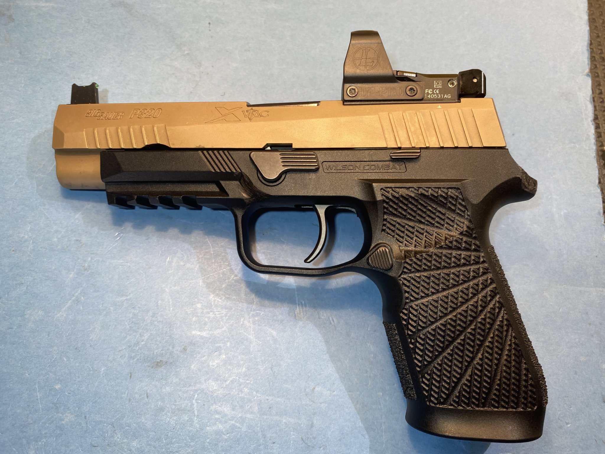

    I mounted a Delta Point on this V-TAC P320 that had a factory milled slide with metric threading to accept factory screws.
    In the Internet era it's said that if someone likes a product they will tell a friend however if they are disappointed with a product they will tell the world!

    Unfortunately I opened the better looking one first, test fit it on the slide and it was a go so I fit the sight. The sight that is completely wrong, yet supplied by them and confirmed by them before purchase to be correct despite the product page saying otherwise.
    The plates in no way have been modified or fit, the sights were the only things that were fit. The sights were drifted in after I completely reprofiled the dovetail angle of both sides to make their cluster fuck of parts worth.
    Neither plate will accept a screw to hold it down because they didn't use the right tap to account for the thickness of the anodizing. Neither plate will allow the posts to pass through their holes. One will go somewhat in but then won't seat flush like it's supposed to because the relief is out of spec for the bottom of the post.
