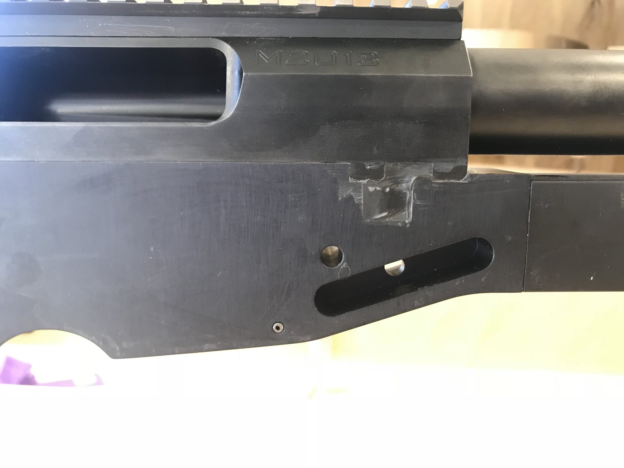

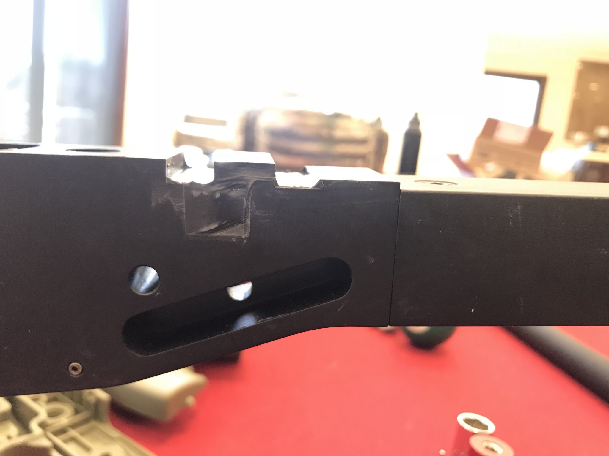

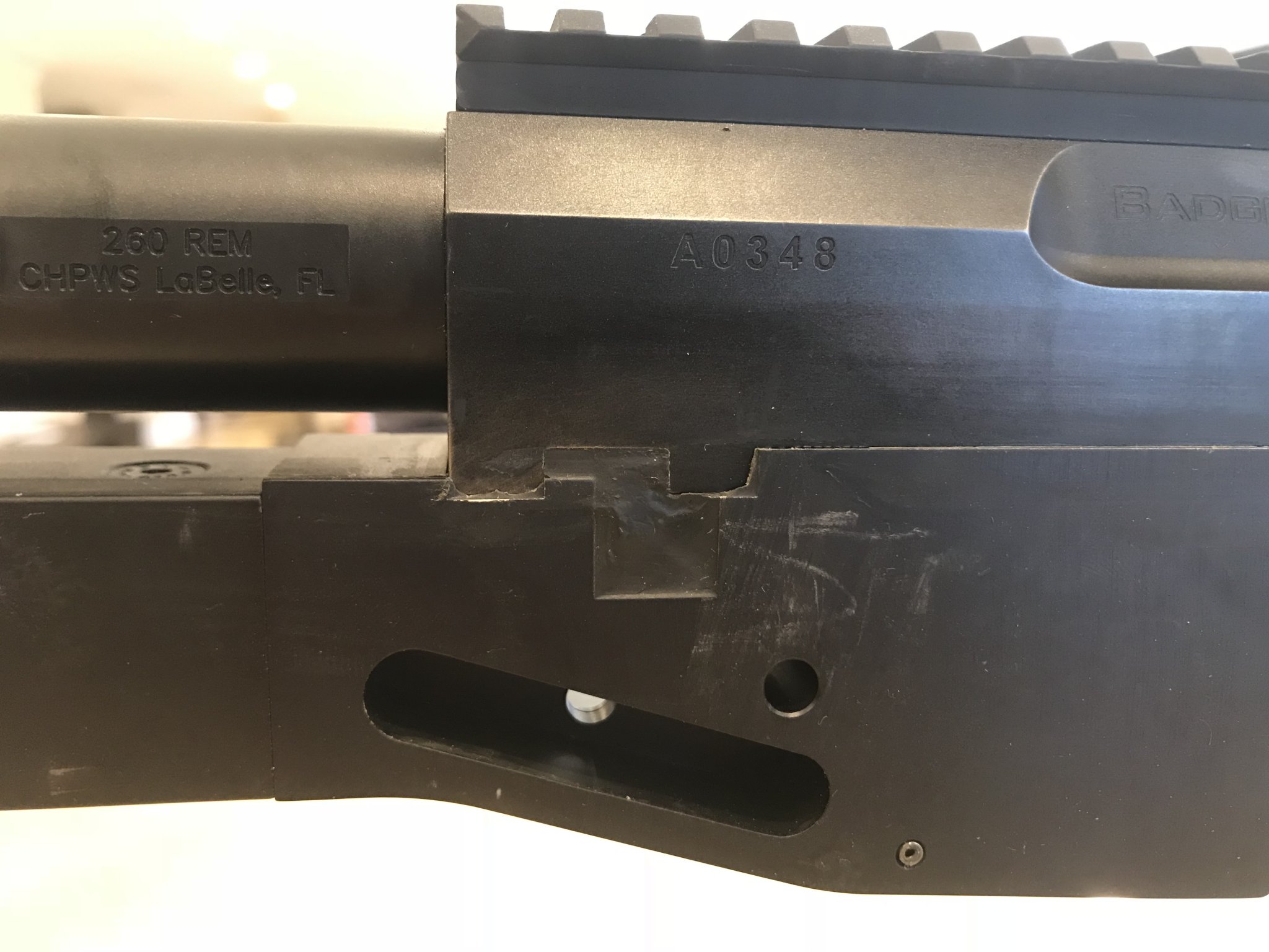

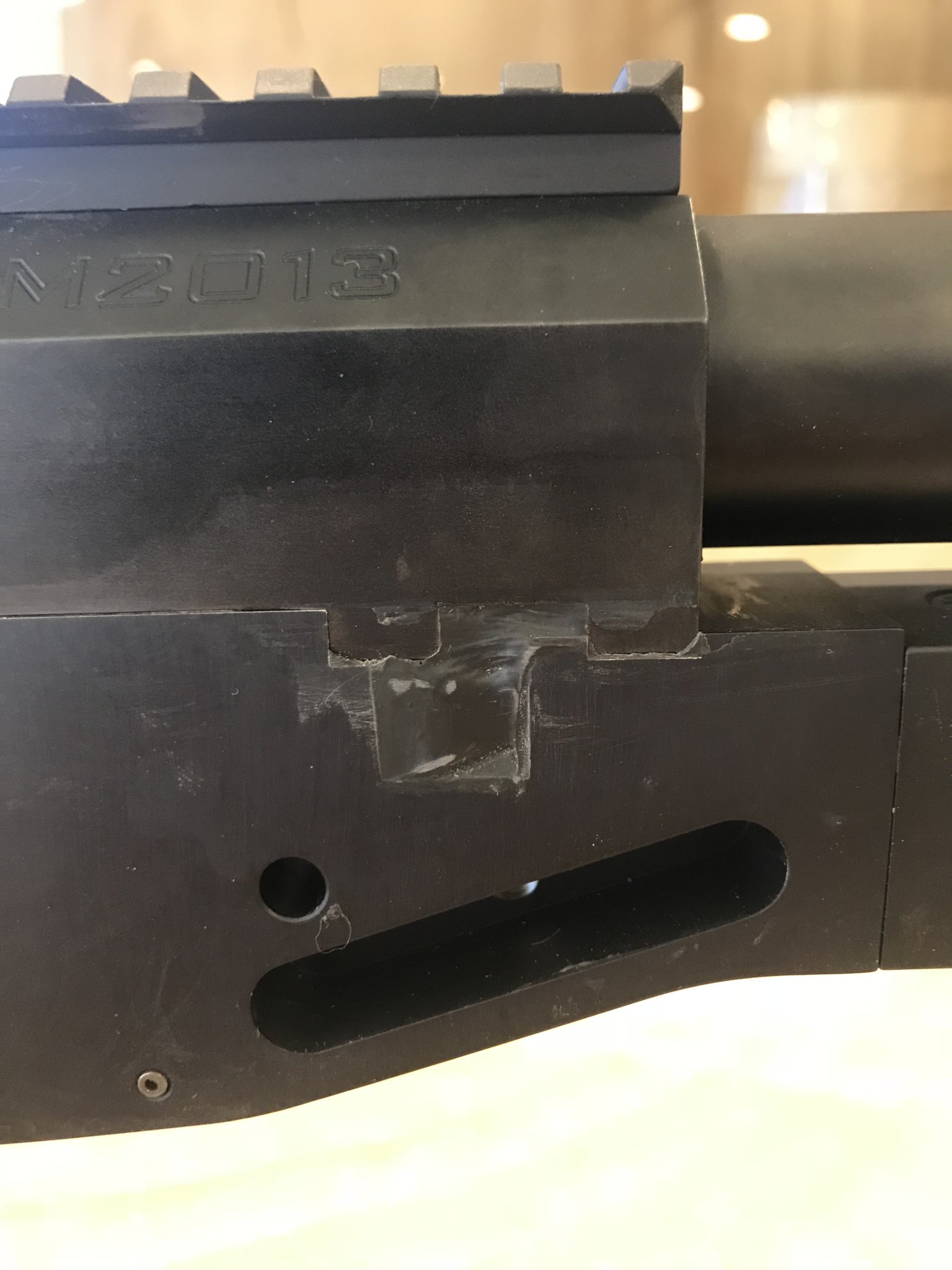

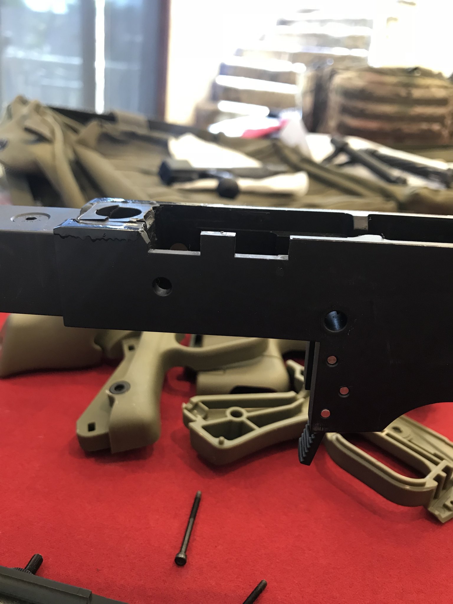

I’m so happy I saw this thread. I’ve done business with Buck years ago. And purchased a couple bolt action rifles from him. So my friend has a Badger ordnance m2013 action sitting on a AI AT chassis so I decided to do the same build and since Buck already built 2 of my rifles which shoot great I thought I’d give him this job too. So I asked if he’s ever milled a AI AT chassis to fit the badger action and he replied no and that he can get the specs from Marty and can program it into his cnc machine and Itle be great. So he called me back tell him to send in my parts and like an idiot I did. Got my rifle back after some time and couple months and couple 100 rounds later I’m realizing this rifle still shoots like how it did the first day I got it. Absolute shit ! Rifle was chambered in .260. So I tested Berger 140 hybrids Sierra match Kings hornady eldm and lapua scenars. Nothing was working and All my reloading is done with top components. My scar 17 shooting reloaded ammo from my Dillon 650 shot 10x better than the rifle he built. After inspecting my friends chassis (milled by Jeff from river bend) and showing him how it looks so much more different than the one he milled out everything went south he has no way of of talking to customers normally or dealing with a problem he made. A lot more shit happened and basically I ended up with a shitty AI chassis that went to the trash and the jackass didn’t fix the rifle and told me I’m a shitty Reloader and a shitty shooter haha also instead of “kick rocks” he hit me with the good ole “run your bolt not your mouth”

I remember being 13 years old and getting my first AICS 2.0 chassis back in 2002 and having to file the inside of the trigger inlet for the bolt release on my Jewel trigger and it not looking like a perfect mill job (on something that needed clearance) and feeling like I did a hack job. Holy fuck though did my relief look great compared to that inlet. That inlet is so crooked at the bottom that you can see it in a crappy pic with the naked eye. Then fill it with JB weld when you fuck up the inlet job 😂😂😂😂. I’ve seen people patch oil pans with JB that look better than that.
Put down the meth pipe and step away from the Dremel.
