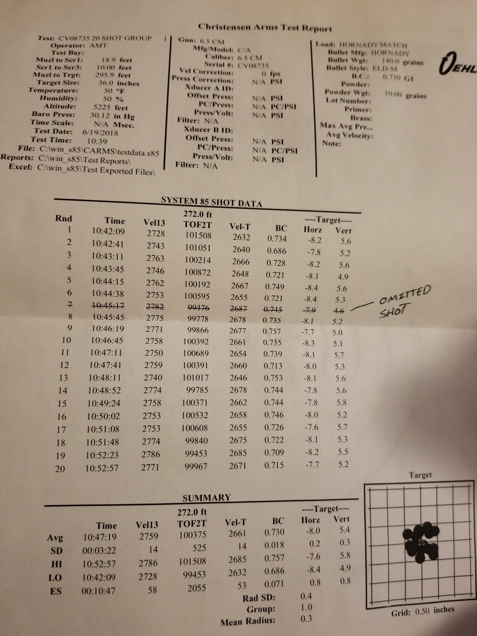

I appreciate you taking time to post pictures and documentation!
Great to hear of their response. That test target looks pretty good. I do somewhat wonder if the response is only due to this thread and if any average joe has the same response, but this seems to be a solid result for you at least!

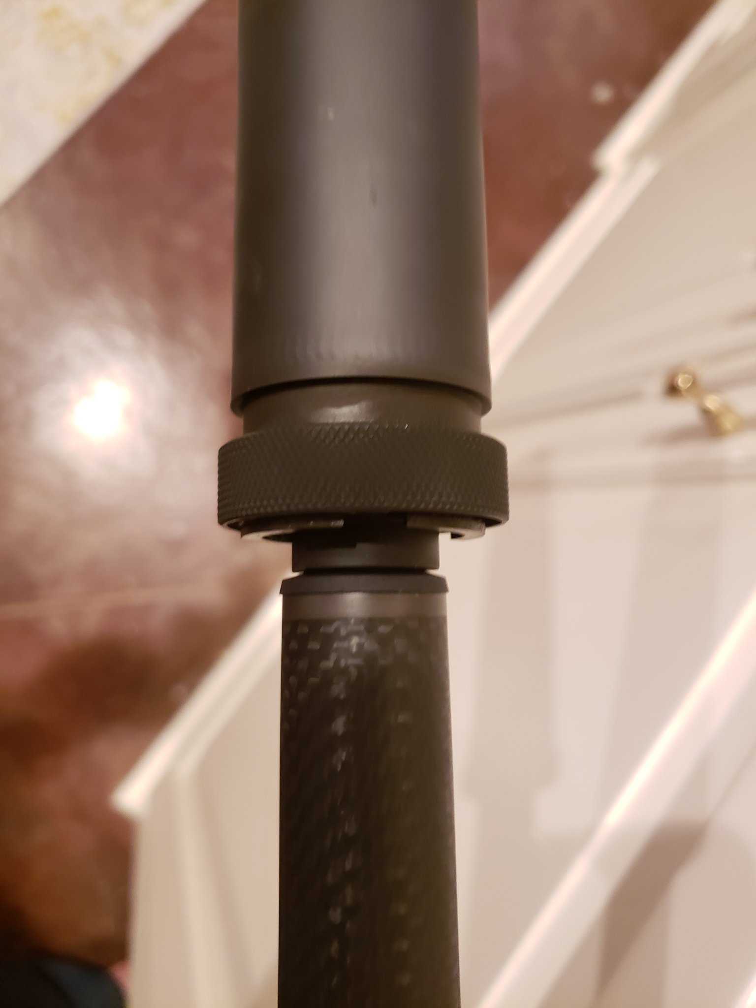

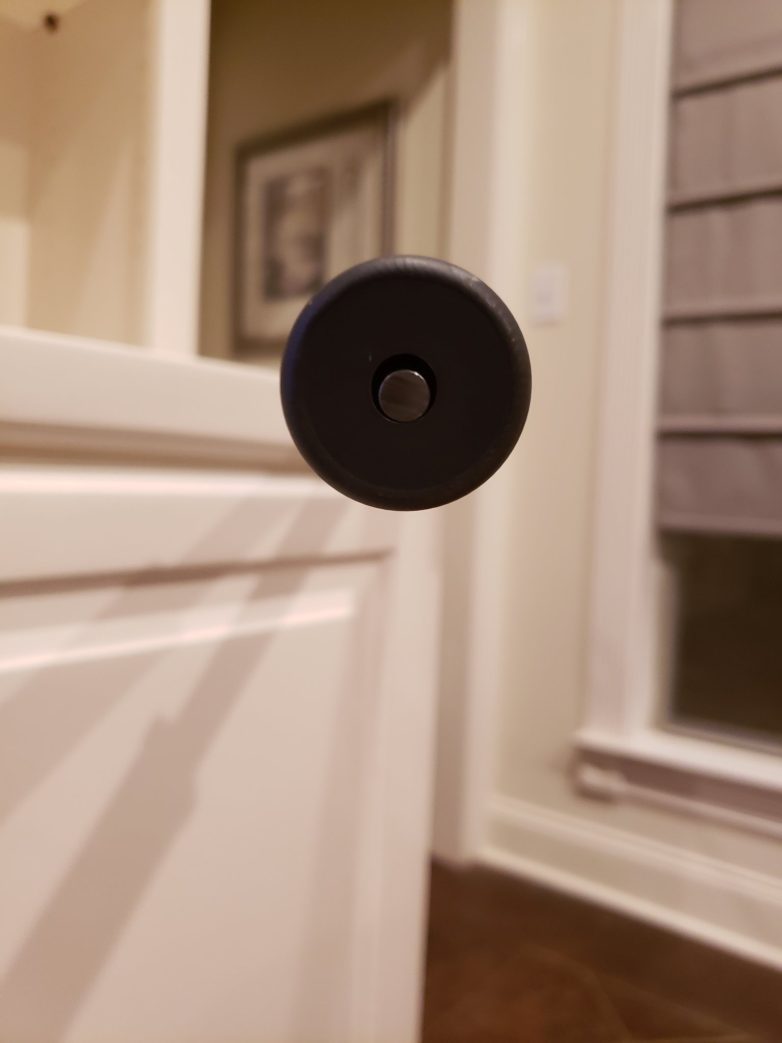

Speaking of the MPR. Just picked up mine and put on a sico ASR break and this is how it came out.
I'm assuming the darker ring is part of the barrel as it wont come off at all. I dont know why a company would think a rounded shoulder for a suppressable weapon would be the way to go.
EDIT: I realize now the dark ring is a washer. I got it off and everything is cool.
Speaking of the MPR. Just picked up mine and put on a sico ASR break and this is how it came out. View attachment 6995592
The crush washer is still on. You need to take that off. Thats the darker portion as you said. Get a pair of pliers and clamp down on just that portion, careful not to mar the silver portion.
Thanks. Literally 5 min after i wrote that I looked at the manual again and just realized it. That MFer wouldn't move with my hand which is why I originally thought it was part of the barrel.
Everything is all good now. Thanks.
Honestly I'm sure more than one person has had a baffle strike because of this. Easy to think it's part of the barrel, I did too until I mounted my can and noticed it was off center. I saw a guy at the range with one about to shoot it for the first time with a direct thread can. He would have had a strike had I not noticed.
CA needs find a better system or at least flip the crush washer around to make it more obvious.
I did the same damn thing on mine... almost jacked my shit up too. Thankfully I noticed it by accident. I hit it with my brake tool and it came loose. I was wondering what kinda fubar BS it was for a while. Glad I'm not the only one that did that.

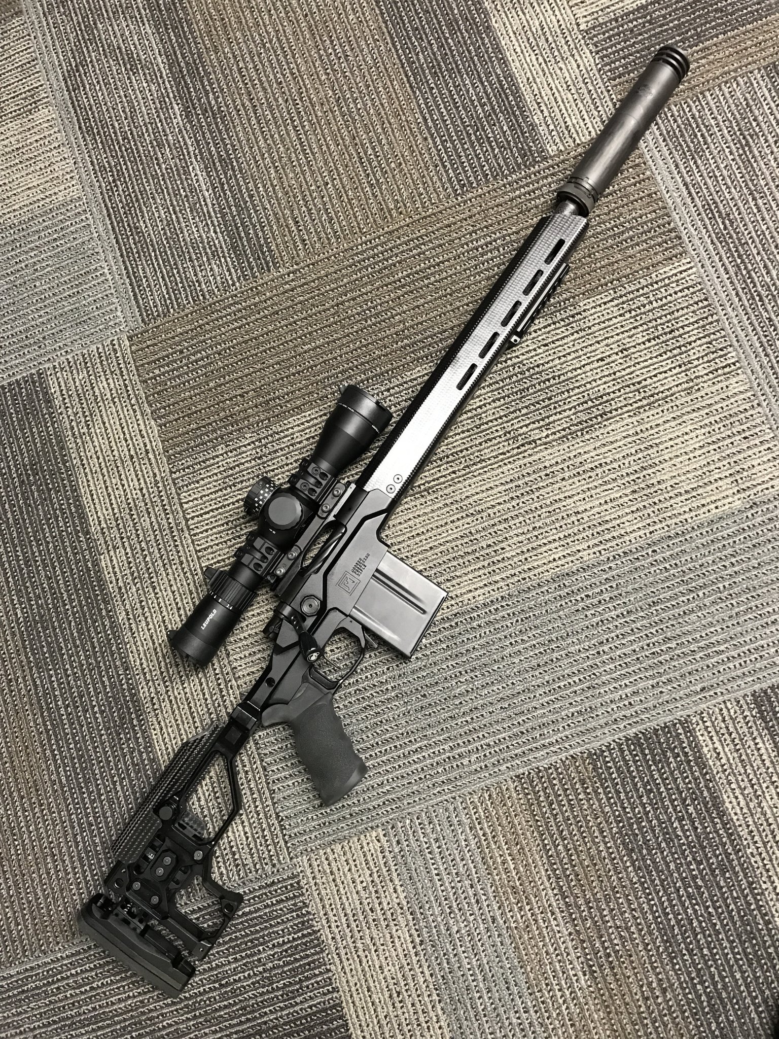

Finally got mine all together, 16" 308 with Leupold Mark 5HD 3.6-18X44, Spuhr mount and SiCO Omega can, easily shooting MOA or under with my handloads. Loves 155gr A-max's. Happy customer so far.......

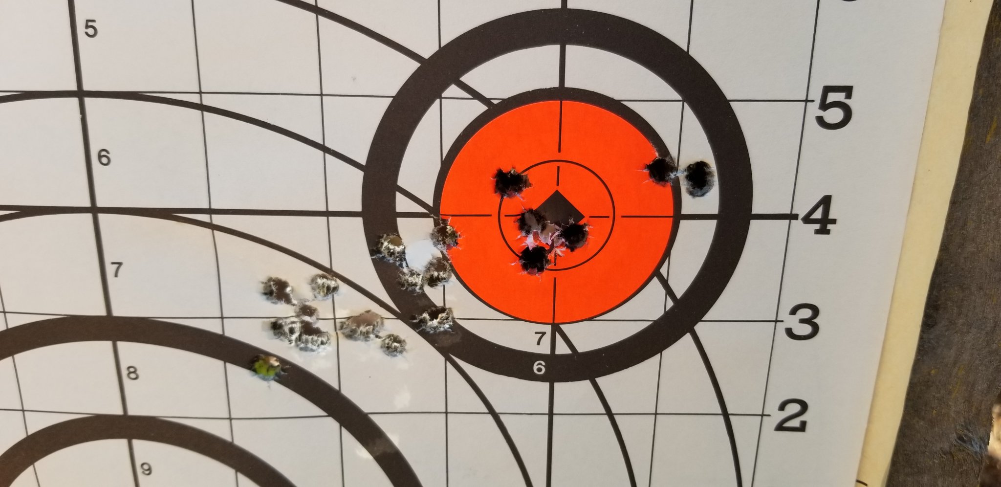

ISSUE 1: CONSISTENCY
I would get 2 or 3 rounds tight then flyers, and at first I was thinking it was just me. So after last time I double checked the torque on EVERYTHING on the rifle. I began to notice as it got warmer, the groups shifted big time (an inch or more), and we are talking just a few shots. I tried taking a few moments between shots and that didn't help either. So I decided to put 25 rounds through the rifle ( had 2x 10 round and 3x 5 round mags with me) and fire a steady pace to see what the group looked like.
This was fired from a caldwell "tac driver" front bag and a rear bag.
First 3 shots were tight on the right, the next few were around the middle, then the rest began walking down and left as it got hotter. I experienced the same issue with a Atlas bipod and sandbag as well. I did the same test with my Tikka in the next photo.
This is 25+ rounds, fired in relatively quick succession. I did not take my time near as much as I did with the MPR and got much better results. I did pull a few slightly.
I understand a hot barrel will open up, but this is not "opening up" its walking low and left the hotter it gets. Anyone got any ideas wtf is wrong with it?

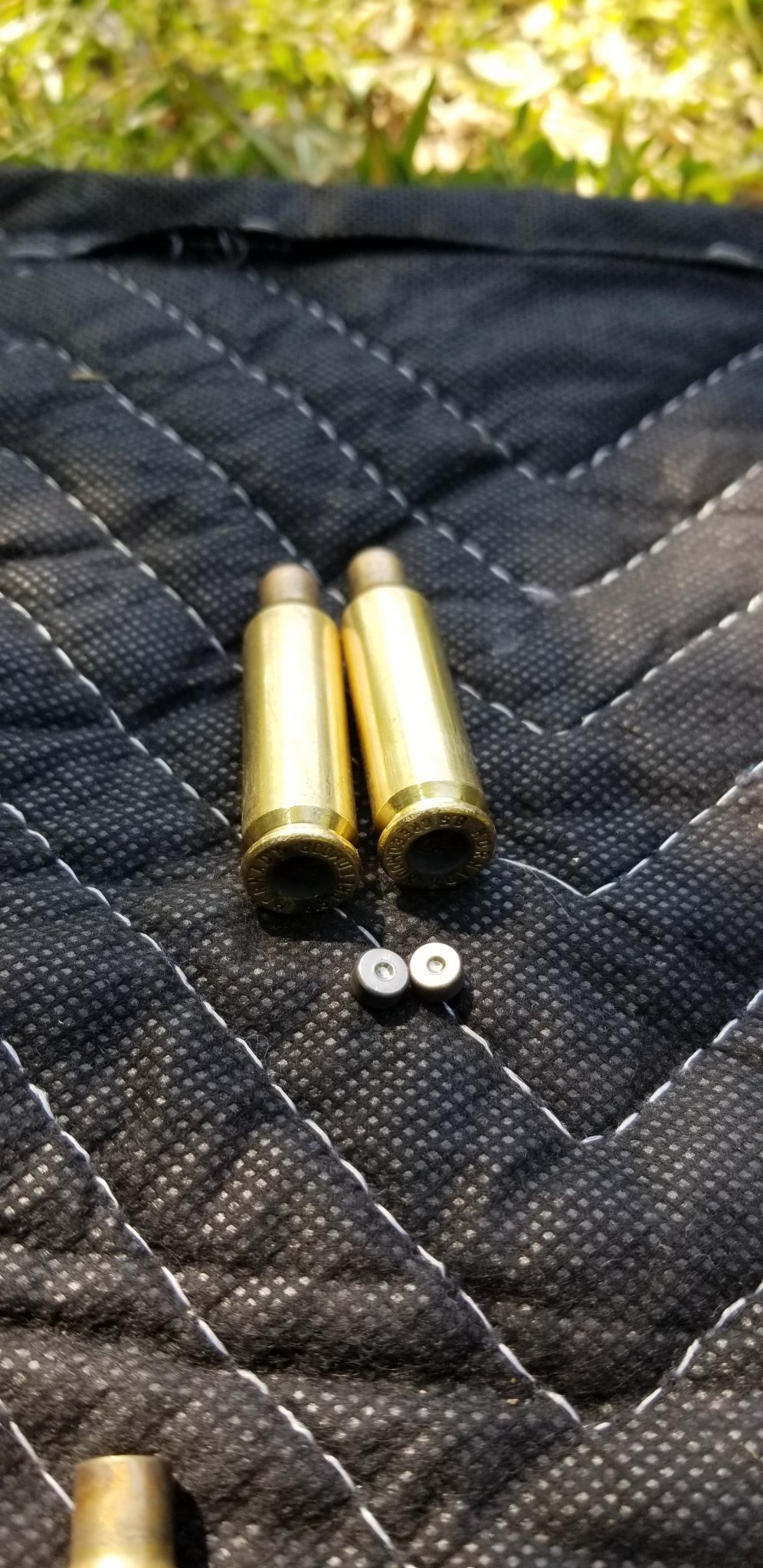

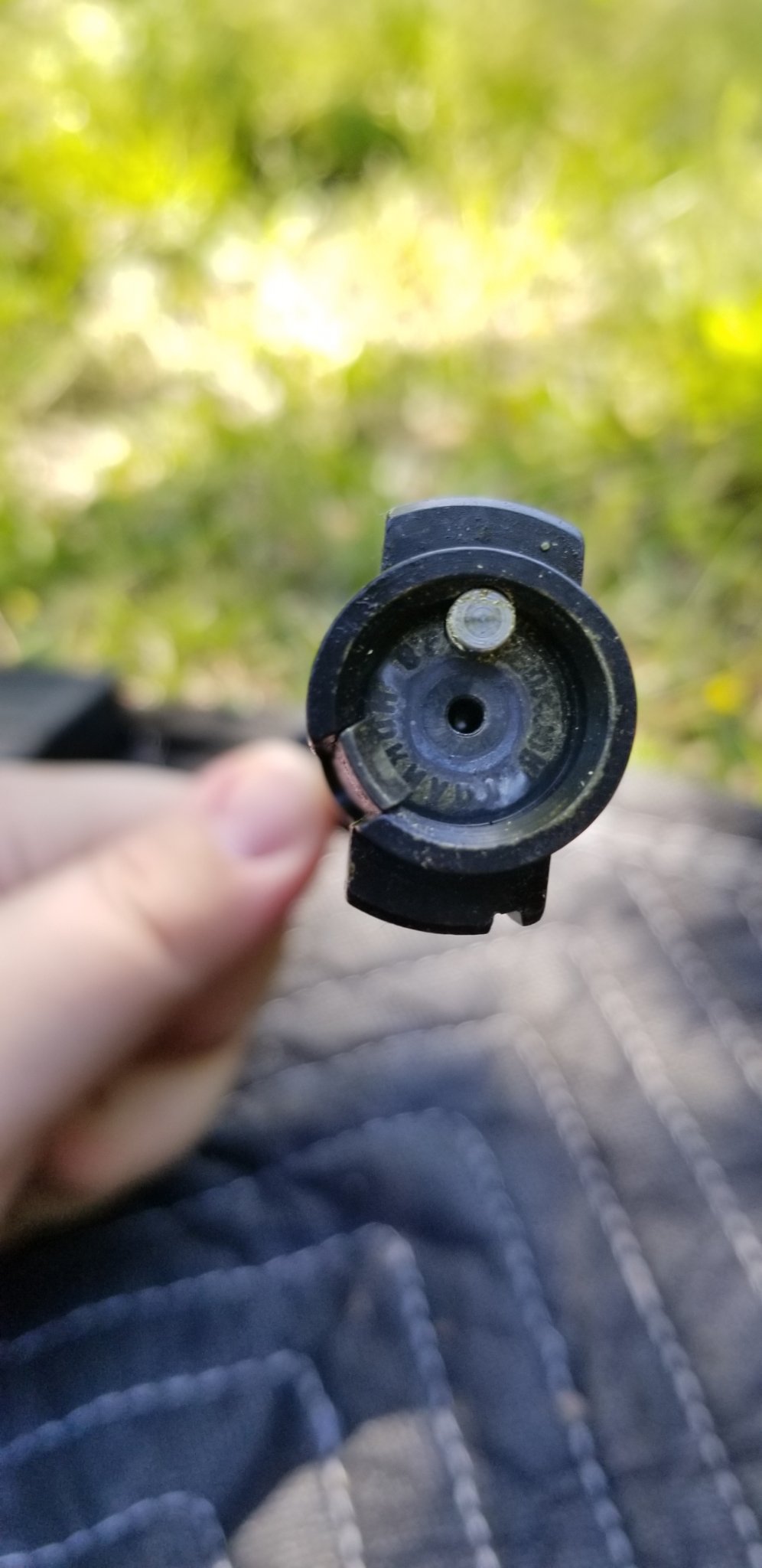

PROBLEM 2: Ammo pressures -
I've seen pressure signs on several loads, many of the "match" loadings are showing some primer distortion, but nothing too serious. Till I tried this:
View attachment 6895863View attachment 6895864
I cleaned up the bolt and checked the rifle, everything appeared fine. I only fired 2 rounds of this ammo and both did this, and I experienced a sticky bolt as well. The other 18 rounds fired flawlessly through my Tikka with no pressure signs. I was under the impression most ammo was made for longer barreled 6.5 CM. I do not understand why 6 inches would show that much of a difference. All other rounds of other ammo types were fine.
