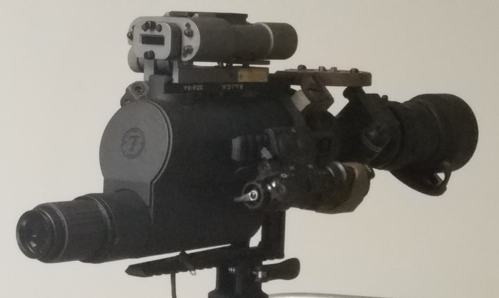

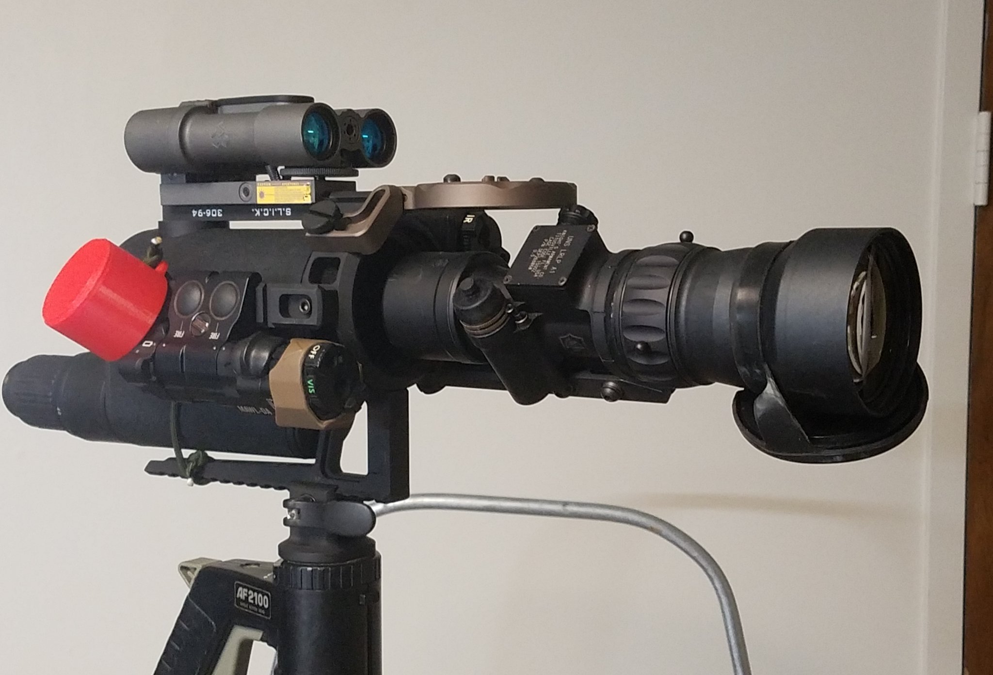

Night Vision clip on in front of a spotting scope
the M151 - ish platform probably offers the most flexibility in mounting solutions. Badger Ord has several SLICK options and well as a SNAP option.
The SLICKs allow mounting clipons in front and RAPTARs or Radiae on top.
The SNAPs allow mounting 14 on the rear of the eye piece.
If mounting thermal clipon in front, probably should get a UTCxii as those will support clearest image at 12x plus
I thought you had already seen this setup at a previous course.
Running 2 of these setups for classes. One with a 30 and another with a 27.
Only change made in a couple of years is I ditched the Badger pic mount adapter and pistol grip ball head for a RRS Anvil to be more rigid over the tripod.
If you are using your setup for other than recreational purposes, I would recommend mounting the spotter (If your spotter is the folded prism design like mine) inverted. This keeps your noggin more out of line with objective glass if anything were to fly your way.
Using a SNAP on the back with a PVS-14 does "okay" but you can forget being able to resolve any reticle you may have in your spotter.
FWIW.....If you are using ONLY for observing, I have found an older PVS-7 allows for longer viewing time with less fatigue due to being able to use both eyes.
Be safe jackinfl.
Damn, that is perfect. I want! Nice setup.
