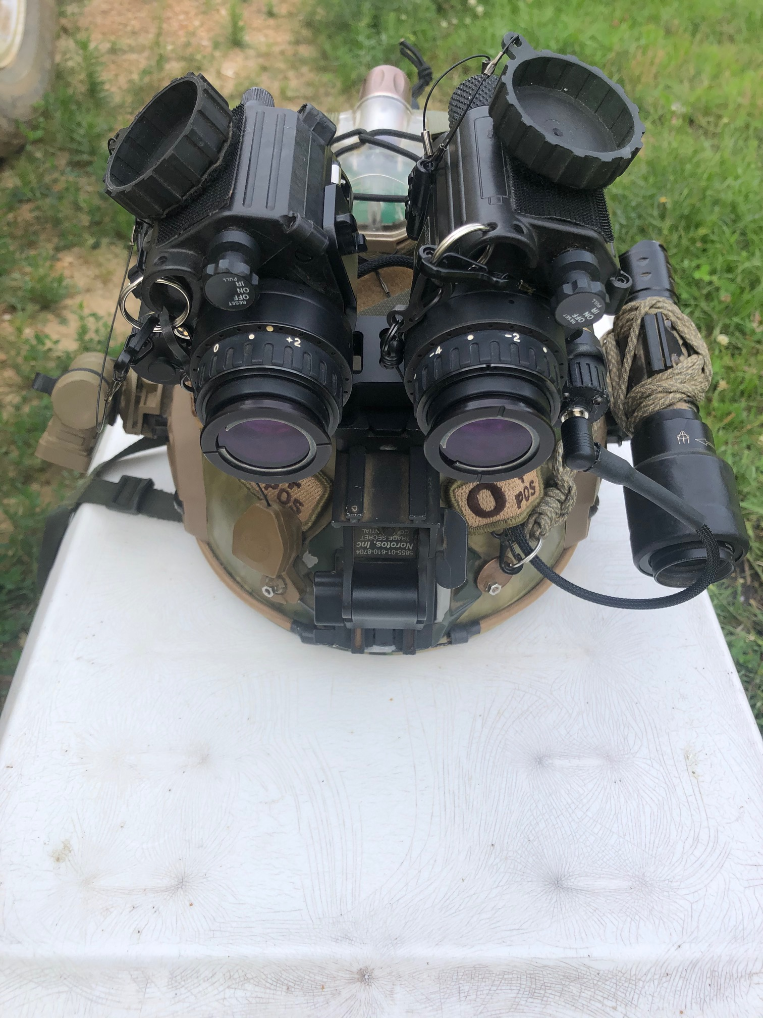

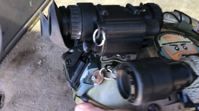

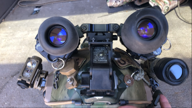

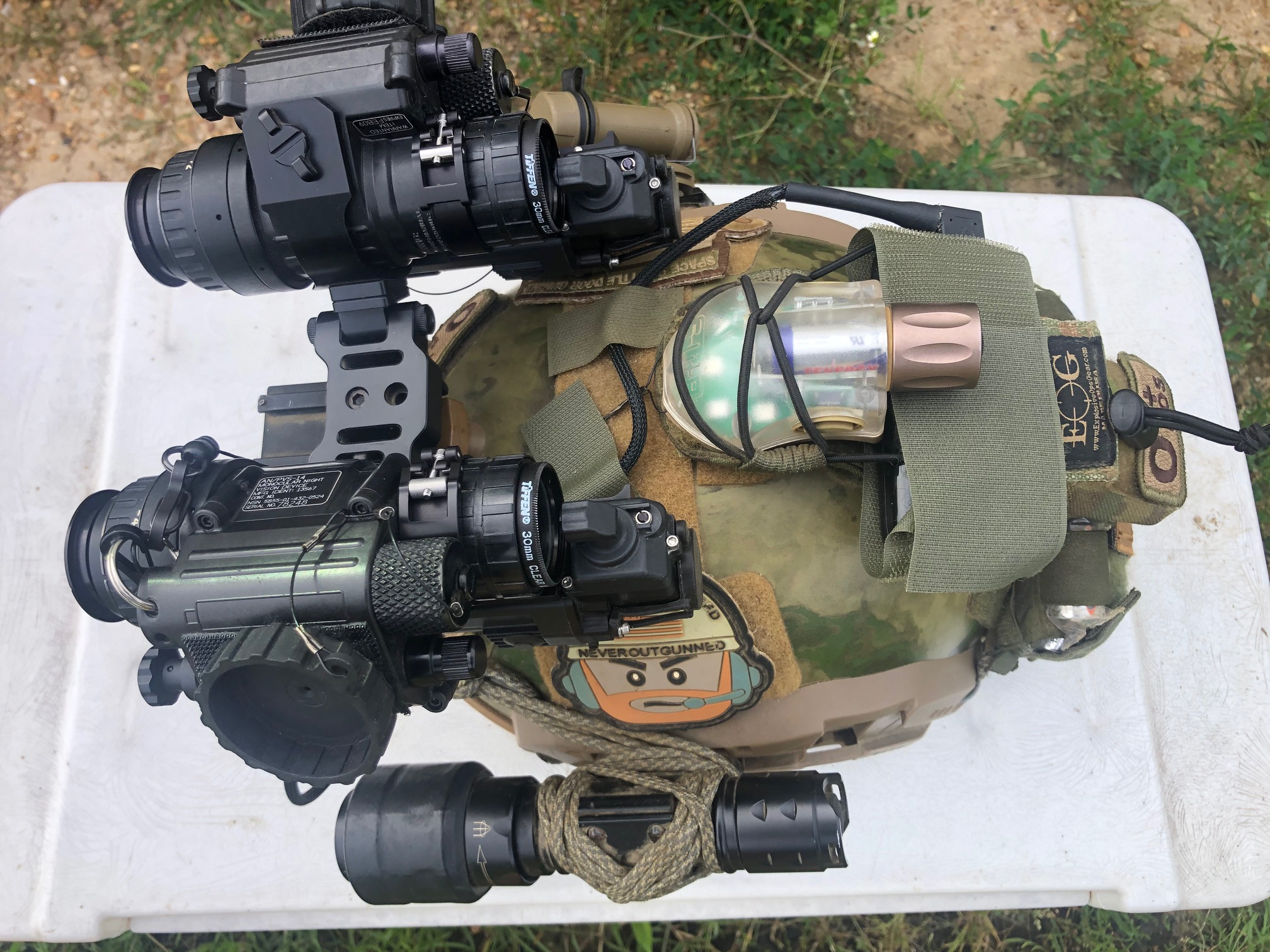

Here are some pics with Dual COTI on they don't fold as flat because of the COTI's
Here are some pics without COTI on which shows you how flat a set of PVS 14s fold down with the Mod Armory Bridge and a Rhino 2 with Dovetail

I 100% notice that my dual 14's are not collimated. It could be something else (mechanical alignment, shitty brain, idk many variables probably exist), but there's something off about these. I probably notice only because I've professionally used dual tube nvg's for years. I can also 100% handle the collimation error. It's a minor issue - but I can also handle a scope that's been mounted canted... I still try to fix it. That being said, I can fix a canted scope for free. Not so much my 14's it seems. My 2 cents on collimation.
Interesting about MX 10160. Those don't have adjustable gain, right? I'm guessing that's what is also in PVS15's then which makes sense as I understand that 31's have some proprietary tubes that allowed adjustable gain. I didn't realize the pvs15 had aviation tubes in them. Neat.
@MarinePMI
I agree, this has become like a cat chasing its tail around.
However, despite the long, (all off in to the weeds interpretations of what it is opined I said) I would like to simply confirm in a quick summary format what I have clearly stated.
From my experience and the experience of others in my circle, if you take 2 PVS 14's that each have been collimated to their systems and you put them on Mod Armory Bridge in a dual configuration, me and my fairly large group of real users have not experienced any headaches.
So for us, the headache legend thing, is a non issue, albeit we all run 4 D pads in our helmets. Man those things must be magic.
Have you tried switching the -14's? I find I have to have the better tube in front of my dominant eye. Since you mentioned your professional use I'm sure you know how to fine tune the focus, but that's another thing that has caused me issues in the past with dual tubes (dual -14's or binos).
Now that's an interesting point. I'll have to file this away for when I get my second 14 later this year.
I actually did. It's not a matter of tube quality, I (think) that I can just tell that the tubes are pointed in slightly different directions. One combo seems less extreme than the other, but neither are very extreme. It's probably not off by more than like 2 degrees from each other (rough estimate based on assuming 1 finger at arms length ~30 mils? images seem to be drifted apart less than 1 fingers worth). With 31's, rotating each tube up and down doesn't shift the image much or at all. With dual 14's (and probably single 14's?) one tube shifts it slight down, the other shifts it slight left. . It's basically a non-issue that I'm not willing to pay to fix, but would do so if it was free and didn't mess up the purge.
One of y'all is right that error definitely exists. The other is also right in that it doesn't really matter (but it still exists).
