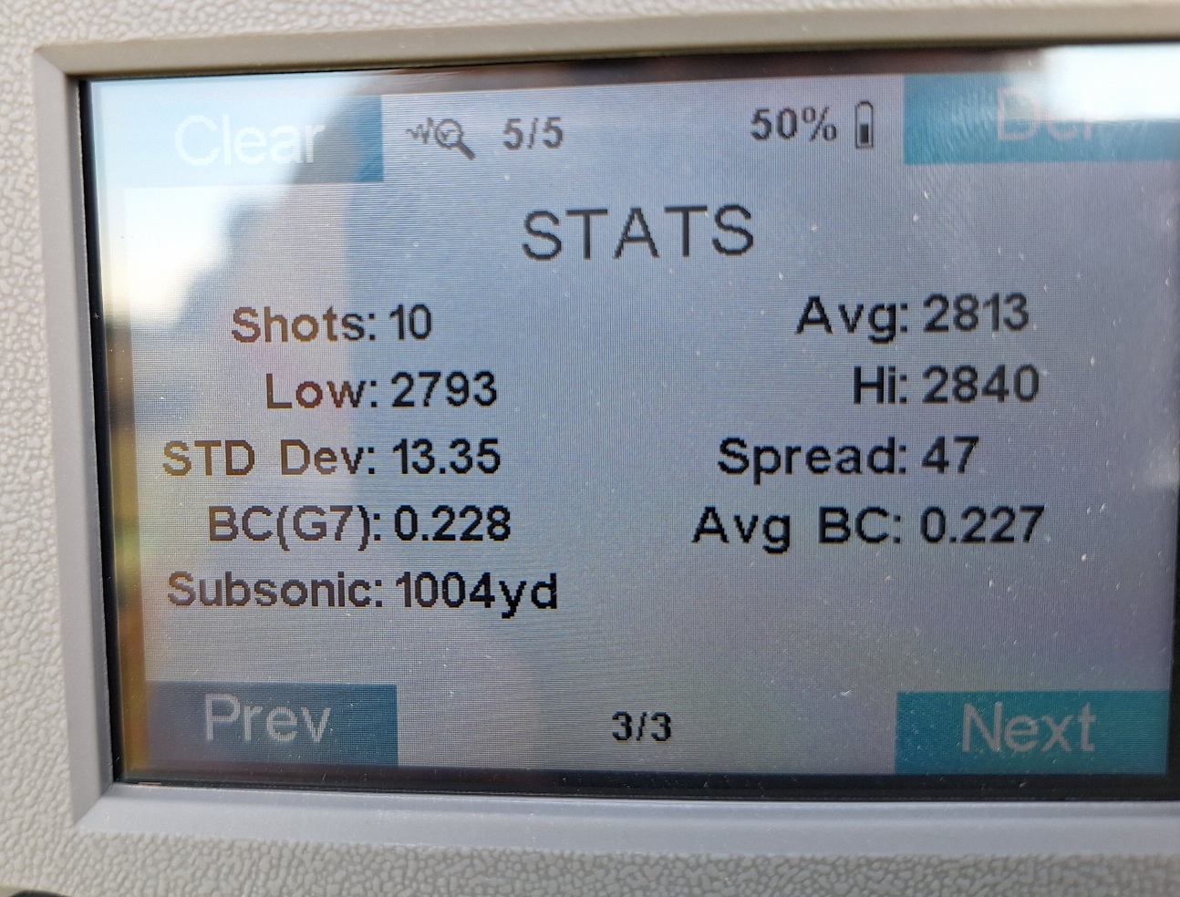

To add a little bit of value to this dumpster fire, ADI loaded ammunition with 168s runs 2813fps from a 26inch 12 twist LW Varmint barrel on a Howa I put together for a friend.

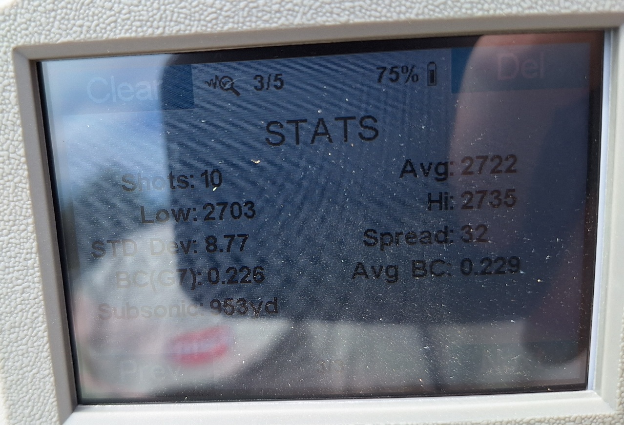

Runs 2722fps from my 20 inch Savage impulse.

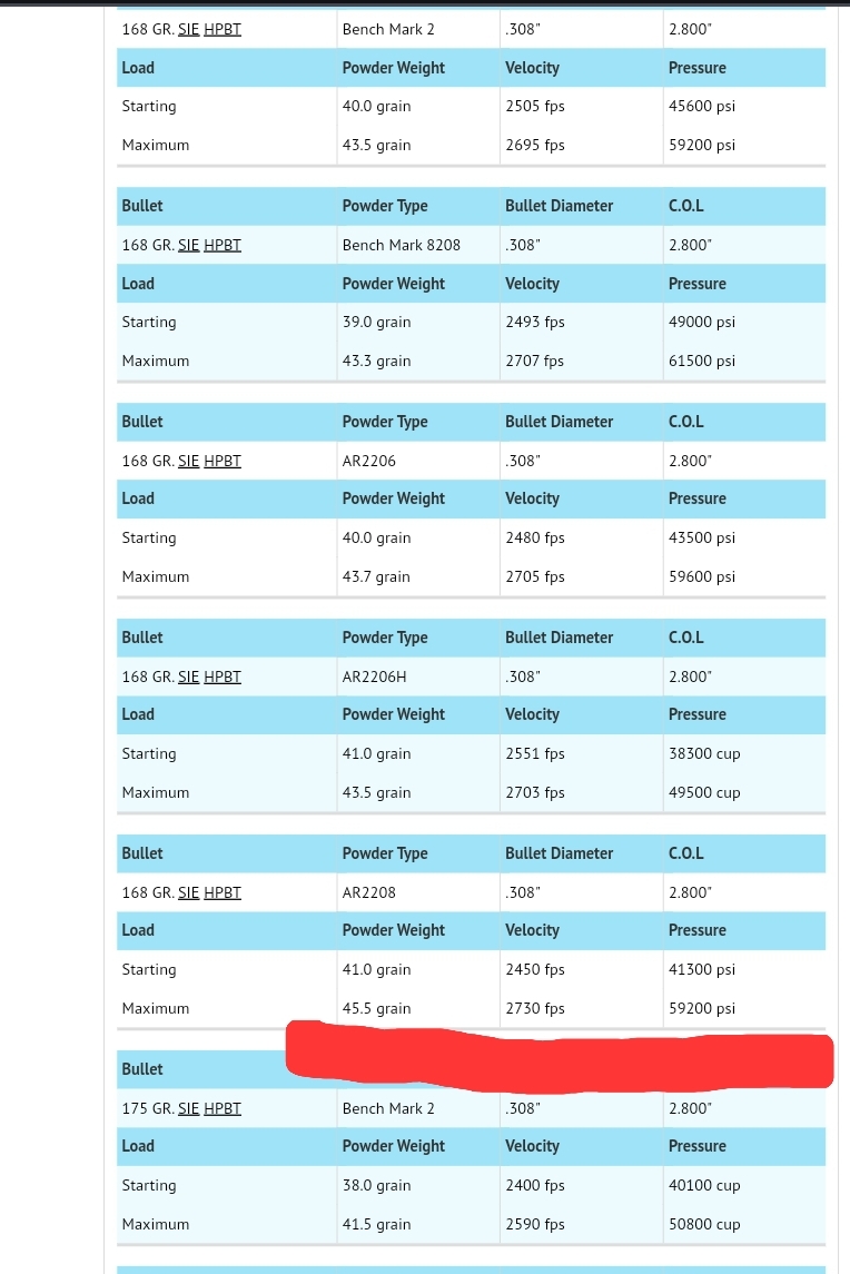

I pulled a projectile on a soft strike out of the Savage impulse and it was about 45.6gr 2208/Varget based on the ADI pressure test data.
I think starting at or below the ADI minimum load is a complete waste of time from a pressure and accuracy standpoint unless they are the only components/rifle you have and you don't want a new shooter developing a flinch.
