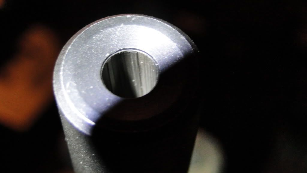

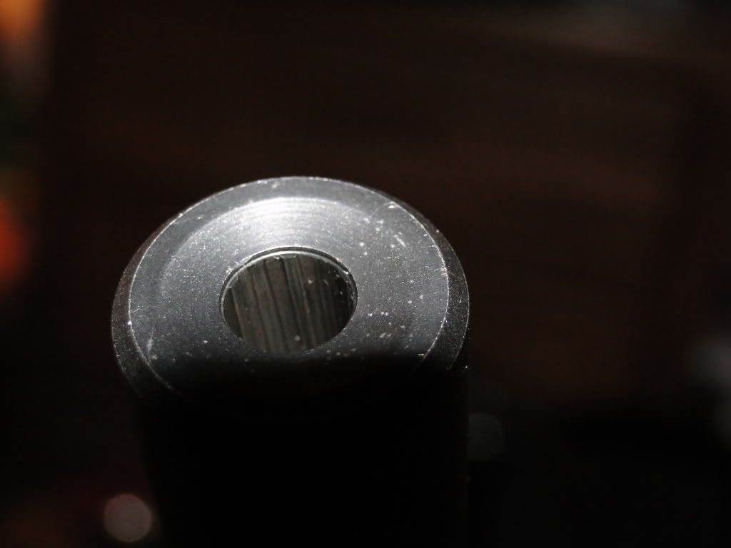

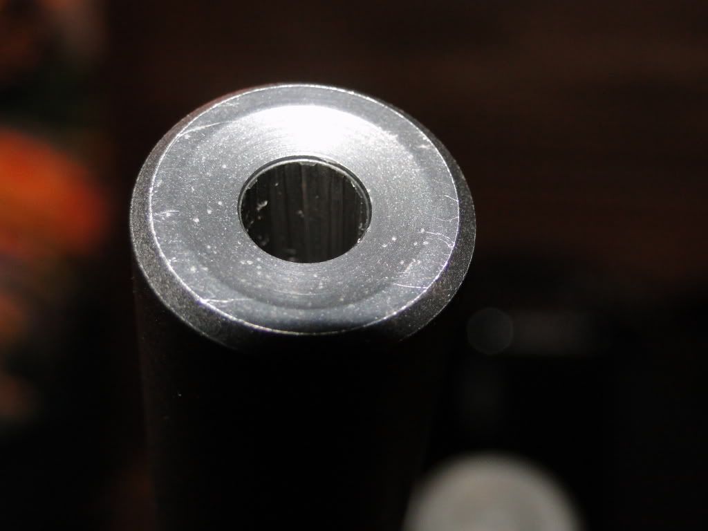

    Here is what my barrel looks like from what pics I can take. This is after about 250-300 rounds through it.
    This is a stock Remington 700 SPS Tac with 7-800 rounds total through the barrel. My rifle shoots sub one shot after another.
    Aron-
