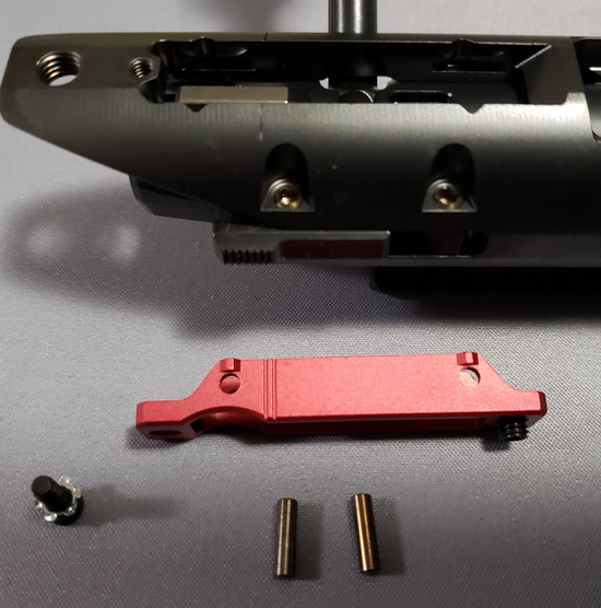

Wait when did the trigger hanger change? Just the screw?
Design change was at least a month ago.
The new hangers lose the protruding pointy pins and instead now have protruding retaining tabs on the trigger hanger itself to retain the trigger hanger into the action. New hangers are also machined with additional clearance for the safety lever.
There's pics of the new trigger hanger quite a few pages back. Older actions do not have the necessary cuts to use the new trigger hanger, but in the picture that was posted it appears the newer actions have cuts for both the newer trigger hanger with the tabs as well as the angled cuts for the older hanger with pointy pins.
